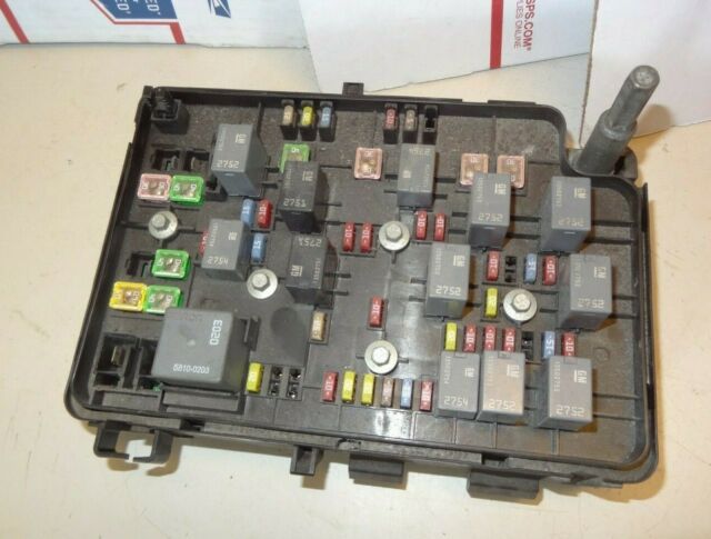

I'll save you a bit of reading because my build thread is ...... long, my problem ended up being that a connection on the fuse block end of my engine harness had a slightly-deformed pin. I had to fix that pin, then it started cranking. But, there's a ton of good advice from our compadres in there, you may find something that helps.

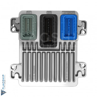

The bottom line is, when you turn the key, the ECM decides whether the conditions are right to crank the engine. If they're right, the ECM provides ground to a set of three pins in the engine harness, which in turn grounds the correct pin on a relay in the fuse box. With that relay pin grounded, power flows to the signal cable on your starter. *edit* I might have said that wrong now that I think about it.

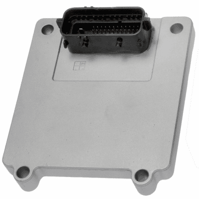

One thing that may be worth considering; the donor was wrecked on the front left, which is the general area of the round connector from the transmission. The connector was damaged and the pins were bent a little. I straightened them and pushed the connector onto them. I am wondering if there should have been a plug attached there. The connection is not secure, nothing 'snapped' into place like with most connections.That's correct, and that's good, because it means your key is being accepted by your TDM. That's bad, because it would have been an easy fix!
