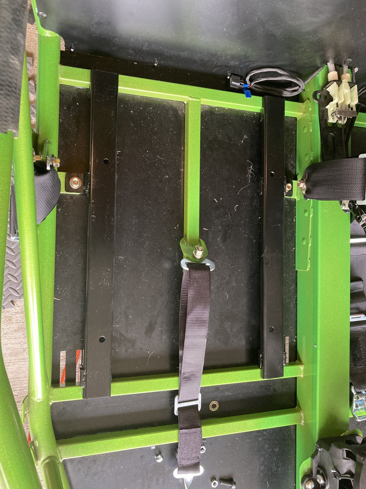

Thanks for the advice! Happen to have any pics of the harness connection points?
Pay no attention to the seat brackets but you can see the side and submarine strap mounting points in the picture.
33144
If you don't have your side panels on yet, things are a bit easier. The crotch belt and inside lap belt should be installed before the seats. The outside lap belt should be installed before the seat if your side panels are already attached. Unfortunately I don't have pictures of these attachments.
My preferred method is to tightly attach the brackets to the seats, and then put the mount bolts on a 2x4 on a floor jack under the car. Raise the floor jack while aligning the bolts so they're held firmly in place through the frame from the bottom of the car. I am consistently able to get only one bolt aligned, so loosely washer-and-nut that bolt. Lower the floor jack so you can get your hand on the second bolt and wiggle it until you can get it generally aligned with the bracket, then shove it back into place with the 2x4 and floor jack. If you can get the bolt into the hole in the bracket but can't get threads to go through, just put your weight in the seat.
I have the FX1 seats (not pro) with the brackets mounted in the outboard position, with the tabs facing the inside. The nut for the inside bolt can be hit with an impact with extensions. The outboard nut requires a wrench as a ratchet is too tall and would hit the bottom of the seat.

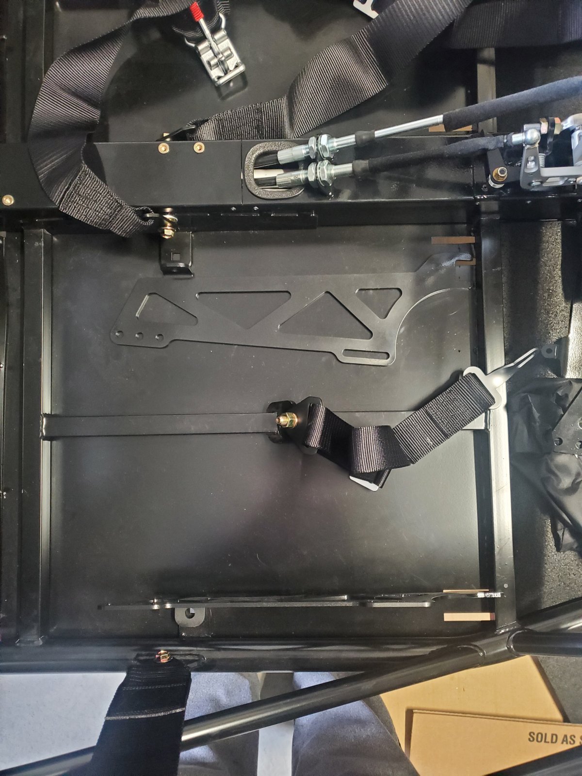

I think I'm missing something. I'm trying to mount the seat brackets to the car and assume that the front "fork" goes around the brase bar with the bottom going through the slot in the floor. The outboard ones seem fine but the inboard ones don't reach the bar. Do I have this all messed up? Does someone have a picture of how this is supposed to look?
The inboard vs outboard bracket thing just recently came up in one of the Facebook groups. Read the comments on this post to figure out what goes where:
Sluggonaut
There are inner/outer and left/right brackets. I think this is something everyone that buys the DF brackets gets to go through.
My FX1's mounted up fine with the bracket tabs facing inboard, both with the standard brackets and the short brackets.
