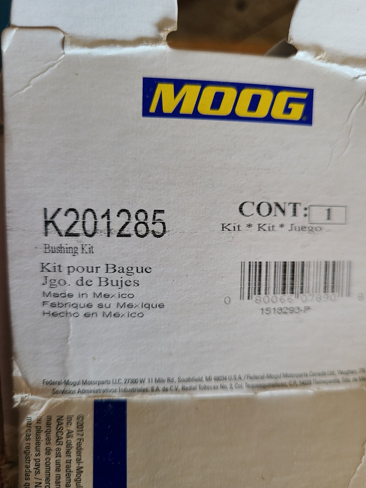

And use the MOOG heim joint type, not just the rubber. Keeps the arm from flexing under accel.
I did not replace my LCA bushings, I just got new LCA's. But, I didn't go the FE3/FE5 route for my rear suspension, so I will probably consider some of this as future upgrades.
This one.
