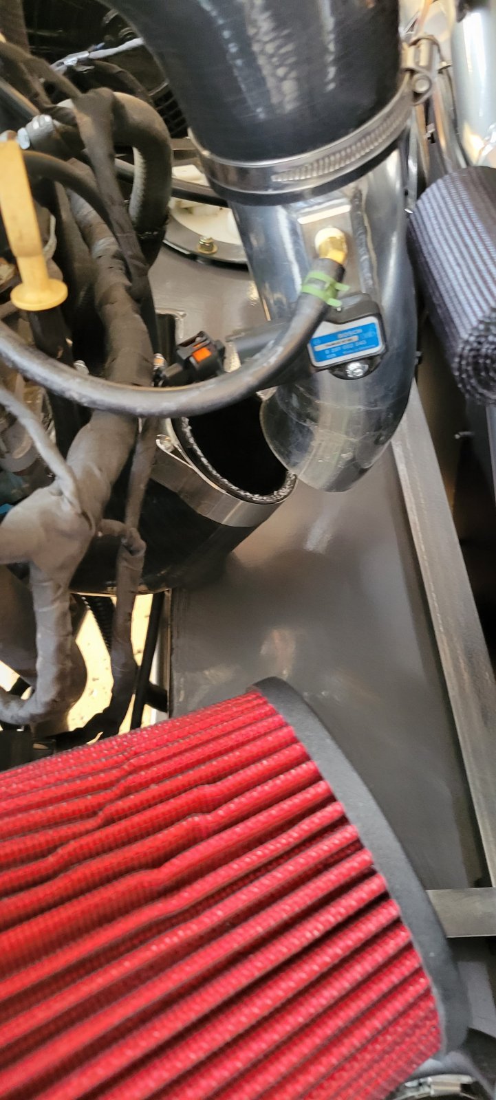

Just got the car out for the season. Did a couple of test runs as I have my inspection next month. The air intake as seen in the picture keeps popping off. What have others done to make it more secure? I am not sure what the boost level is when it pops off either. Appreciate your thoughts and ideas.

I had similar happen with a backfire letting off the gas after wot. I am at 26 psi boost. Make sure the band clamp is actually Clamping the rubber hose over top of the pipe.
It works. A 1/16th bead gives a 1/8th width increase to the tube, which is enough to retain a silicon coupler when torqued down correctly. It just takes more time to get a bead into a tube - and lots of hand-grip workout.
