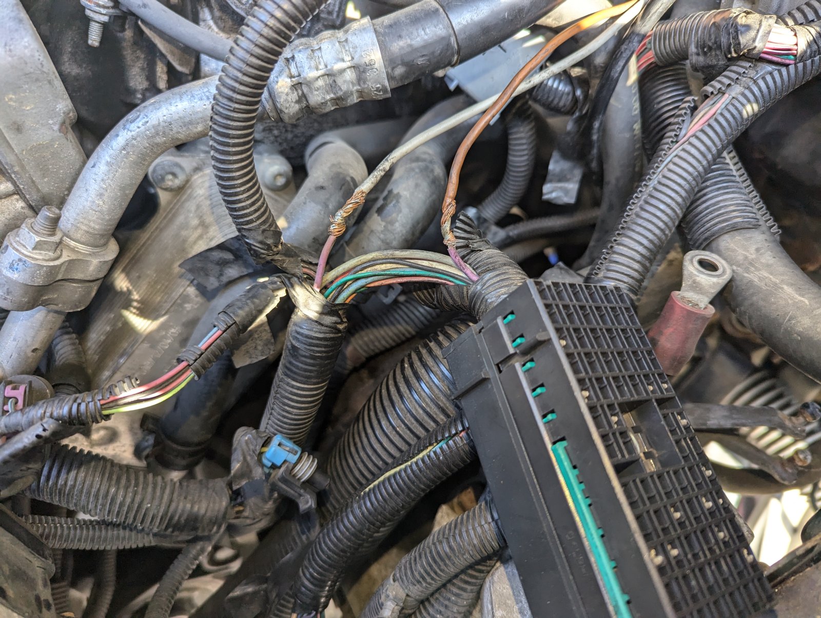

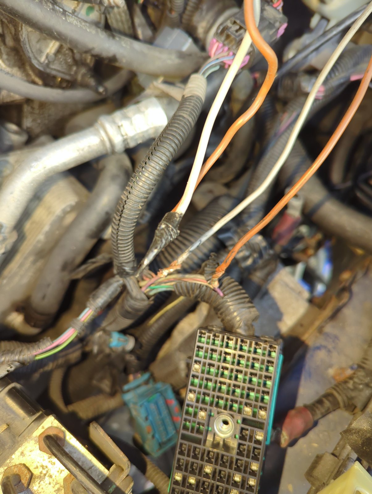

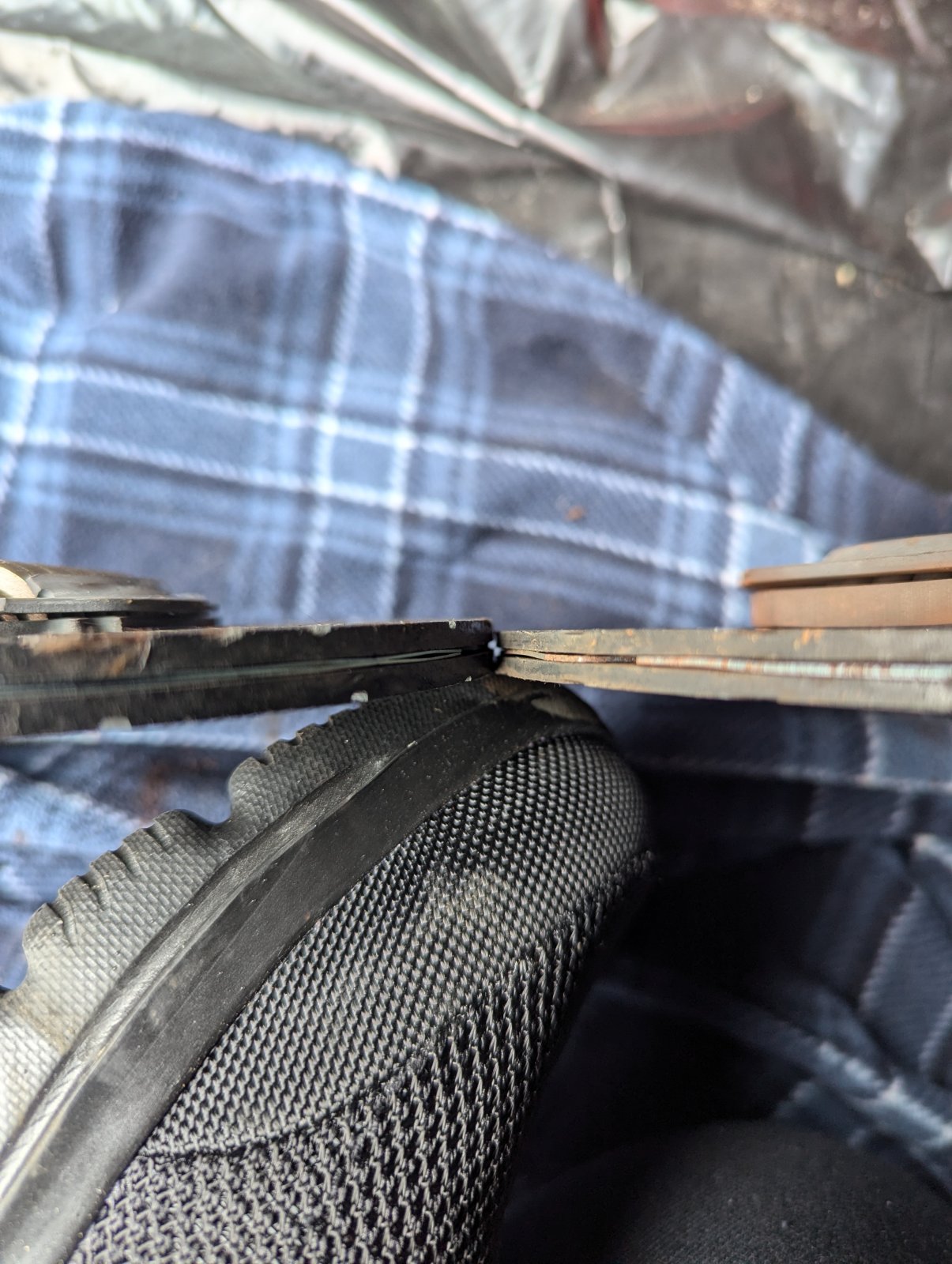

Iv acquired a lsj supercharged cobalt 05 or 06. I'll post most pictures and information soon but right now I'm swapping the transmission. I've come across this split here and wondering where it may lead off to. The start and end seems to be the same wire seen in purple. Where the other two wires go inside the cabin? No idea. Thoughts? I'm almost likely going to trace it to the fuse connector and see what fuse it is using and possibly tracing the split inside too. The points are soldered and I'm thinking of undoing it and properly soldering and heat shrinking it after I figure out why it's there.

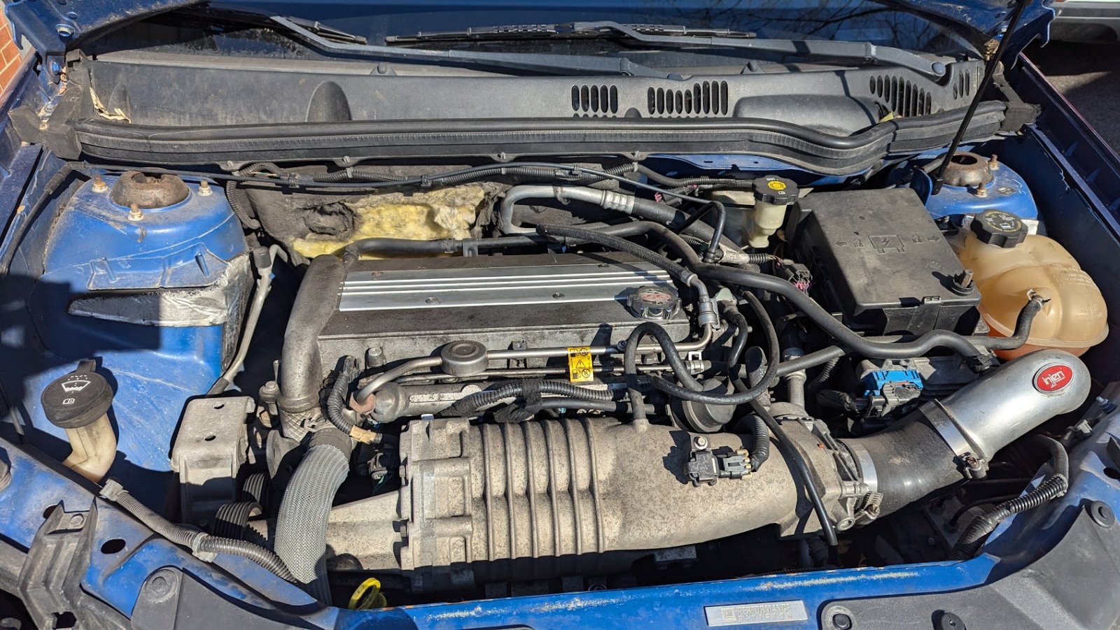

engine bay shot, the car spits out some codes once in a while but its been code free for a few weeks now, something about the supercharger solenoid i cant remember and then some issues with gas not being sent to the engine that have come and gone

I ran that purple wire as a remote start for about 6 months, until I could figure out my intermittent high speed LAN data issue.
When the LAN data wasn't flowing, I could use the purple wire & a 12V aux. power port, to remote start the engine... as long as the key was turned on, the engine would run. No dash data, so the instrument cluster was dead, but I could still drive.

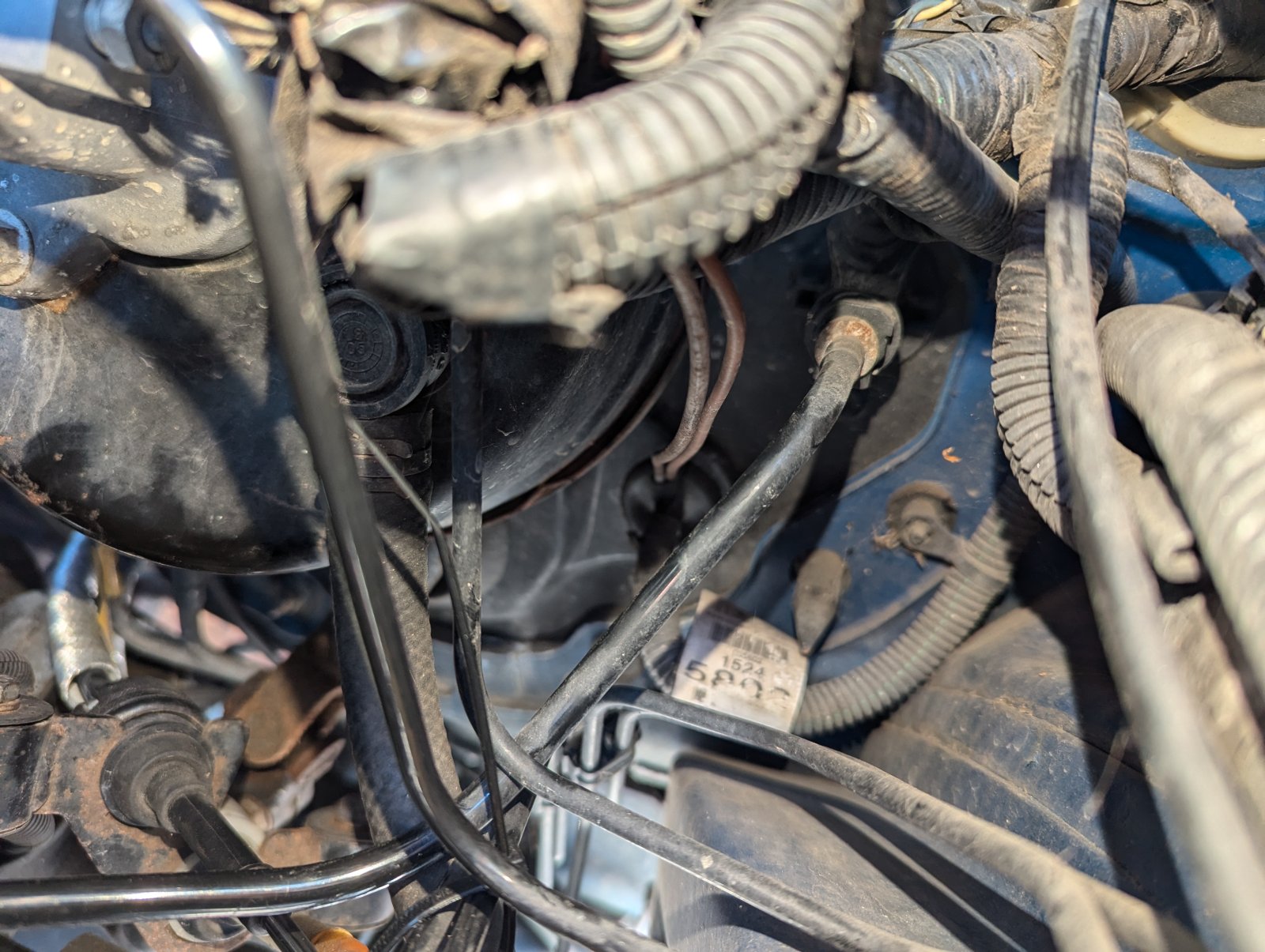

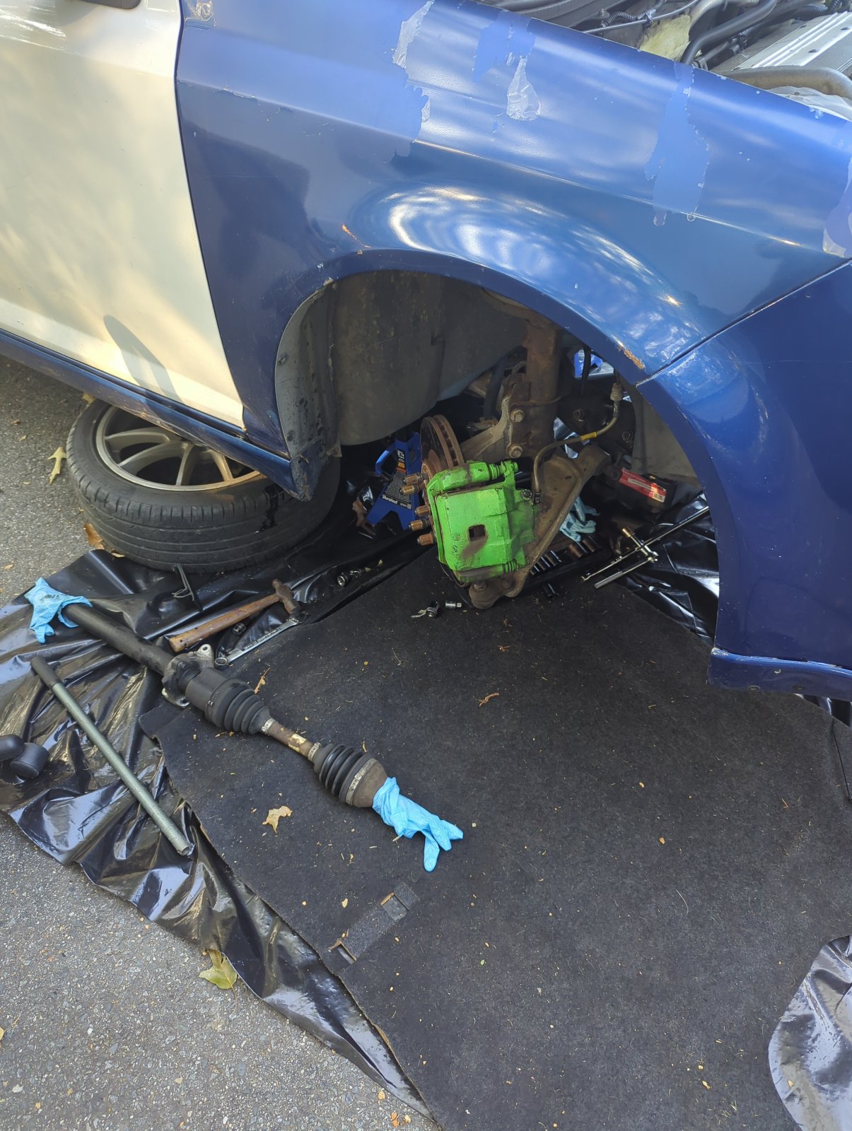

Some more pictures of disassembly

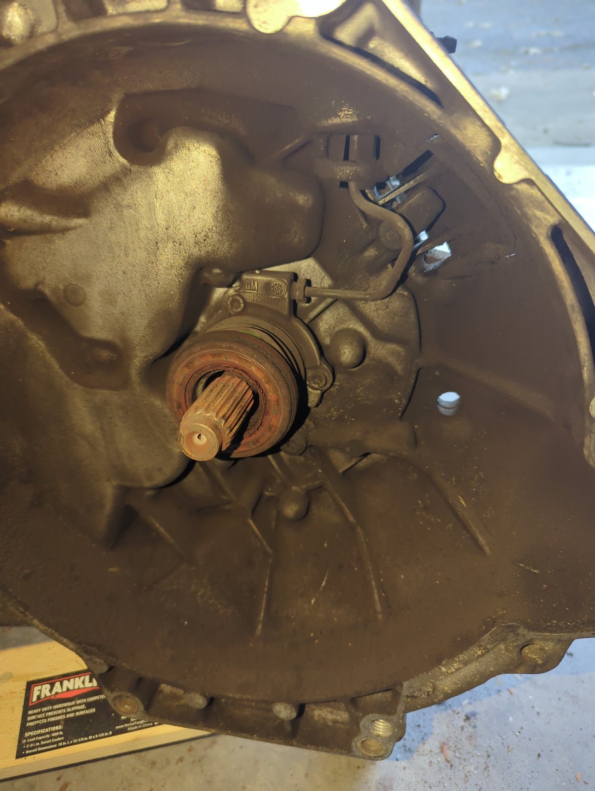

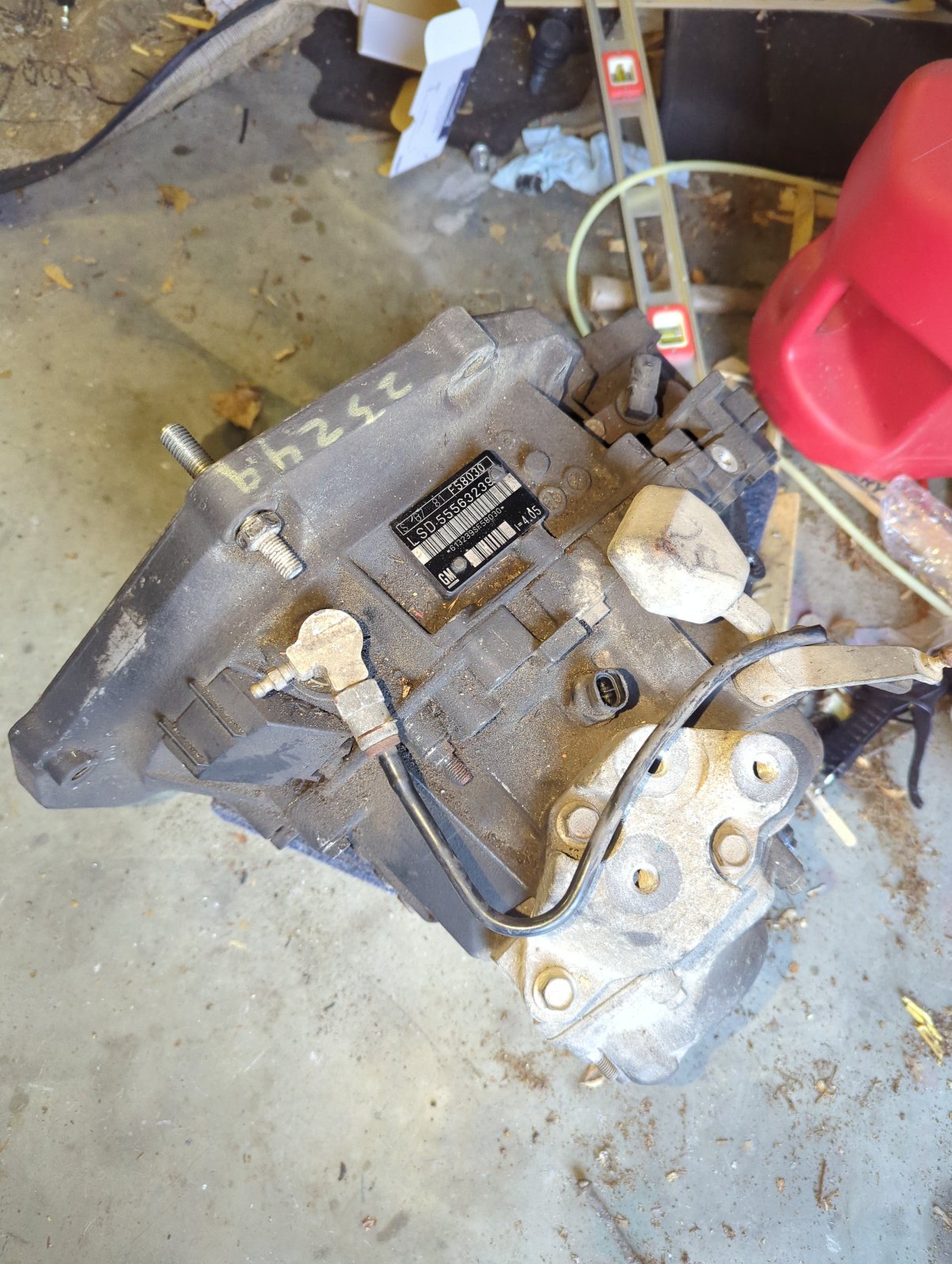

Replacement transmission

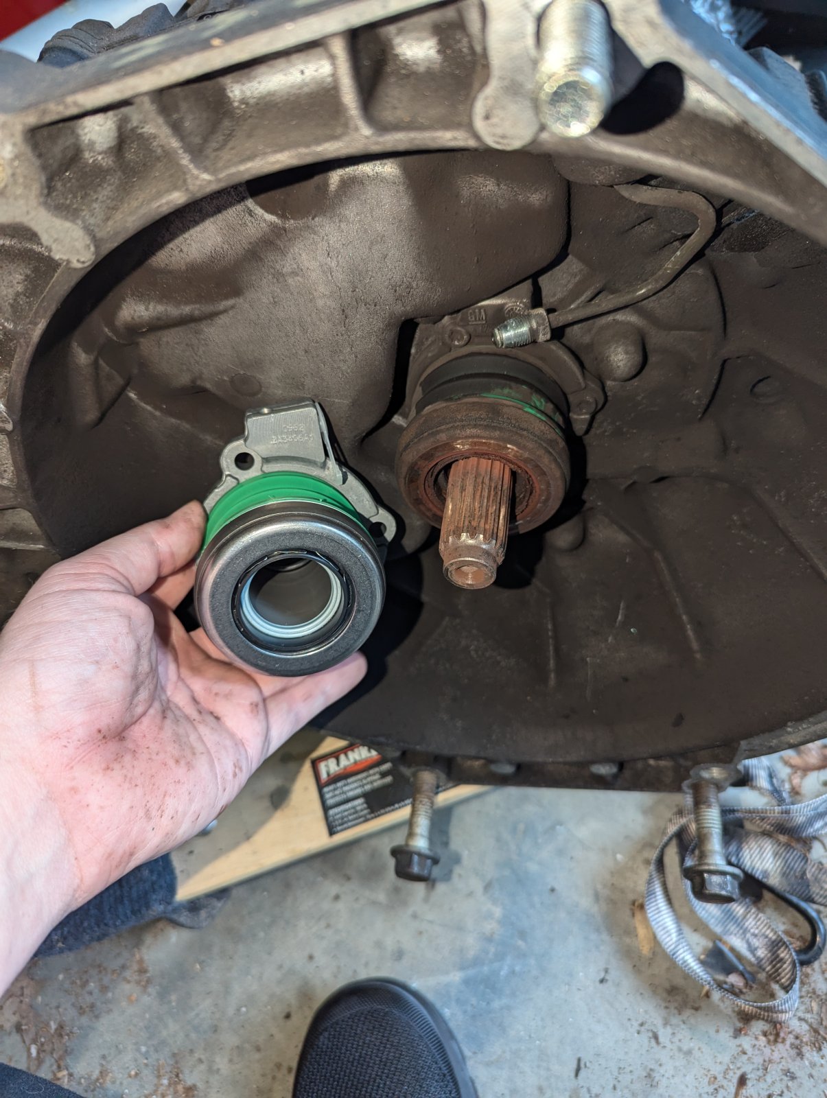

Was thinking about replacing the clutch slave cylinder as a might as well thing. Using the one in the other transmission or buying new. It may be perfectly good though. Might as well inspect the clutch too and replace if needed. If there is a way to test it out of the car that'd be cool.

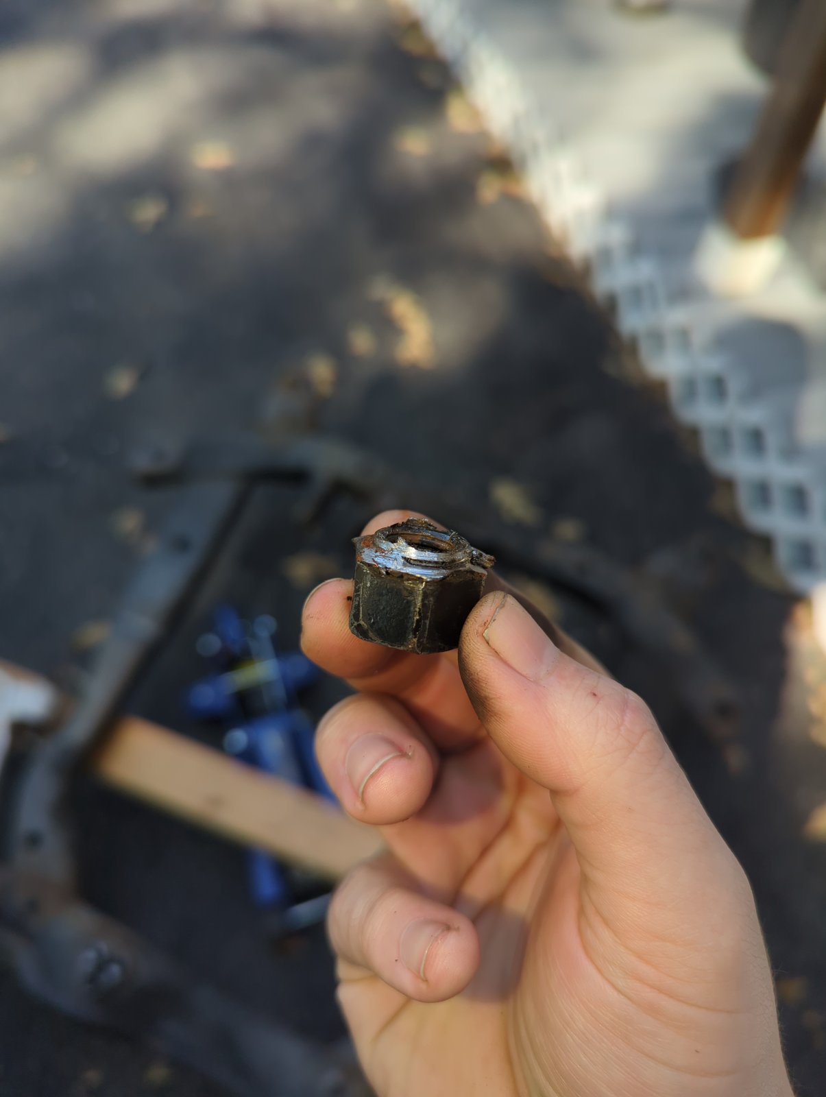

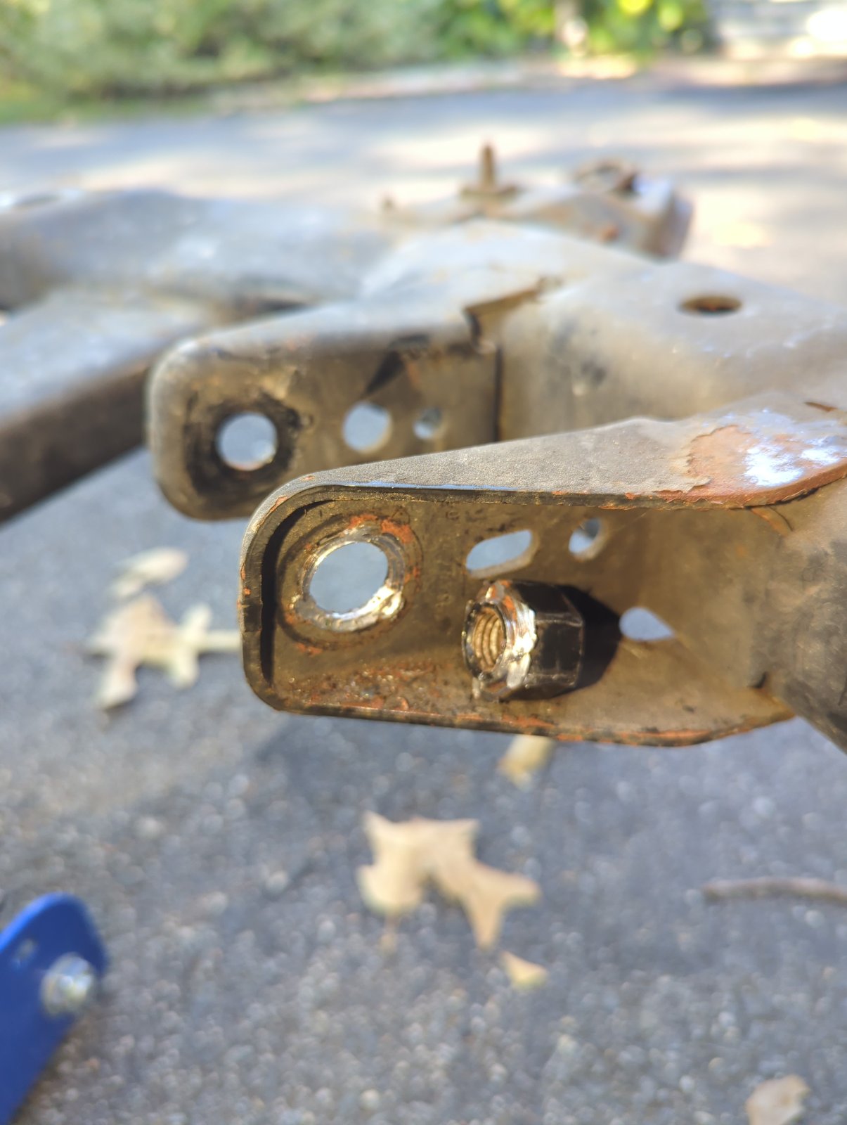

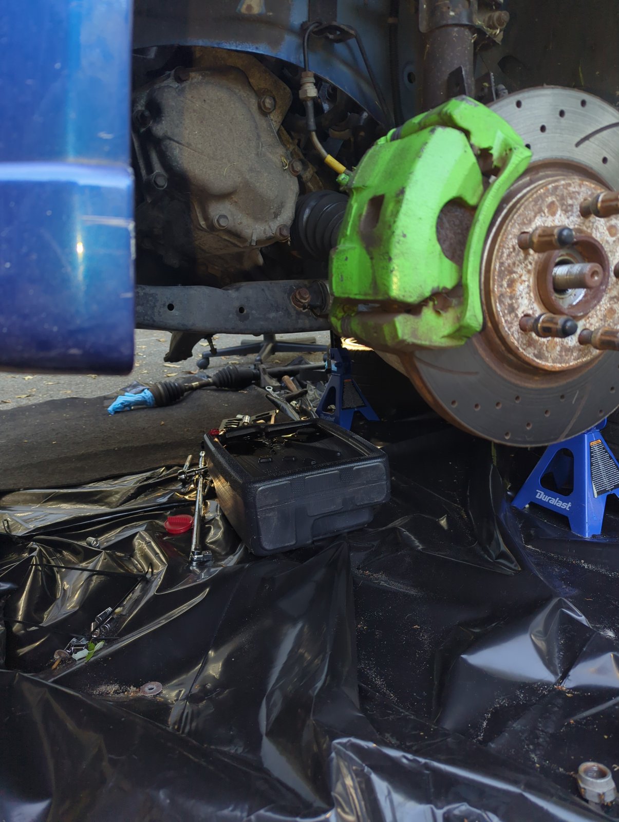

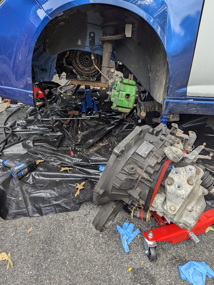

Its finally out.
53856

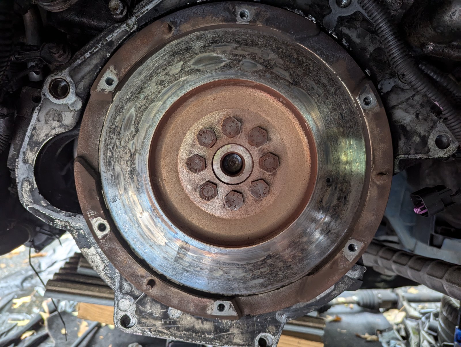

Since its out I might as well order a new clutch kit (Flywheel, flywheel bolts, clutch, clutch plate, slave cylinder). I was told by the previous owner that this clutch may be factory. I've yet to look at it since I am done for the day and the next two days is going to be raining. Next time I will make note to position the transmission jack at a better spot and possibly makeshift something out of wood to make it easier to slide in the donor trans. If I find out that the donor is bad I am going to cry and or explode.
Fenix Nexen

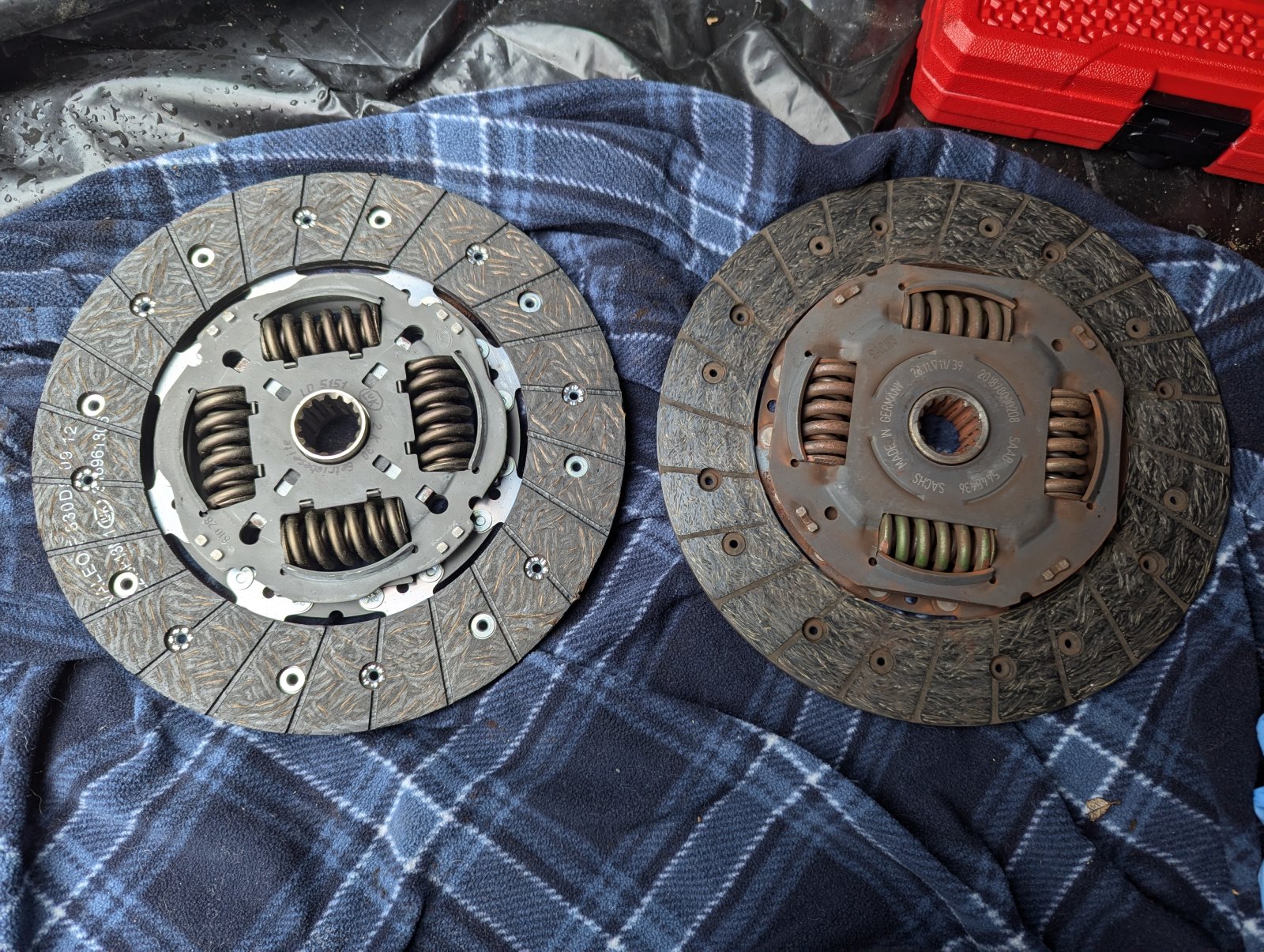

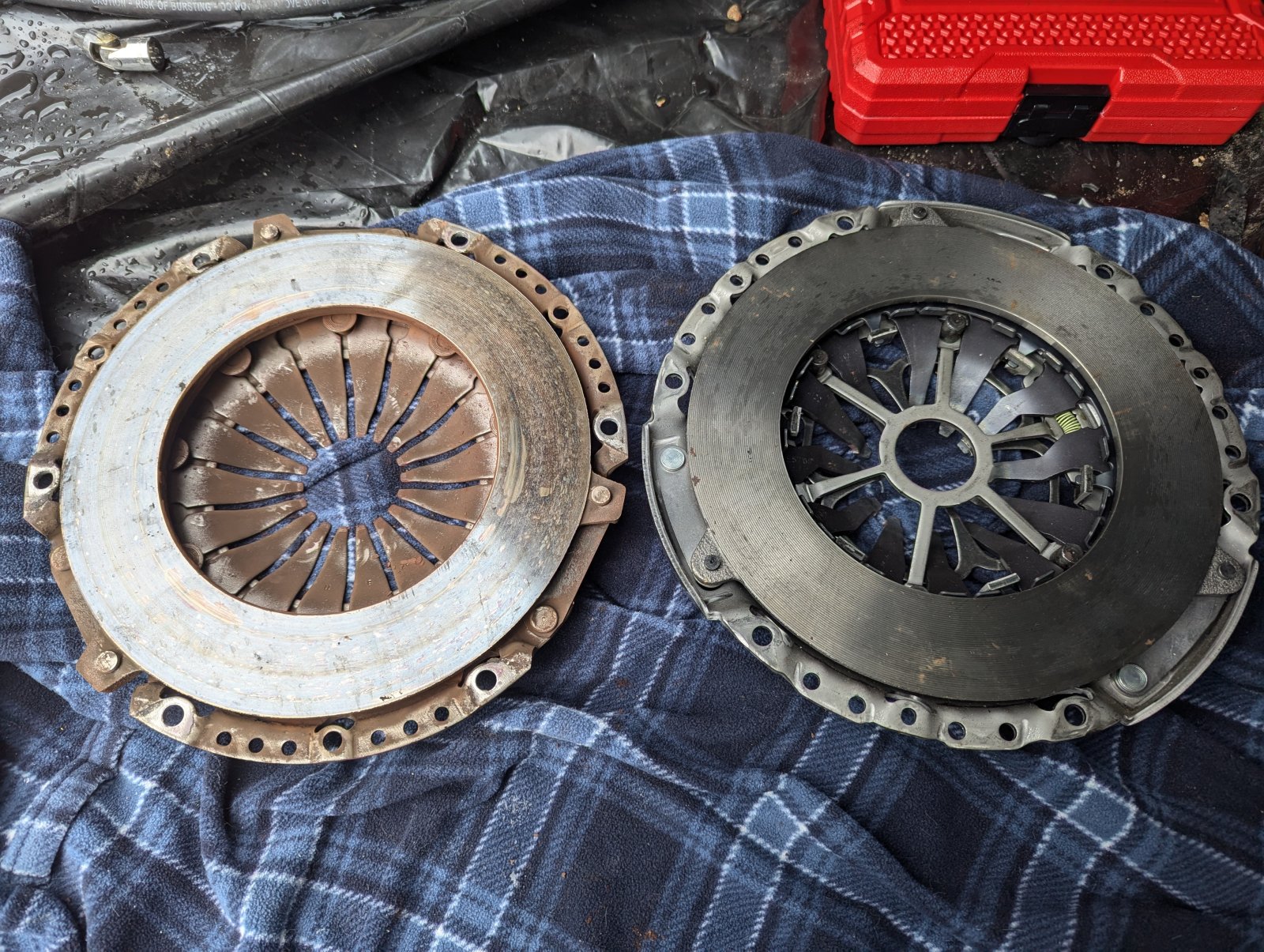

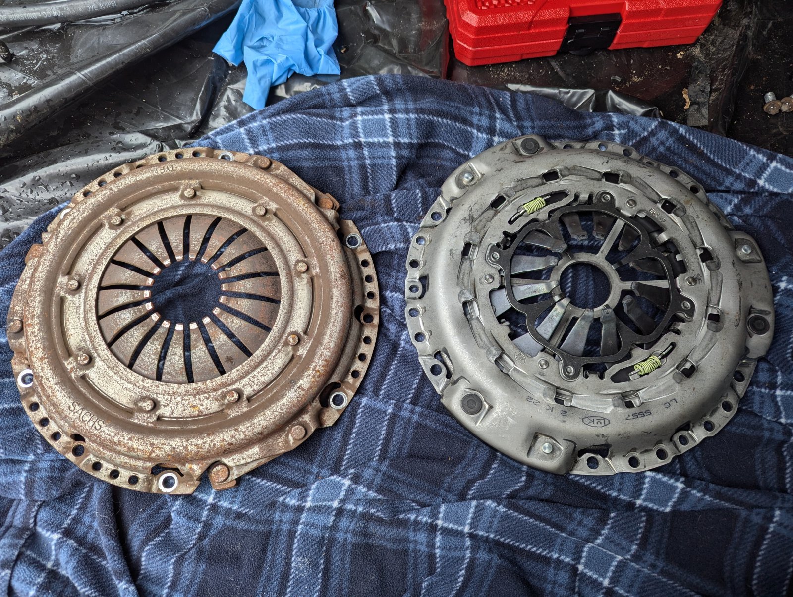

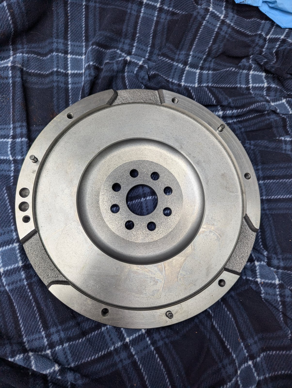

Progress in between rain, here is the old vs new clutch parts. Since this is my first time replacing a clutch I don't know if the old looks good for 175k miles assuming this is the factory clutch. It's neat to see SAAB on this. PXL_20250917_202040561.jpgPXL_20250917_202126494.jpgPXL_20250917_202520587.jpgPXL_20250917_202628578.jpgPXL_20250917_202531811.jpgPXL_20250917_202747236.jpgPXL_20250917_202926847.jpg
