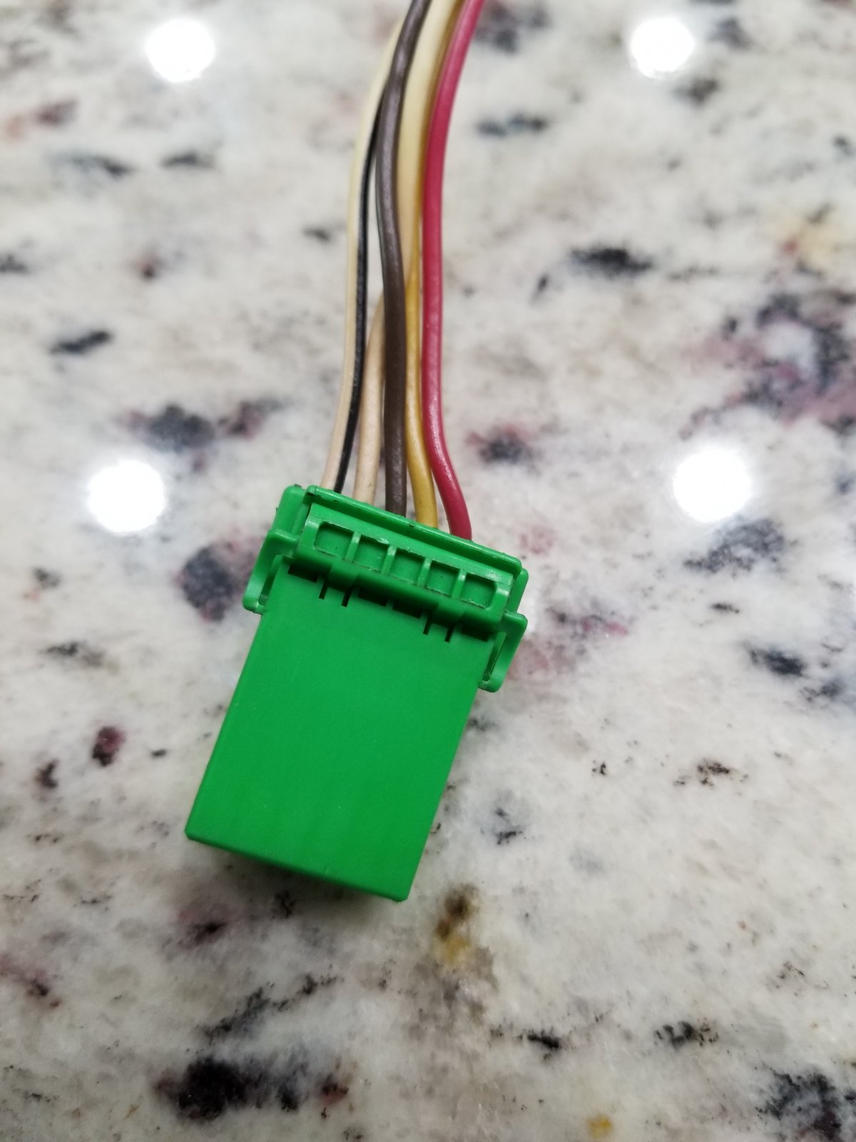

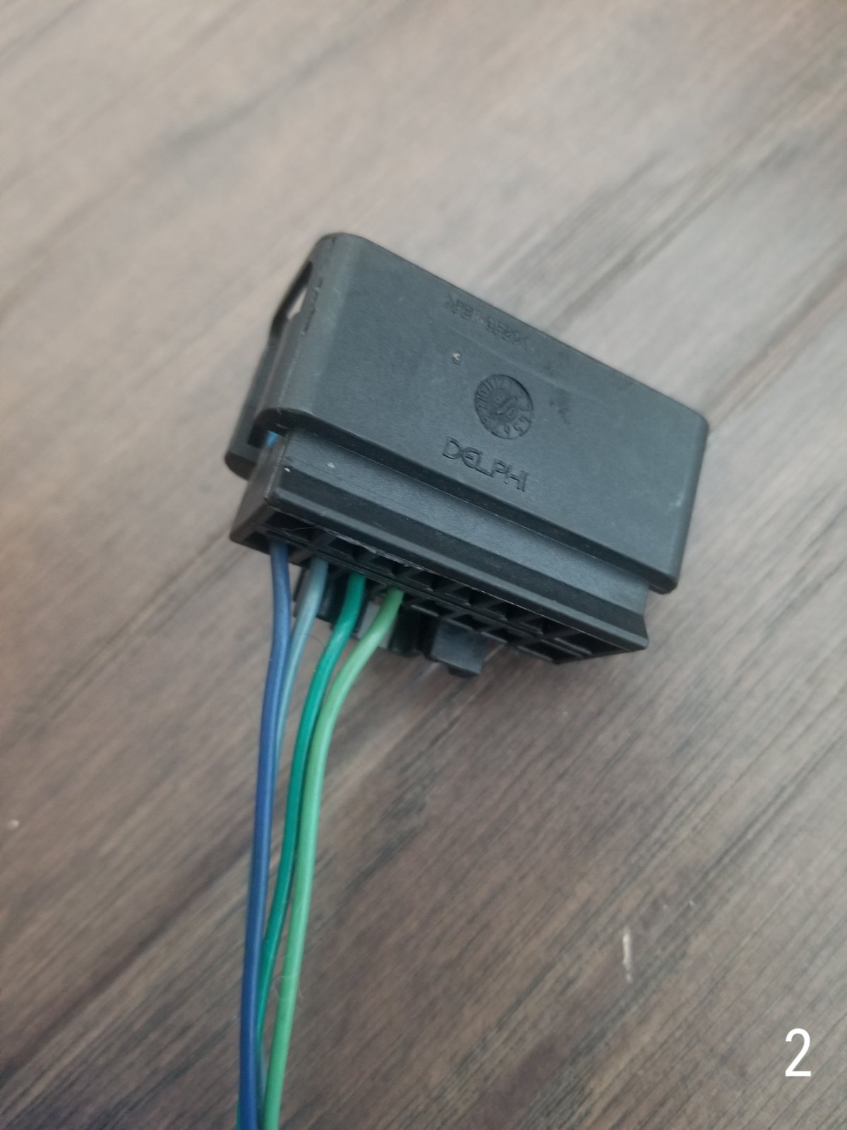

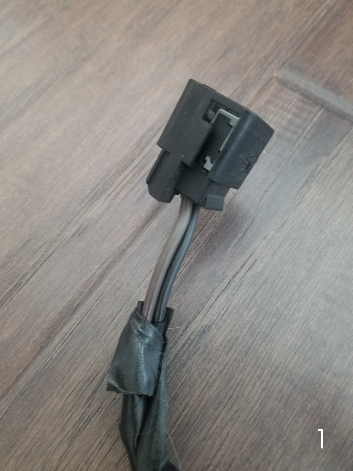

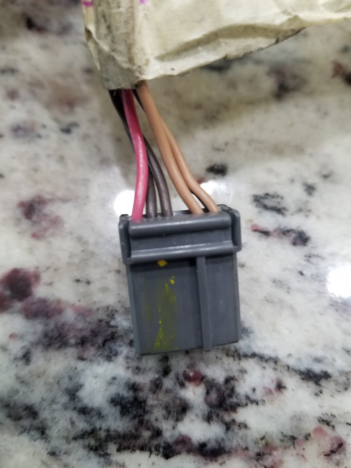

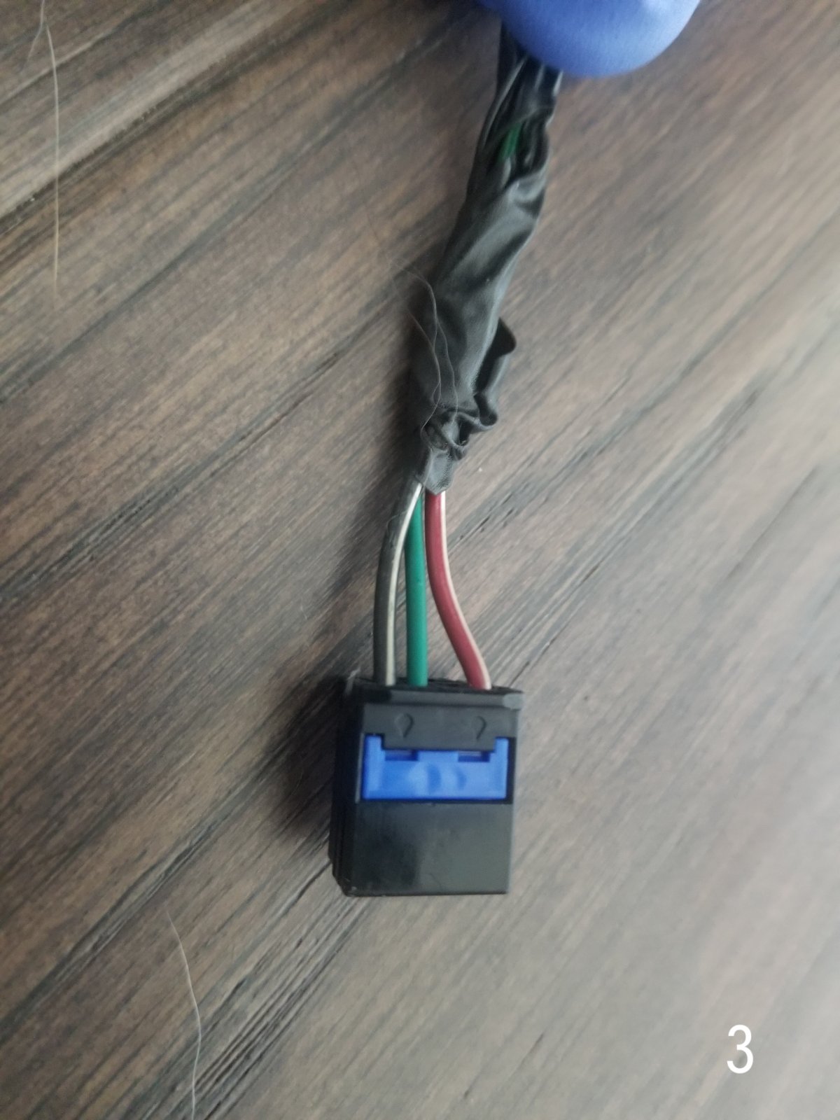

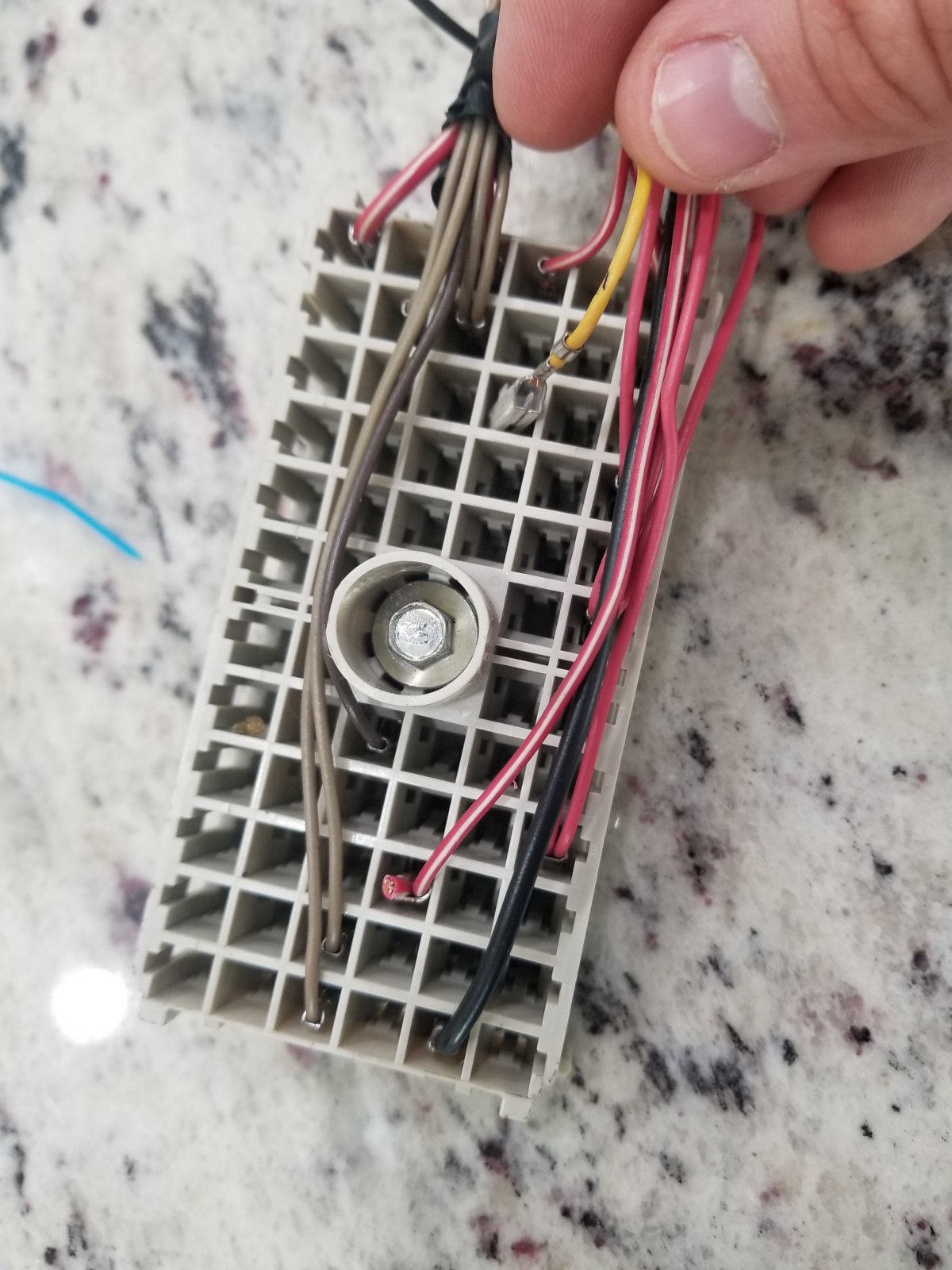

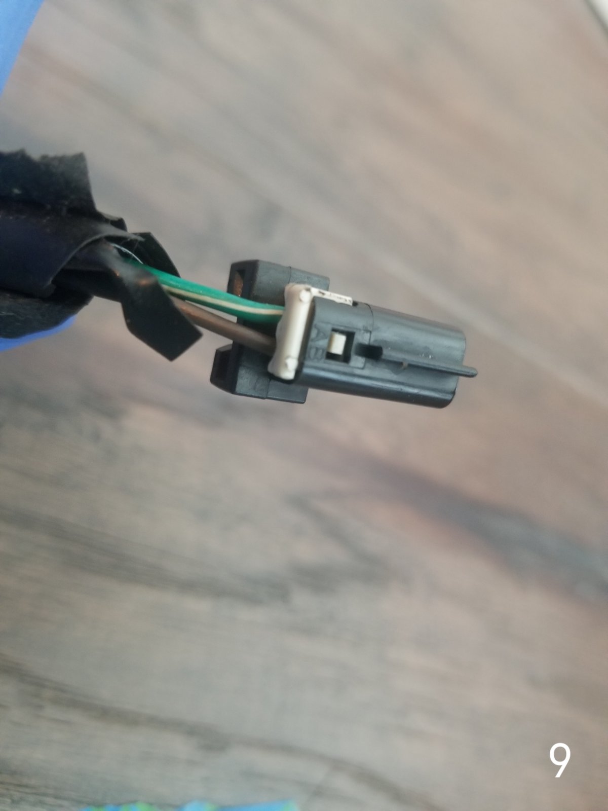

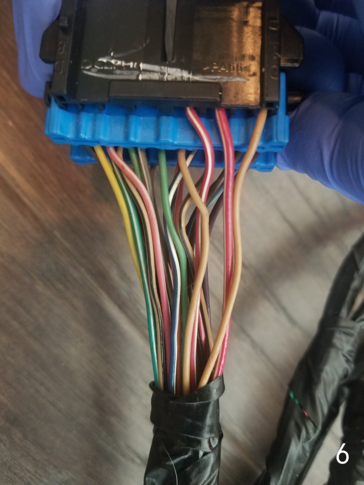

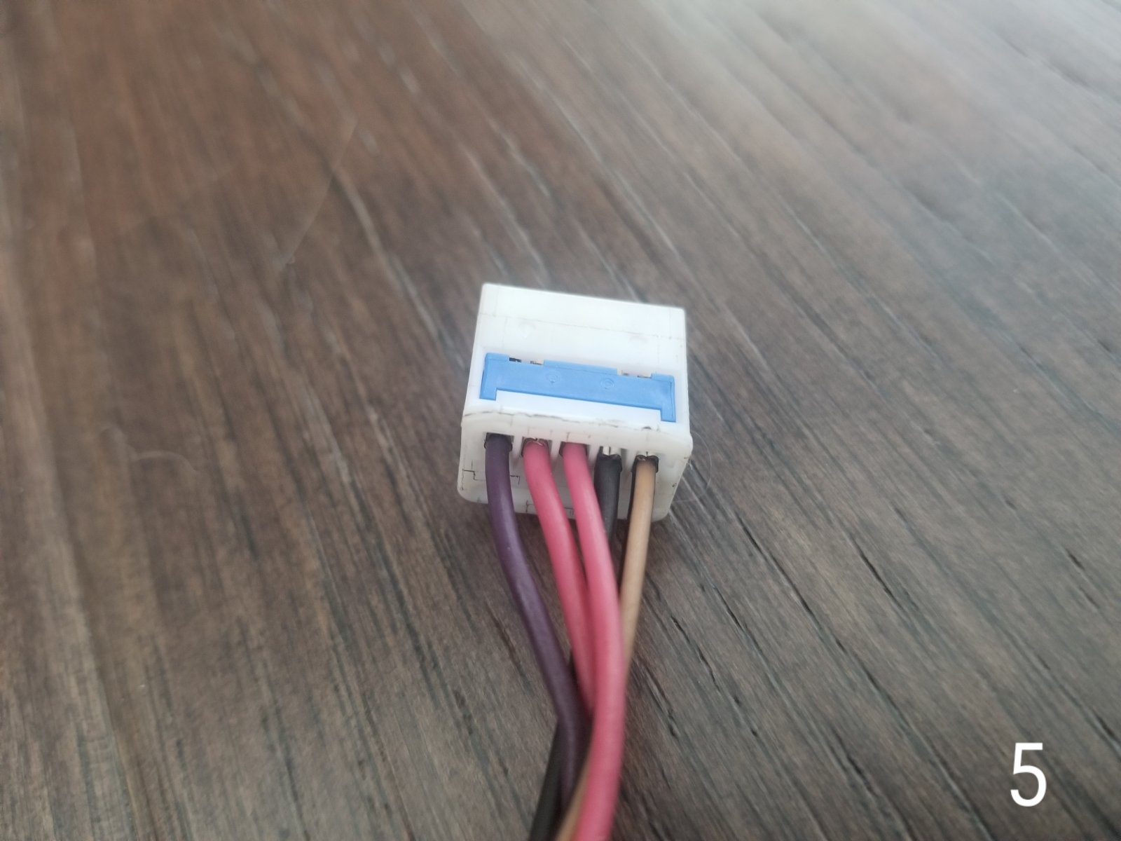

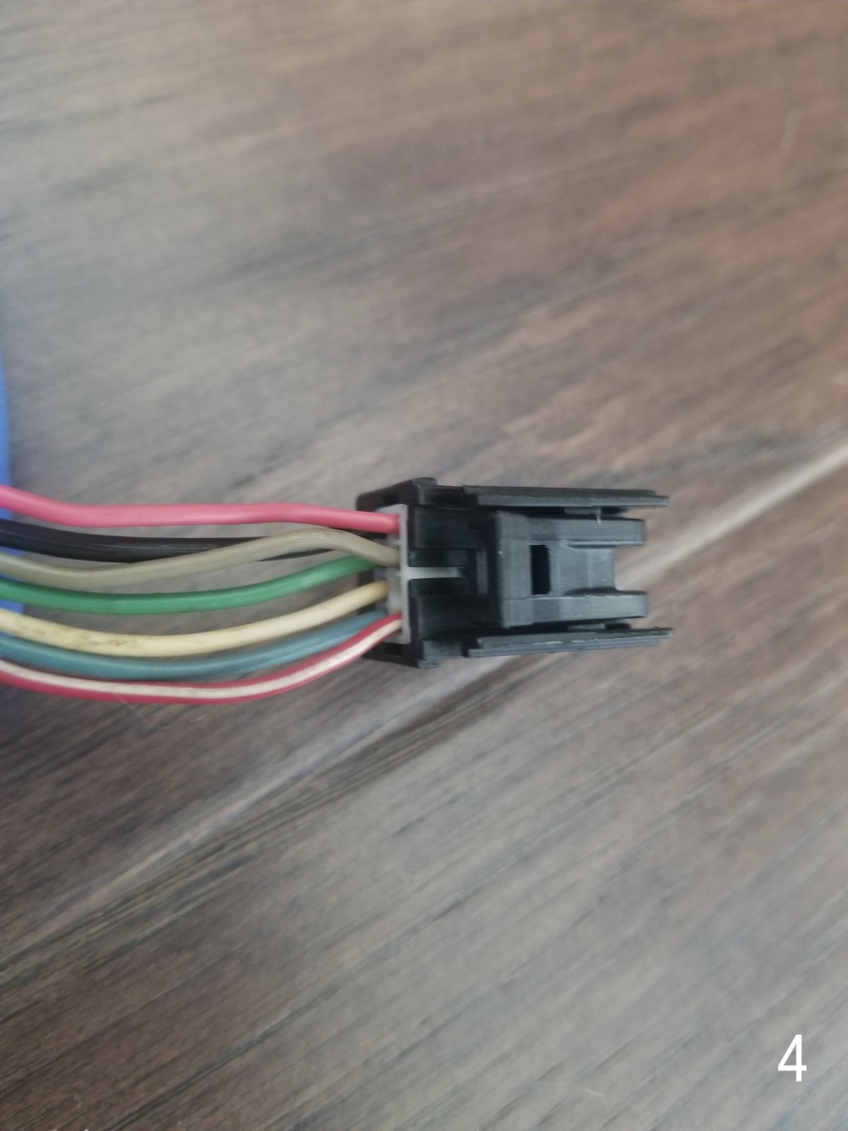

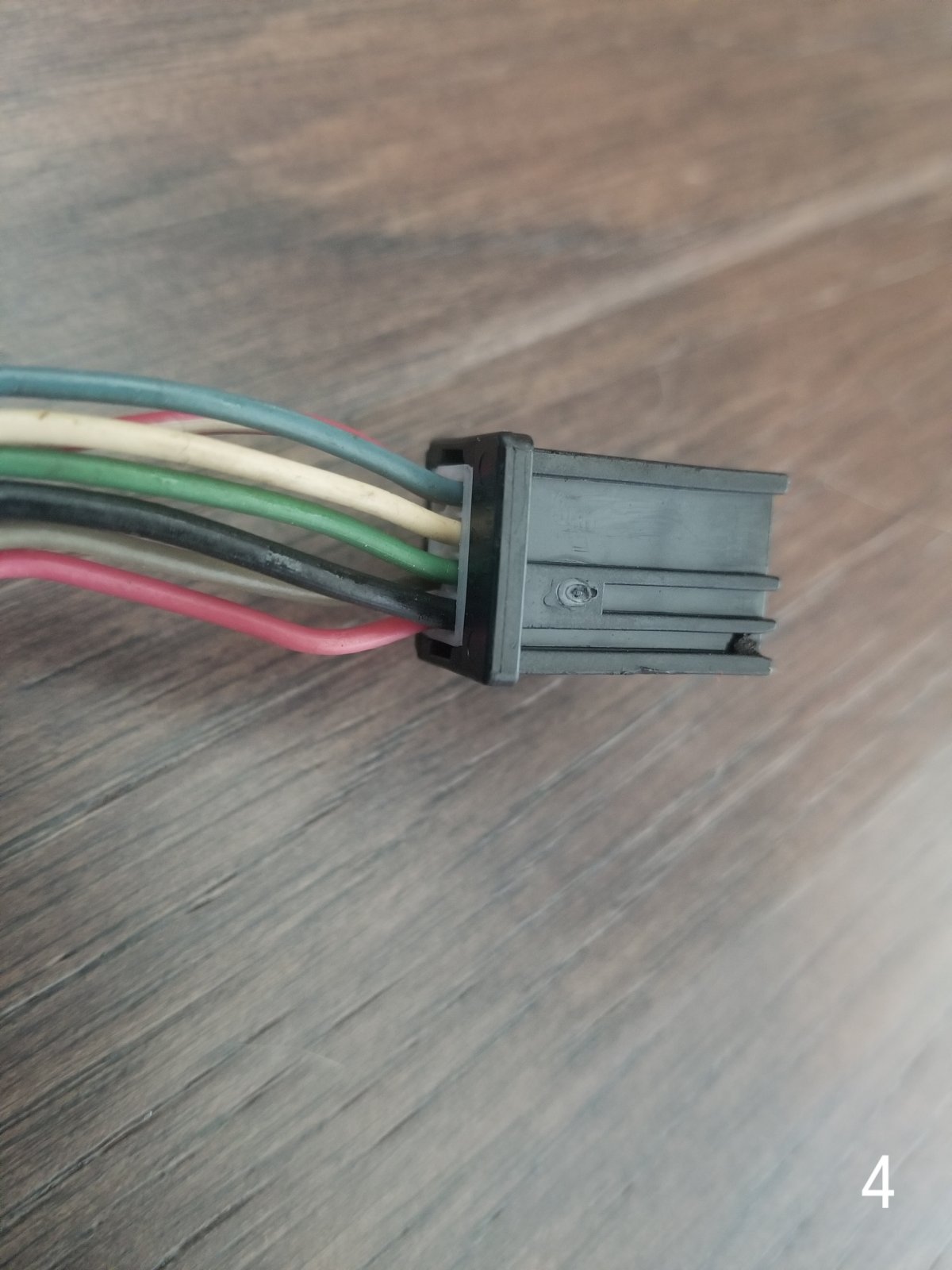

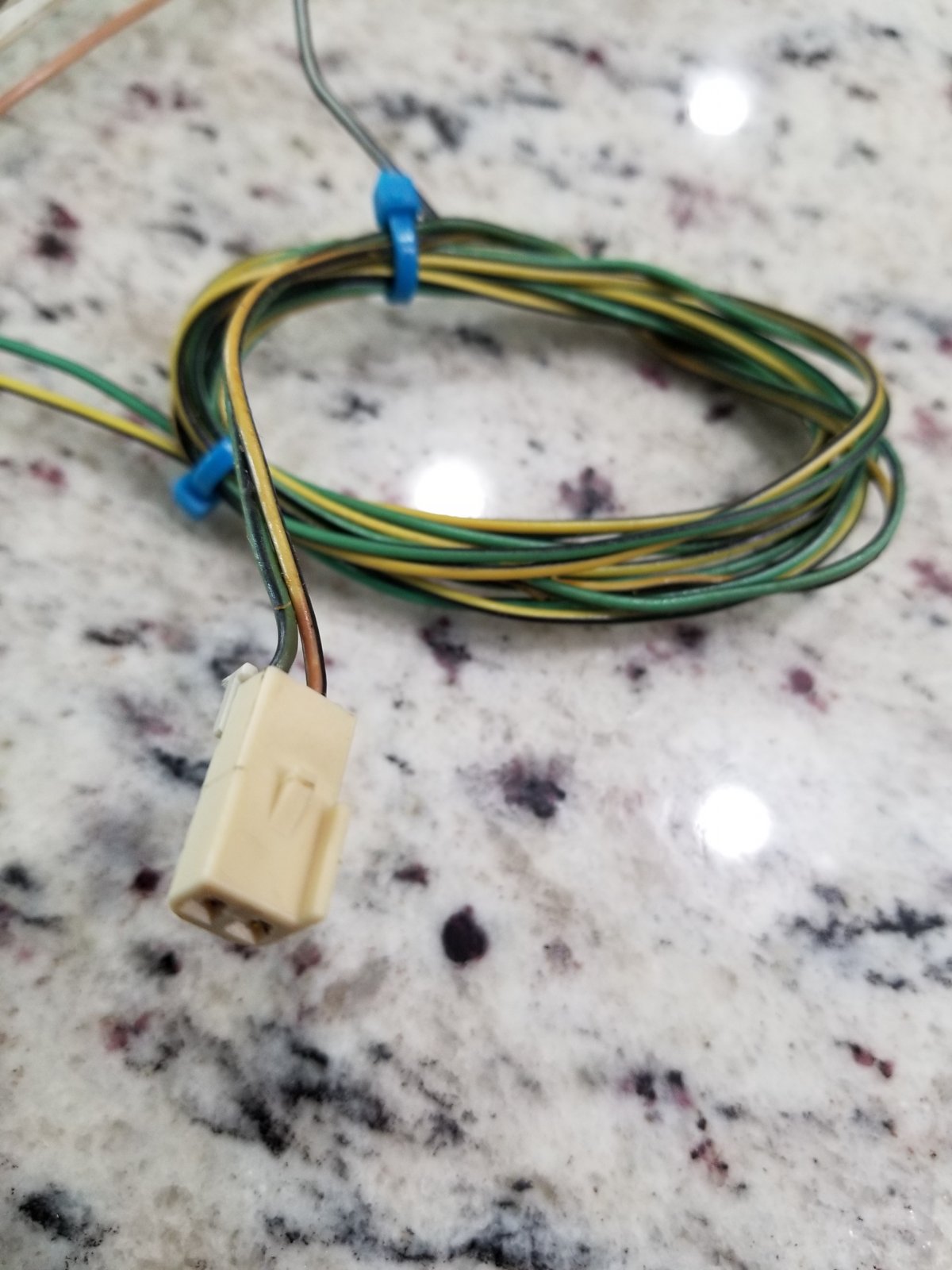

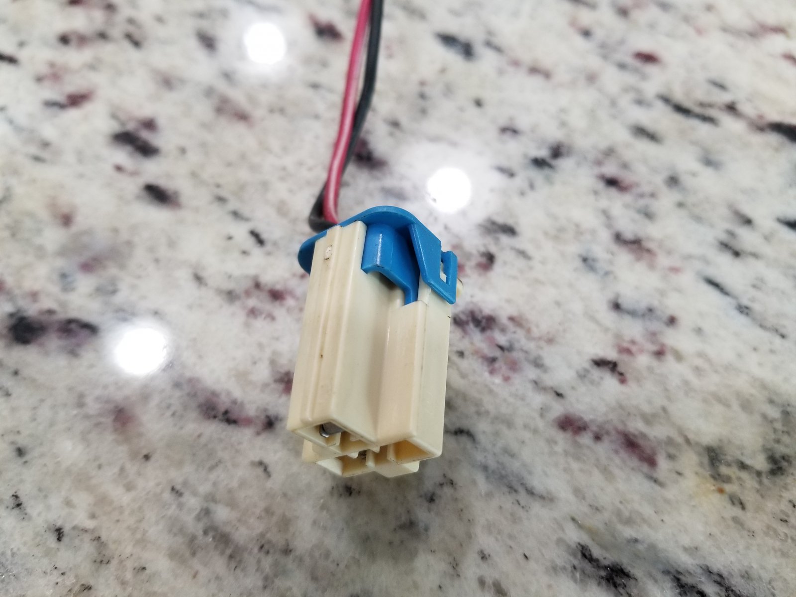

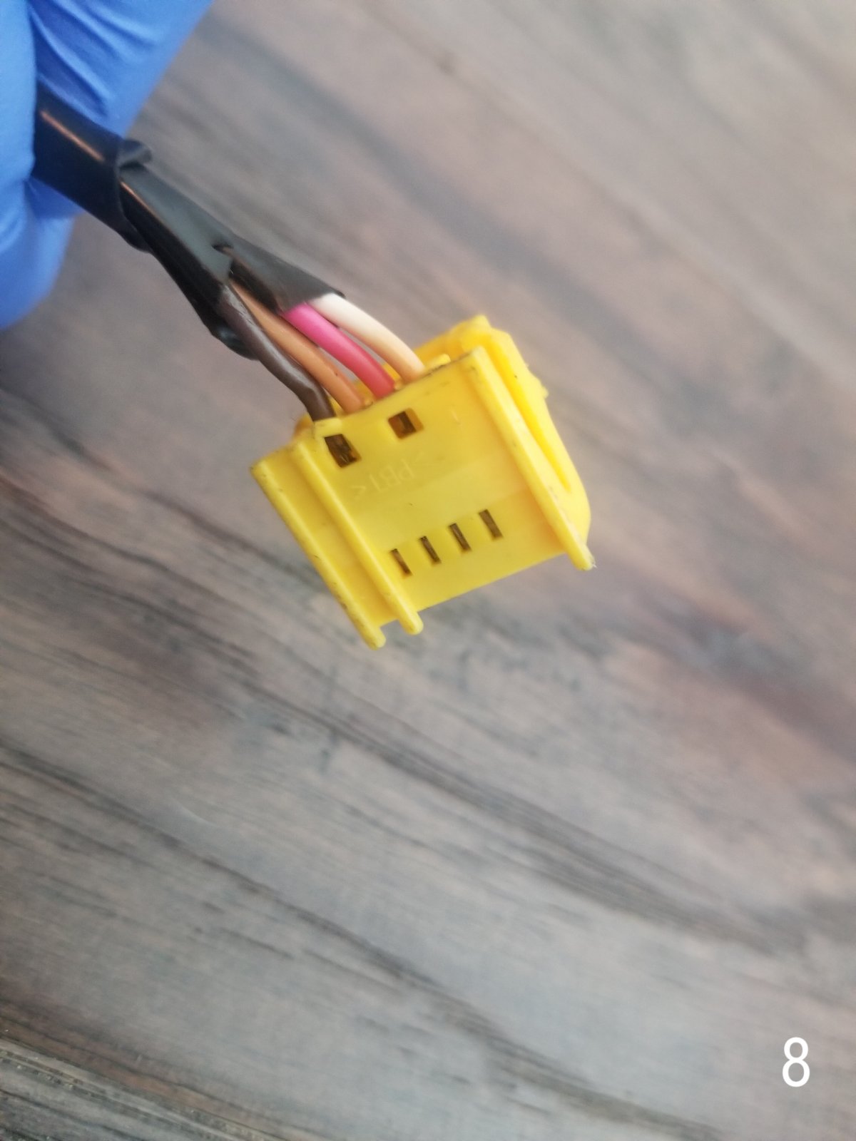

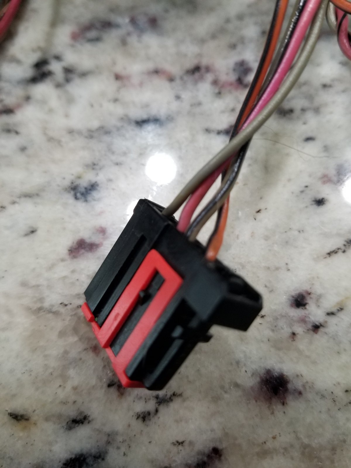

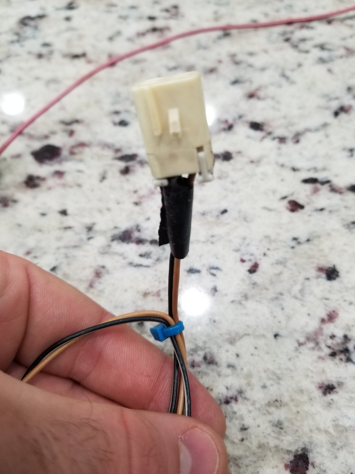

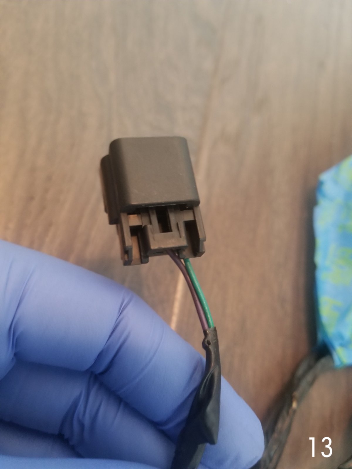

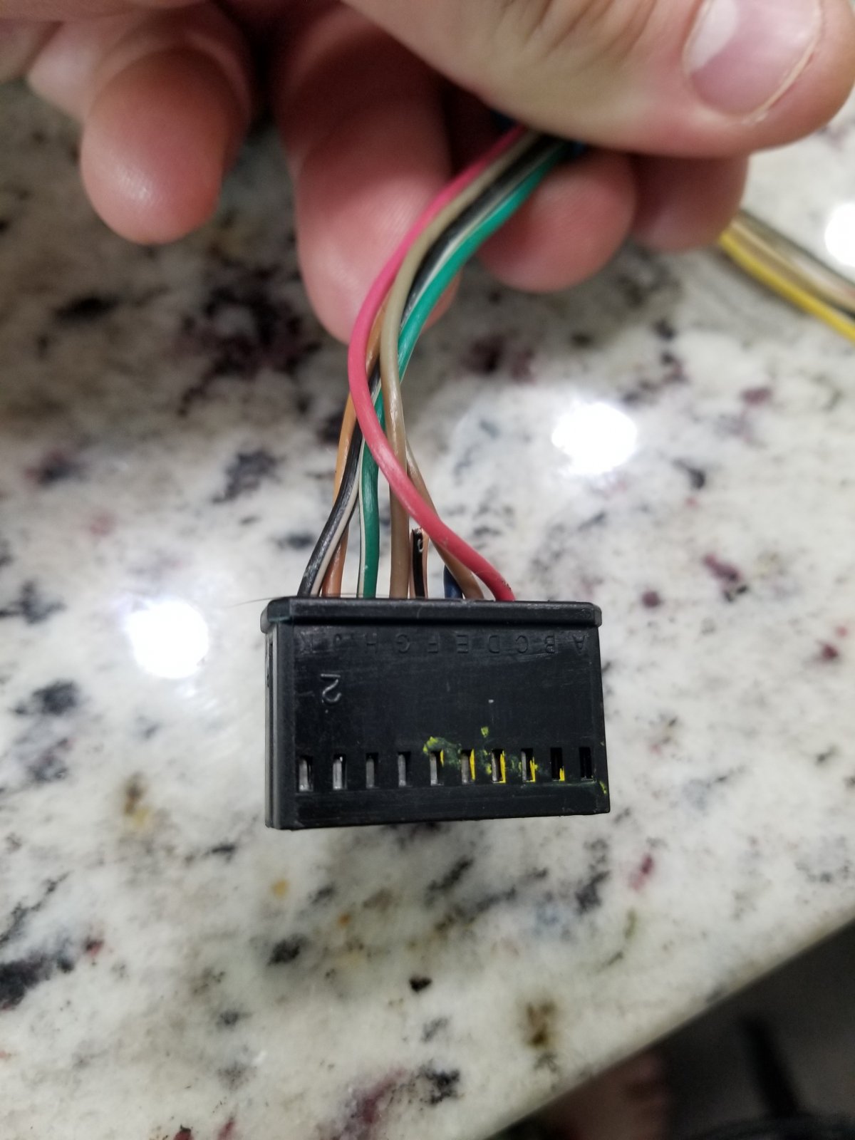

Attached are some of my unknowns, could I get some help to identify them?

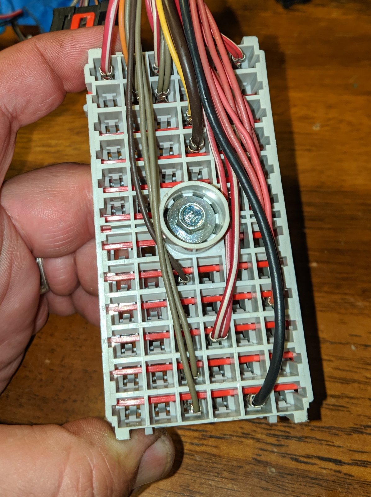

Secondly, In trying to clean up the wires I'm removing some from their connectors and rerouting them due to the rata nest created by storing the harness after unraveling it. Before I could label the single yellow body harness wore to the white multiplug with all the red wires, I lots it's place. I know it's 3rd down from the top but I can't remember which row it's in.
Lastly in the excitement of cutting wires I mistakenly cut the turn signal stalk instead of the wipers stalk. I got the majority of the wires soldered back together but the flatter connector's Red/White wire's endpoint is a mystery to me.

RouteAbel
I have a '10 turbo that I am about to start dash disassemble. I'll try to get you pictures of those connector locations.
RouteAbel
1. Not sure
2. Trunk Release
3. Steering controls
4. Ignition Switch
5. Not sure but it is near the turn signal
6. Light sensor
7. Not sure
8. Cig lighter
I'm not sure I understand your other question.

Okay so my replacement harness from eBay doesn't look to have the RPD plug, but I think it has the sweeping style boost gauge plug.
Can someone confirm? Also, if this is my case can I use a non-digital style gauge instead? I know the car won't start without the RPD plugged in but if it has a sweeping style instead will it be ok? Should I swap over the wires entirely?

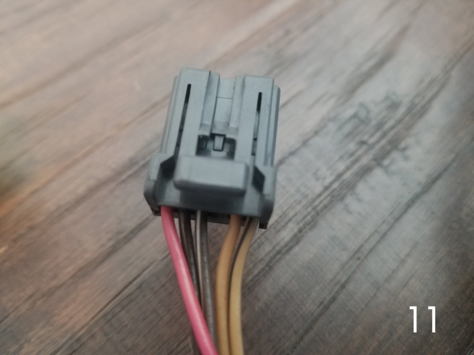

Your image shows a power steering connector
The reason a cobalt or Goblin will not start without the RPD plugged in is because it brakes the data wire chain. You should be able to use the RPD plug from your old dash harness with your new harness. You just need to make sure the data wire chain goes through it.
The data wire chain goes into and back out of several things like the power steering, BCM and ECM. You just need to have the data wires go in and out of the RPD also.
It may be easier to repair your old harness. If you post some detailed images of you old harness we may be able to help guide your repair.
Mayor West
Okay, thanks Lonny! It looks like the new harness is a no different from my old one, aside from missing RPD. Im going to splice in the old harness to this one because my old harness is a rats nest now.
The part number is 25947707 which is what the GM website says is the dash harness for my 2009 turbo, guess not?

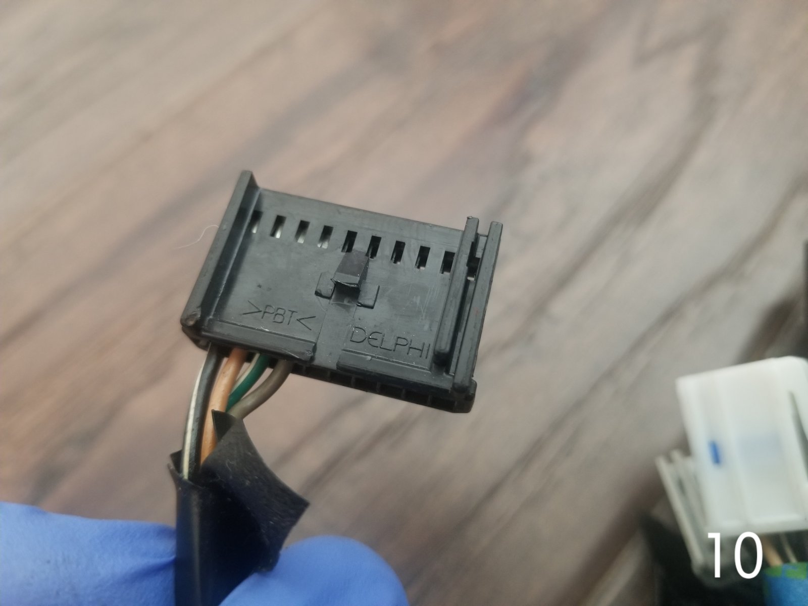

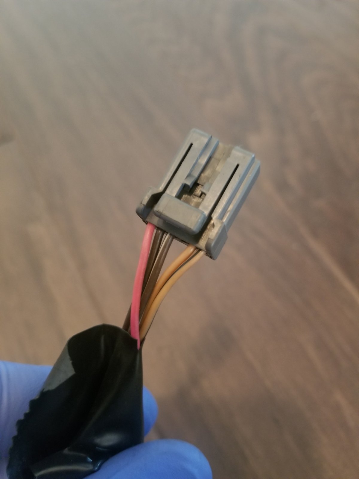

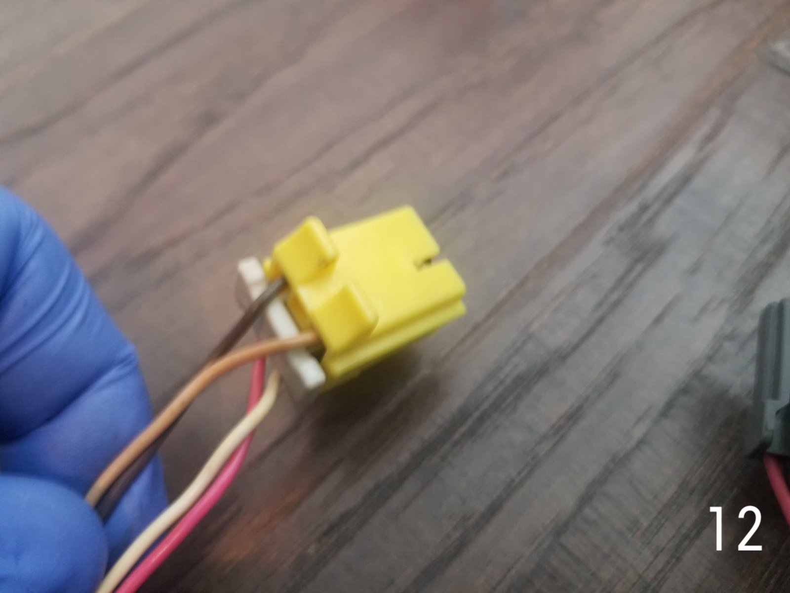

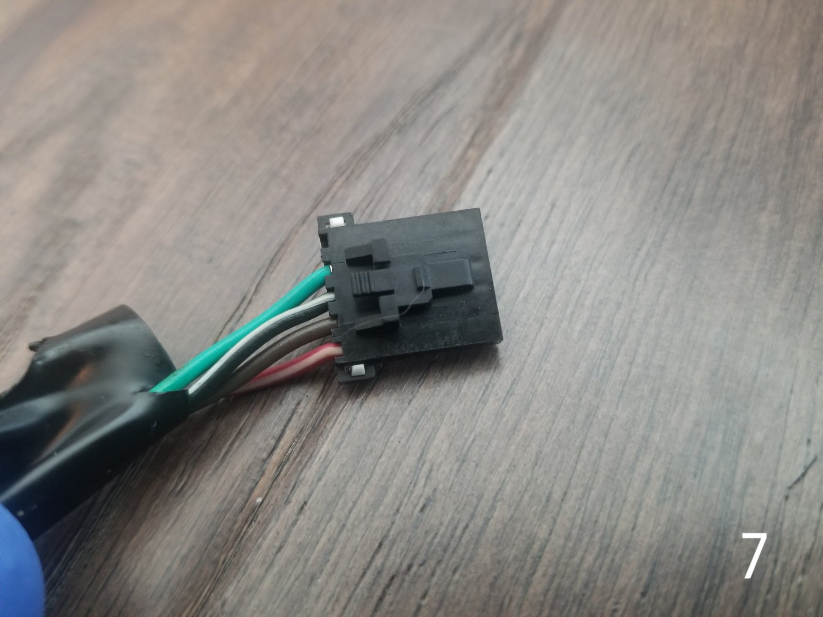

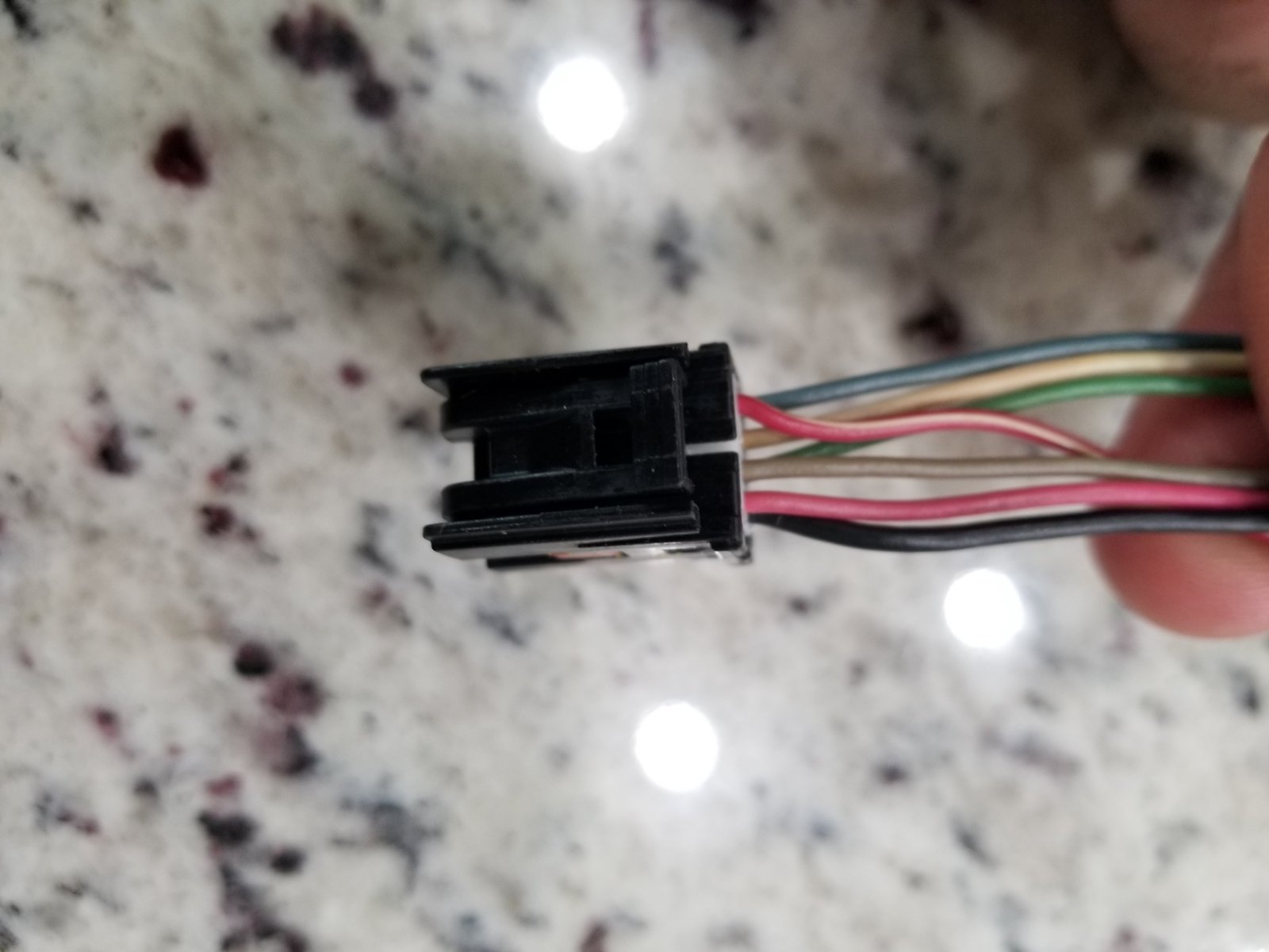

I have about 11-12 unnamed wires on the new harness, Lonny got the power steering pictured #11

The pics you posted are not from a turbo harness. They look to be from a base model automatic. I'm home for the night but I will check my books tomorrow.
#9 looks like the connector for the key lock solenoid on automatics.
#10 I think should have more wires. It should have an orange wire for fog lamps, another gray wire for cruise control and a couple of wires for radio controls.
I could be wrong though.
Mayor West
That sucks... the part number I searched said it was fine for a 2009 SS. https://www.gmpartsdirect.com/oem-parts/gm-harness-25947707
Should I bother fitting this for my kit or abandon it for something else?
My #10 turbo harness does have 2 more wires on it than the new harness has. The clutch pedal was also taped up on the loom so It's definitely an automatic harness.
The only thing I've done so far is pull the tape off and zip-tie everything so I can better see the wiring colors. If this is going to be too much trouble to make suitable for a turbo I'm going to try and see if anyone on the forums wants to buy it off me so I can source a proper turbo loom.
Starting from the first post top left.
1. X210 I/P Harness to HVAC Harness
2. ???
3. Remote Control Door Lock Receiver
4/5. ???
6. Inflatable Restraint Passenger Air Bag On/Off Indicator
7.
8. Theft Deterrent Control Module
9. Inflatable Restraint Steering Wheel Module Coil X3
10. Ignition Lock Cylinder Control Solenoid
