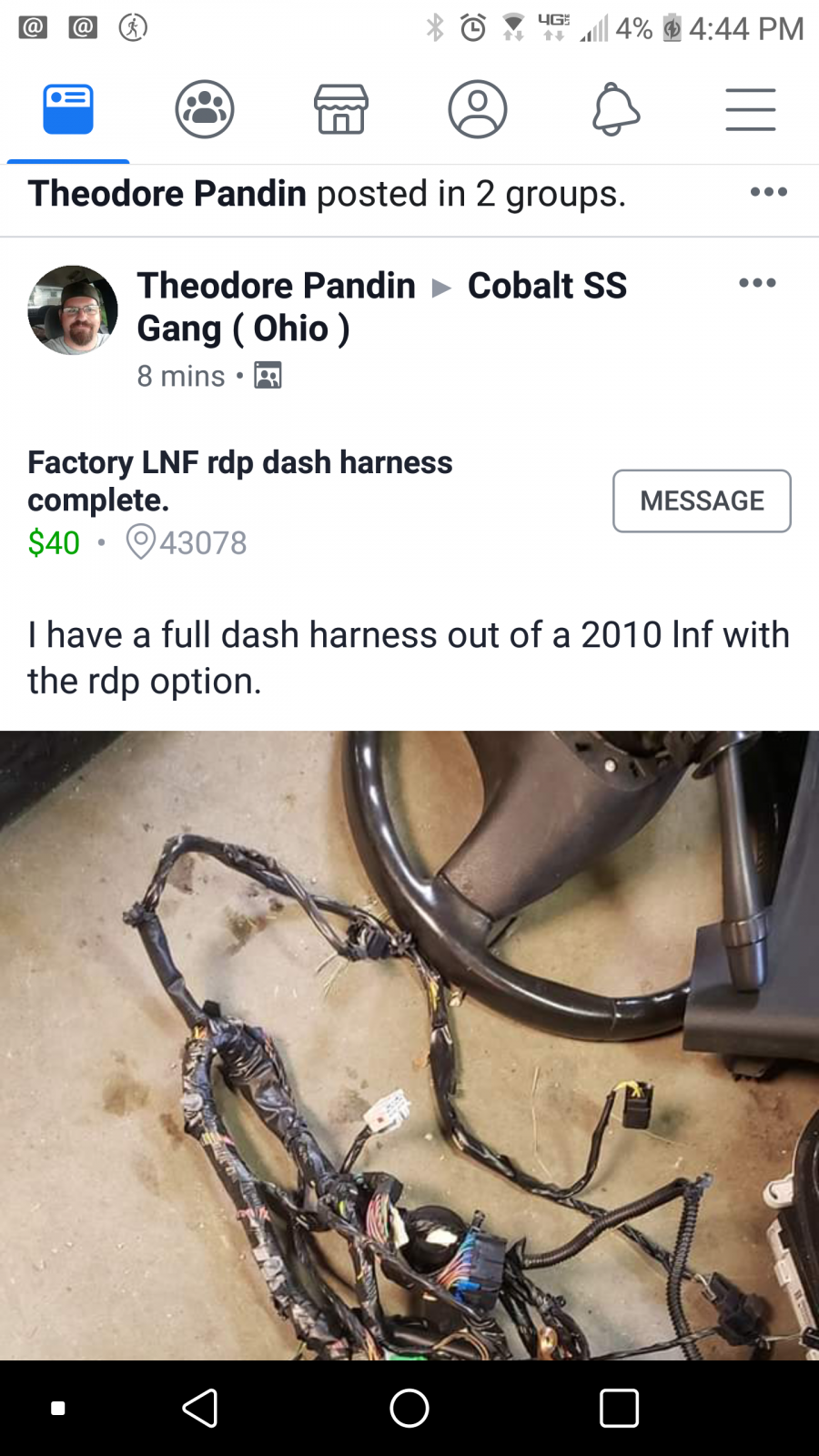

Vwsaabvt
Don't know if you needed another harness, saw this and thought someone needed an rpd harness

Mayor West
That's a great price. I'll reach out to him to see if he'll ship.
I ended up getting it from him, thanks for the heads up!
