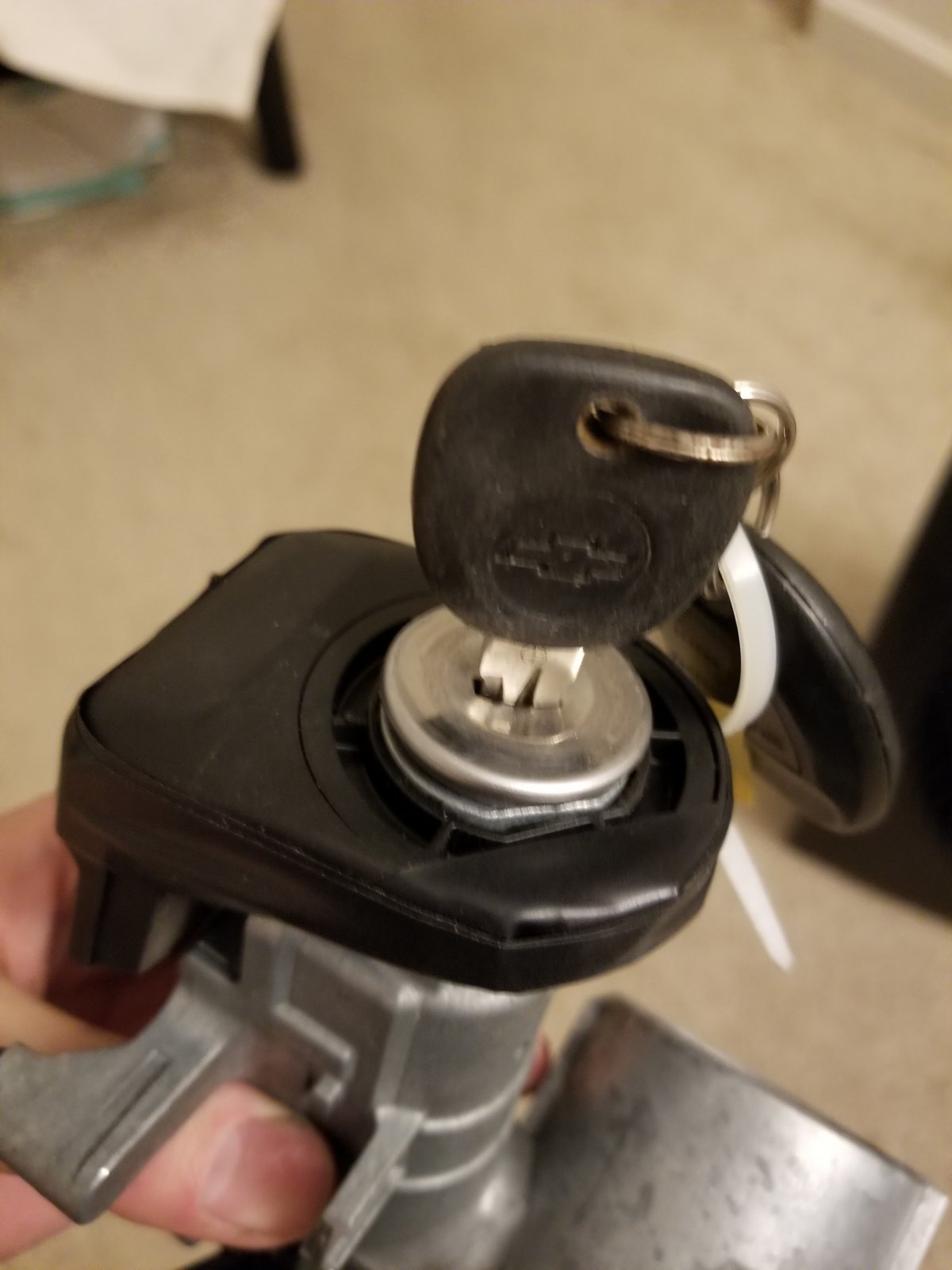

Careful the o-ring is not lost either, it can end up inside the aluminum manifold.

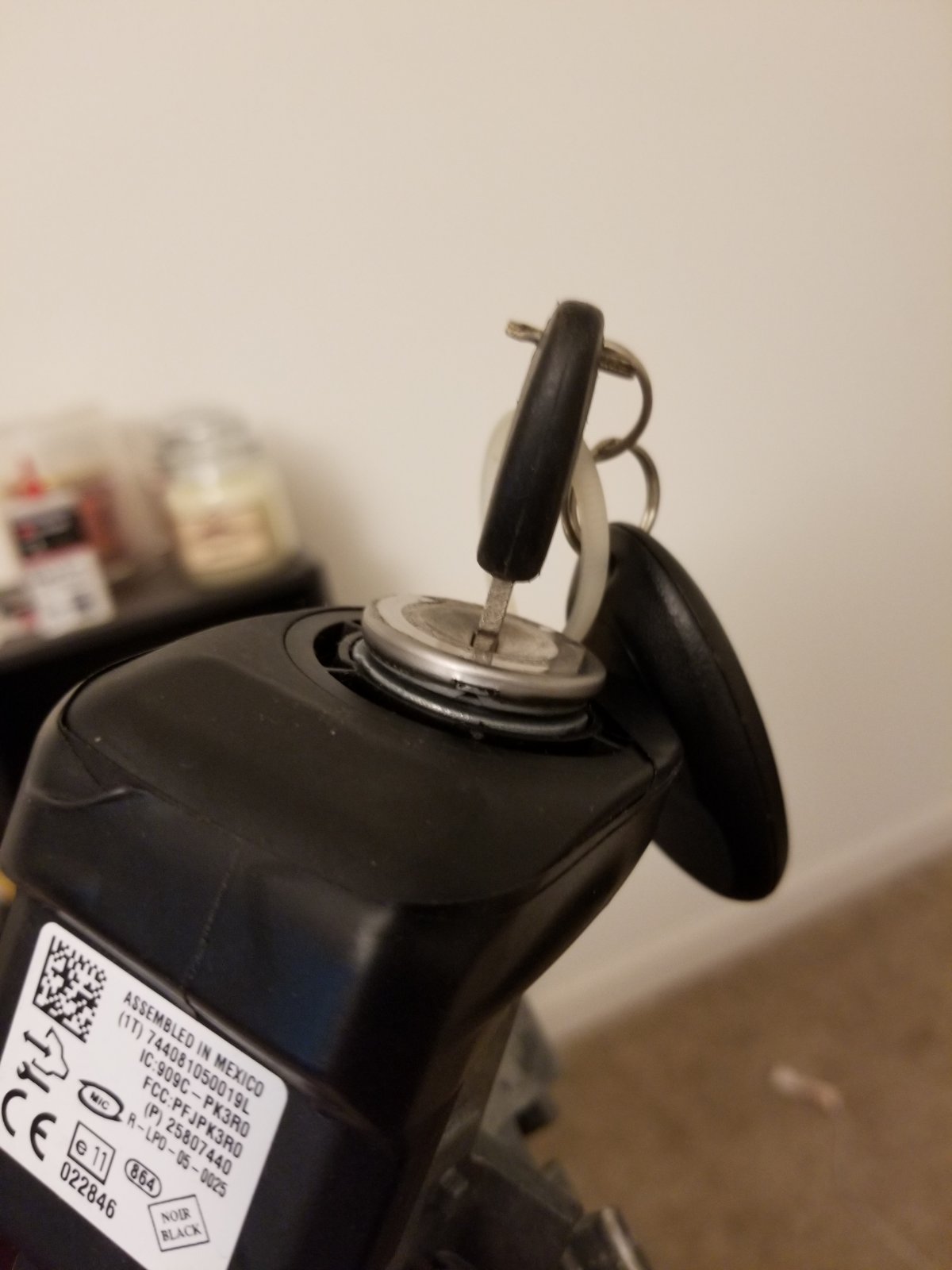

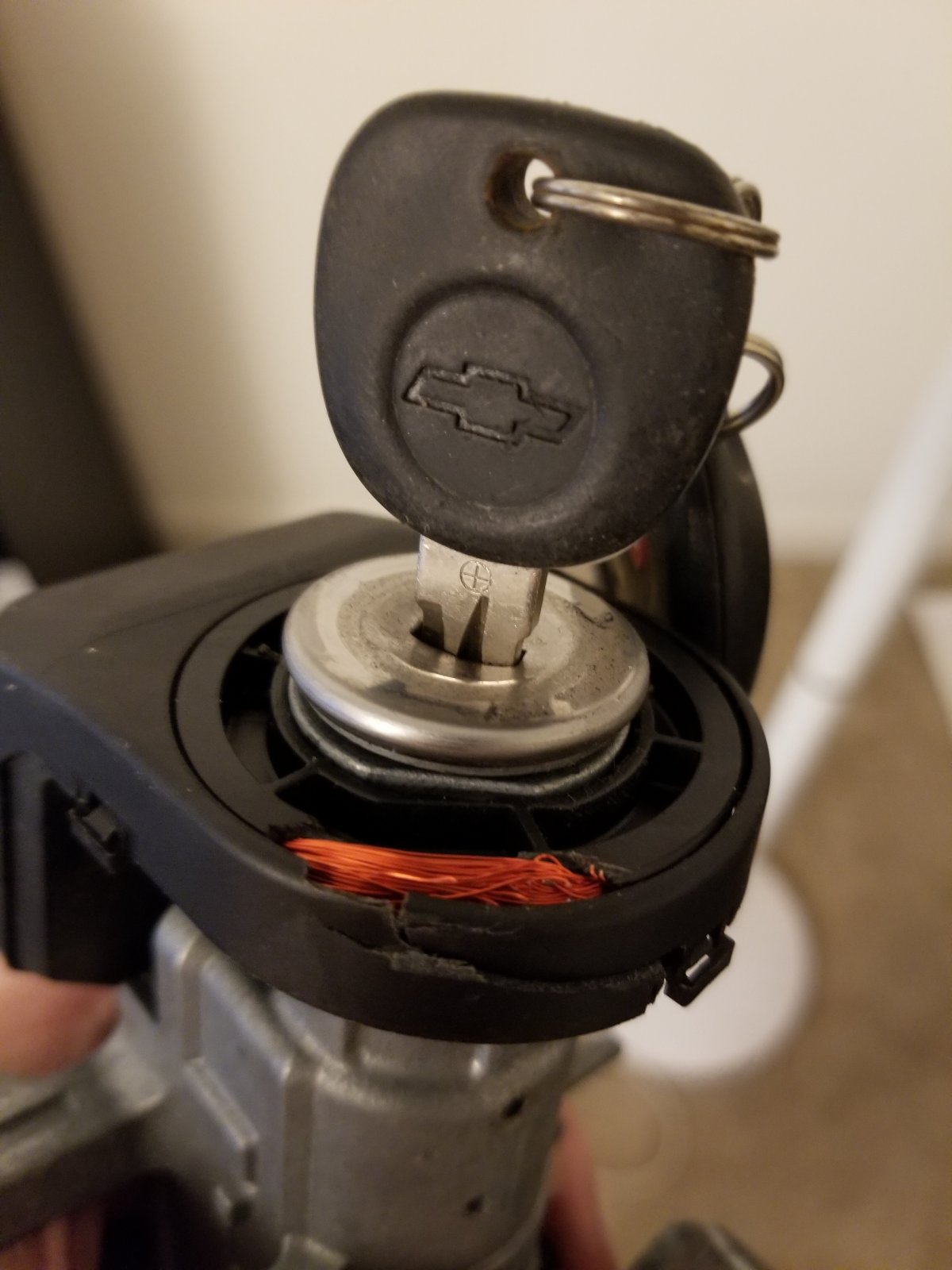

Now that I see the picture with the tape off, I may have led you astray. You'll need to order the actual anti-theft module and not the actual ignition switch. The switch won't come with the module. The nice thing about GM parts, is they usually stamp/sticker the part number right on it. GM 25807440.
