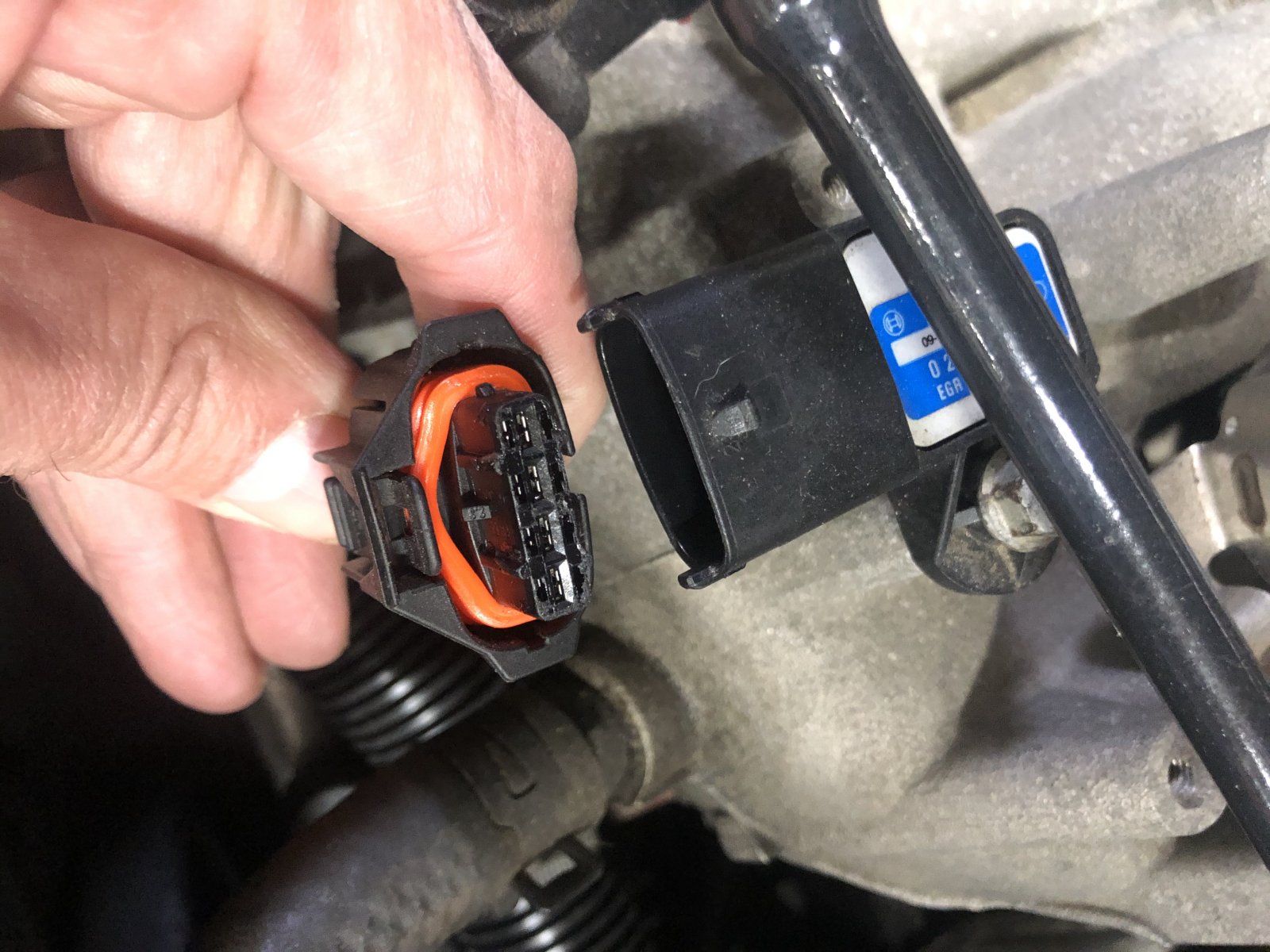

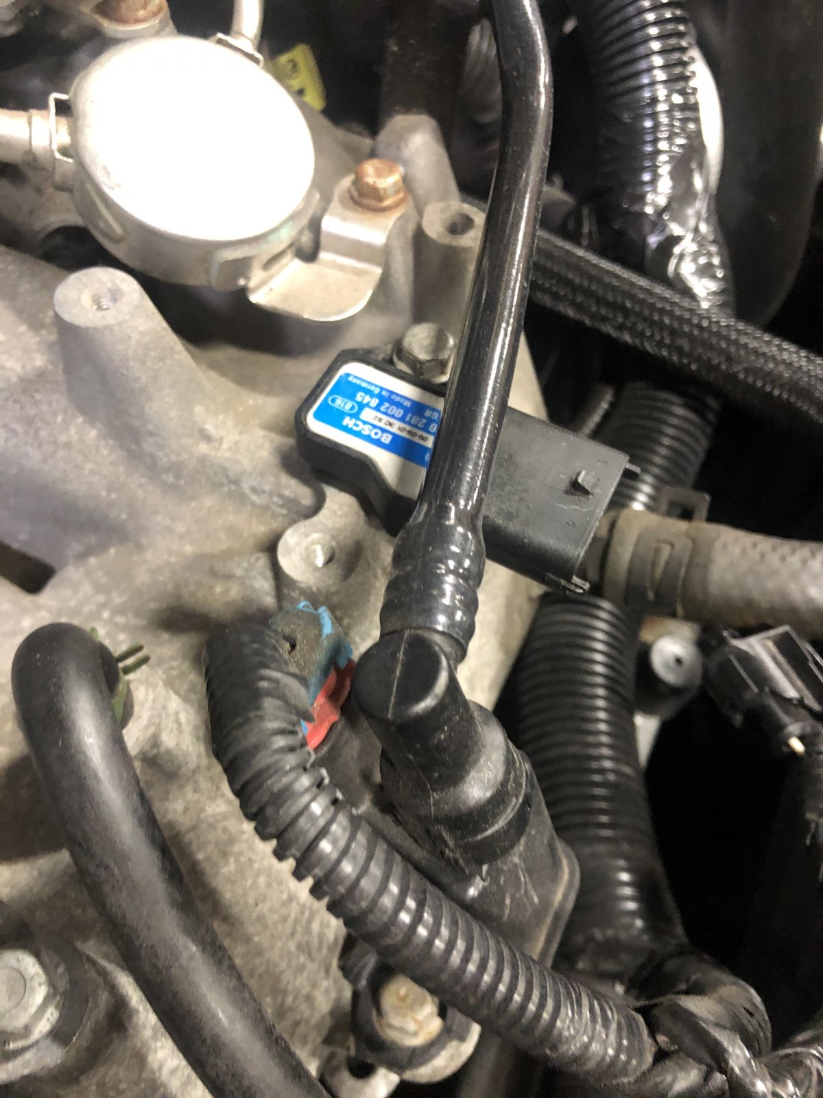

Pictures attached are from my LNF an wonder if it’s best to change out the MAP Sensor vs changing the Plug?
I confirmed my LDK has a different connector as well.

The map sensor on my donor (again not sure that it was stock, although I think I confirmed by part number when I first noticed the issue) is a different size (hole in intake was either bigger or smaller) and my donor map wouldn't fit. That would have led to a trying to find a map sensor that both fits the intake and uses the old plug, plus confirming the tune changes that might have to be made if any.
If your picture is from your donor, that part number is for a 3 bar map sensor and is a 1 bolt that is the GM stage 1 upgrade. LNF 3-Bar Map Sensor (Stage Kit Item) 55206797B | That GM Parts Guy
I think the stock Cobalt LNF map is a 2 bar, 2 bolt sensor.
LNF Stock Map Sensor (Intake Manifold) | That GM Parts Guy
If your donor sensor will work in your intake, I would use it sense your ECU should be tuned to work with.
Both the old map and new were 3 wire on mine. I think the distance from the center of the sensor to the bolt hole was also different because I remember considering drilling it out to the large size and I don't think it was that simple.
