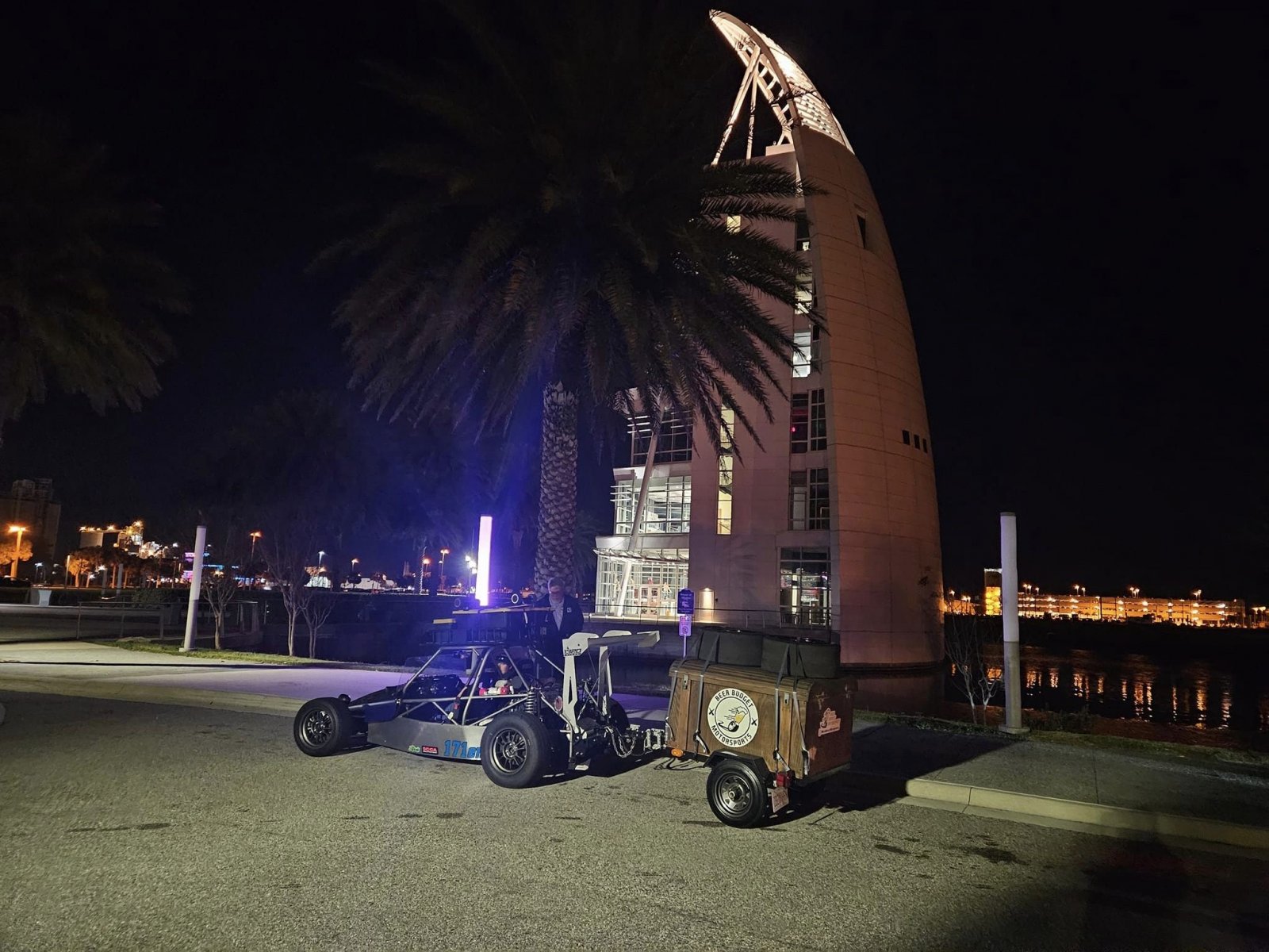

I just towed a loaded trailer roughly 1000 miles in five days with no cooler on my auto goblin earlier this year.The trans temps stayed right around 175-180. Unless you're hot lapping a racetrack for extended periods of time I wouldn't be too worried about it.
