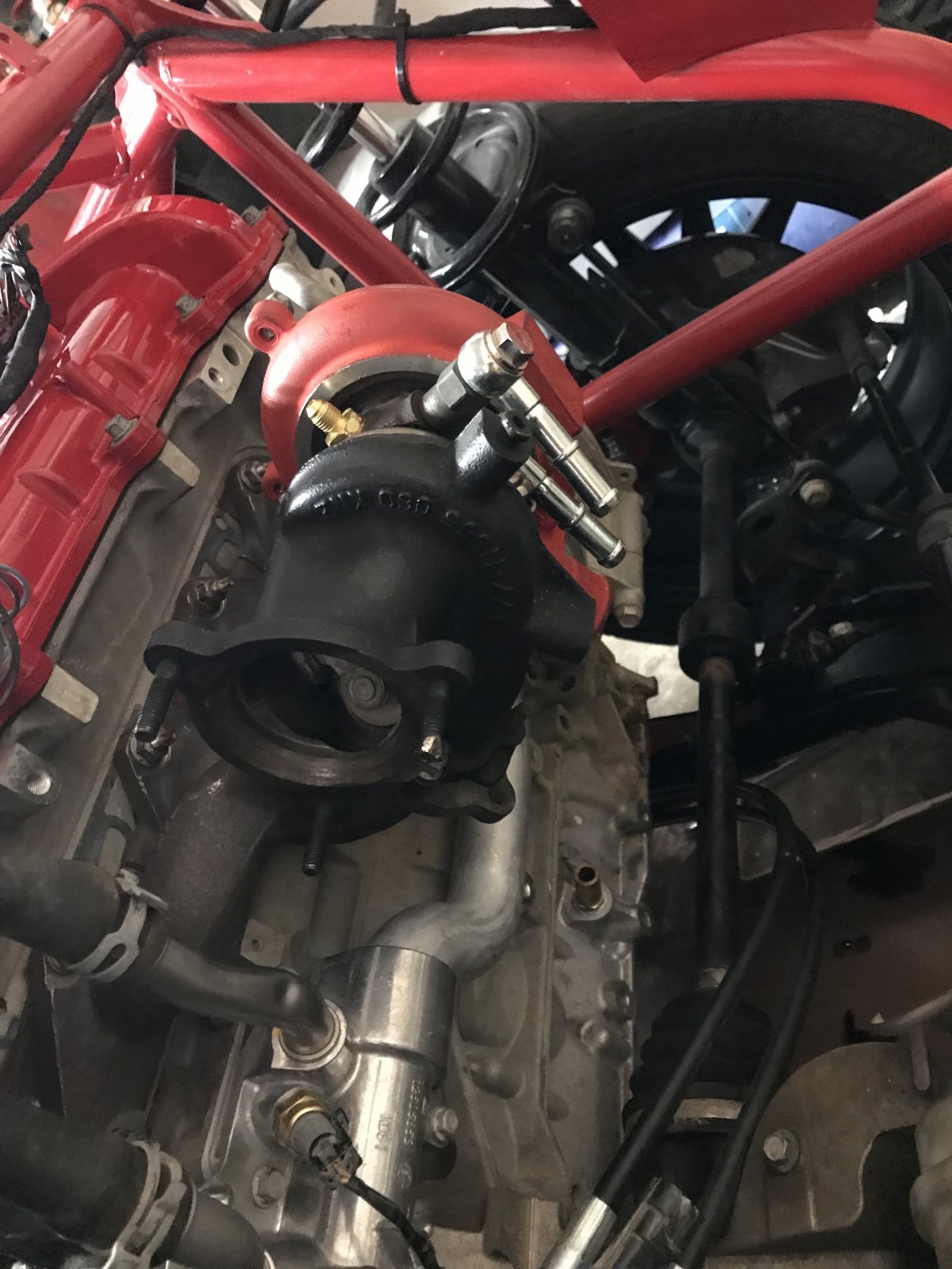

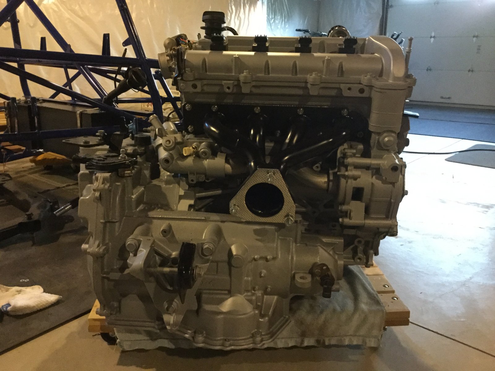

Lots of progress has been made. The oil lines are done, block has been drilled for oil return etc. I had to get the SS/TC water pump pipe to clear the turbo manifold but that was no big deal. At this point I’m pretty much just waiting to get my PCM back from ZZP.

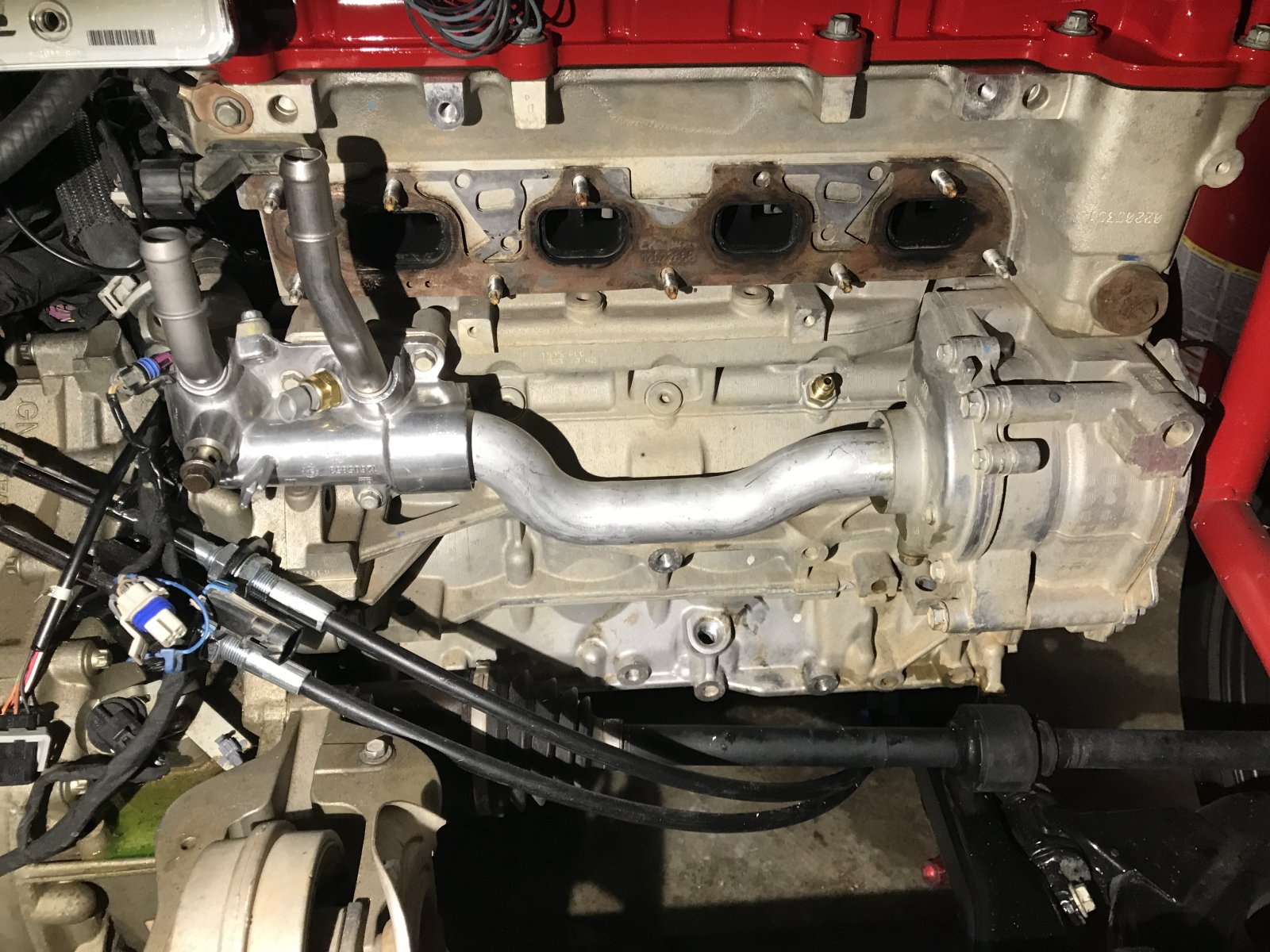

I've also been told that the heater inlet/outlet holes for the heater core can be plugged. I'm thinking that I'm going to pull the hard pipes out and drill and tap them with NPT plugs. Might make running your downpipe easier.
John
BAR-AIR
I want to say that they are 1/2” NPT but I’ll have to check. One of the tubes came right out the other was a pain (ended up cutting it inside the housing then breaking it out). When I drilled and tap just be careful not a lot of meat (material) to work with on one of the holes.
I don't have a 23/32" drill bit to tap a 1/2" NPT thread, but it appears the holes are right around 3/4" which means it's too big to start with. It also doesn't appear to have enough material to go to 3/4" NPT.

View attachment 2340 Here is the one I am using. Hard lines pulled then tapped and plugged.
Makes for a cleaner look plus never intended on putting heat in the car other than possibly doing heated seats in the future.

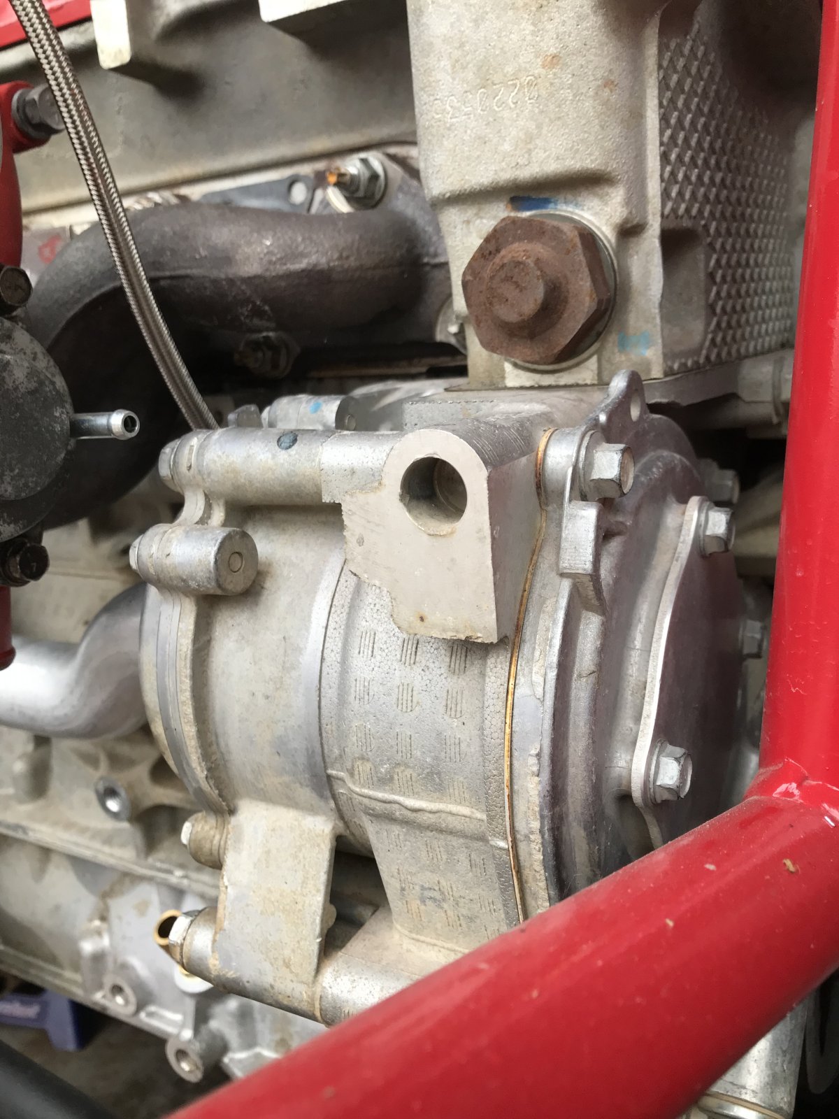

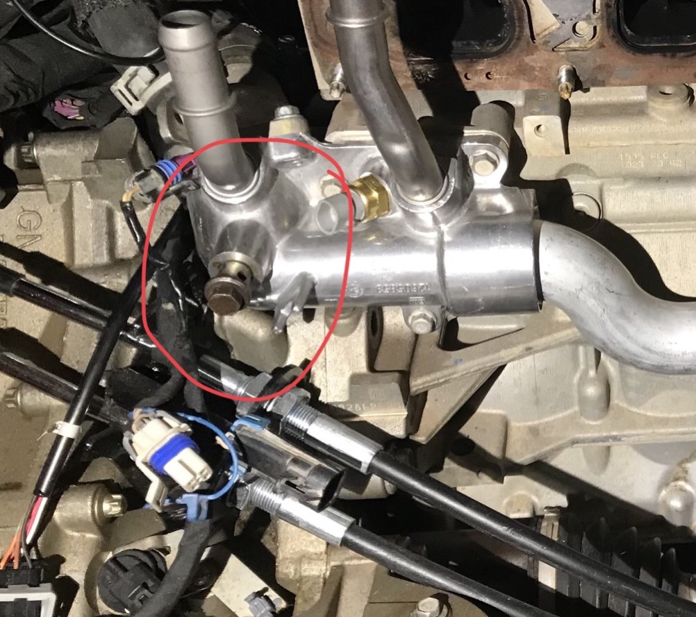

The stock turbo takes its water from the boss just below the left hand heater pipe. I was wondering if it would be possible to run the turbo coolant from that pipe but don’t know how or if it’s all connected.
That looks really nice.
In an LNF the coolant feed pipe is sourced from the engine neck by the water pump. The return pipe hooks up to the thermostat housing.
JSATX

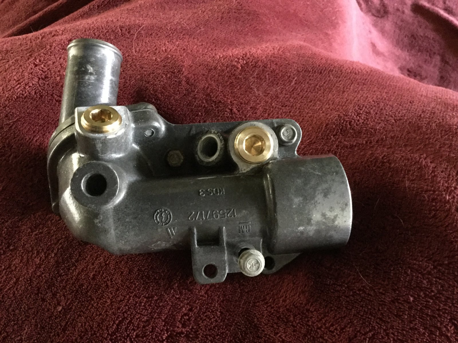

Are you sure that’s not backwards? The Saab turbo cool line “in” comes from the fitting circled below the heater core pipe. The turbo water “out” then connects to the upper radiator hose hot side.
