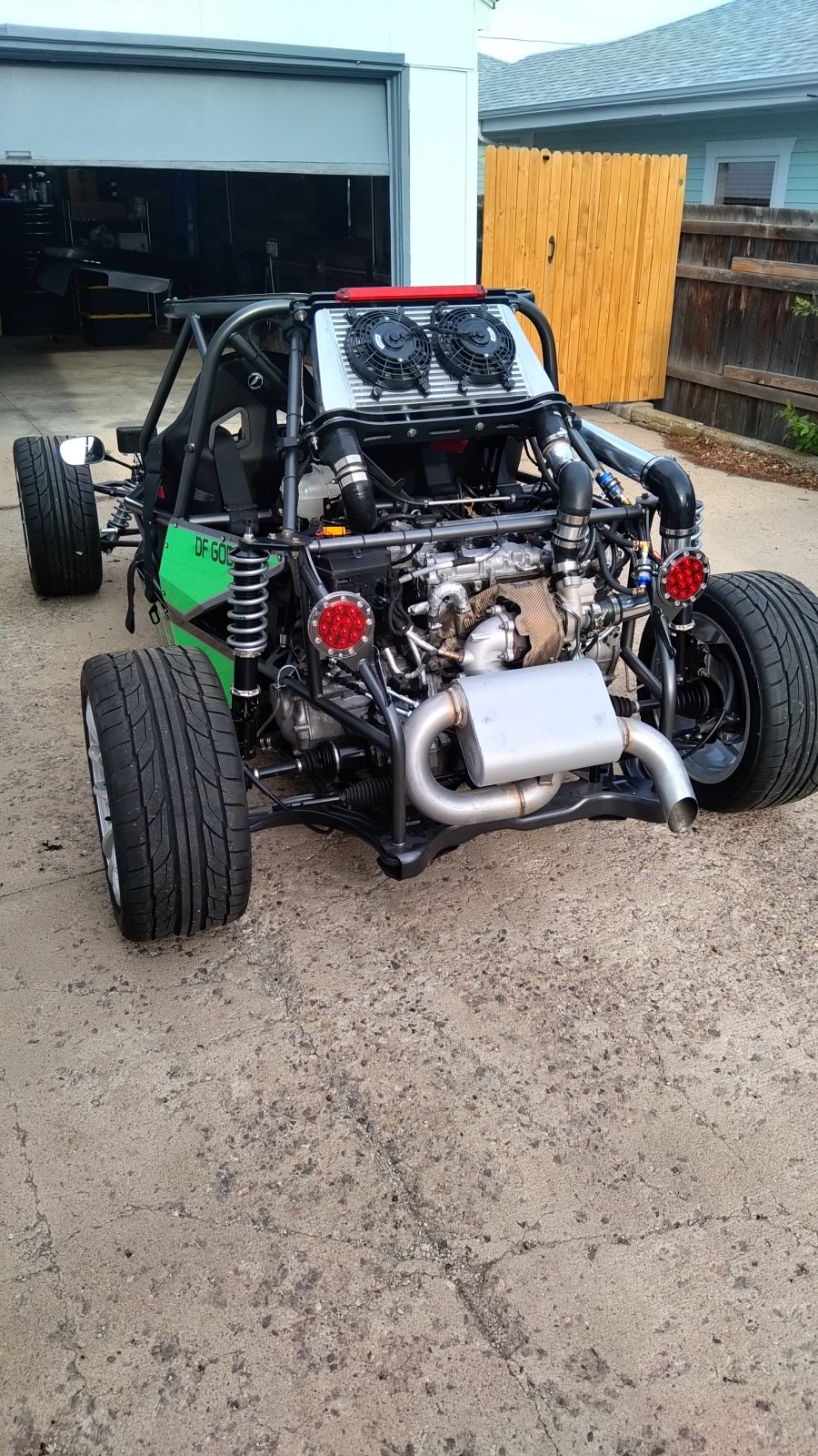

am I the only one who powdercoated both the subframe the rear lower control arms?!?!?
I think it was worth the extra effort :-)

I powder coated a large amount of parts to match the chassis color then powder coated a few more satin black to “hide” them. I used Sharkhide on bare aluminum to prevent oxidation and also used it on some steel bolts after polishing with a wire wheel in the bench grinder. Some Cobalt parts that were larger, I painted with rattle can Krylon Rust Tough.
Powder coating is the most durable. Painting is probably the least. Great thing about Sharkhide is that it is a wipe or brush on so easy to touch up.

Donor Parts
    • pedal box (also the clutch pedal bracket on manual cars) painted
    • steering shaft painted
    • fuel filler neck (must be trimmed - see notes below this list) painted
    • subframe powder coated satin black
  • Kit Parts
    • sheet metal: floor bed liner, firewall matching powder coat and front bulkhead painted
    • fuel tank and pump retainer ring (we recommend a flat or textured paint) powder coated satin black
    • floor support strap matching powder coat
    • battery hold down angle and hardware painted but should have powder coated for durability
    • engine and transmission mounting plates matching powder coat
    • hardware (to prevent bolts and nuts from rusting) Sharkhide
