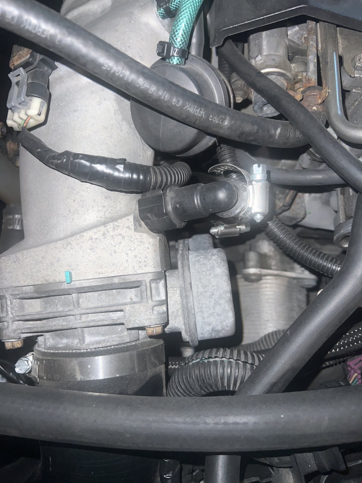

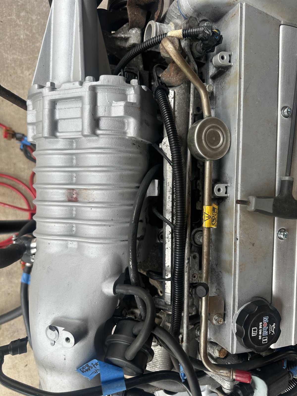

I am trying to locate the brake booster vacuum hose so that I can extent it. The video shows a NA car and I am not sure where this hose is on a SC car. I will attach a couple of pics of what I am looking at. Thanks.

The brake booster hose should be the other end of the semi-rigid nylon hose coming from the tunnel under the fuel tank. Find it and trace it up to the connection at the engine.

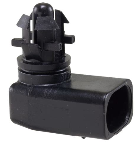

Looks just like this one. This one goes on top of the SC but there is another one that mounts somewhere on the back of the engine. It reads the external air.

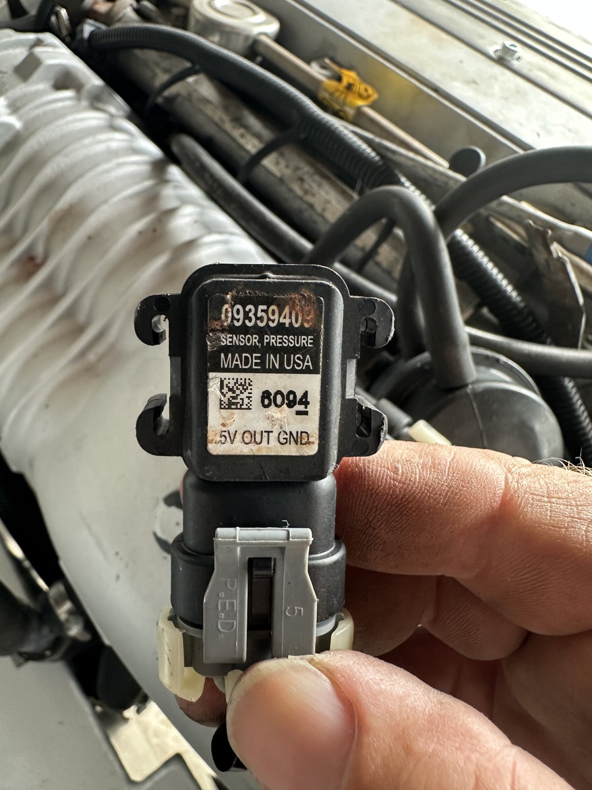

Different donors have different sensors, although I don’t Know if there are any differences in SC SS between 06 and 07.
But this video explains the differences and stock locations of the SC SS pressure sensors
Both baro’s are on the charger and engine. I think you are talking about the oat like trea posted. That one can go anywhere. I think I put mine on the subframe.
