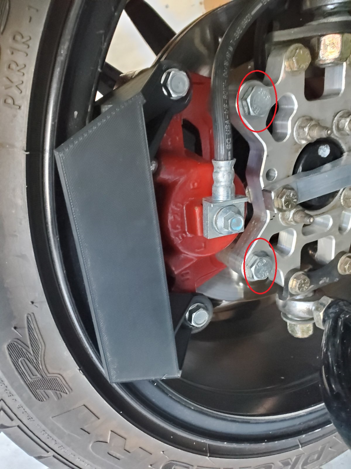

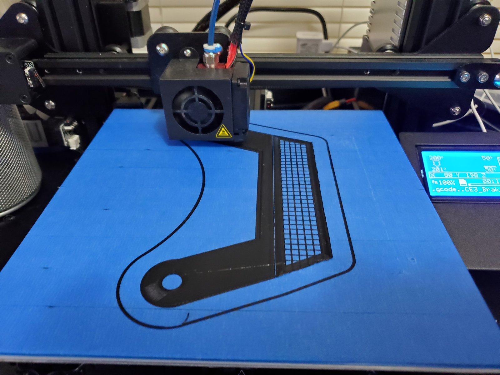

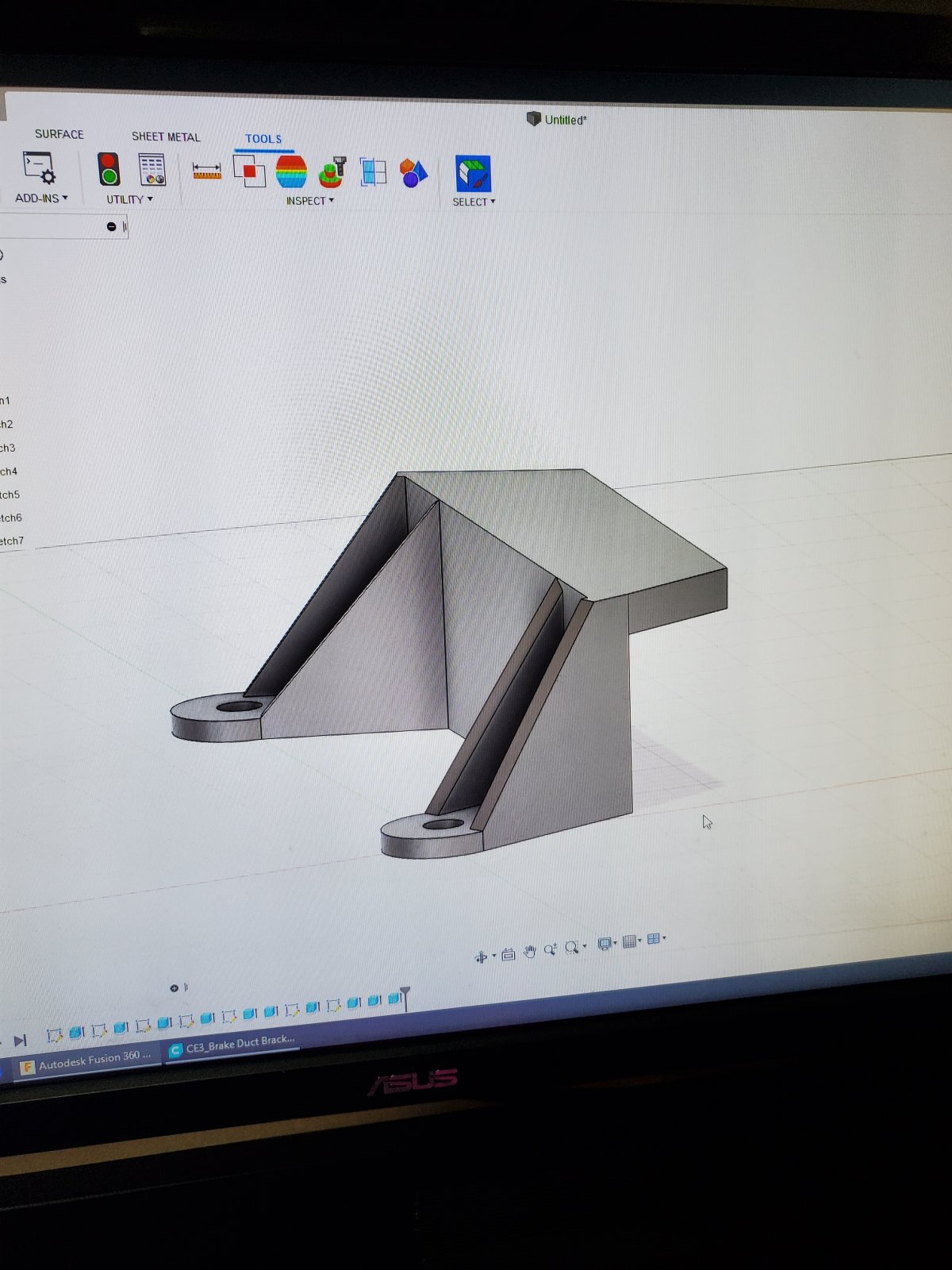

I was watching Formula 1 recently and I saw brake ducts on the front brake so I thought I would bake a new one. I modeled a test one to see if it would fit and it is currently printing.
Ferrari SF70H - Racecar Engineering

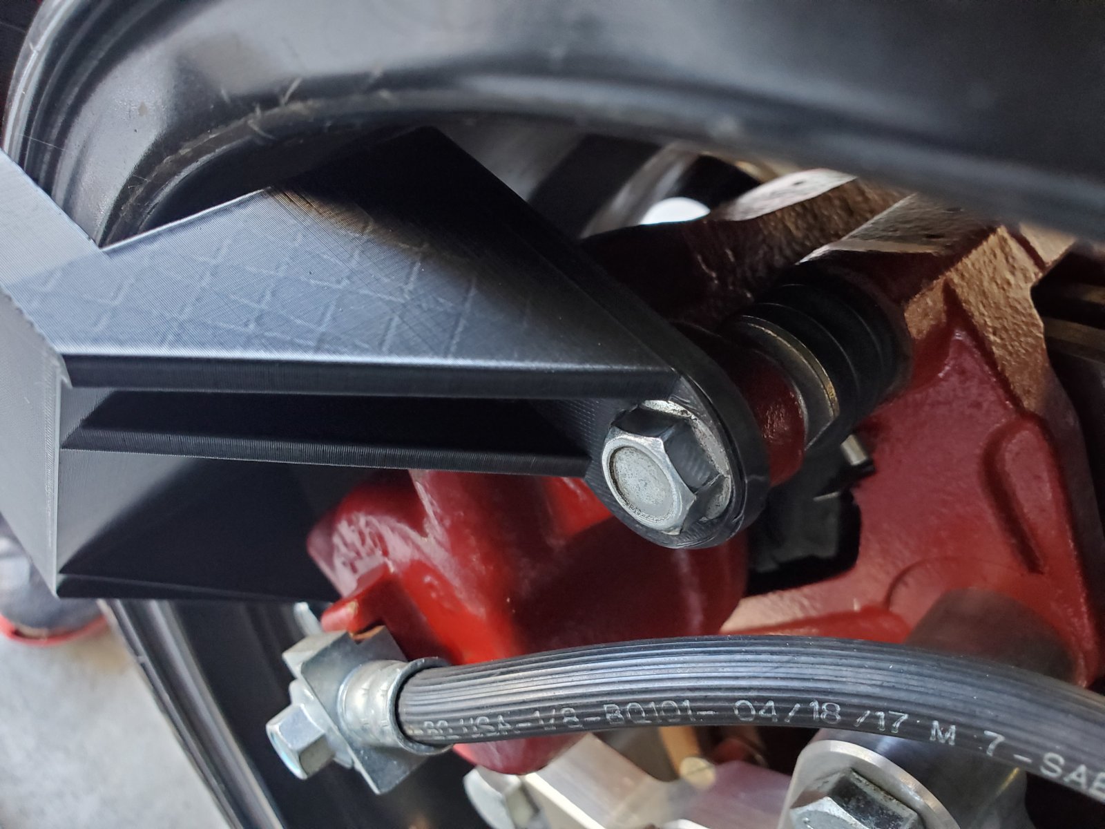

This is the bracket test to see if I can get the measurements correct. They will mount using the same holes and hardware used on the brake calipers.
15414
15415
N

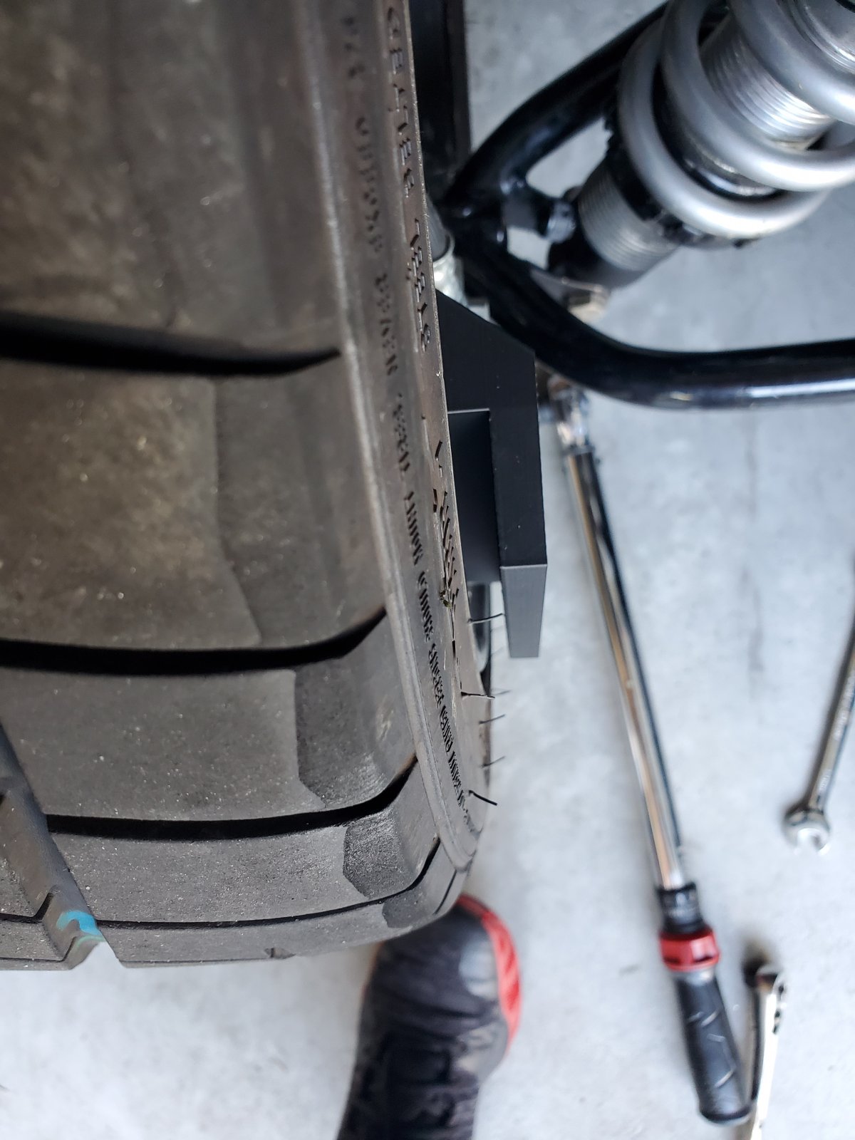

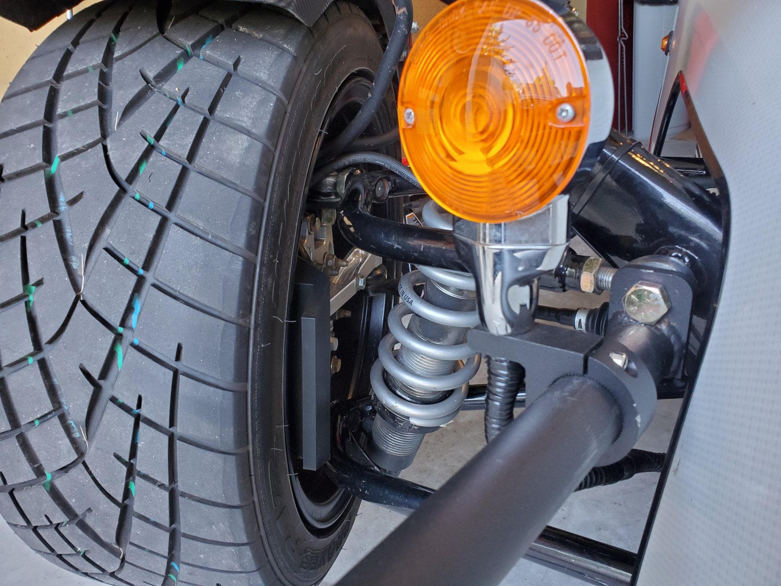

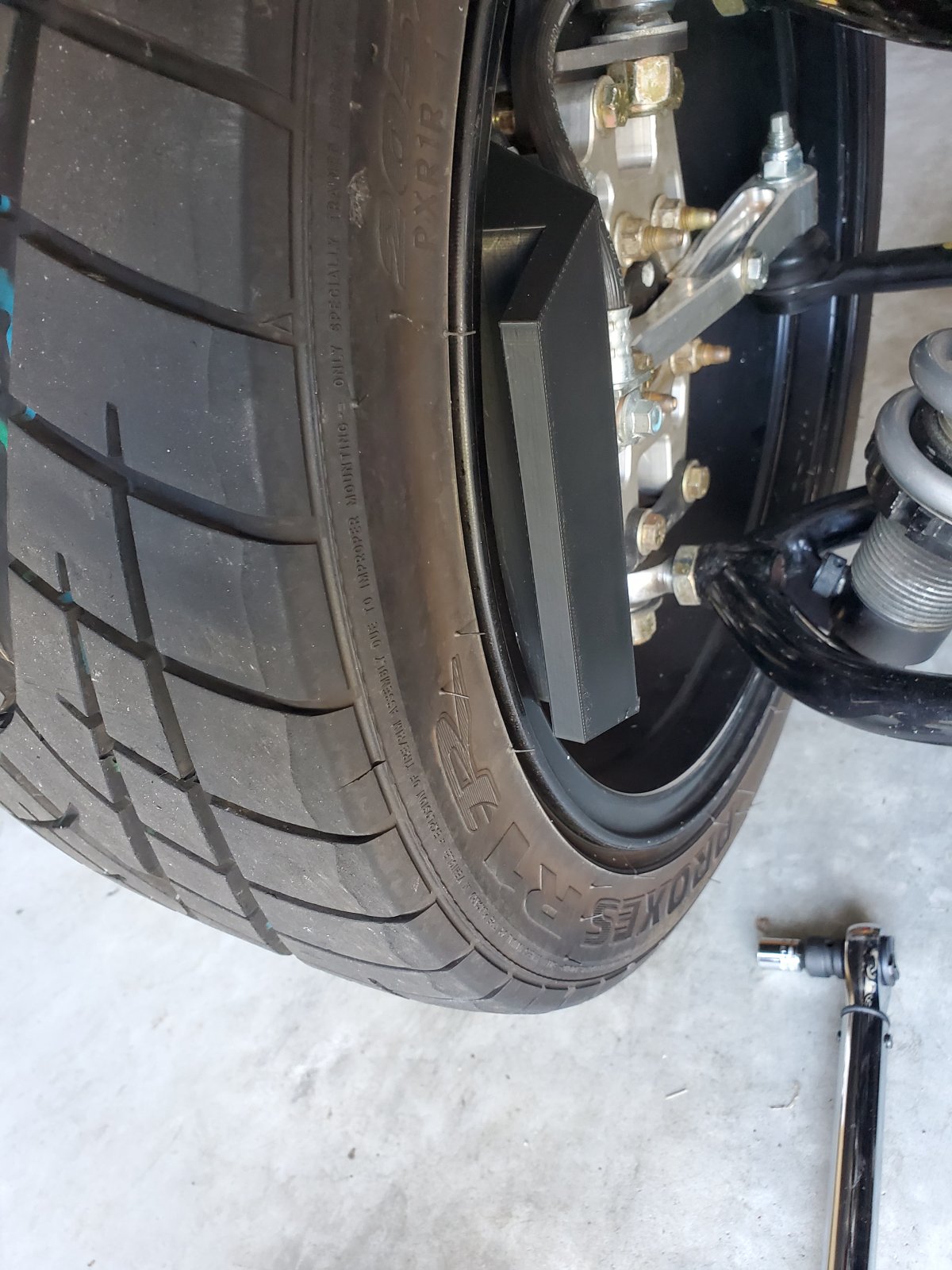

I got the mount set up and it looks like out clearences are good even when the wheel is all the way turned.
Now to work on a plate to cover the inside of the rotor to keep air out.

Can you torque the bolts down just as fine even with the plastic in there?
I think that's neat, but brakes also get fairly hot, I wonder how quick it would warp?
95Blitz
15813
Mount to the 2 bolts circled in red then you can cool the caliper also and you can make it bigger because it's over the A arm. Oh and might be able to still use PLA or PETG.
...or simply punch a 3/4 inch or so sized hole in the 'back plate' aimed at the caliper to allow some air to blow onto them using the existing pieces already mounted. :) Minimal effort for better performance!
95Blitz
Could if the duct was made of metal but that plastic won't hang out long attached to that caliper and may not last on that upright either.
This is just one of the things i'm looking at doing. I watch a lot of F1... ;)
JPas914
My two cents, using the bolts that 95Blitz circled, the rear wheel bearing bolts and the caliper pins, you could fab a metal frame and then make the scoop out of fiberglass or carbon fiber (maybe after getting everything worked out). It would funnel the air in to the caliper and rotor vanes a bit more effectively. And wouldn’t need to stick out much further than what’s prototyped already. But, like I said, that’s just my 2 pennies. I’ve thought about adding brake ducts myself, but I don’t have a need for them right now.
I watch a ton of F1, WEC endurance racing, IMSA, and sometimes Indycar as well.
