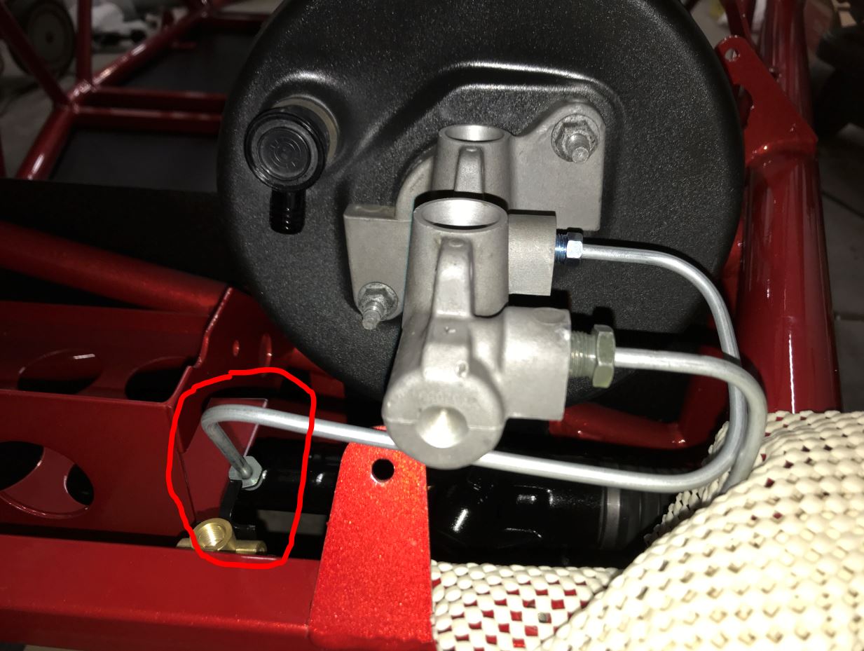

Did anyone else have issues with the DF brake line being way too long to fit coming off the master cylinder? It is about 2 inches too long.
We usually put a another bend in that line to help clear the master cylinder. It is easy to do by hand.
index.php
We use to have it make a tight bend going into the brass tee but it made it difficult to start the tube nut. So now we leave it longer to give it more flex.
The bake line material we purchase is made to be easily formed by hand for custom car builders. It doesn't easily kink while bending and can be twisted around to line up with the fitting.
I don't mind sending you another one so let me know if you have any problems bending it.
