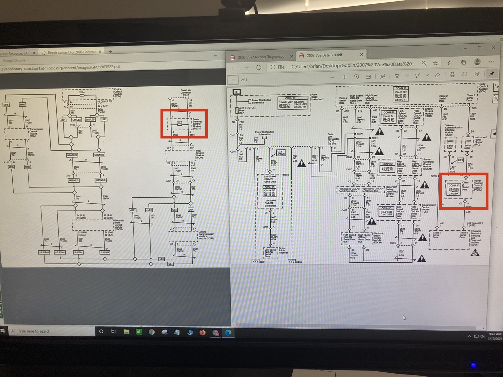

My Aeroforce gauge wasn’t working, so I tackled that first. Had good ground, 12v, continuity to the CAN wires... Then I rung out the CAN wires... Zero ohms; where it should be 120 for bus termination.
I realized that this Saturn Vue steering module might be different. I was able to confirm on the wiring diagram that the Saturn Vue steering module isn’t even on the CAN bus but instead runs on a completely separate class 2 data bus from the BCM. I hung the Cobalt module and plugged it back in. Everything works now. I’ll have to find a 120 ohm resistor and install it later on.

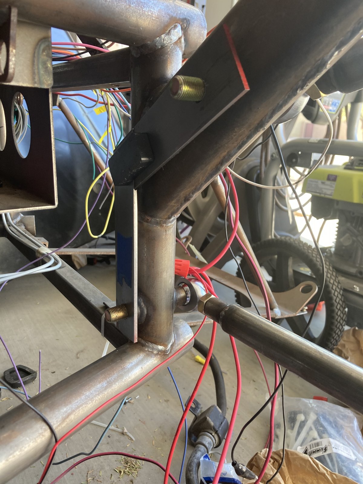

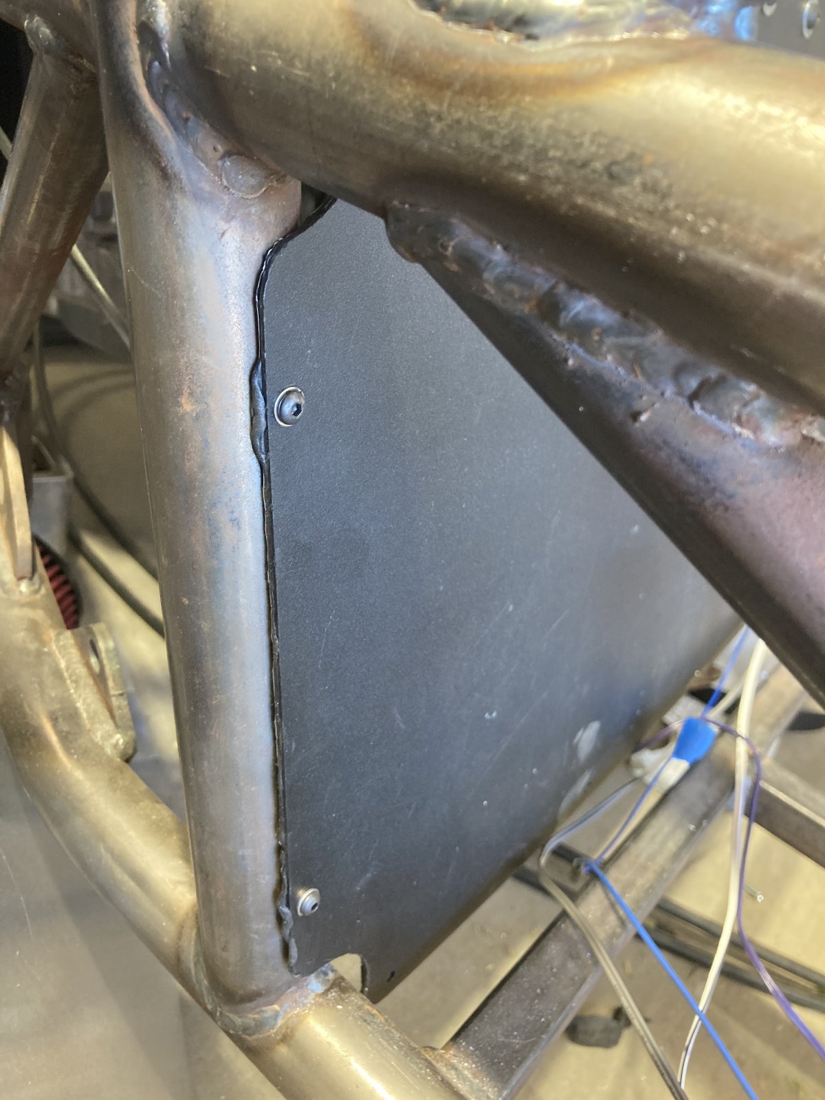

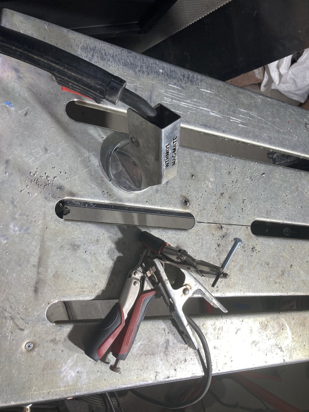

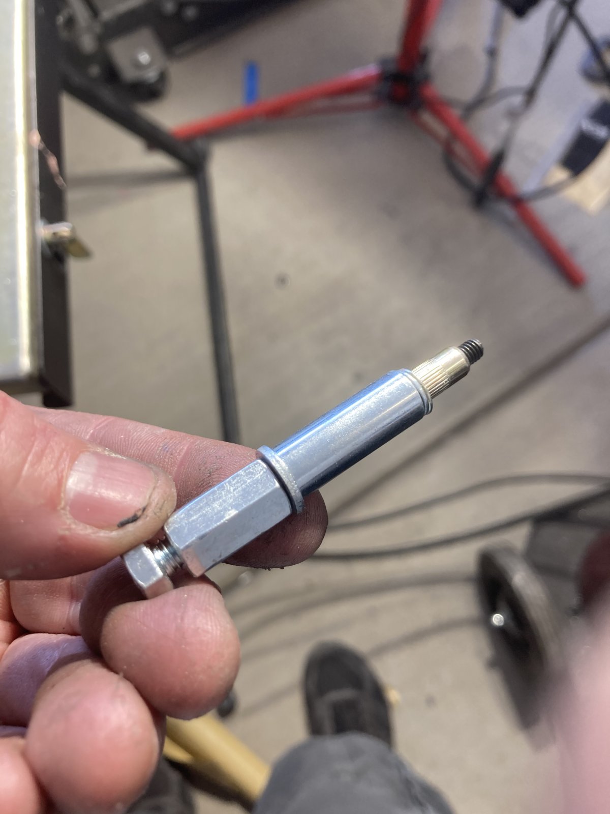

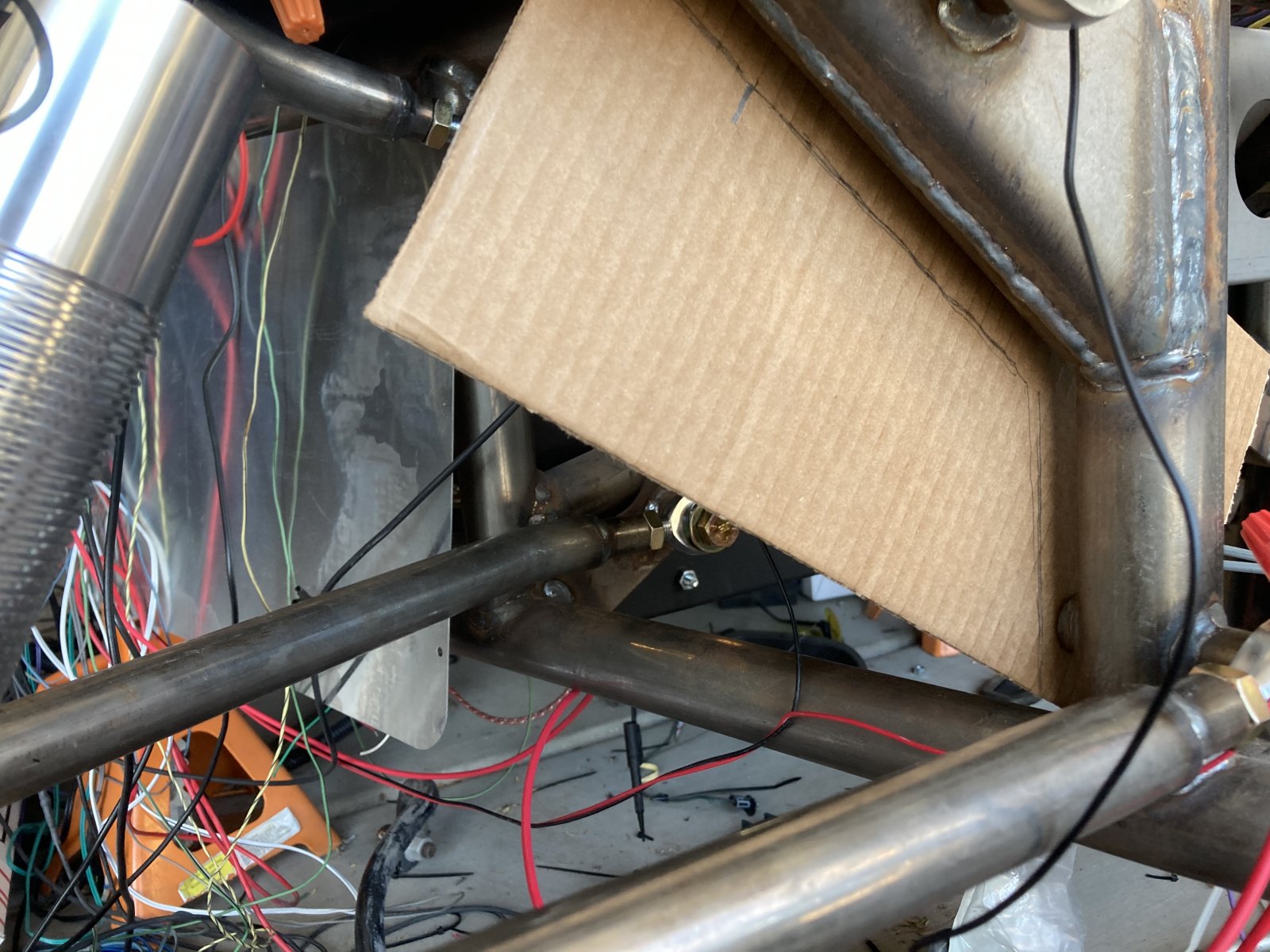

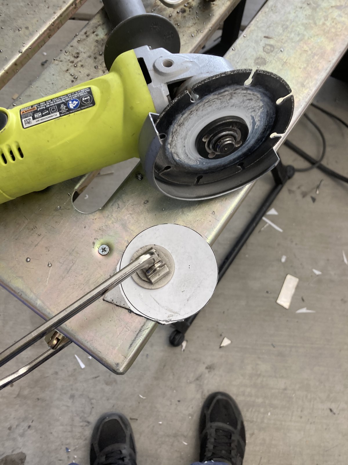

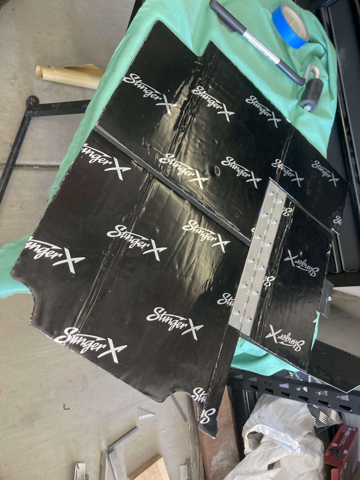

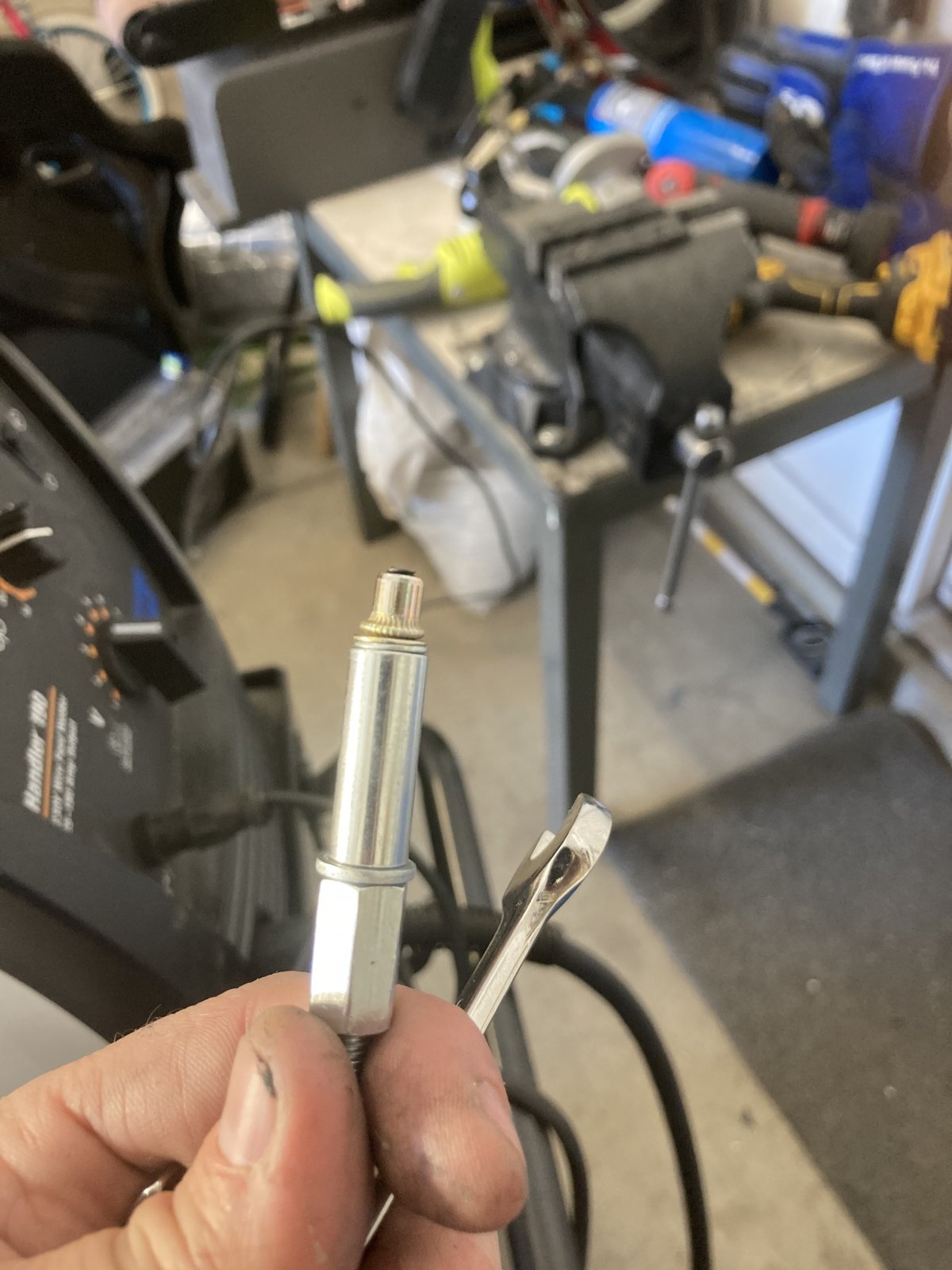

I decided to work on the firewall. I got the pax side sound deadener installed. I decided to use 4mm rivnuts to bolt the firewall panels to the frame. There is no way to get a rivnut installer in a few of the outside holes, so I fabricated my own compact rivnut installer from some hardware I bought. It ended up working out really well.

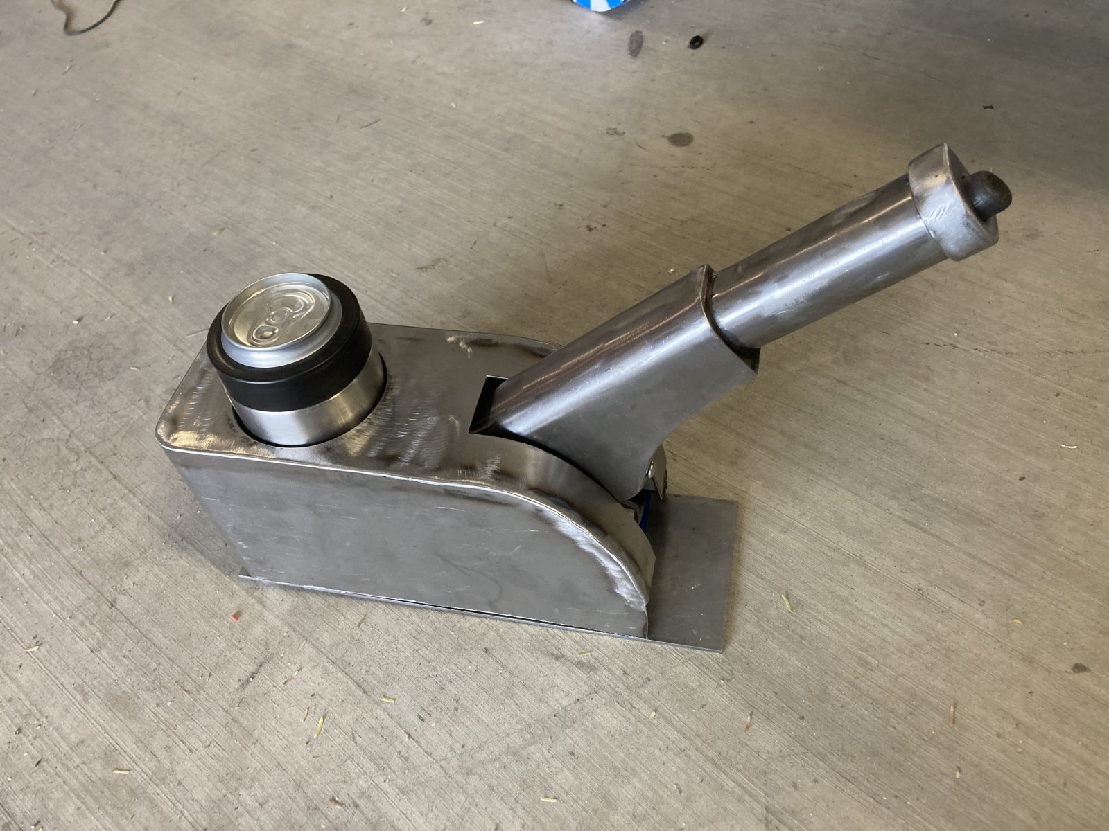

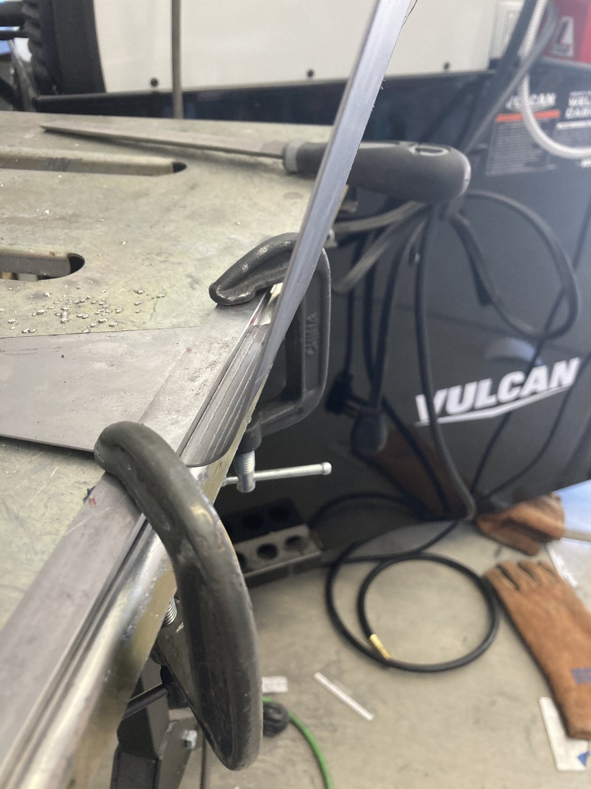

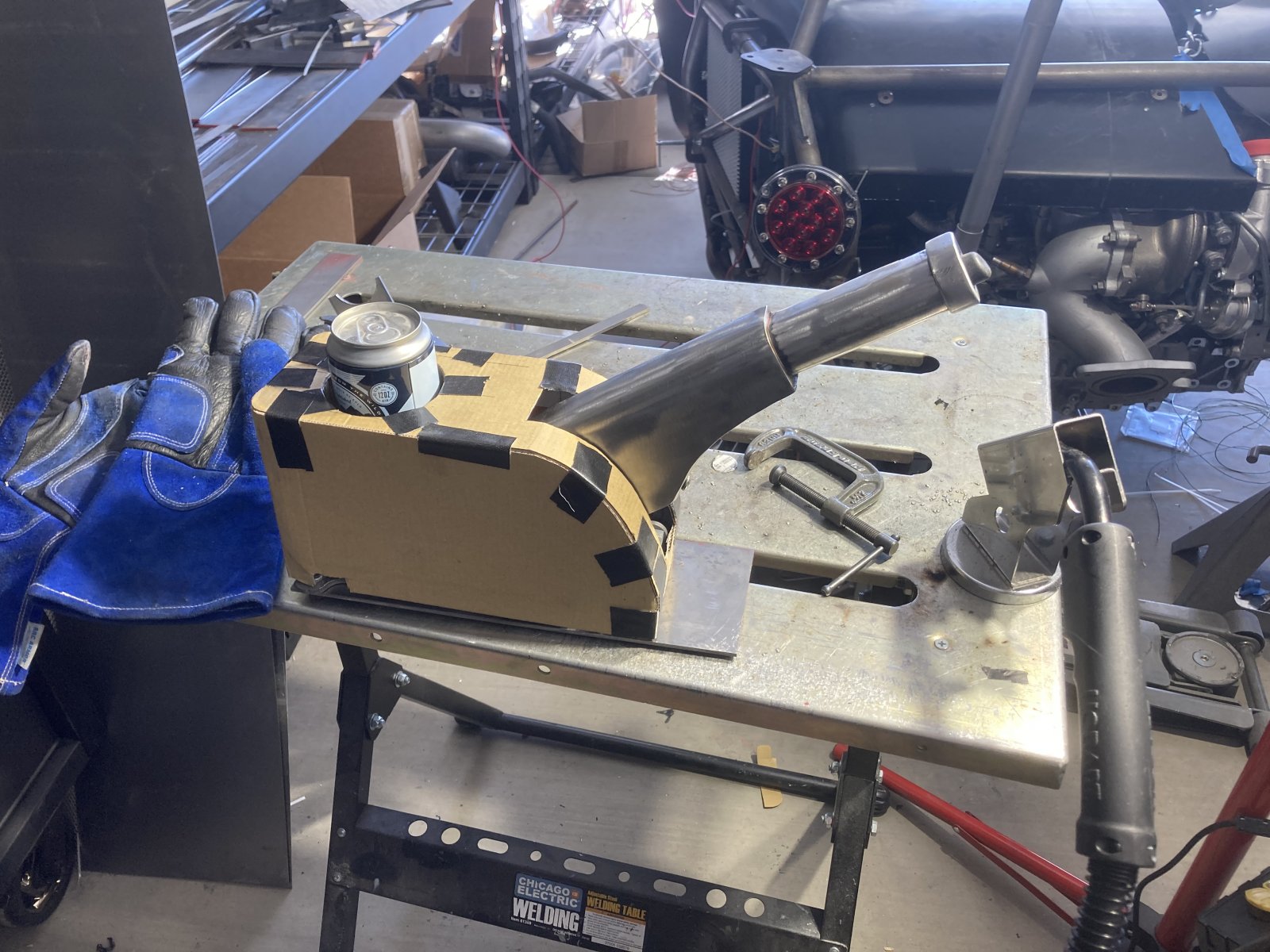

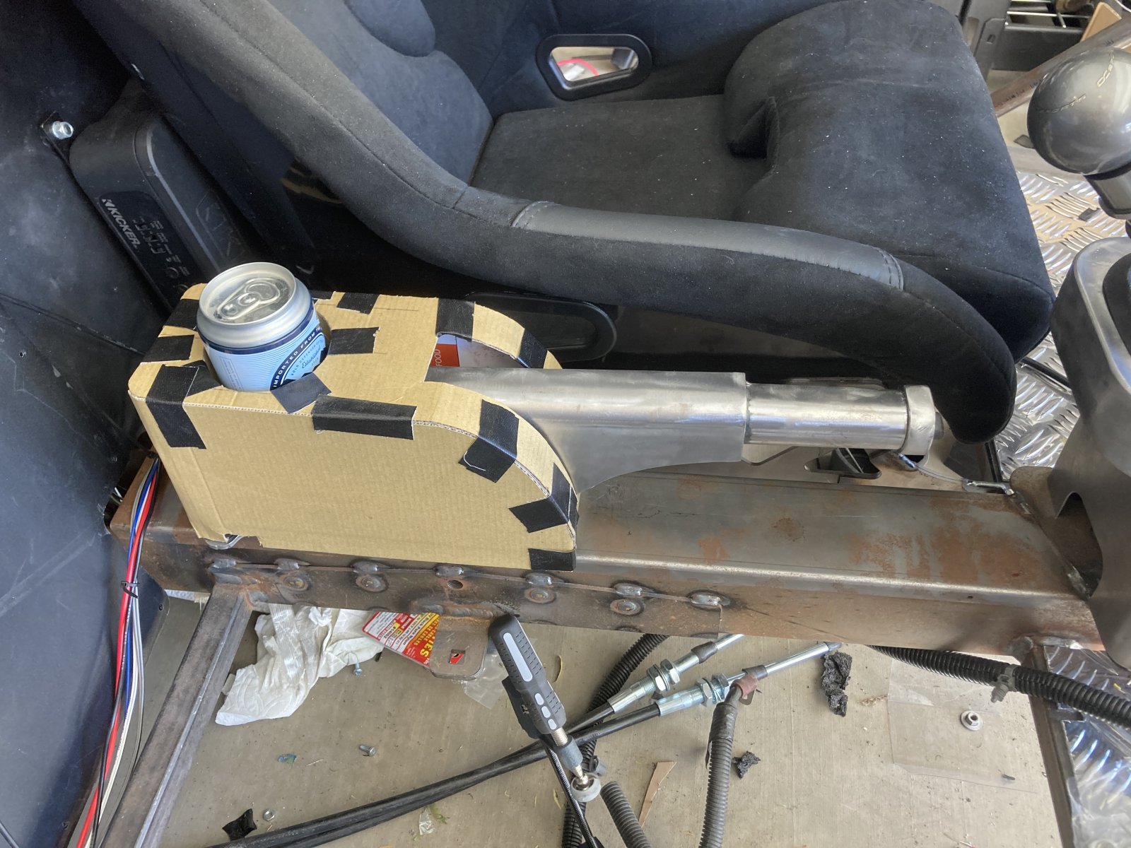

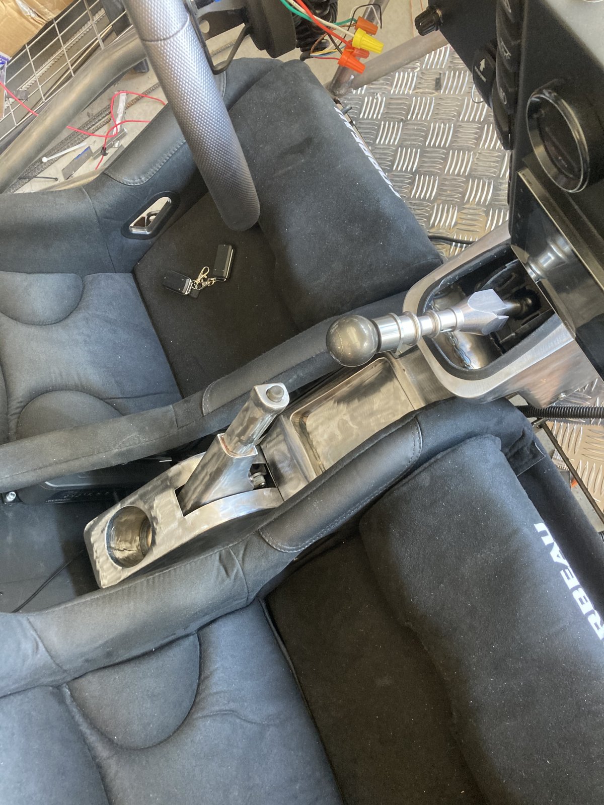

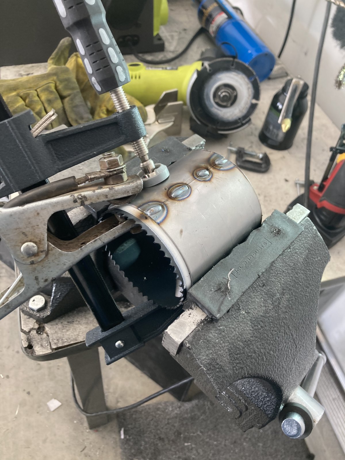

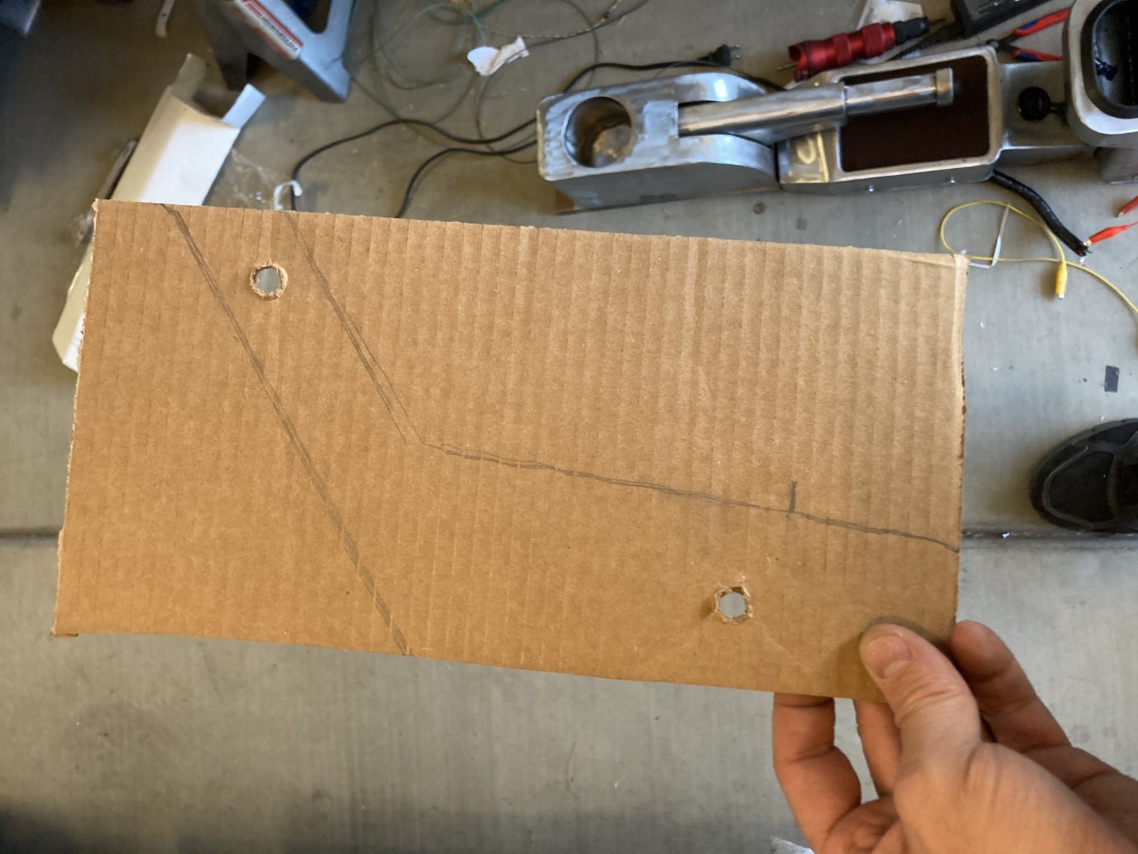

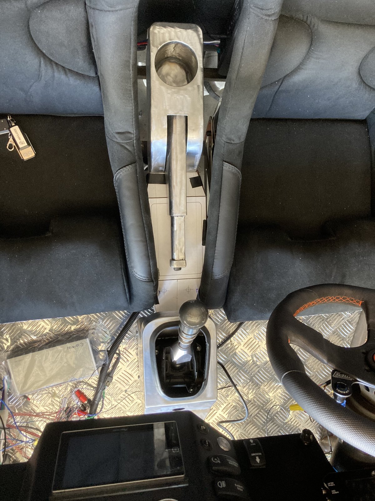

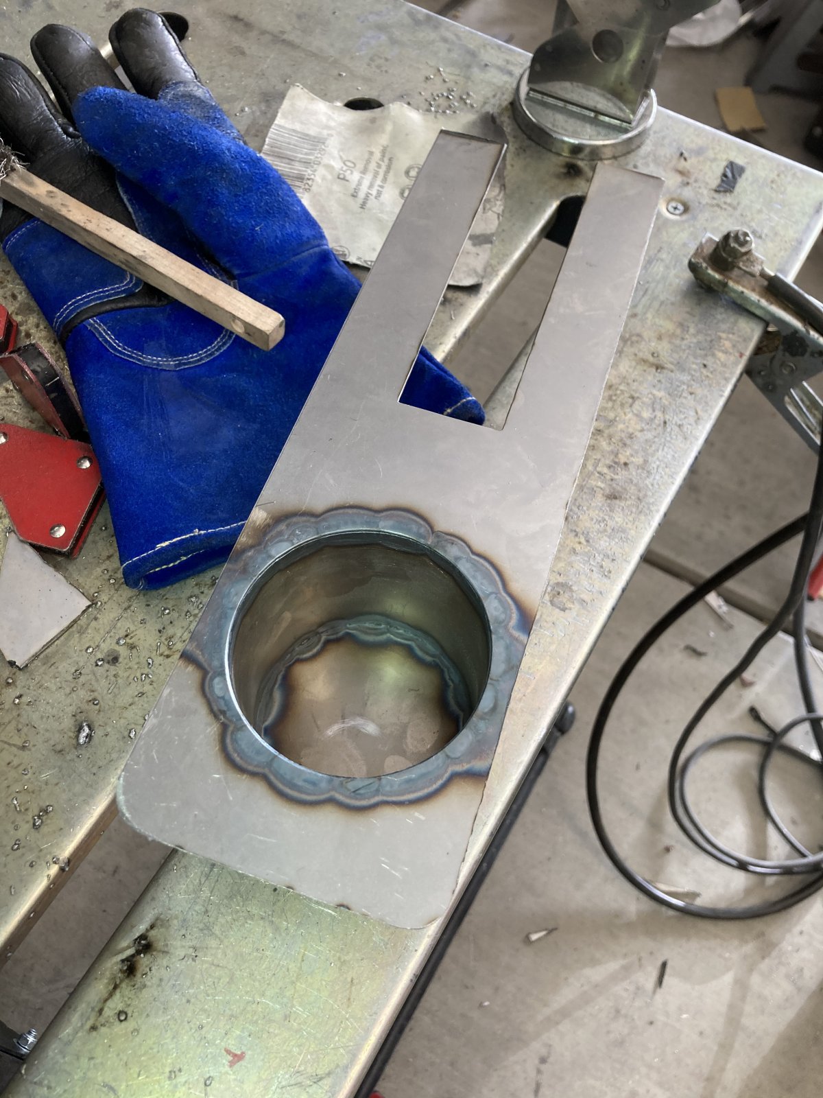

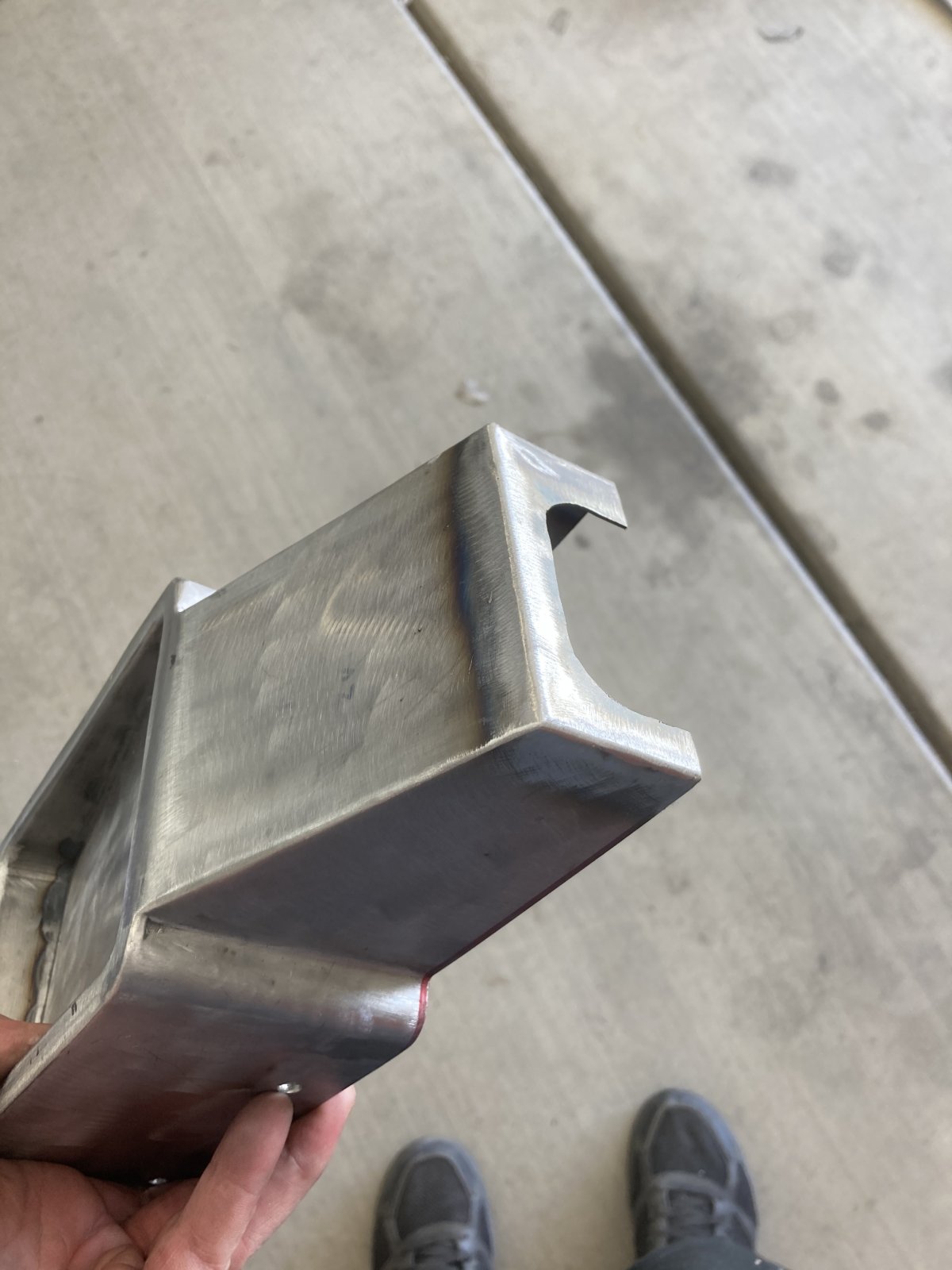

This weekend I decided to fabricate a cover for the parking brake, as it didn’t quite look finished. It also has a cupholder, which I’ve been wanting. I can actually reach it with the harness buckled and I designed it deep enough to fully secure the two cups that I regularly use. I am also working on a small console tray to go between the parking brake and shift console.

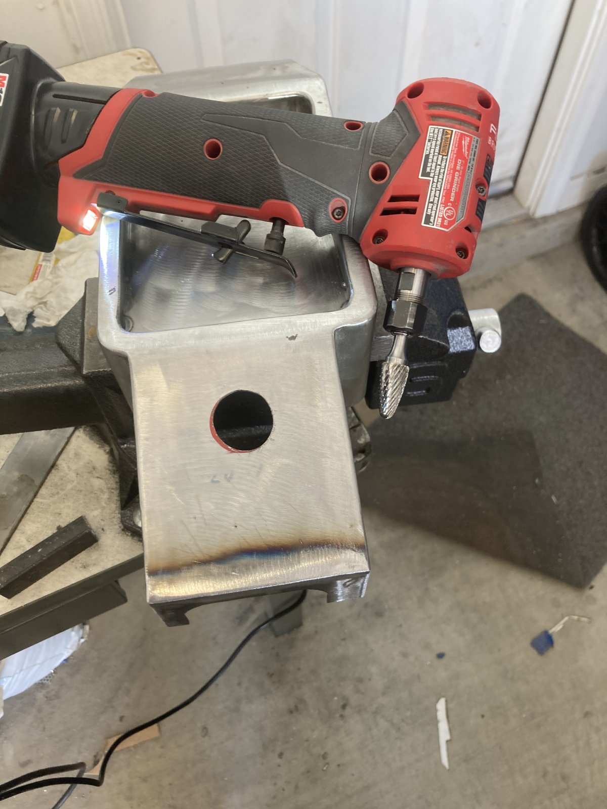

I have been curious about using Rivet Nut's, has there been any issues in using them on the curved surface of the tubes?

Yes. Got a Vue box out of a pull your own yard for dirt cheap. Its a direct fit, other than needing to install a 120 Ohm resistor to make a new CAN bus termination.
They should work fine assuming you drill the proper size hole. I had no issues with them holding inside the tubes. Make sure to use steel ones to avoid galvanic corrosion. You’ll need to either make or buy a low profile installer for the side firewall holes as there is not much clearance.
I also had to use a dremel and carbide burr to enlarge the holes as a drill bit will not fit in there either.

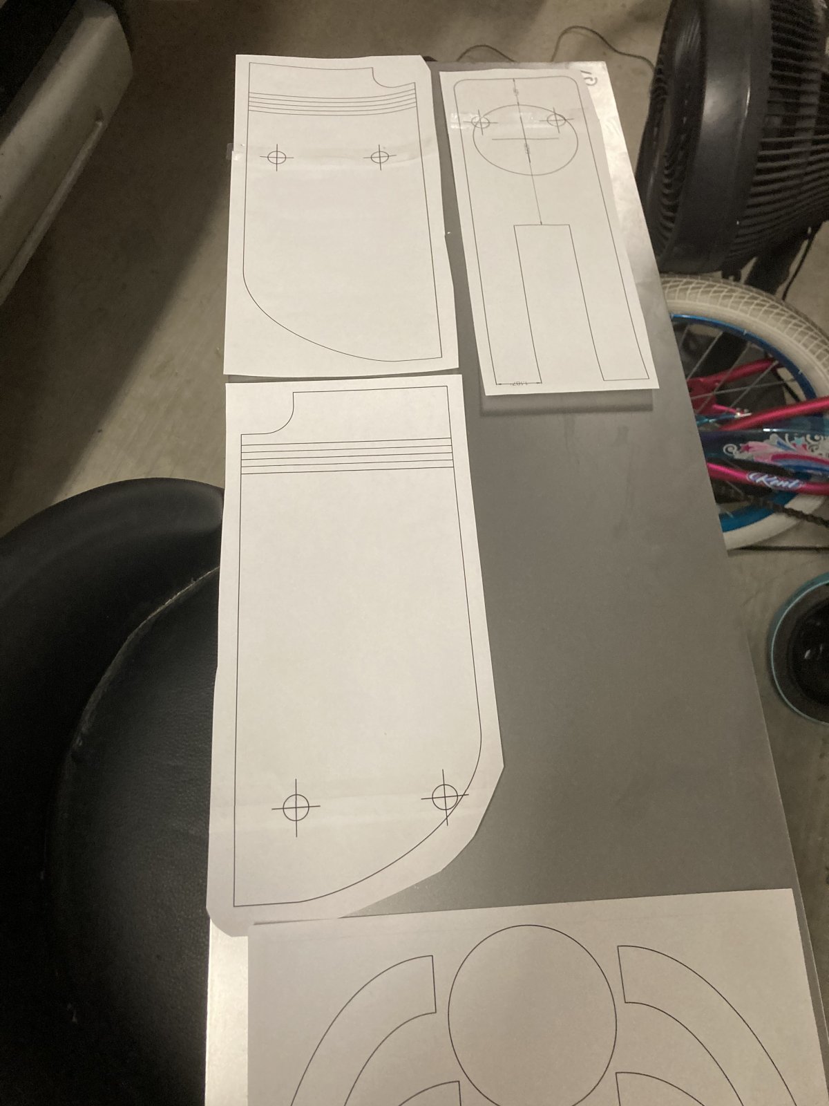

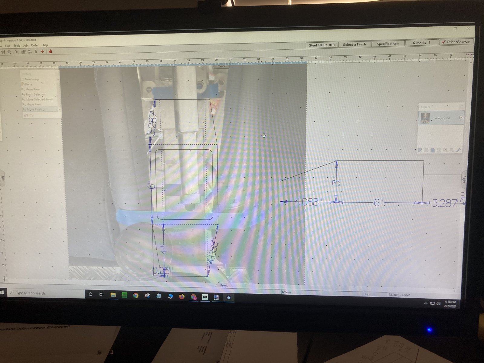

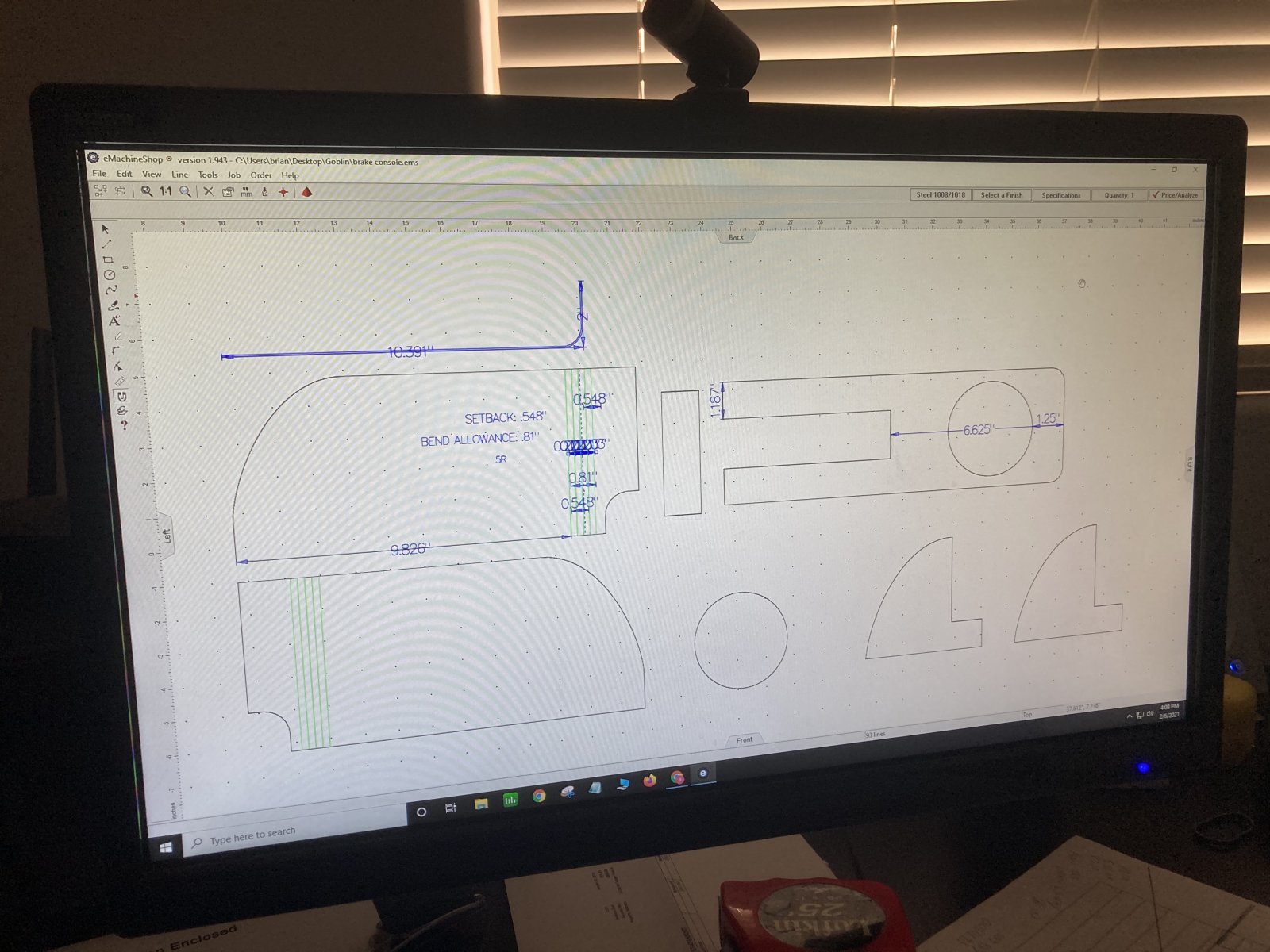

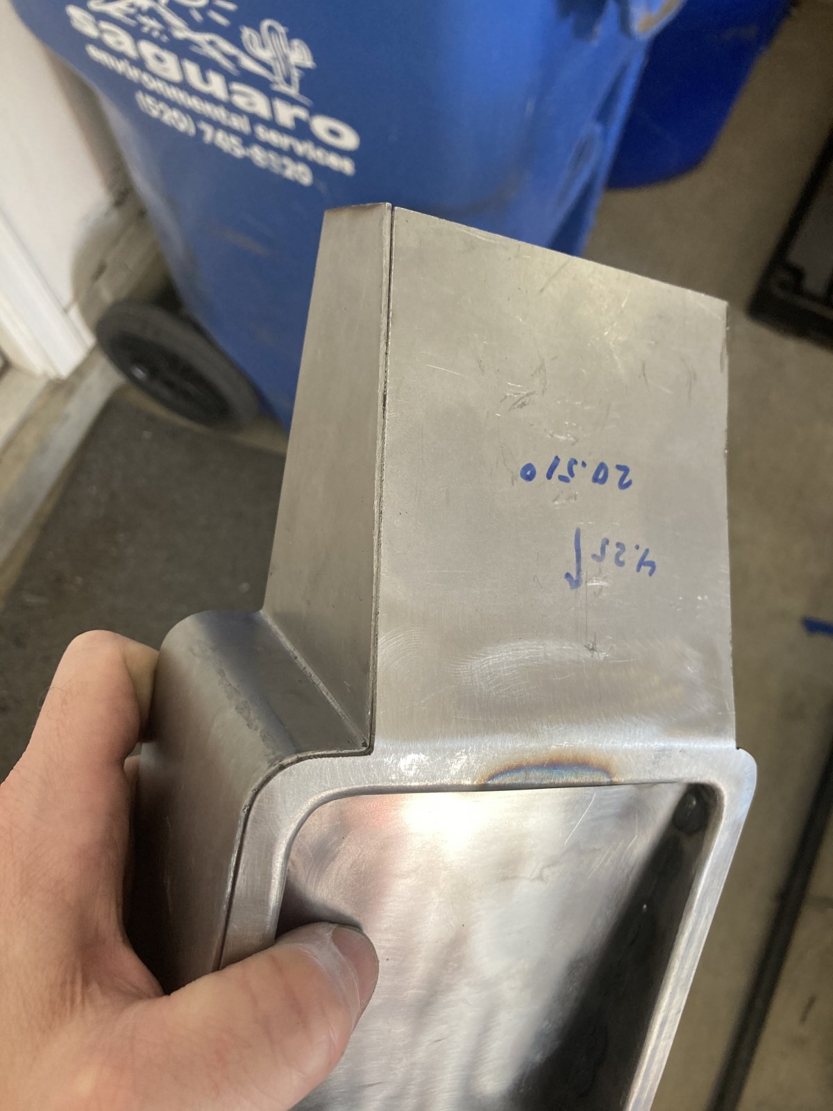

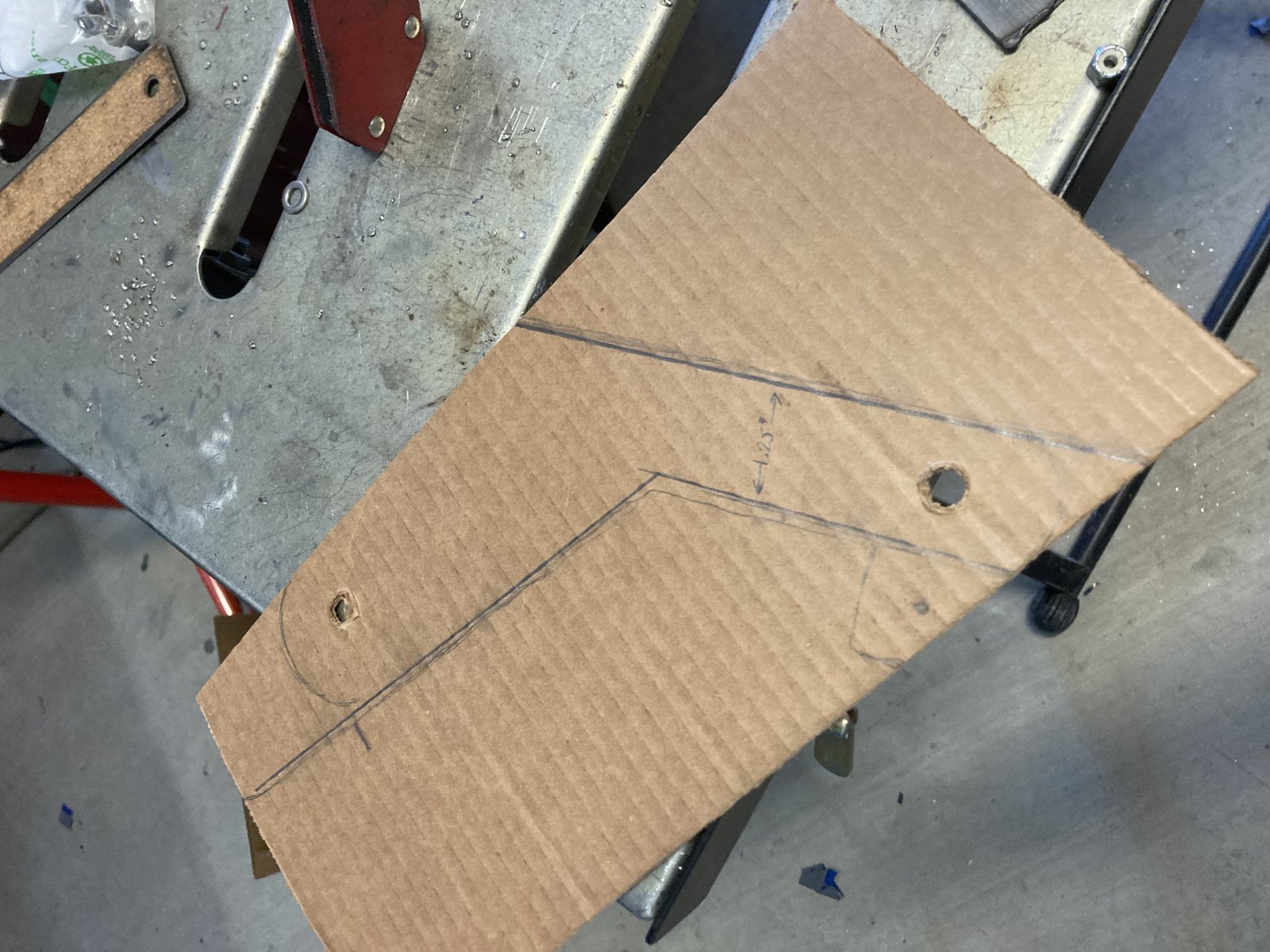

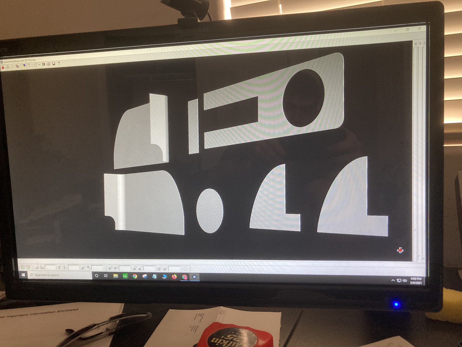

Slow, mellow day today.... BUT.. I figured out an awesome new trick with this CAD program that is not even in the scope of their advanced technique tutorials.

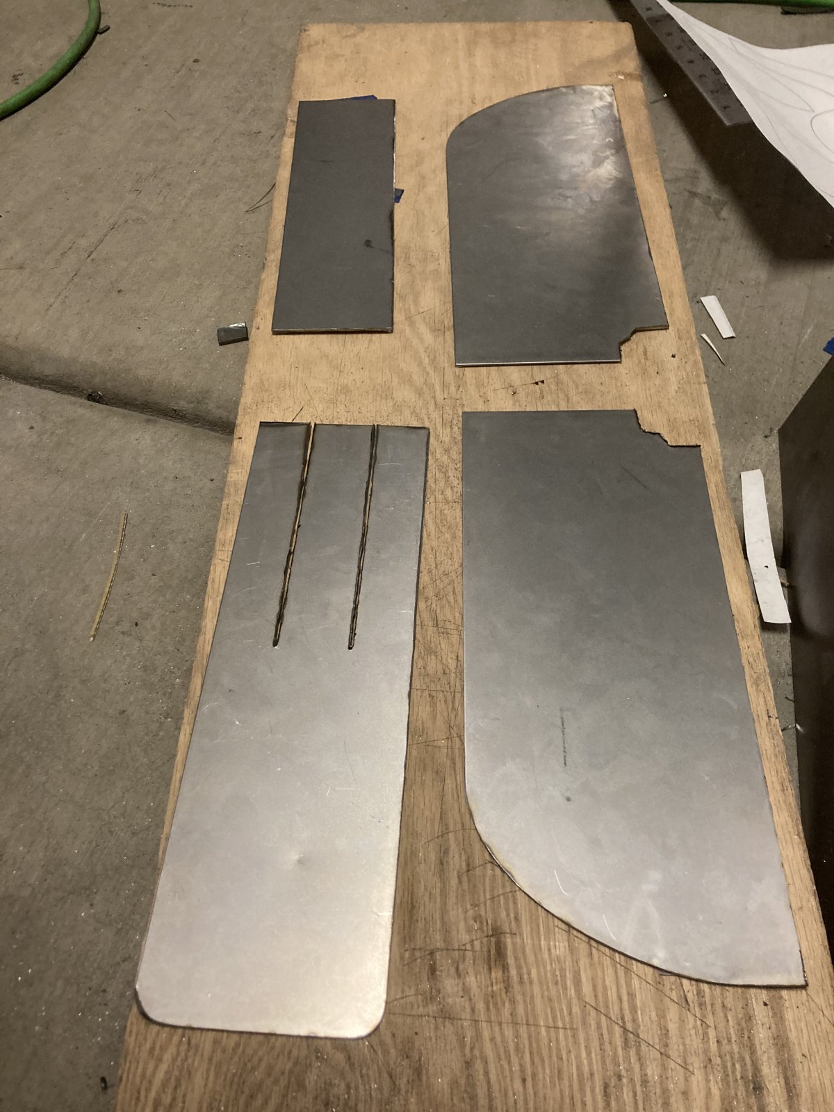

I am now using the top down/bend view to align my sheet metal parts. It gives a nice WYSIWYG profile of the part and makes for simple corrections in bend radius, flange, and setback. There is still some math involved, and constraints need to be remembered, but the math now is 3rd grade level. Had I figured this out earlier, I would have saved hours and numerous gray hairs doing the math I avoided learning in college. Now I understand why good fab shops pay a CAD guy to do all of this stuff...
Kinda bummed I’m literally designing the last piece of cockpit sheet metal at this point, bit I’m grateful to have learned so much in the process.
The Goblin has been mostly an experiment and challenge to learn new abilities. I doubt I’ll ever part with it. Holy ***; I’ve challenged myself and learned more than I ever thought I would so far on this build!
My next proposed car (Rorty Shotgun) will have much of this Goblin build experience buillt in.

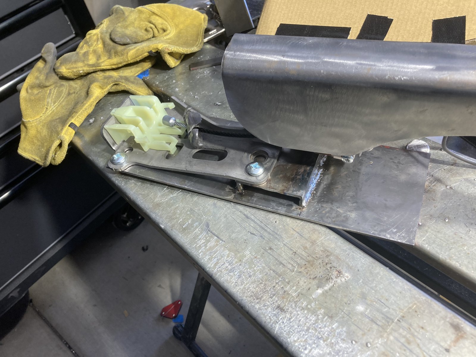

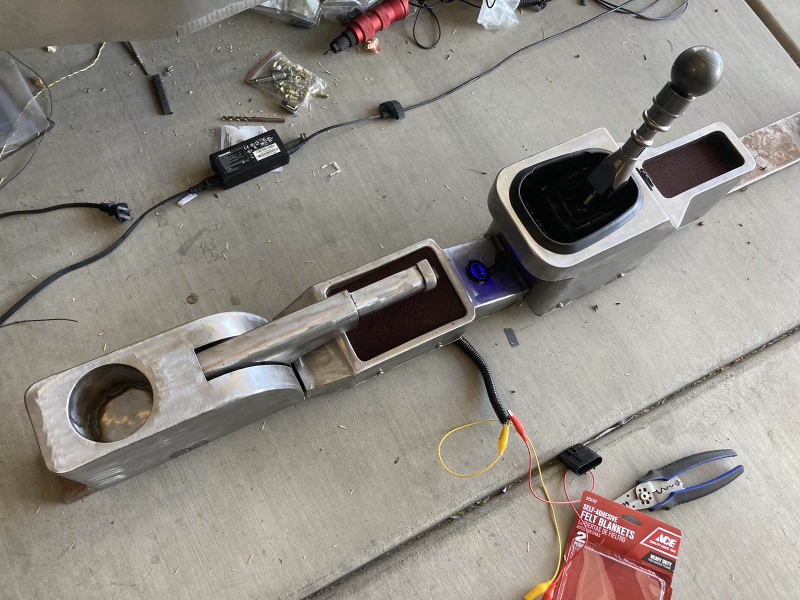

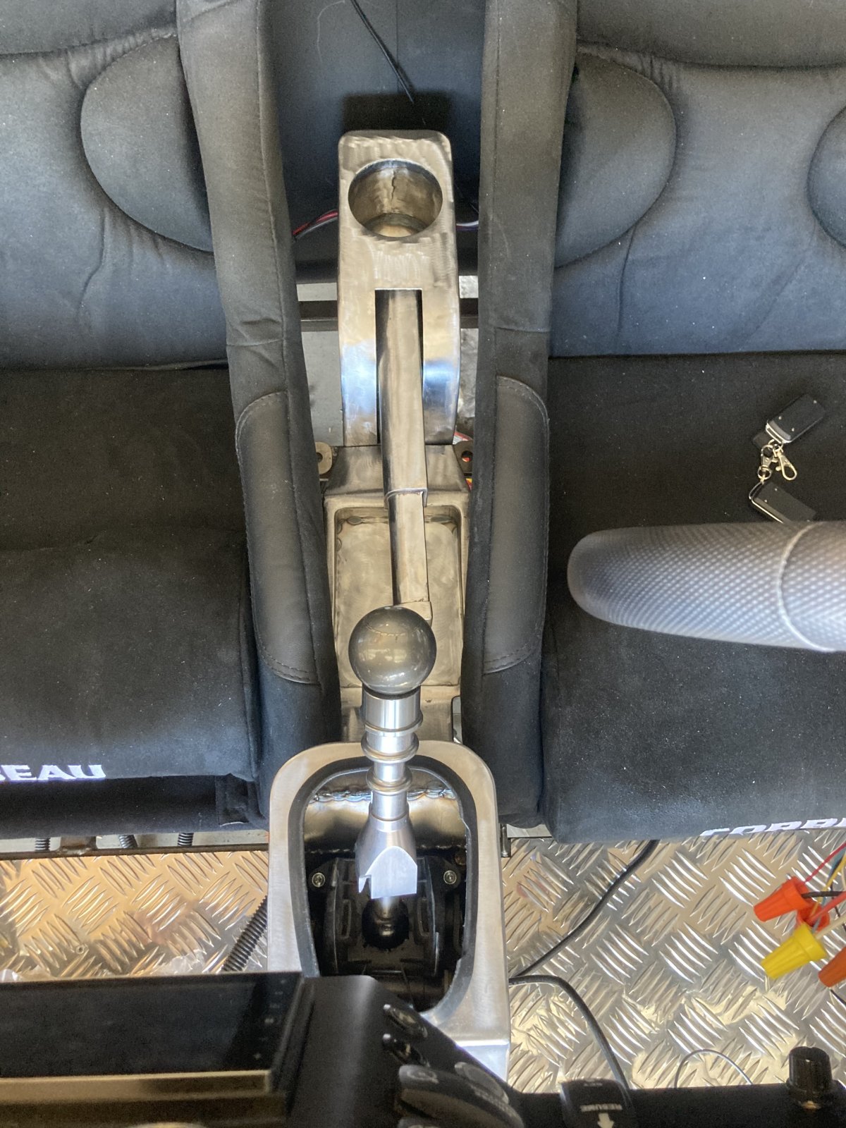

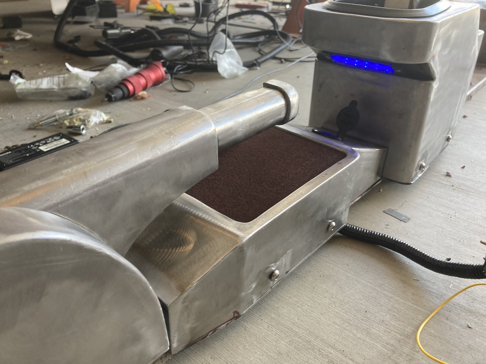

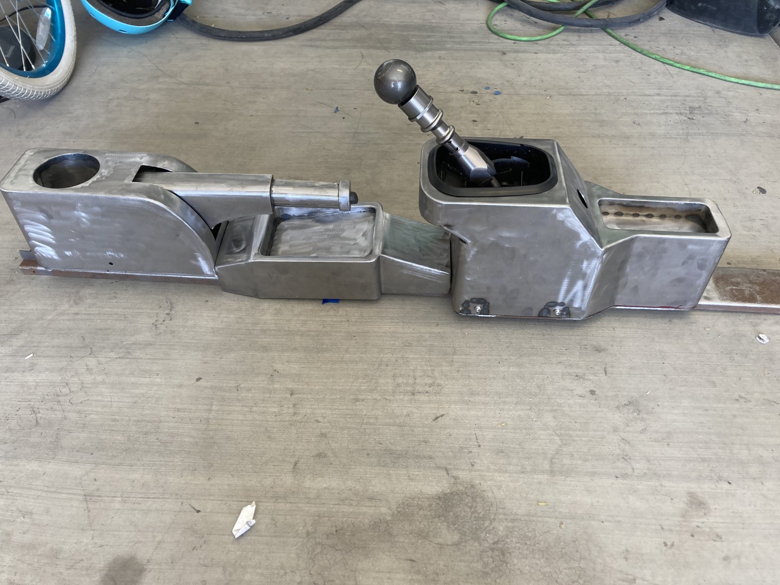

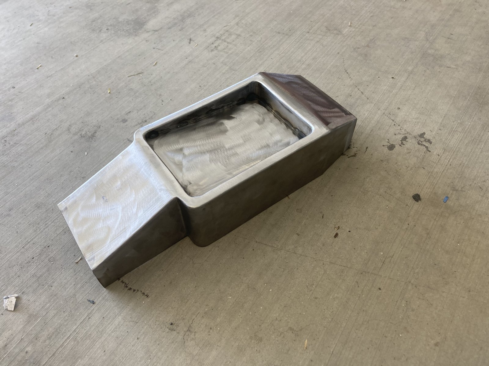

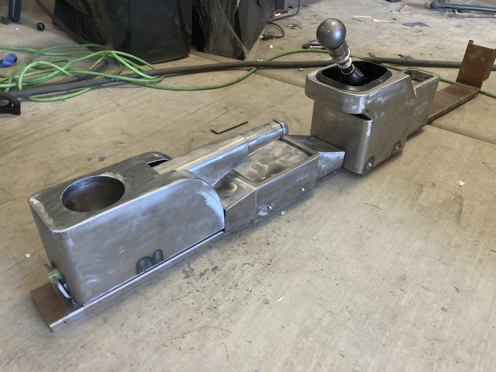

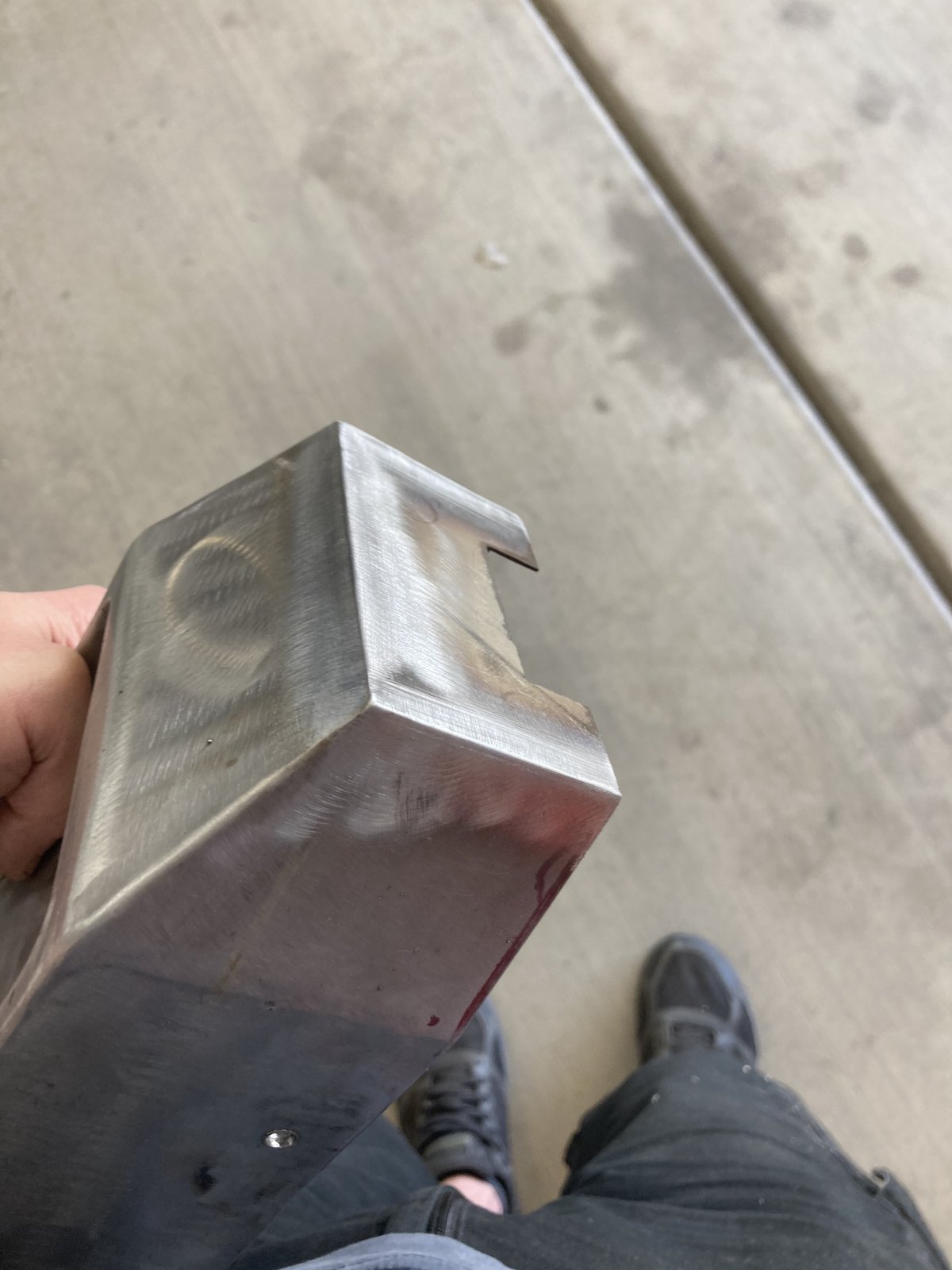

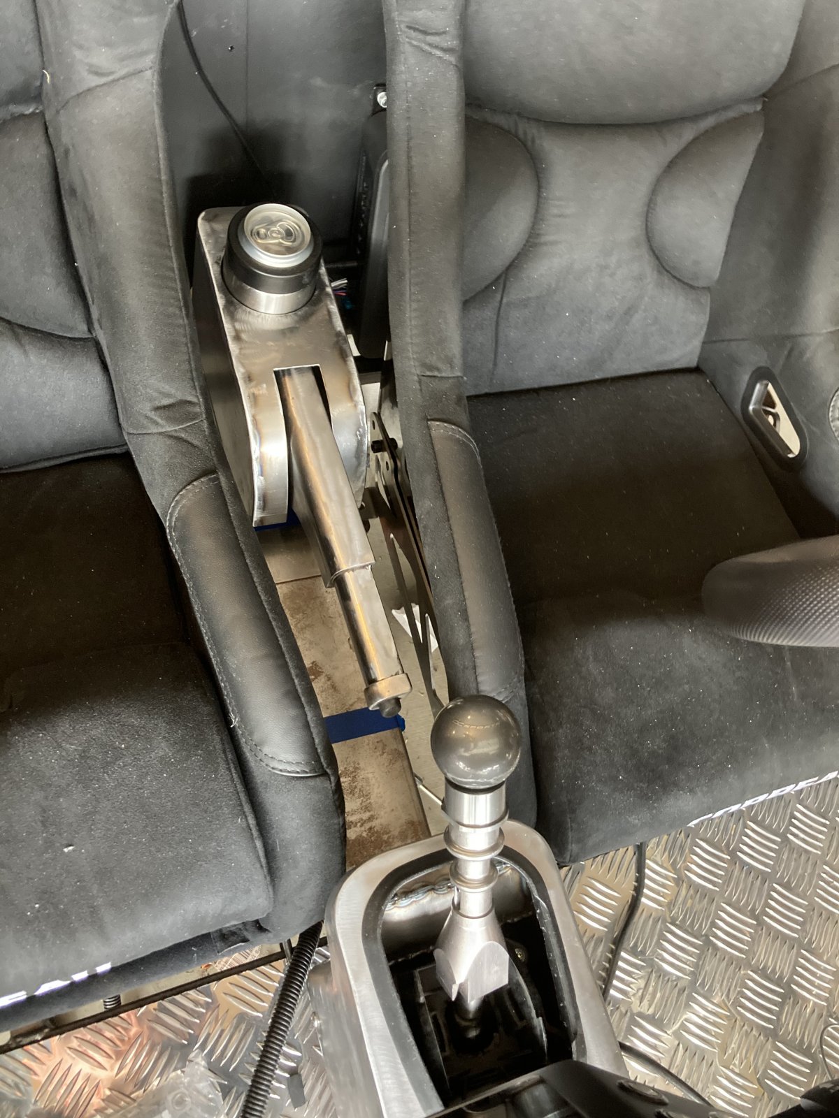

Finished the intermediate center console. Will build the parking brake and tunnel cover mount tomorrow if I don’t run out of welding gas. Also plan to get the floor panels bolted down and do a good check for subwoofer rattles.
Brian74

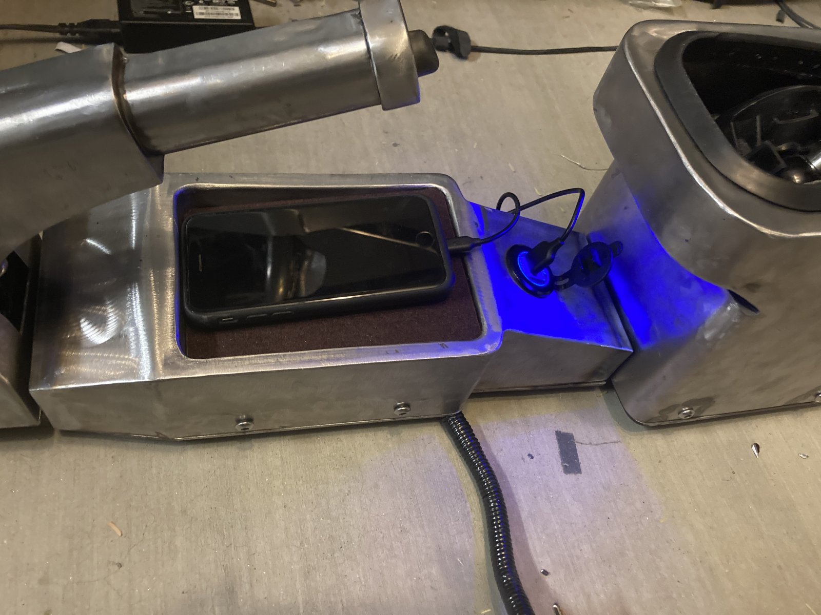

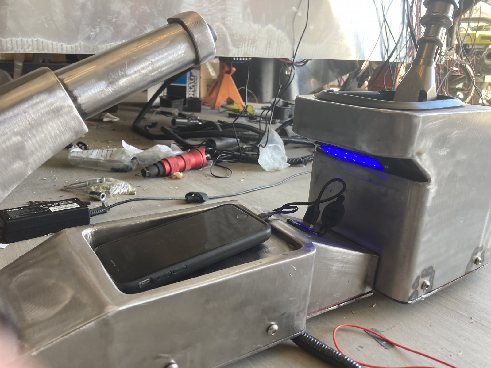

Finalized the center console. Added USB port, lighting, and built the wiring harness to run everything.
Waiting on some parts to build my very last custom touch... retractable fog lamps. Aside from finalizing the wiring and some minor welding, I’m just about ready for powder coat.

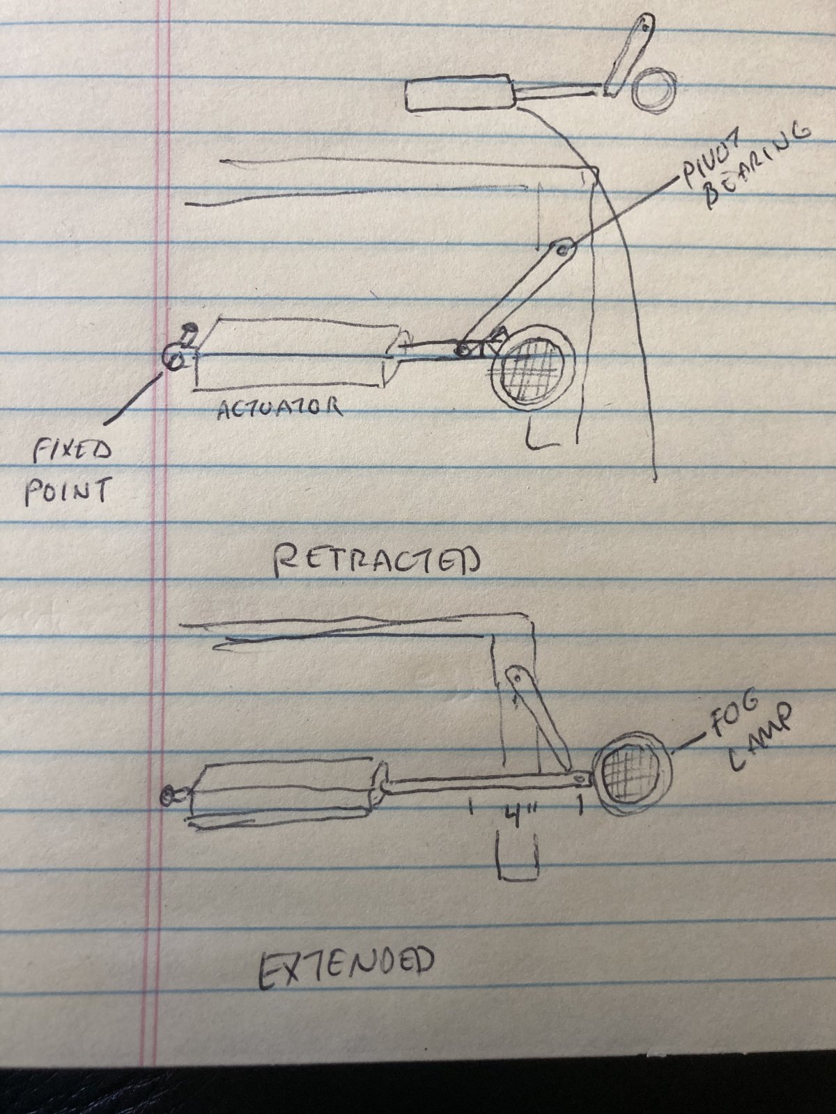

Stepping into my next project, which will be fully actuated fog/driving lamps that will automatically hide away when not in use.

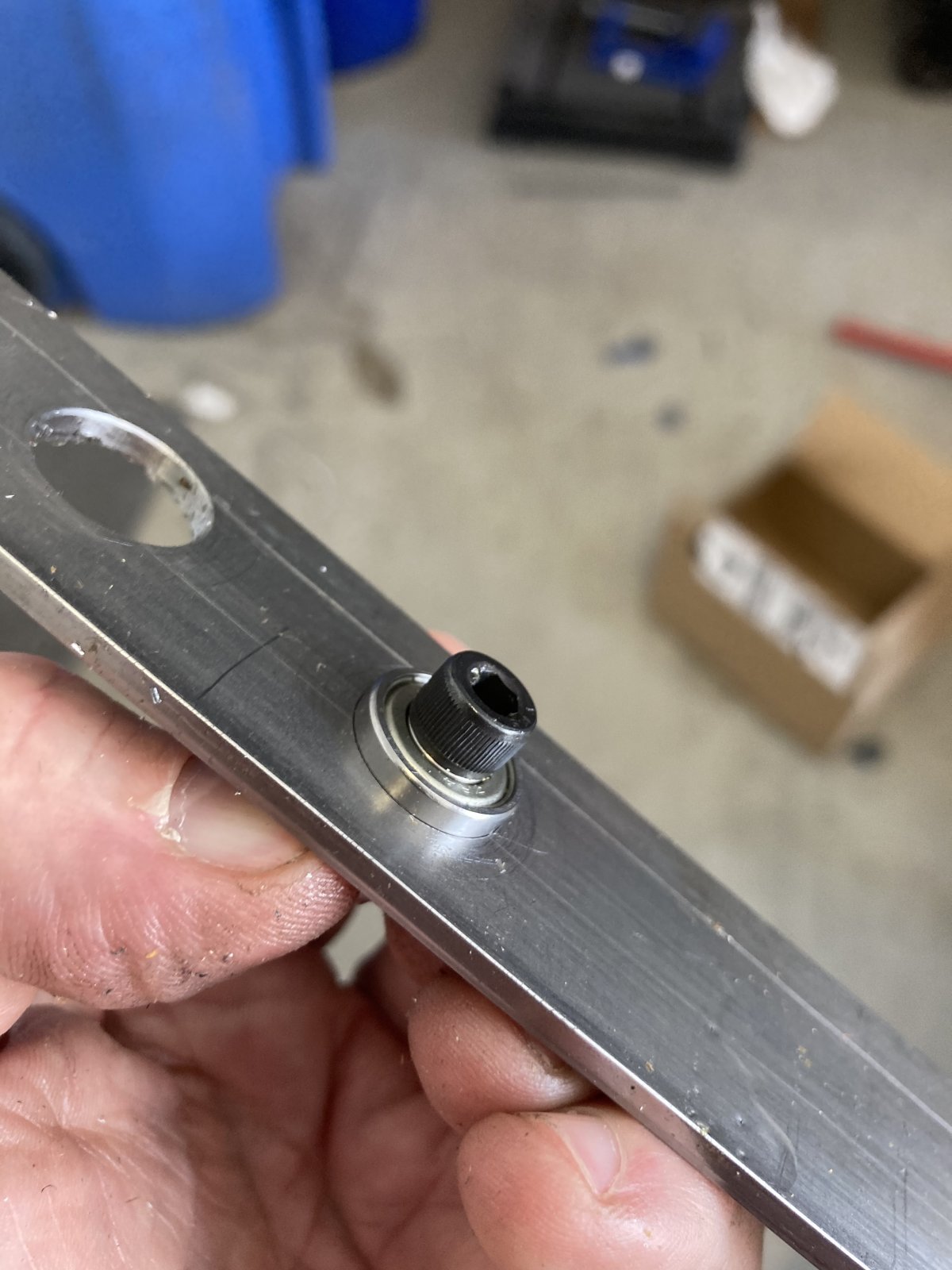

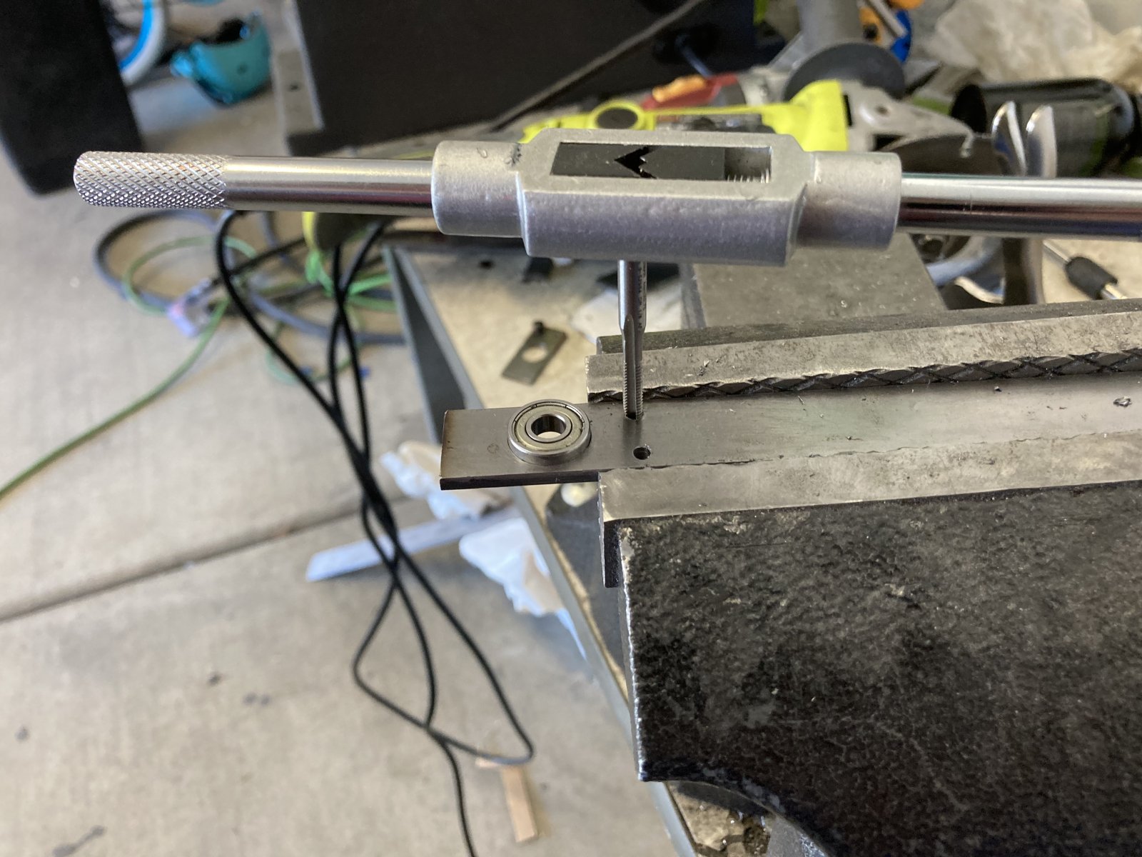

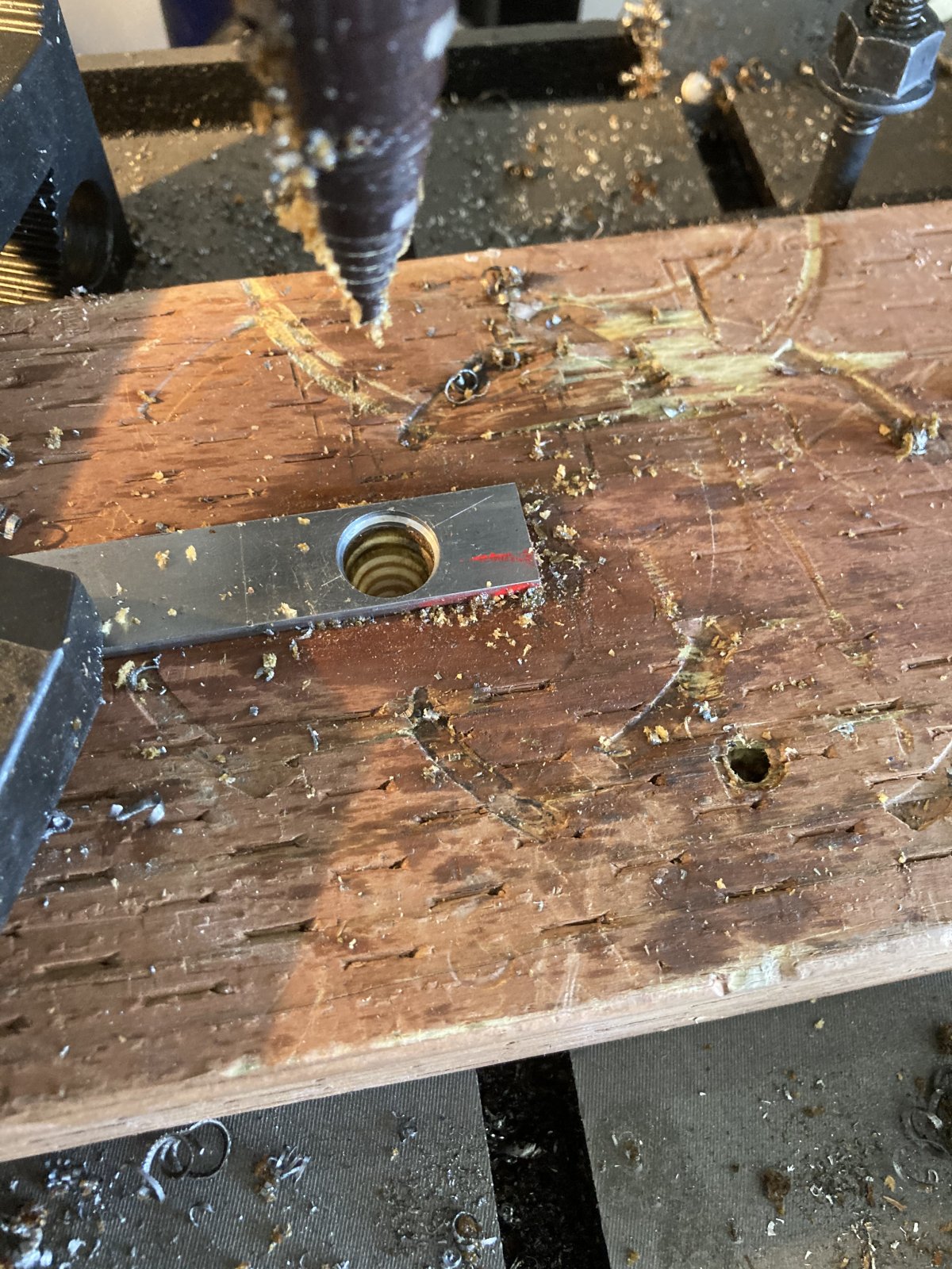

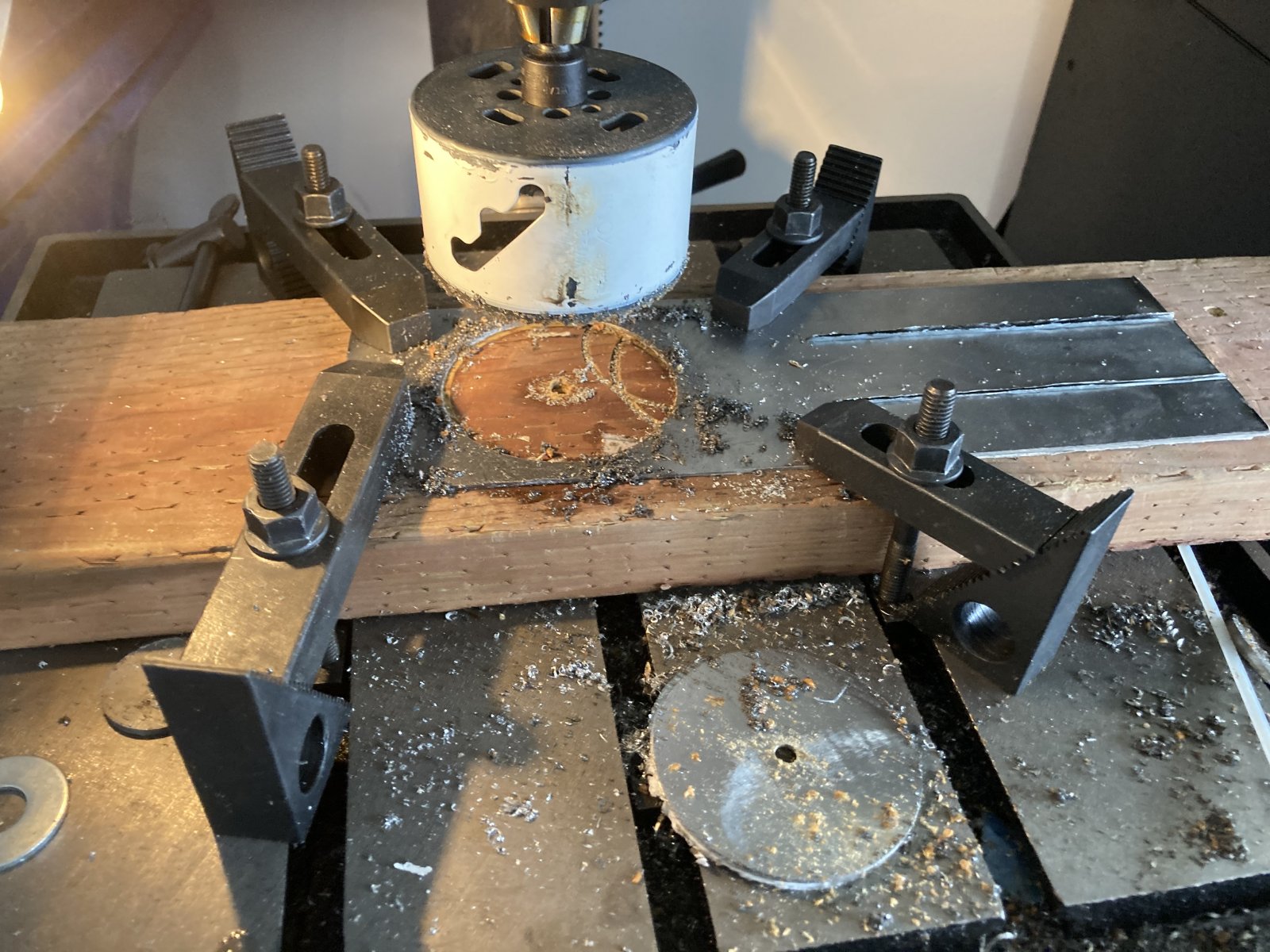

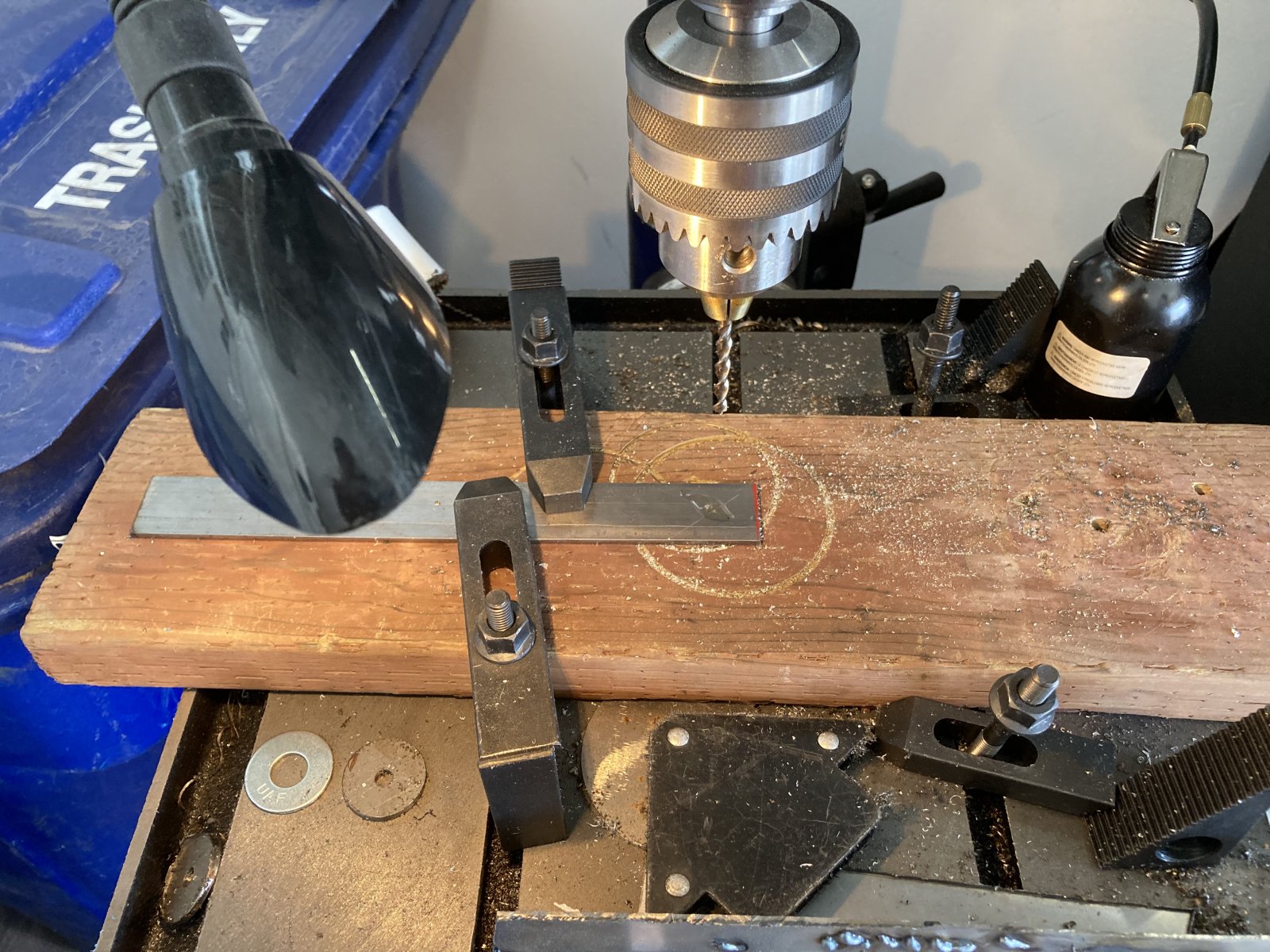

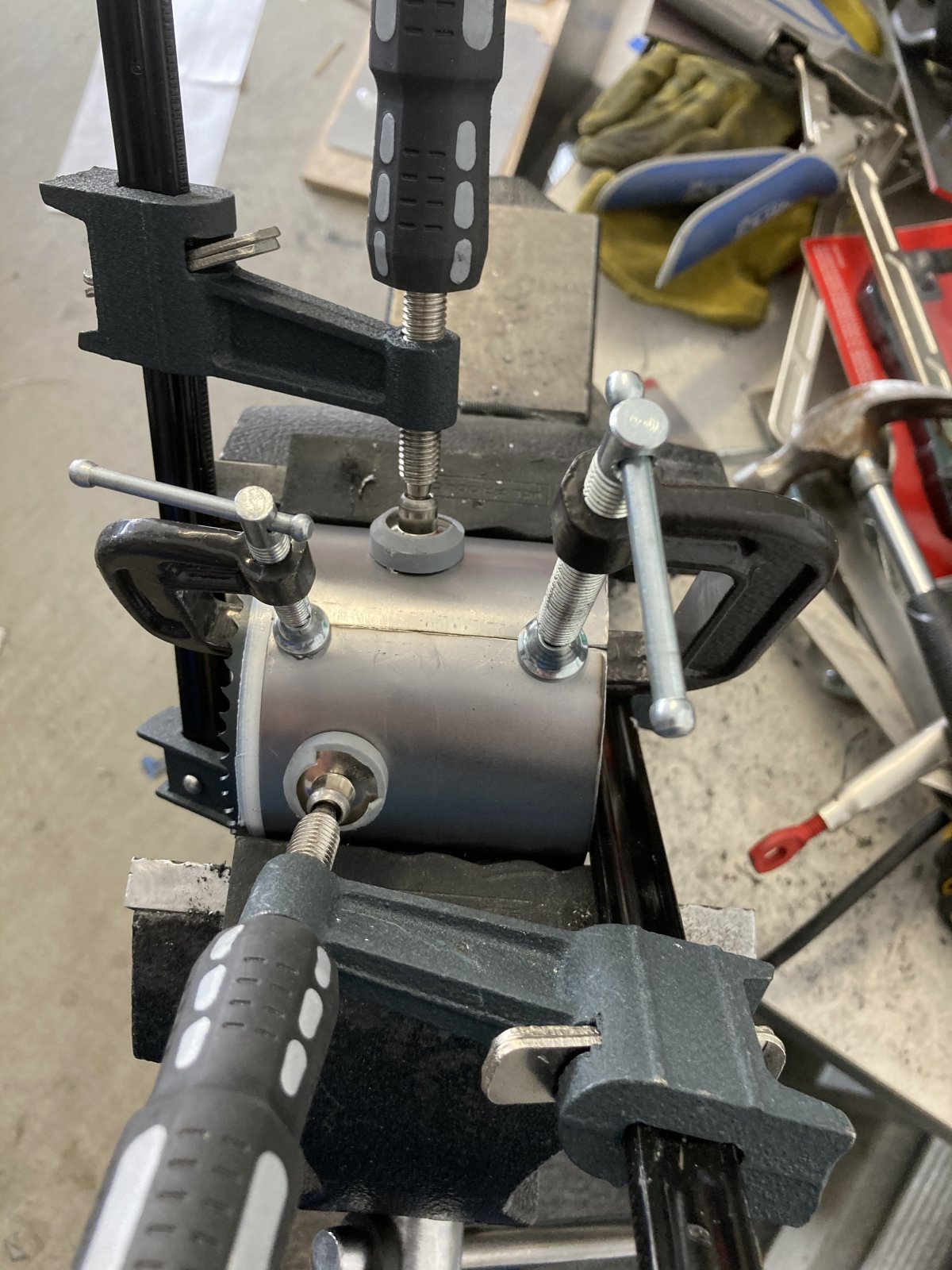

Spent 3 hours at the hardware store, where most of my brainstorming happens. Was able to find some 5/8 OD precision bearings. I decided to chamfer two pieces of 1/8” stock using a step drill bit and sandwich the bearings between them. This worked out well. The bearing ID works well with a 1/4” bolt.
Got the bearings test mounted and played with the actuator. I need about 5-6” of throw, but I think I can get that using a properly positioned 2” actuator instead of the 4” actuator.

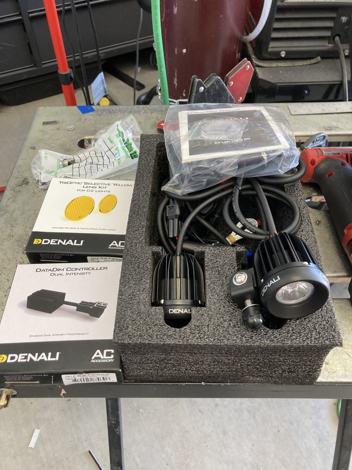

These Denali tri-optic lights are pretty nice as well.

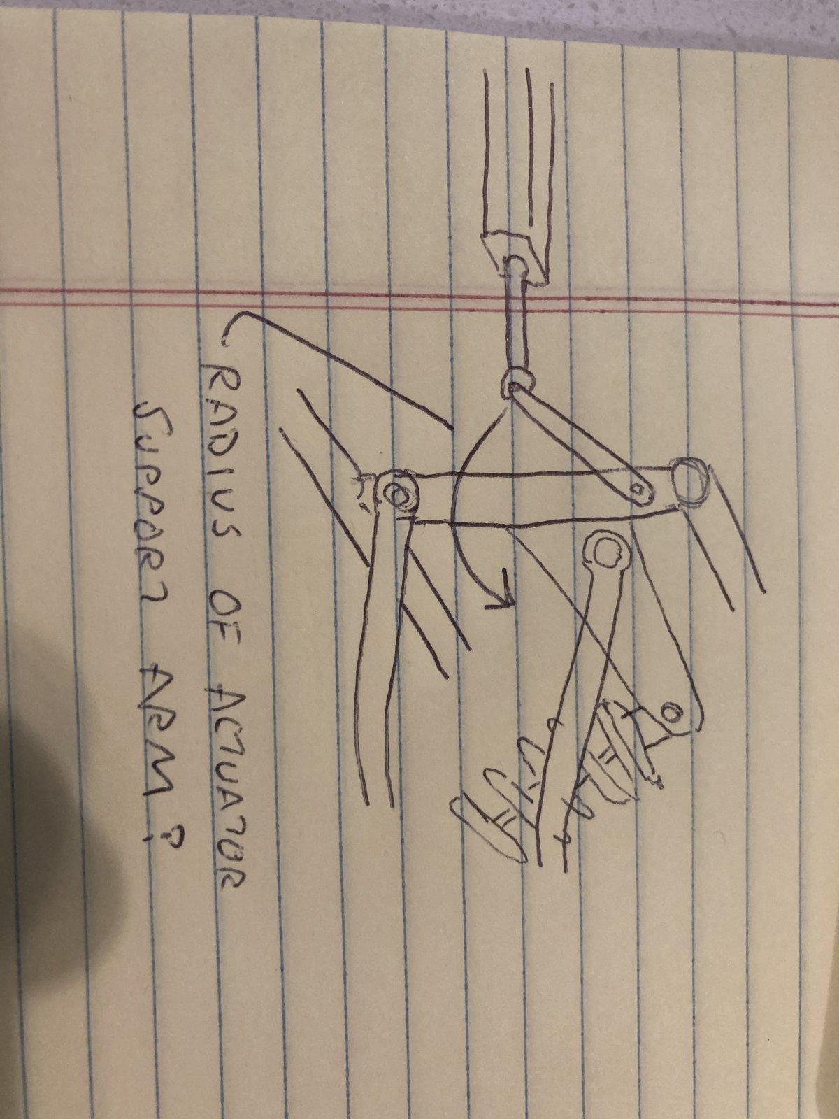

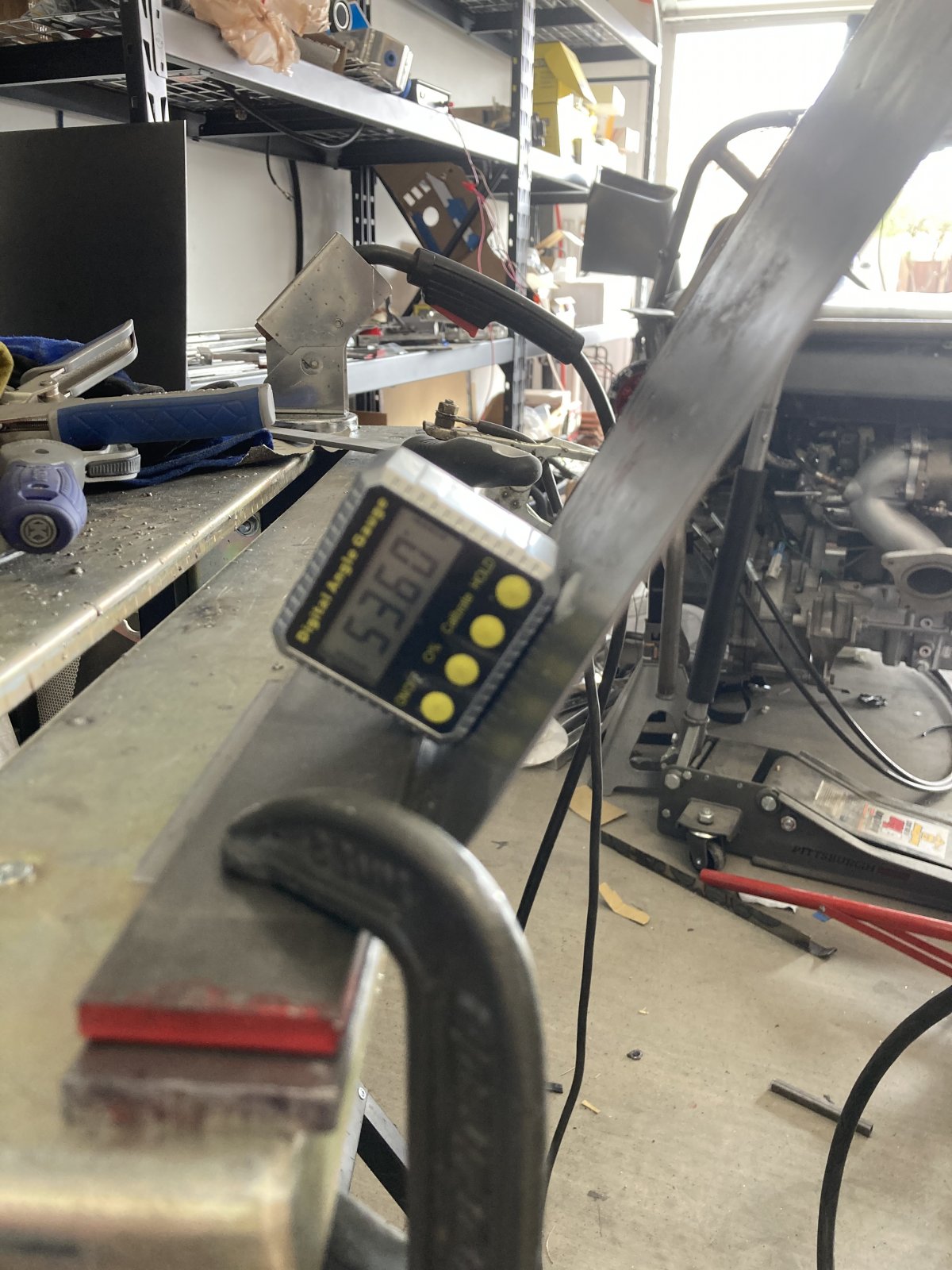

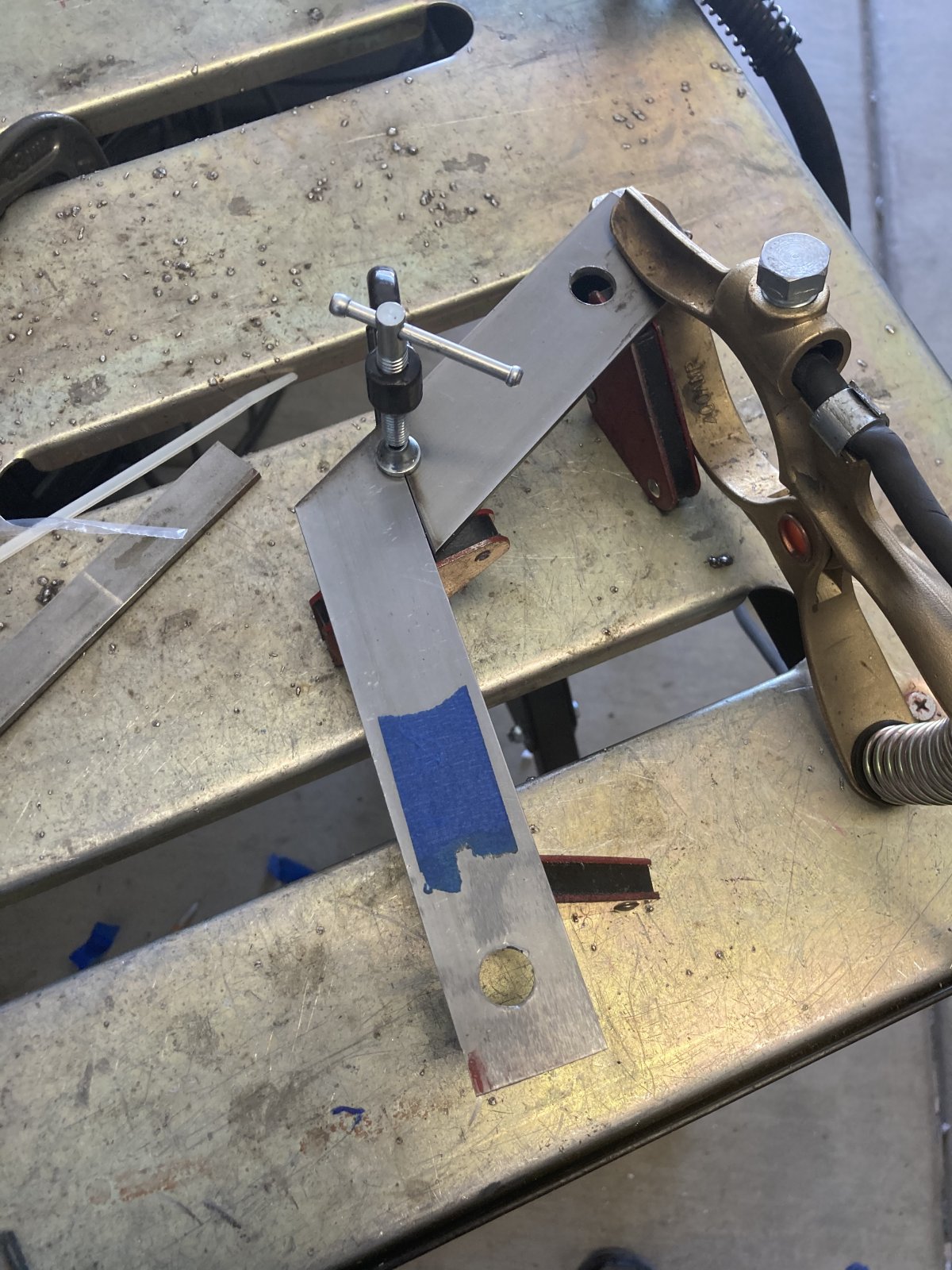

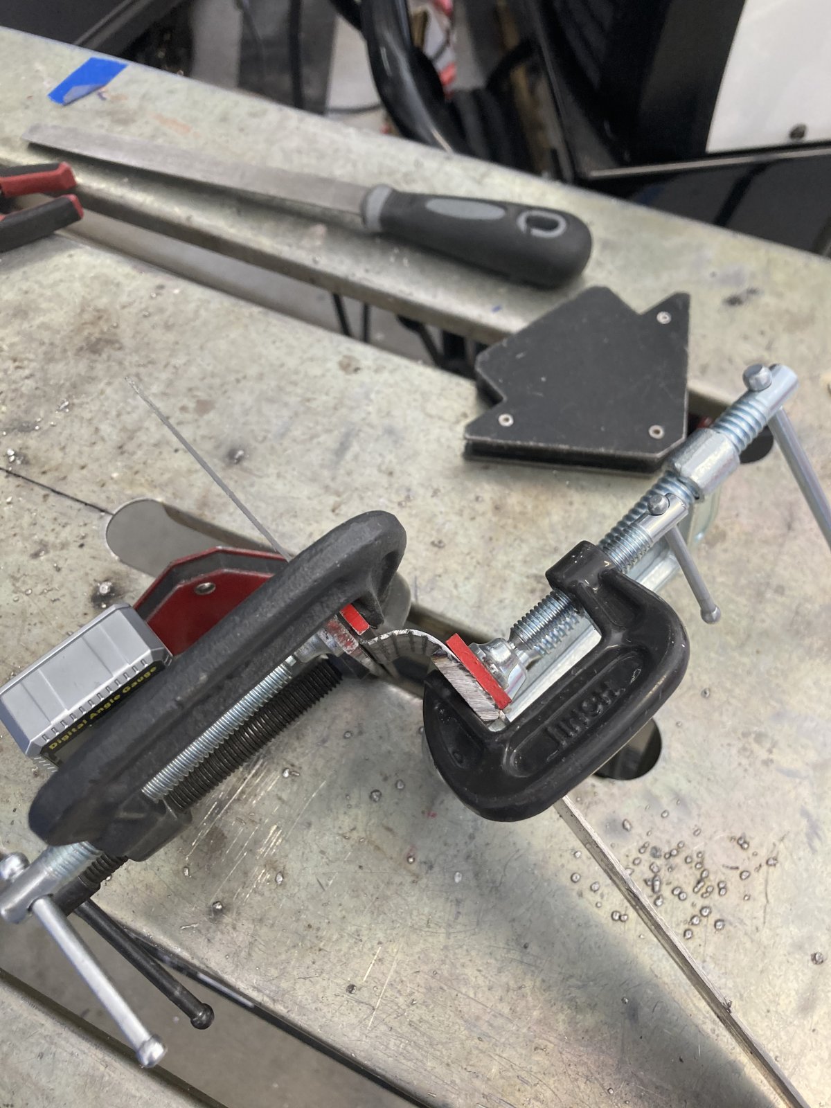

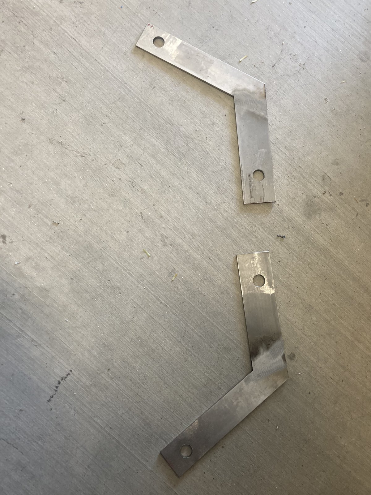

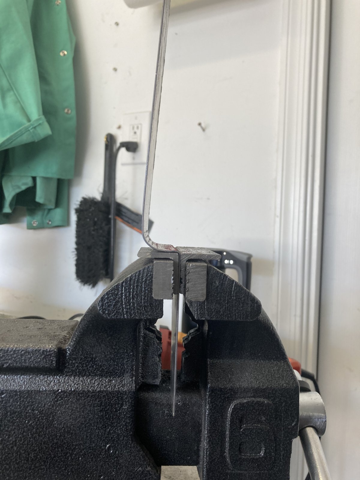

Mockup of the fog light actuator bracket... I started making frame measurements today. This will be a simple bolt-on design utilizing the U&L control arm bolts. There is adequate room for the fog lamps to tuck behind the cowling when not in use. When they are on & extended, they will locate approximately centered between the coil over & cowling; just above the lower control arm.
I will make a base frame piece and determine the lever pivot point and machine the bearing pivot. Next, I will rescale the dimensions for the actuator mount and actuator arm and machine the actuator bearing pivot points.
I am slightly concerned with the design of the lever arm and fog lamp mounting point as wind speed will stress it slightly. Will probably machine down some 1/8”x 1/2” L-bracket for better rigidity without adding too much weigh and add a lower support bracket to provide a resting stop for the actuator and additional support for the lever arm.

My actuated fog lamp prototype is finished. Super happy with it; they function exactly as I had planned.
These fog lights are very bright; I will use the wide diffuser lens and it should put a fair amount of light around the front. Still need to machine the actuator pivots for the precision bearings.
