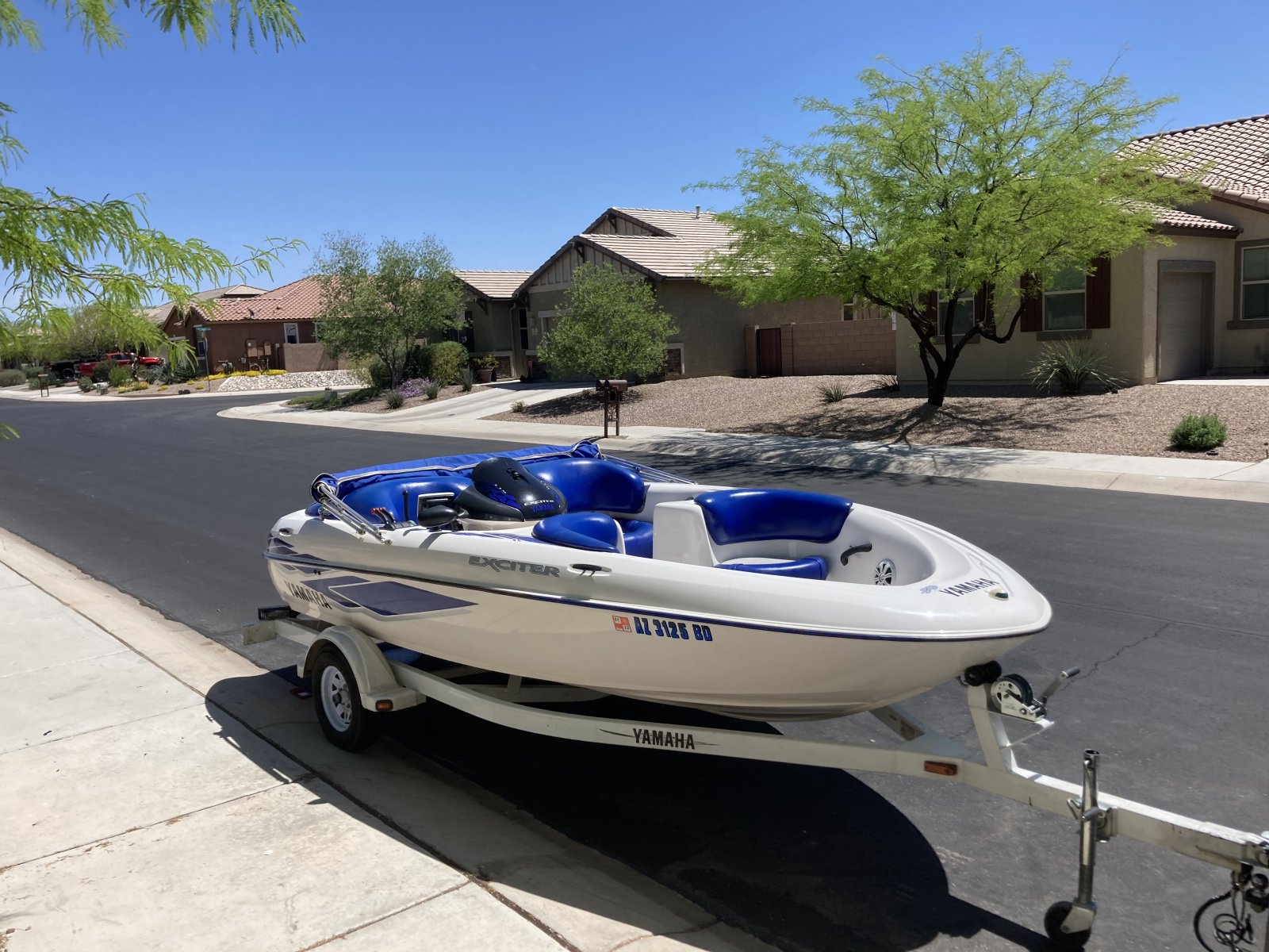

Today I got my boat back together (99 Yamaha Exciter; if DF Goblin made a boat, this would be it). Its somewhat of a collector’s item. Previous owner had the carbs rebuilt improperly. I went through them and found wrong gaskets installed; causing pressure loss at the pop-off valves. I will take it to the lake this week for a test & tune and then sell it. This will free up a bay in my garage to add the space & additional metal fabrication tooling I’ve been wanting.

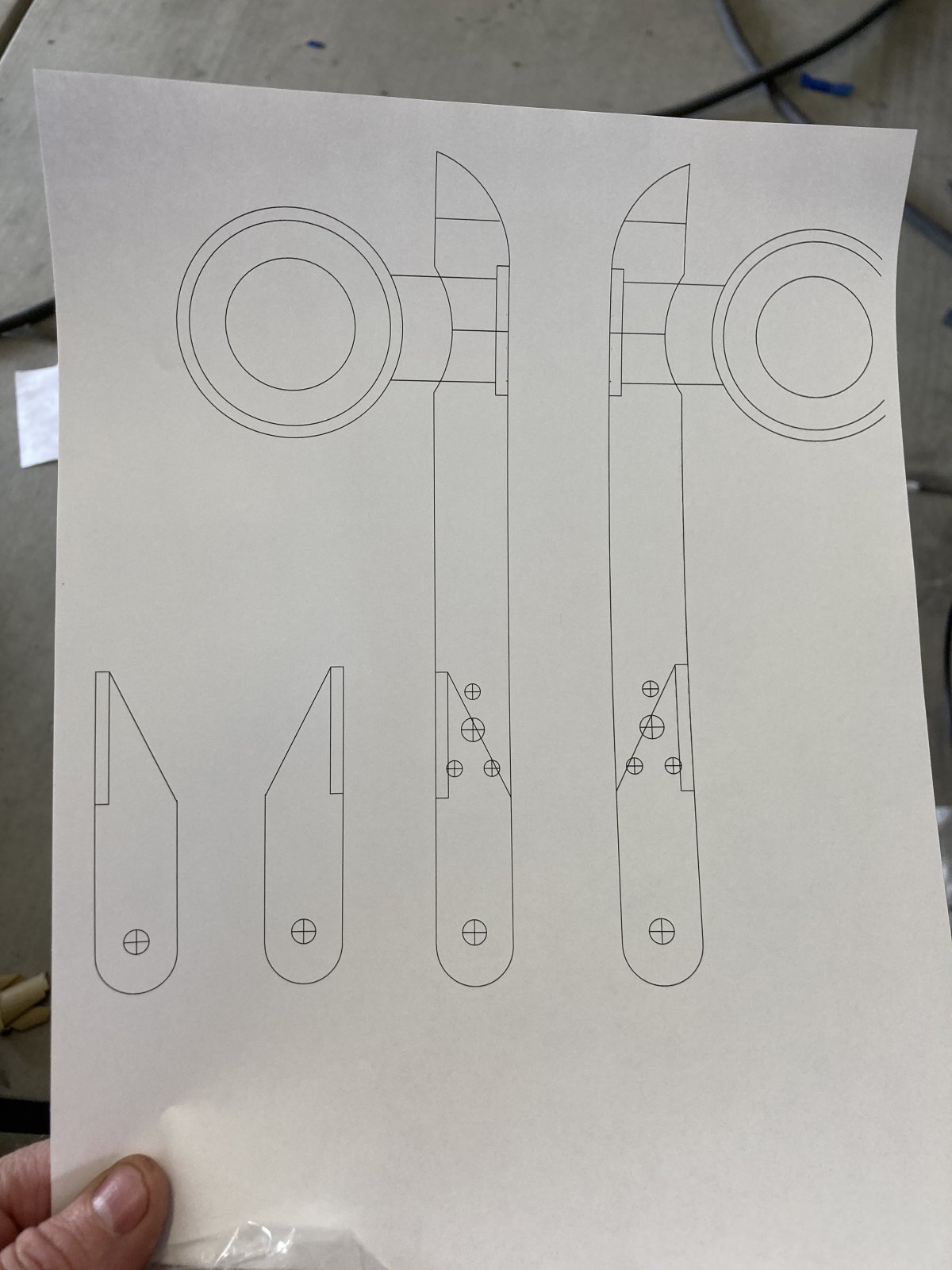

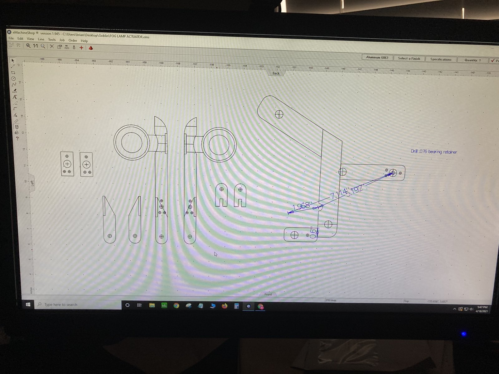

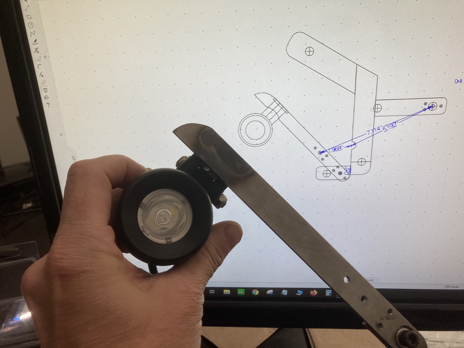

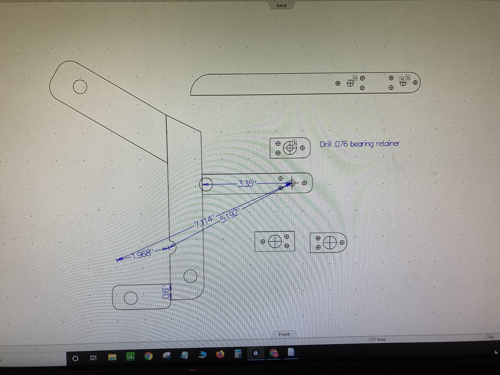

I spent some time today cleaning up the fog lamp actuator hardware with a good computer mock-up. I rounded out some of the corners and added rubber bump stops at both the extended and retracted positions (this will reduce static loads on the actuator). I also added bearing plates. I will build them this week. I’m sitting just under a 2.5 lb. load with the actuators rated at 5 lbs.

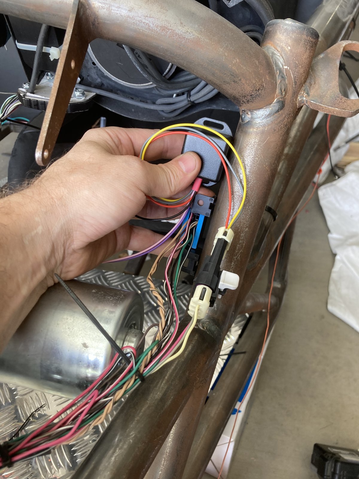

I decided to start on the wiring today. Super intimidating, but not too bad if its broken down to one circuit at a time.

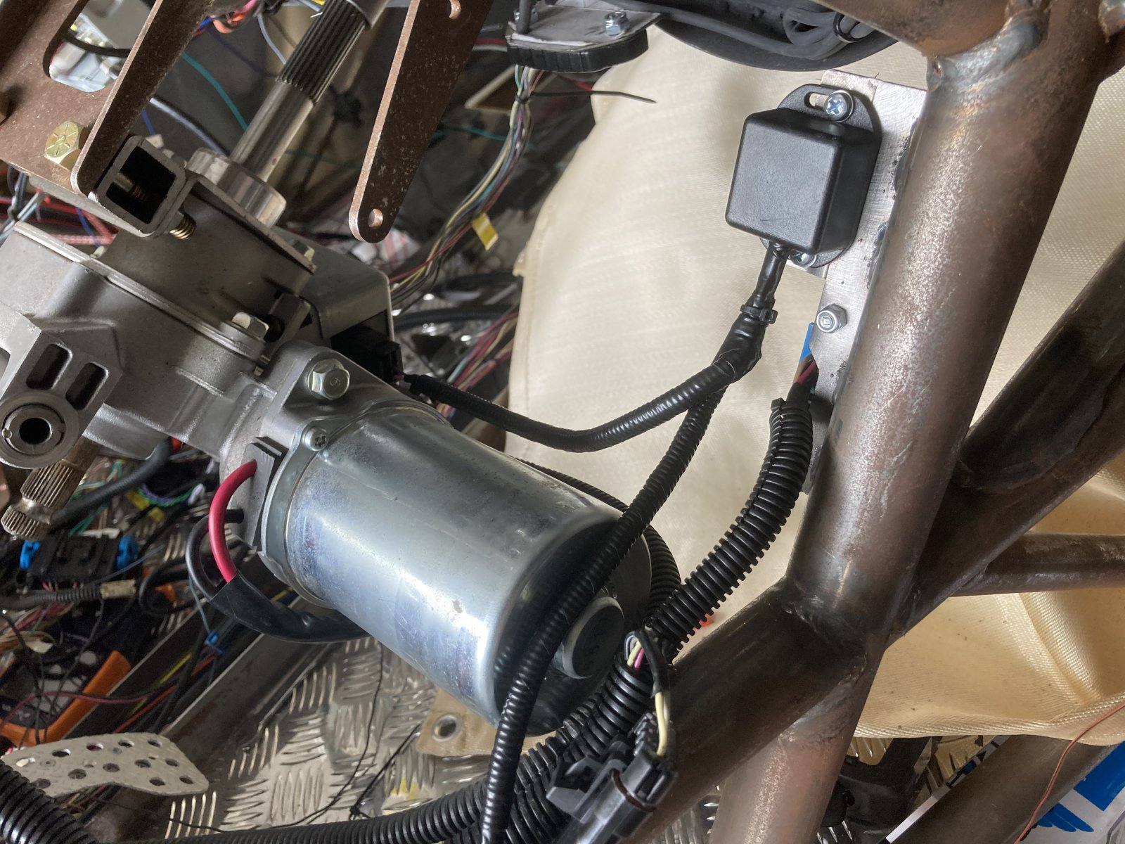

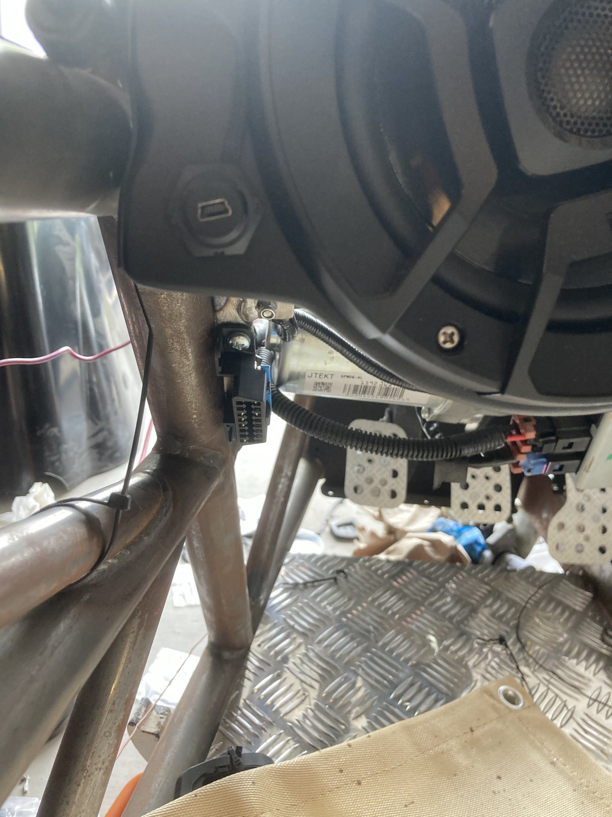

First 2 issues were where to locate the data link connector and my adjustable power steering module.
I removed the cobalt EPS unit and installed the Saturn one. I had to cut the connector and terminate the CAN bus wires (the Saturn EPS does not reside on the CAN. I simply ran the CAN hi/low wires to a 120 ohm termination resistor and soldered it into the harness. With the adjustable power steering, the EPS just uses two signal wires from the module; super simple.
I found a great spot to mount the module and the DLC just below the left side of the dash. I fabbed up a bracket and tacked it in.

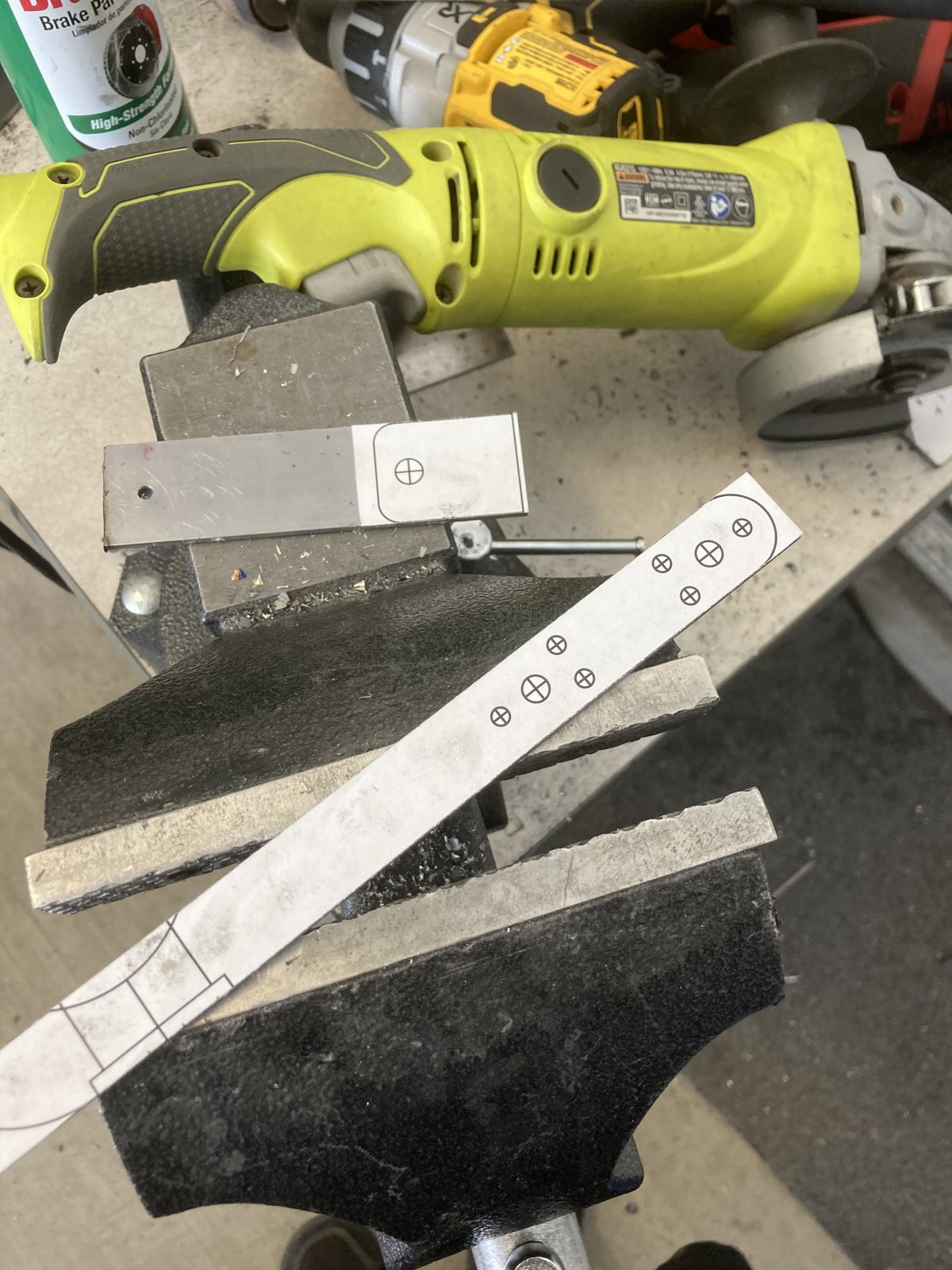

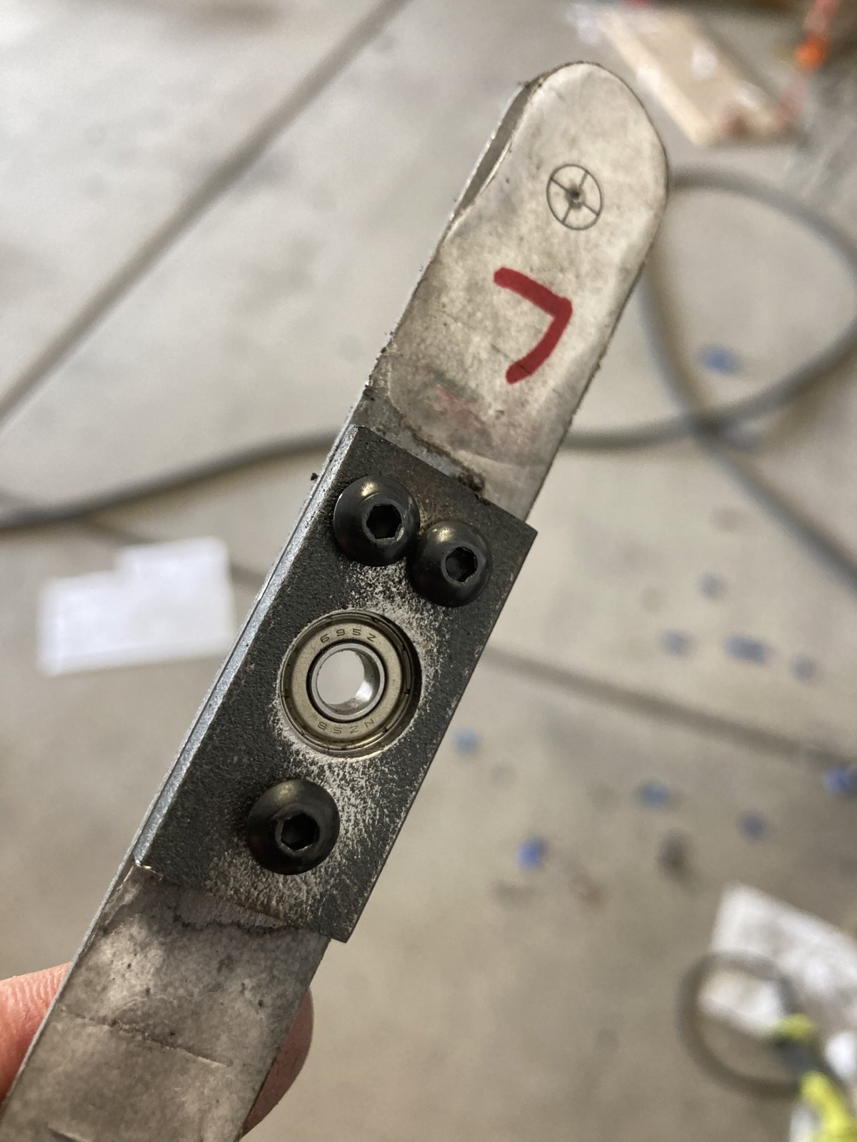

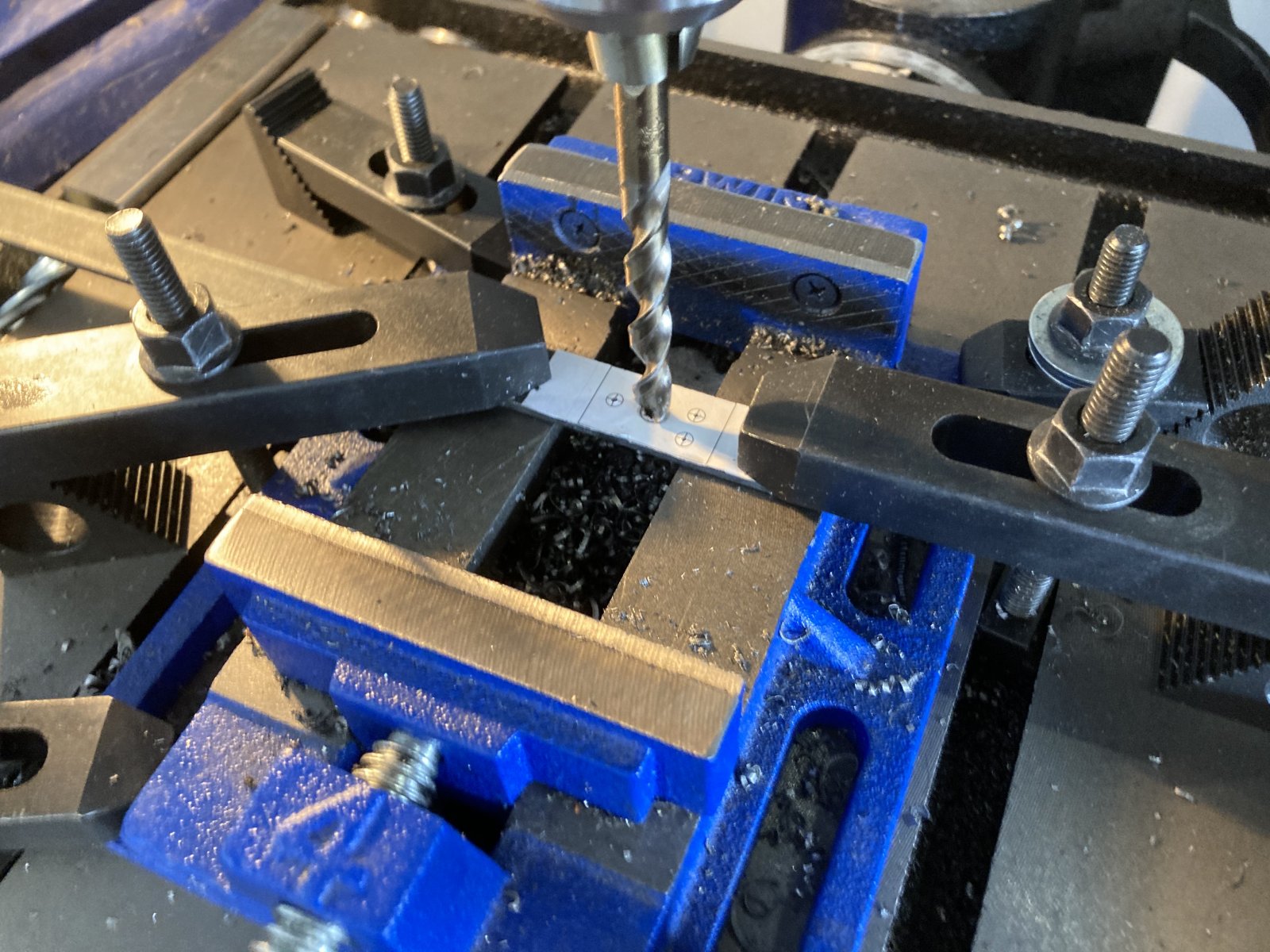

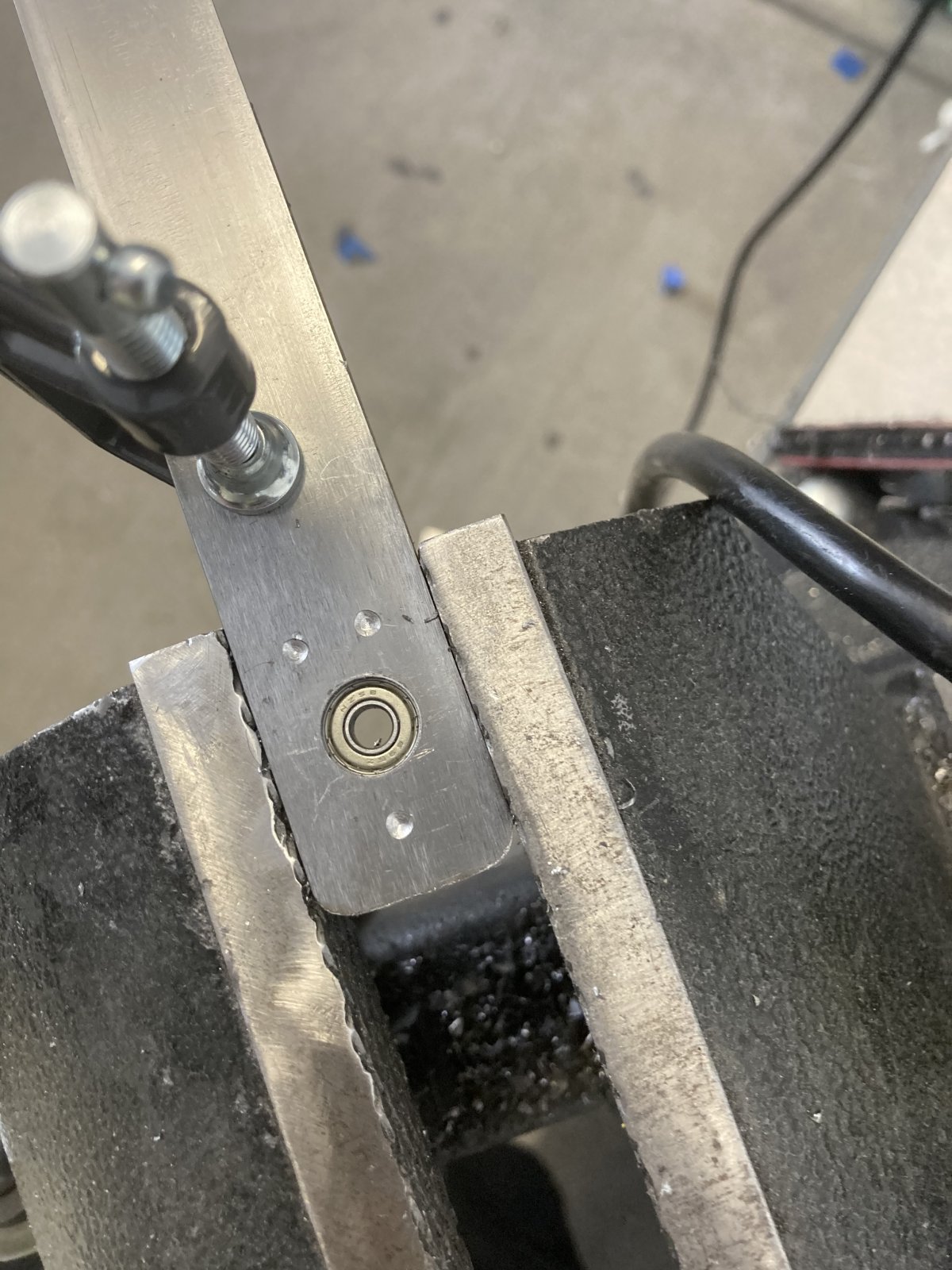

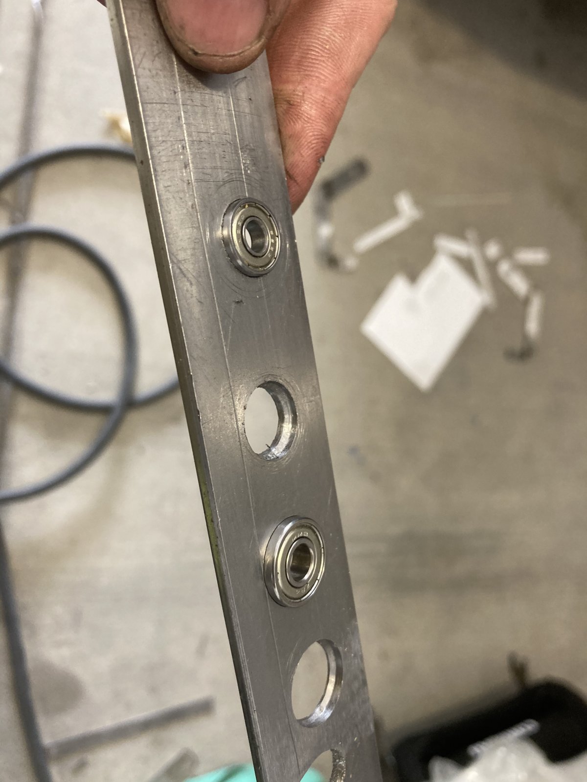

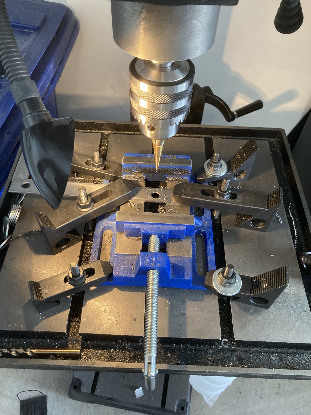

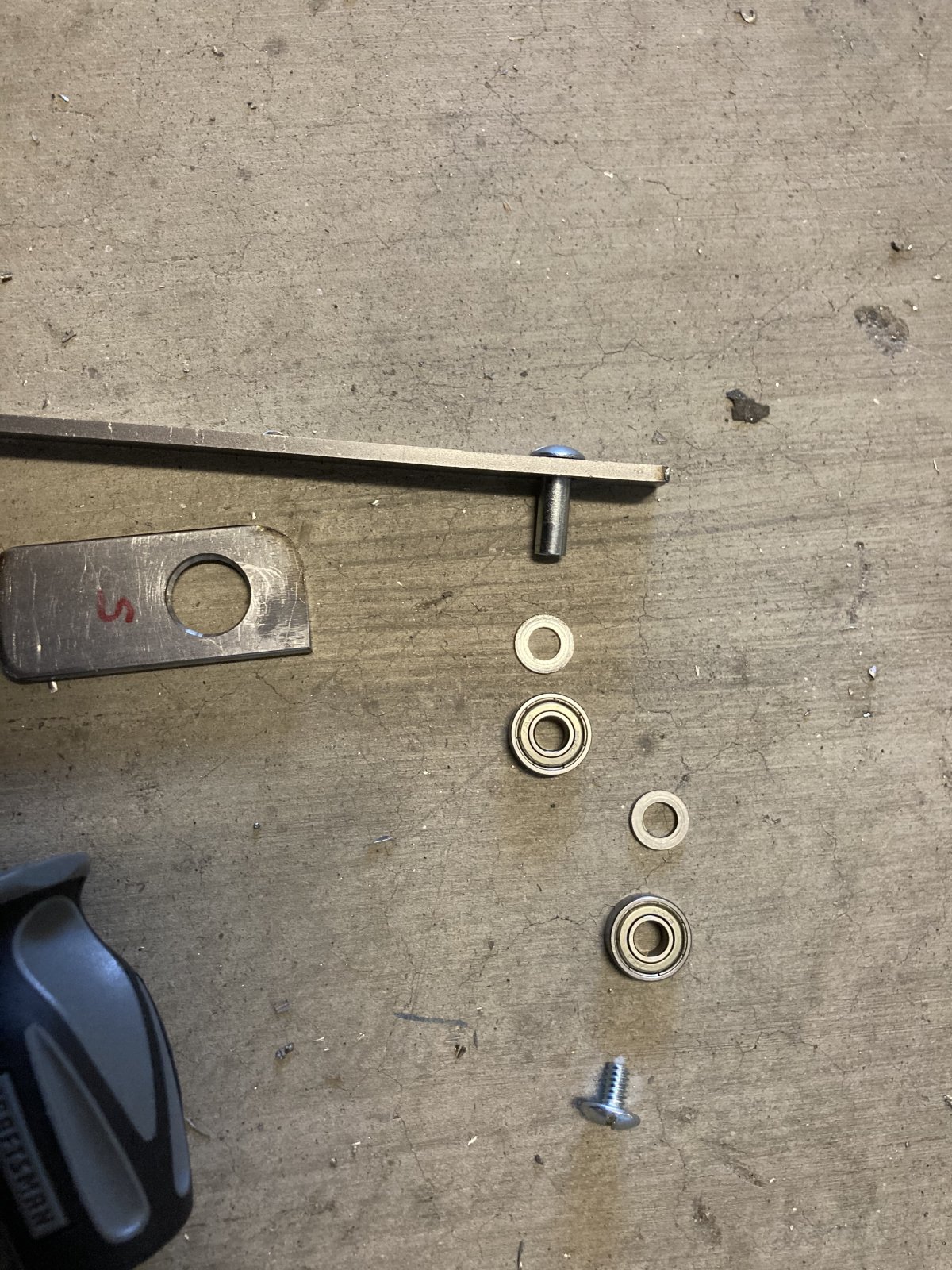

I got my 13mm drill bit in today. I test drilled some 1/8 sheet and the bearing fits perfectly. I will do some depth settings and then build out the bearing housings for my fog lamp actuators tomorrow.
Brian74

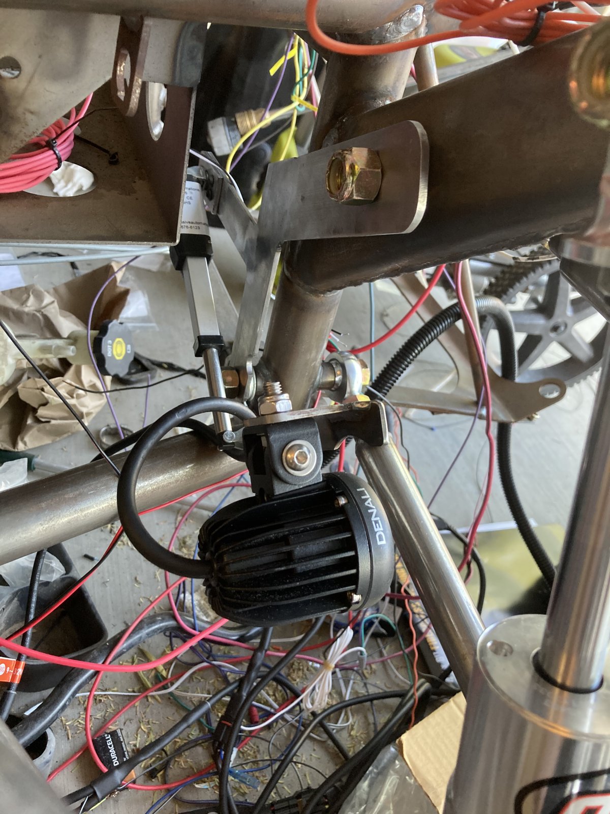

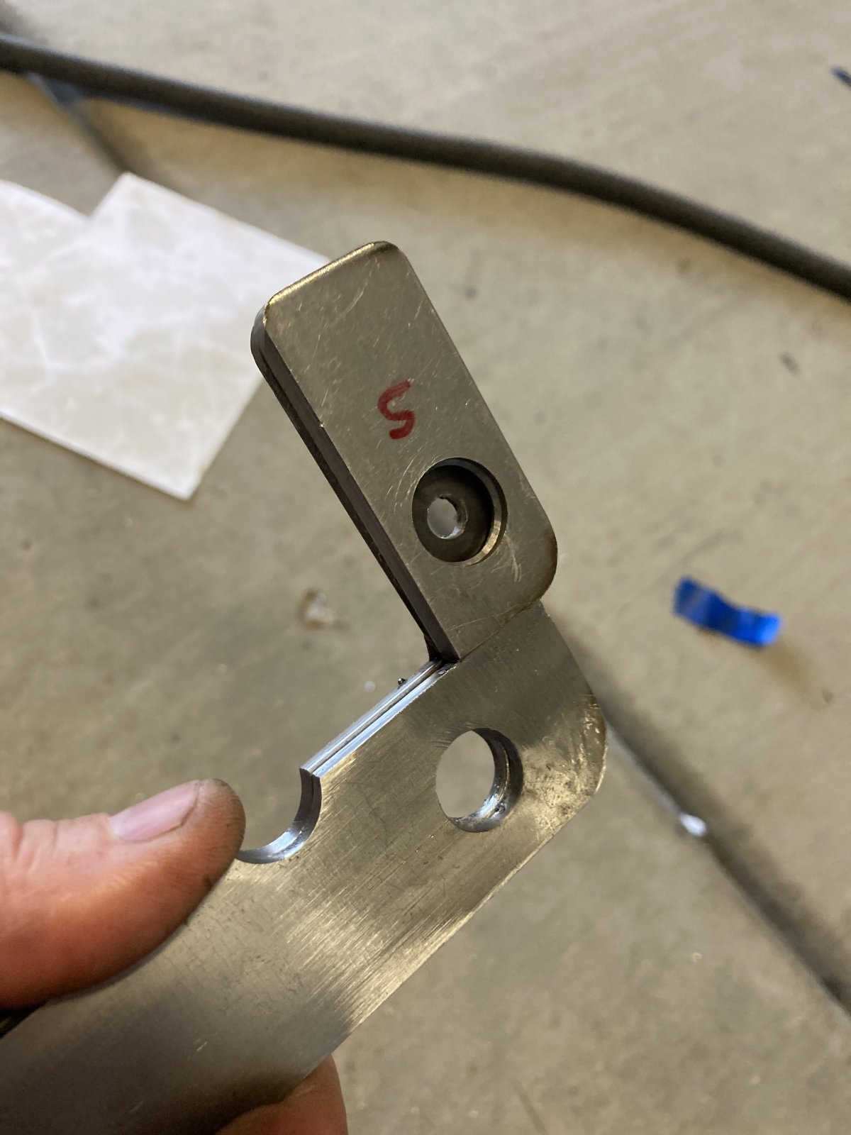

Got up this morning and drilled bearing housings all day long. Needless to say, every pivot point of my driving light actuators is now on bearings. I need to fix the depth adjustments on a few of them and I’m debating on running Delrin travel stops, and doubling up on the lower pivot bearings to reduce lateral play. With these things set up properly, there is zero play in the down position. The actuators are well below their dynamic and static load. These should work well & last forever.
Brian74

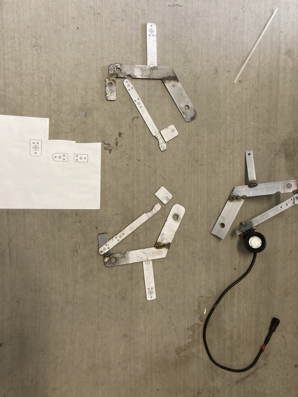

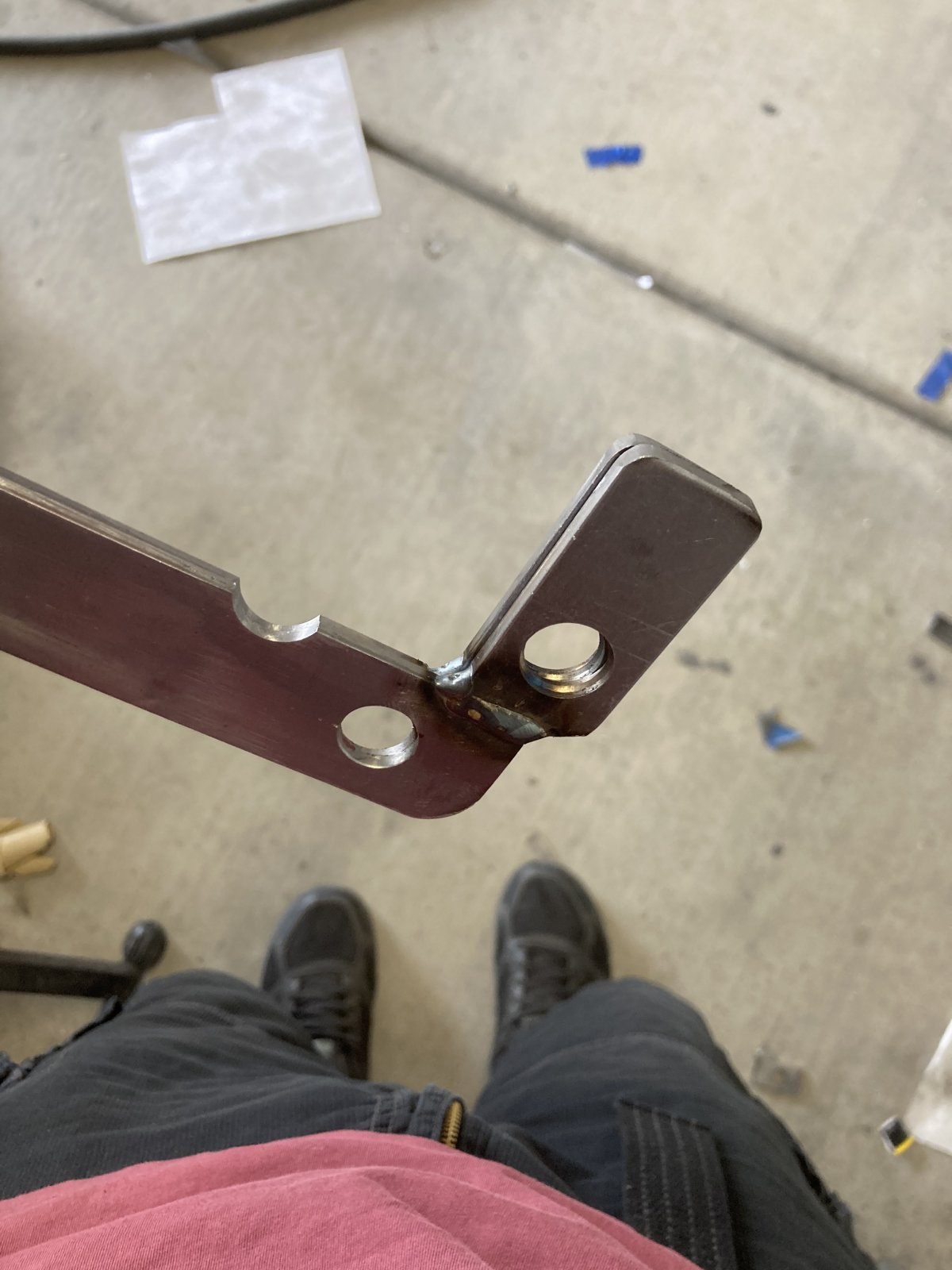

I wasn’t happy with the lower pivot bearing because I could not get all of the lateral play out of it. I decided to redesign it today. After much brainstorming, I decided to machine two bearings into a thicker piece of steel and then have a two point mount for the actuator arm. I mocked it up and it works perfectly. I also found some exact .250” inner diameter shafts for the bearings and proper thrust washers. There is zero side-play now and the pivot arm will be much stronger and less prone to wind deflection at higher speeds. The only remaining freeplay is in the actuator ends, which can be taken out using proper travel stops. Hopefully I can get one or both actuator assemblies built up tomorrow...
Really need to get back to finishing wrapping my wiring harness.
Brian74
More brainstorming today and another hardware store trip...

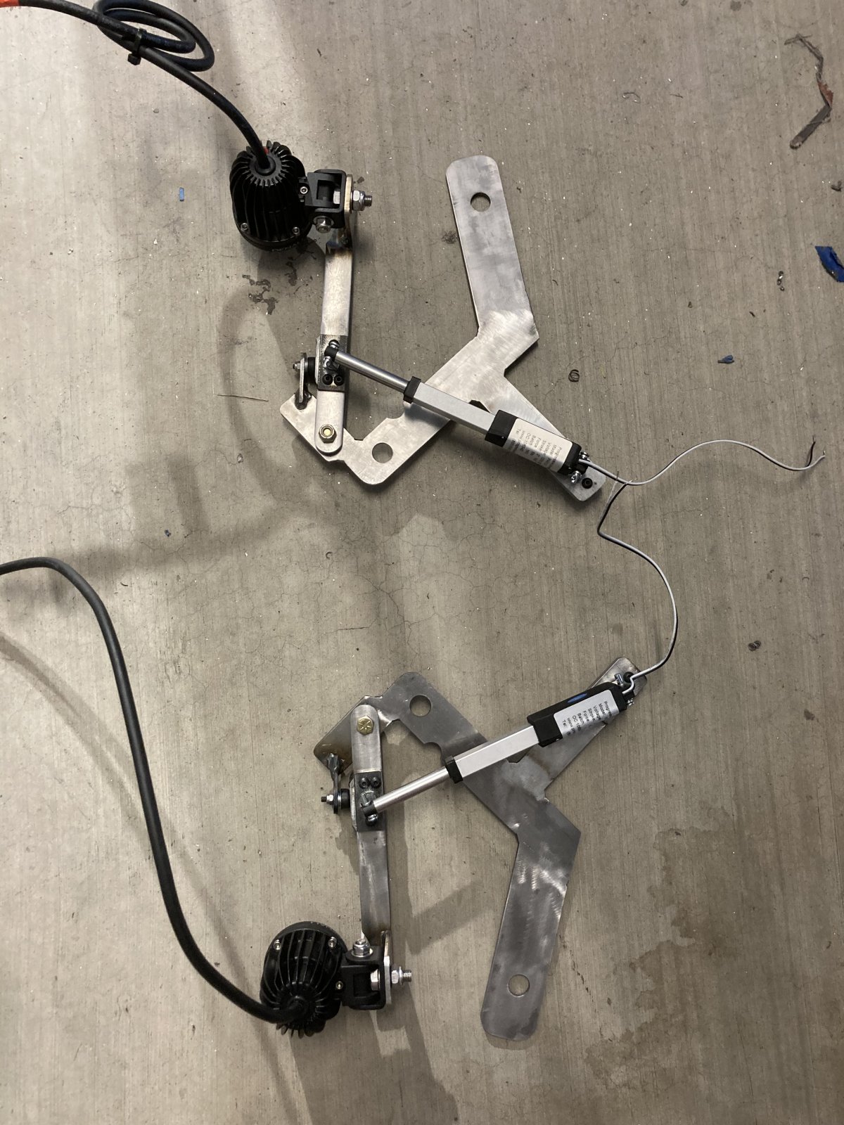

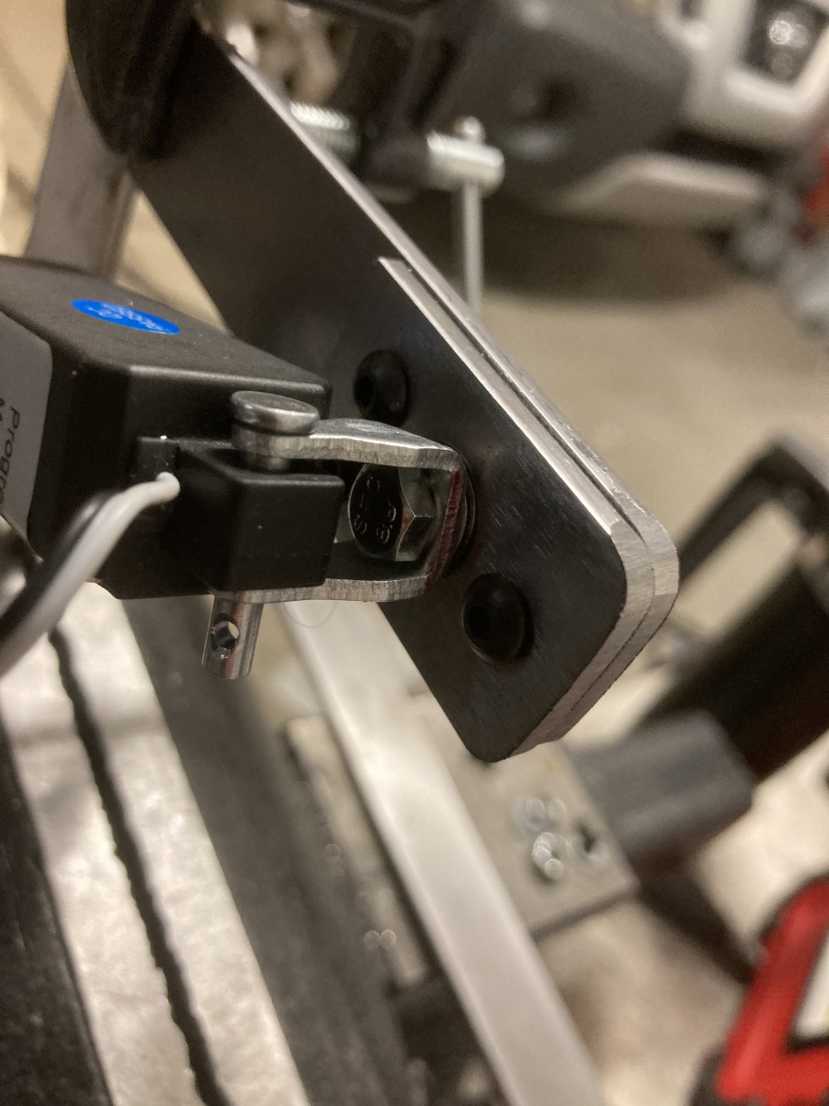

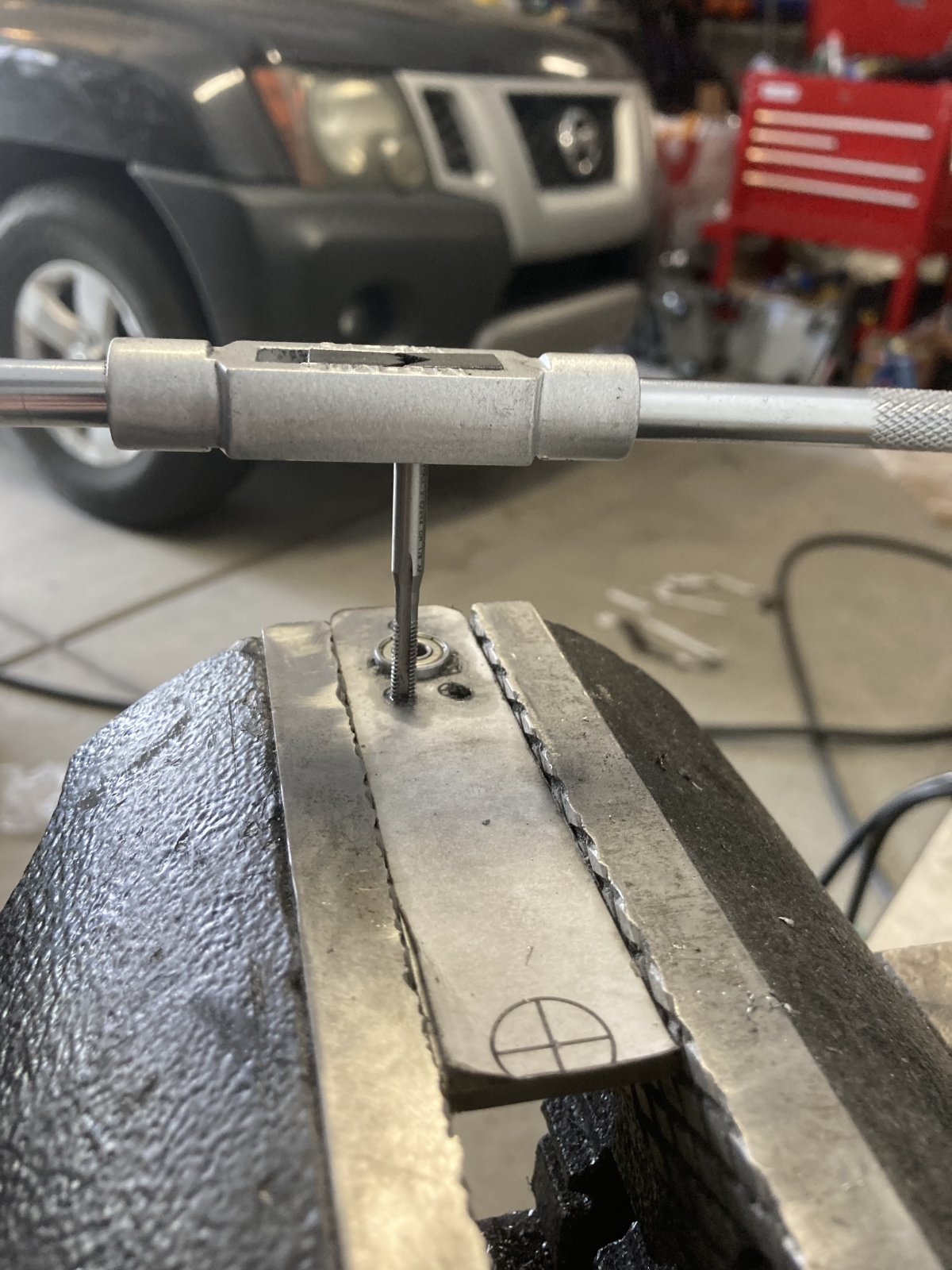

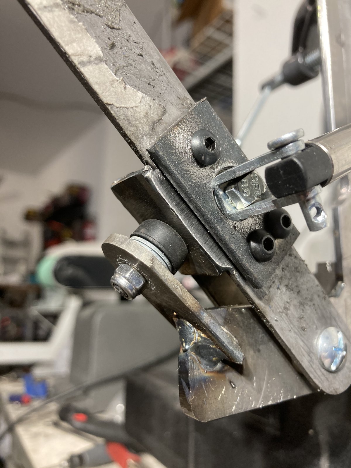

Left actuator assembly completed!
My new dual lower bearing design eliminates all lateral play. I added in an integrated, adustable lower bump stop to minimize play and static load in the down position. Super happy; It all works as I designed it to. In the extended position, these lights will not rattle whatsoever. Fully modular and bolt-on.
Will build the right side and install the assemblies for mockup tomorrow. Even with all of the changes I made, I was able to keep the original geometry.

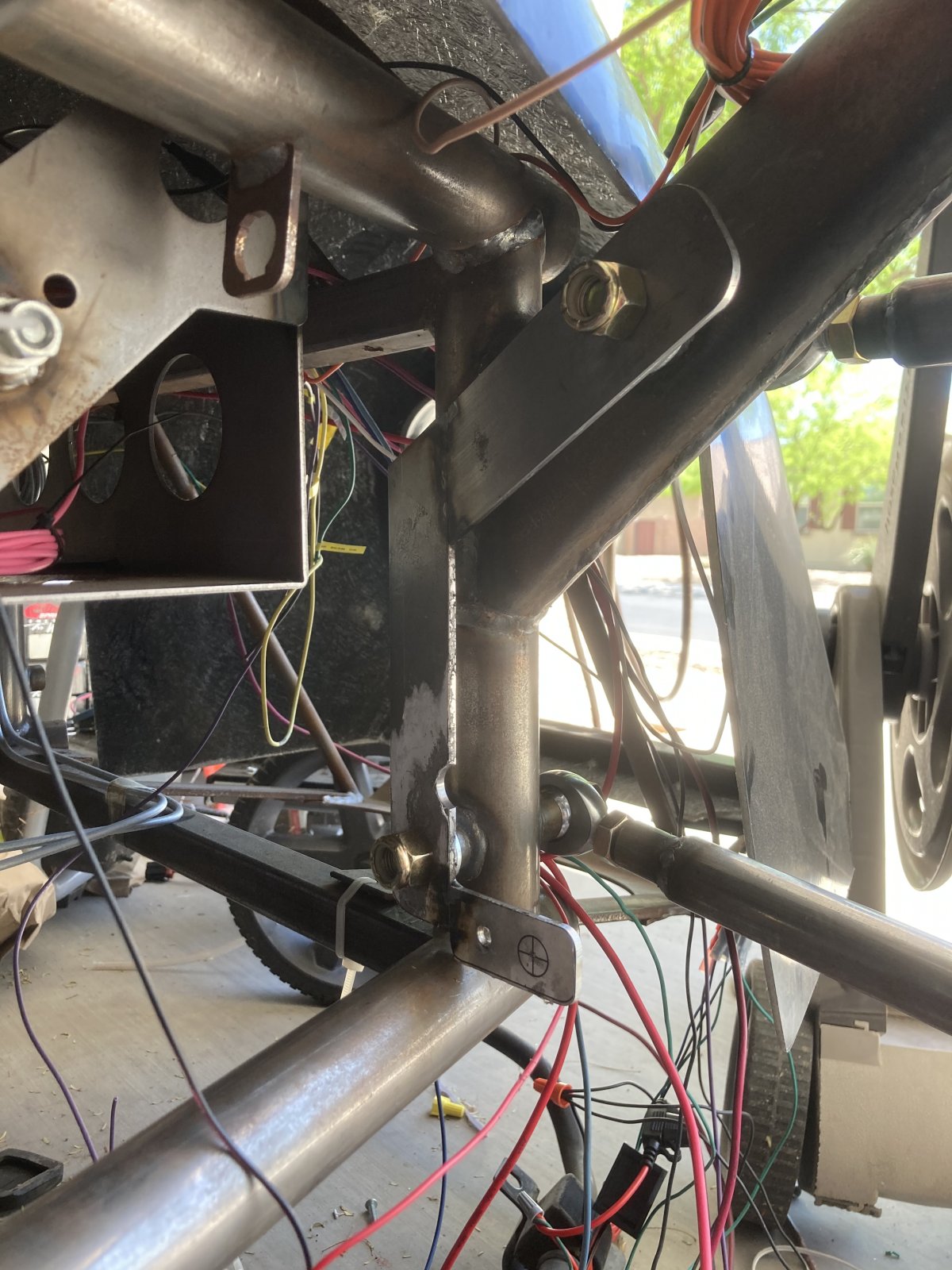

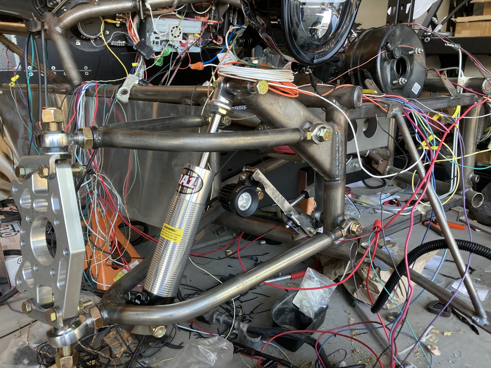

Actuator assemblies built. Right side mounted to verify clearance at the battery box. Still need to fab up some upper travel stops, then will install the actuator assemblies and start finishing up the fwd wiring harness.
k.rollin
Fog lights look great! Looks like you're going to want to remove your front uprights to reassemble them correctly, unless a wonky alignment is part of the plan lol
Brian74
I just threw them on in a hurry to check clearance when I took my initial measurements for the actuator assemblies.

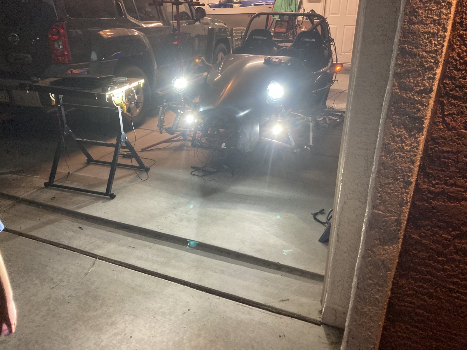

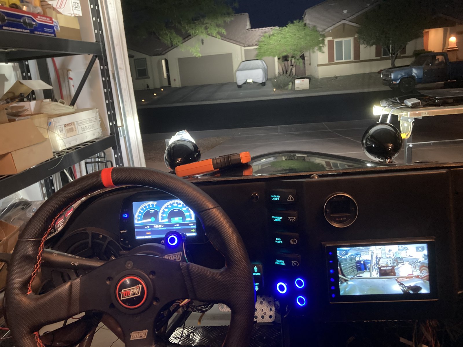

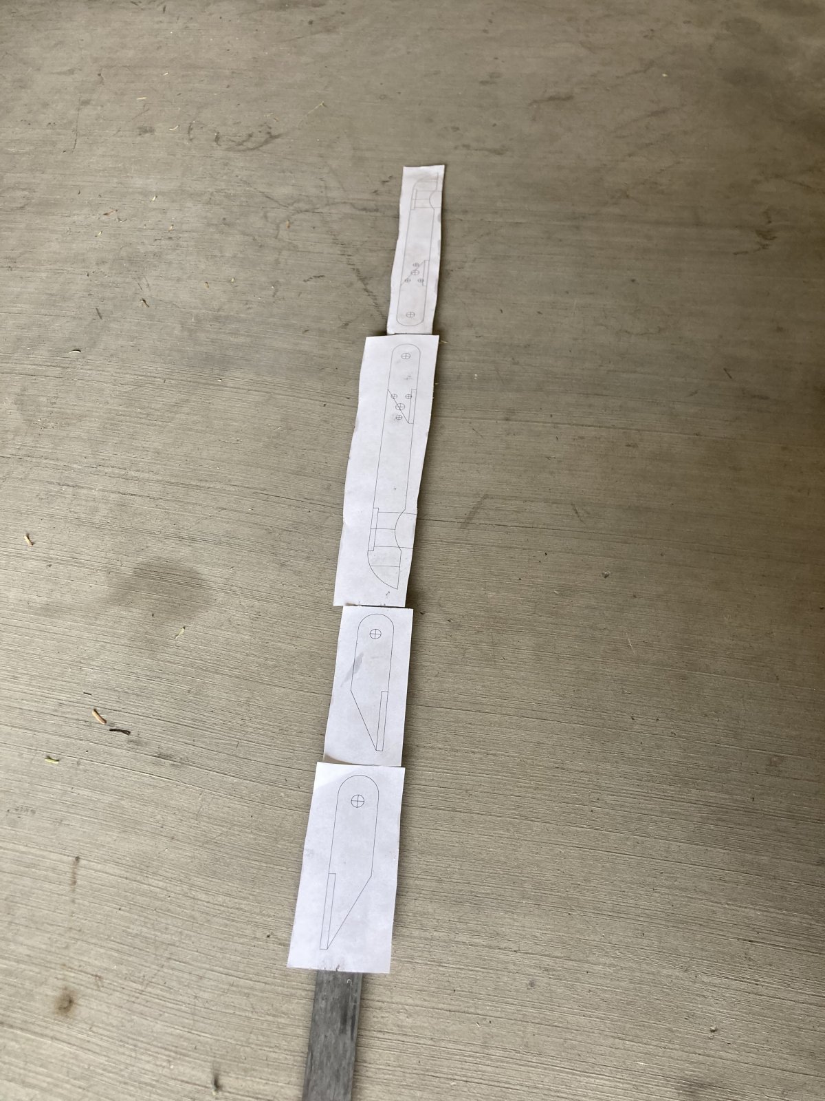

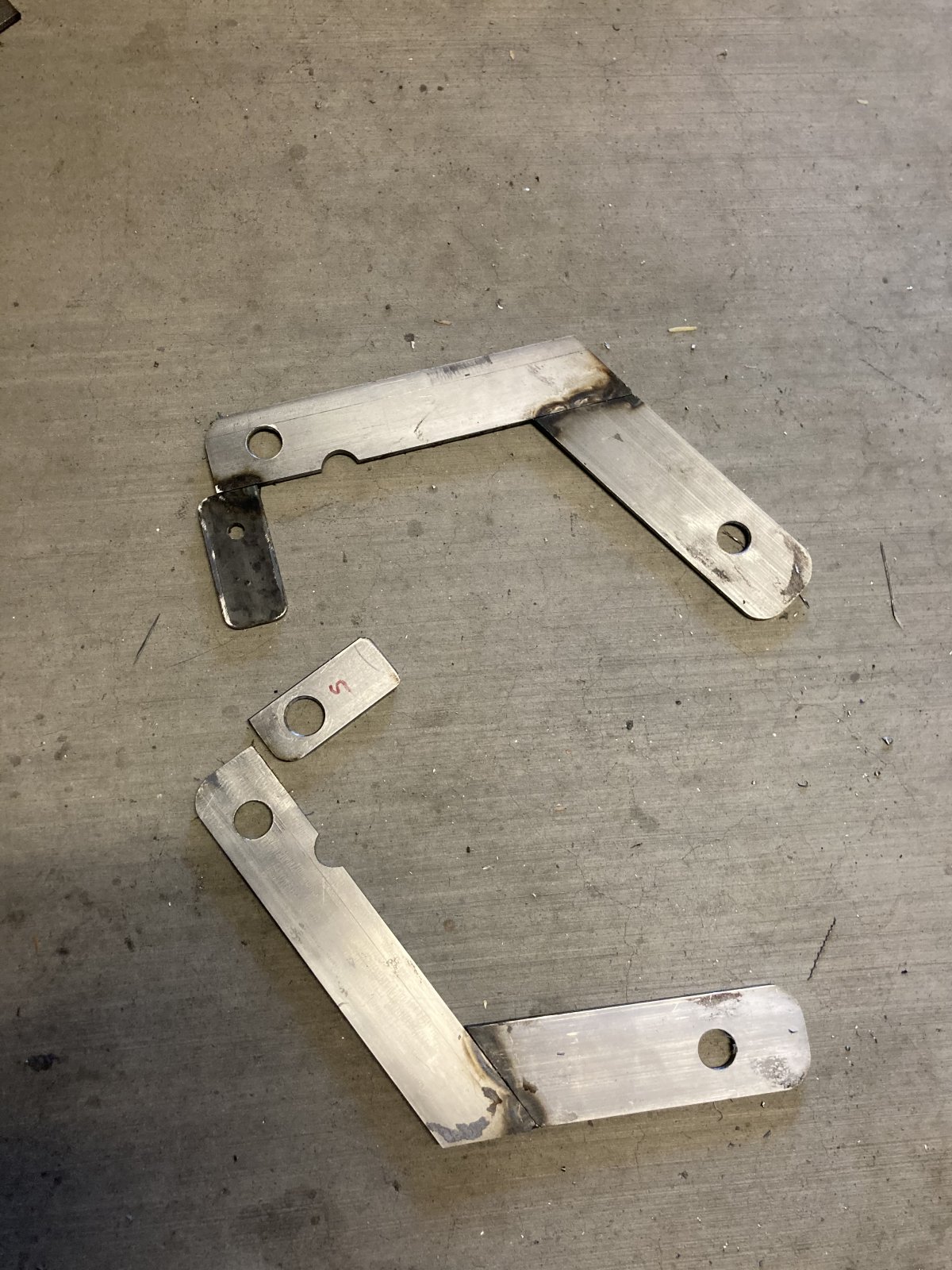

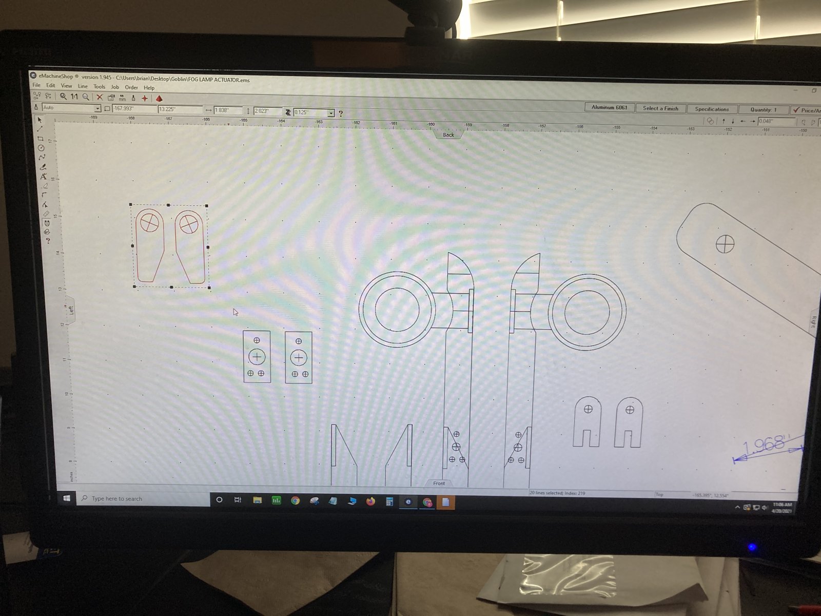

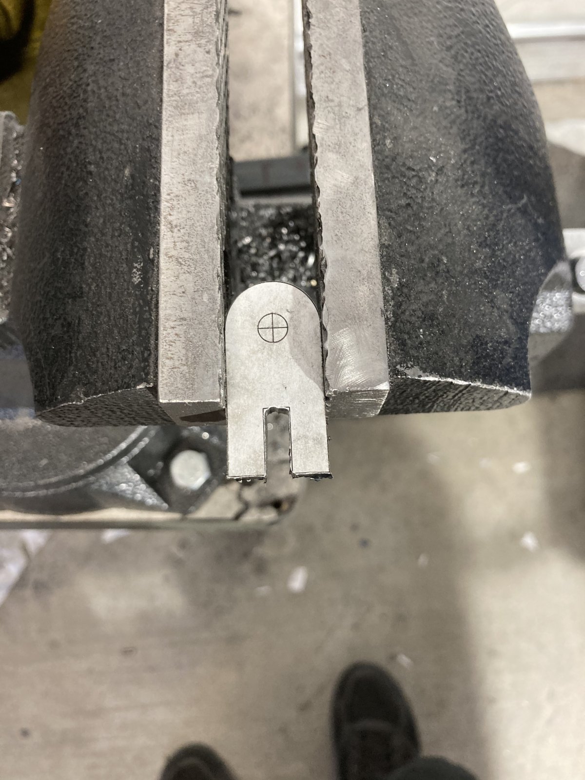

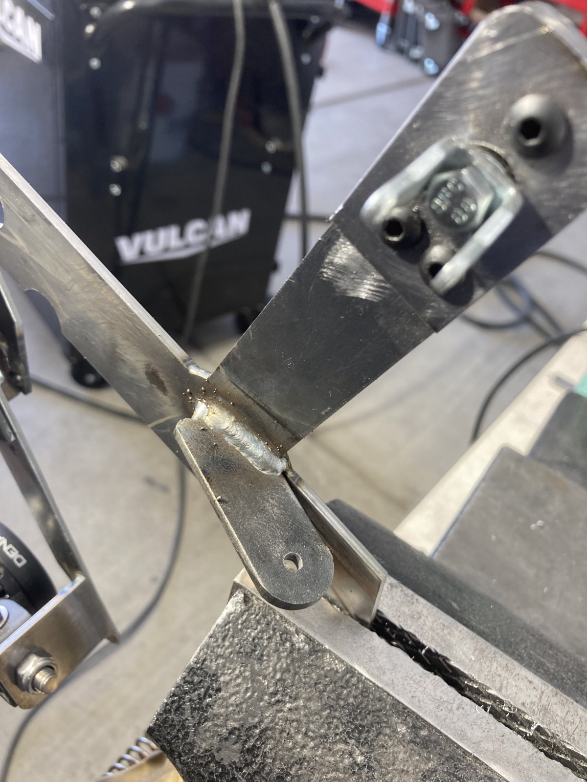

I designed some upper travel stops on the CAD, cut them out, and welded them in. Cleaned up the garage a bit, mocked up the rest of the front end, installed the fog lamp actuators and wired up all of the lighting.
For some reason, my front turn signal wires are not getting signal; will have to recheck the pins on the fuse block. Everything else works. Super happy with how the fog lamps turned out.
