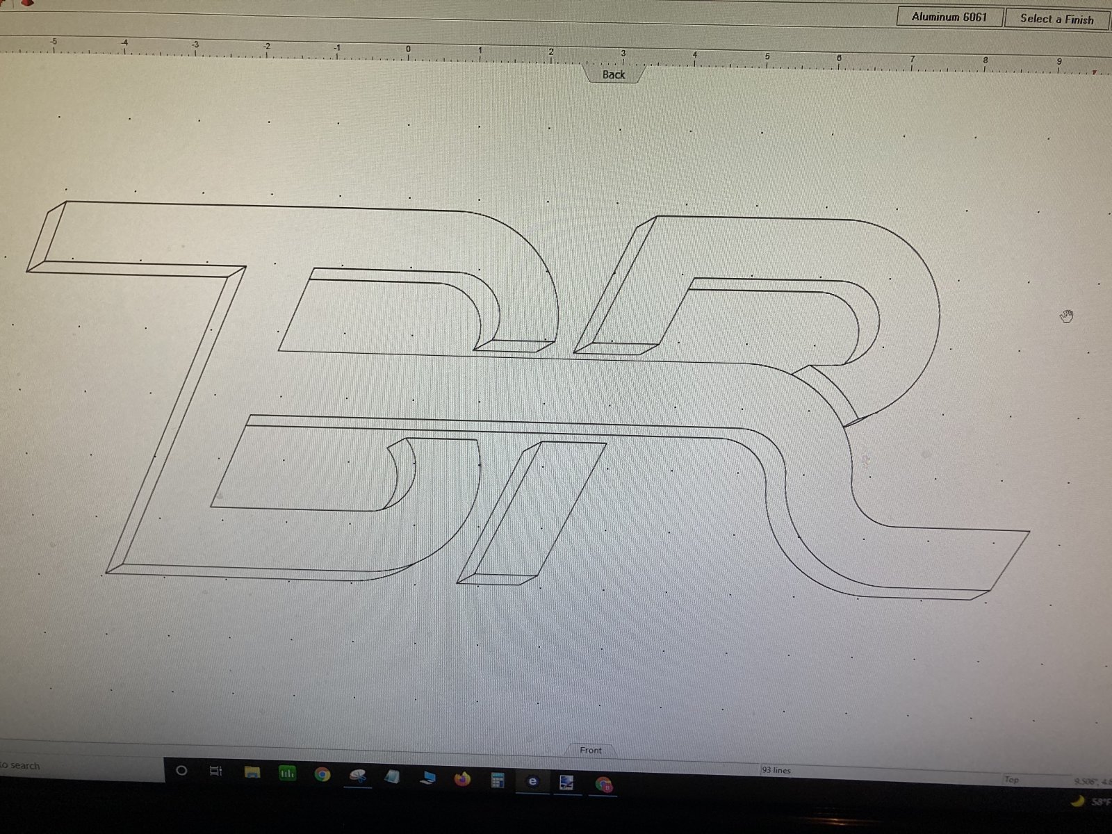

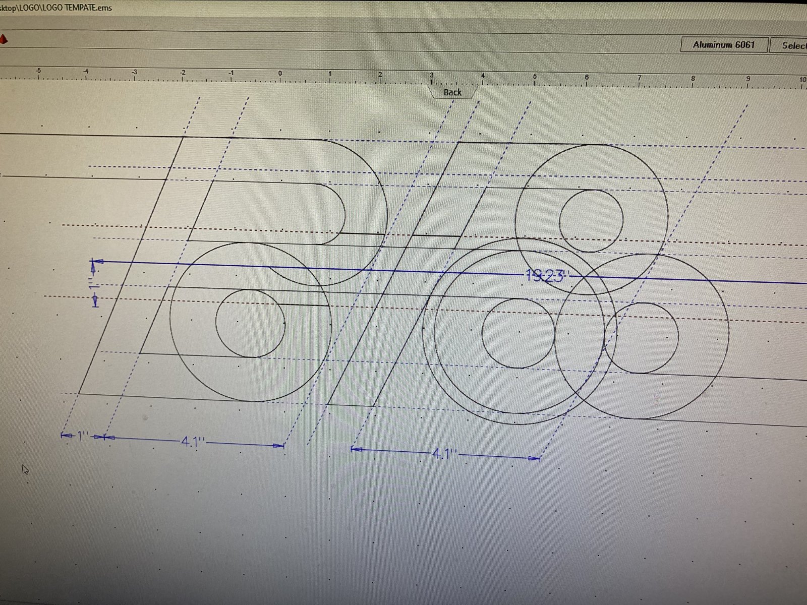

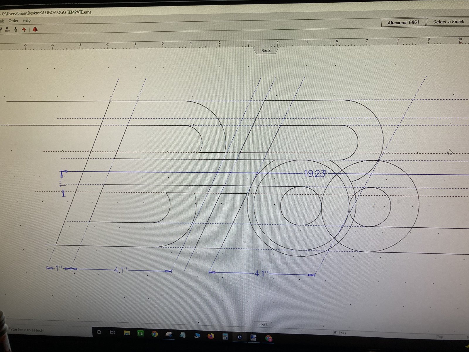

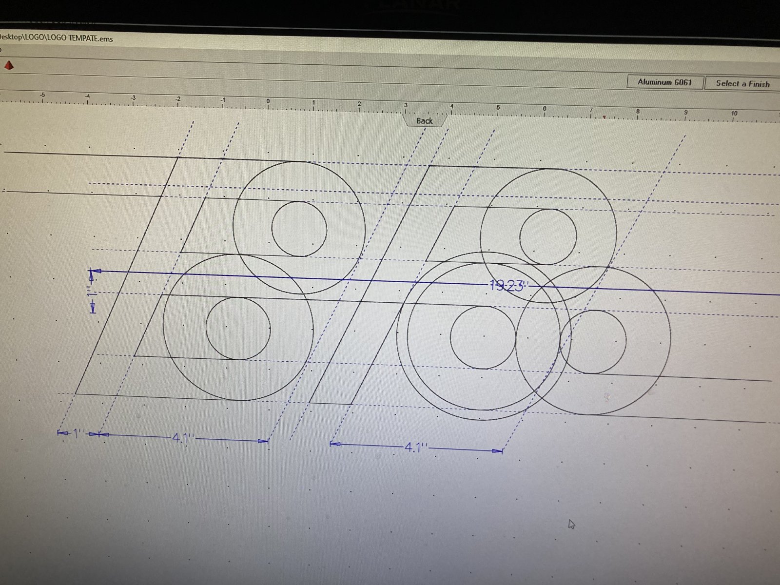

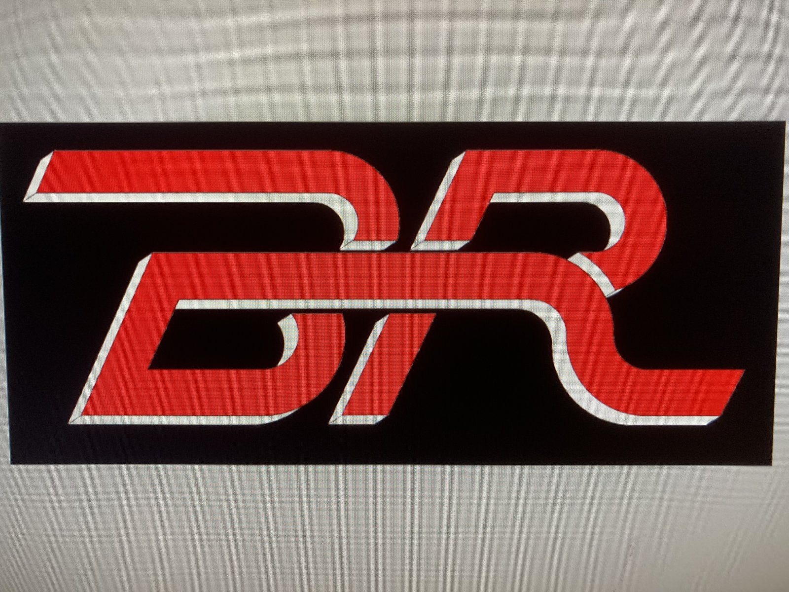

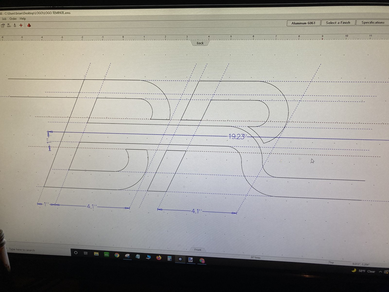

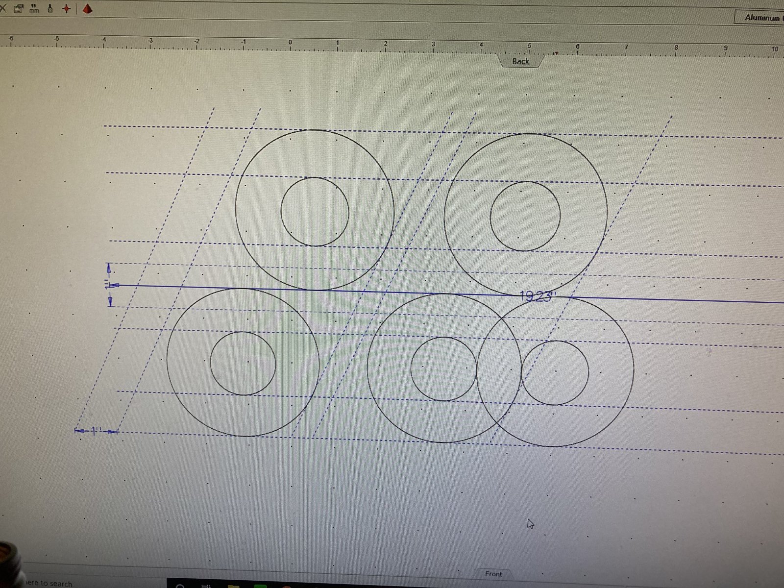

Designed my LLC logo last night, using the same CAD program that I designed my dash & center console on. It was surprisingly easy. I plan to integrate it into my Goblin vinyl wrap design as a source of advertising.

Thanks; Cool article. Its kind of amazing how good of an eye people actually have for symmetry, which can be broken down between both the shape and positive/negative space. Quite often the simplest of designs work the best and are the most versatile.

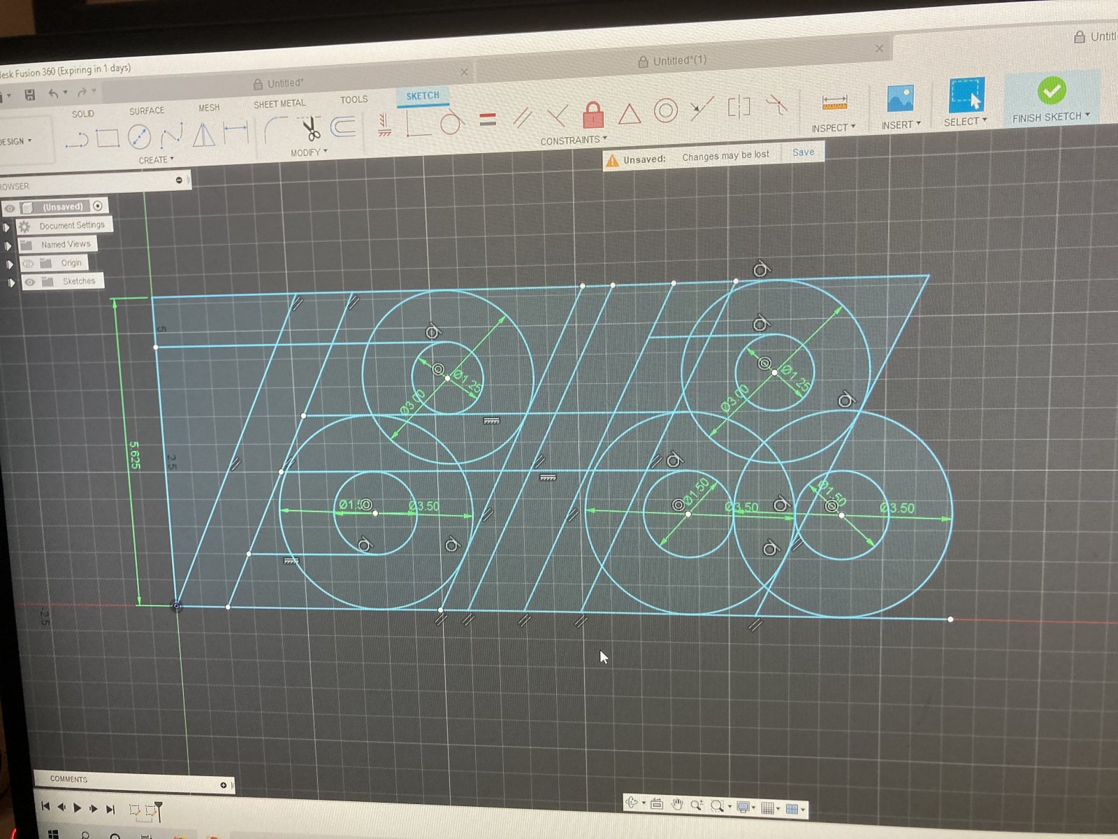

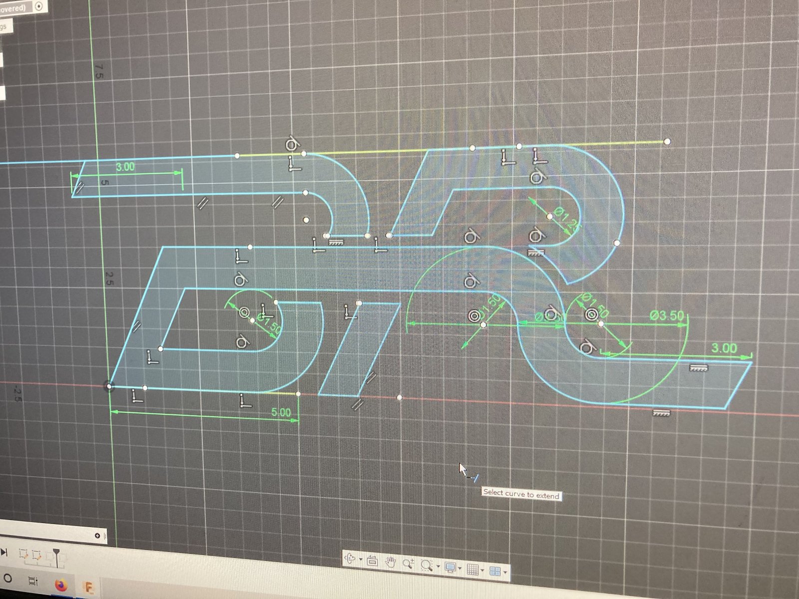

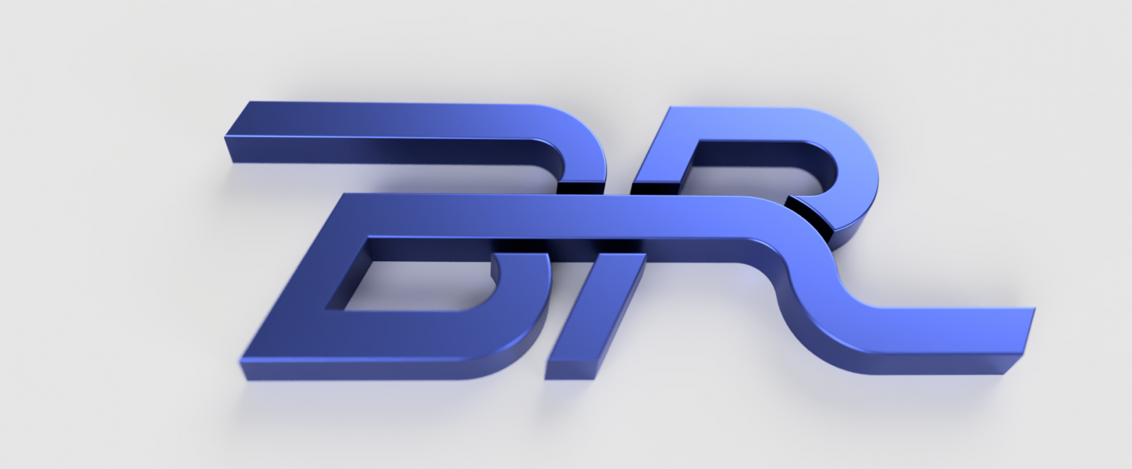

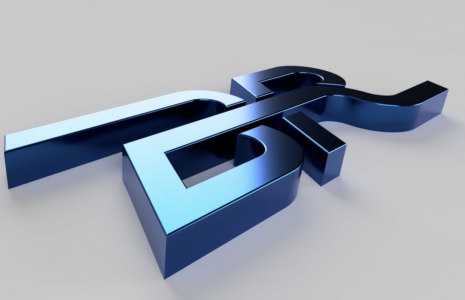

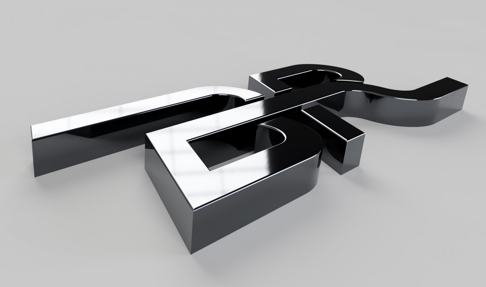

Decided to try Fusion360 today. I need to become proficient at a professional CAD program if I plan to make money with this LLC. I was thinking it was gonna be super complicated.
I decided to start simple, using the sketch plane and a 2-D design, as this is going to be my bread and butter work once I get the CNC plasma table.
I basically just took my company logo that I designed 2 weeks ago on the otherCAD, and transferred all of the measurements over to the Fusion360 sketch application. Ended up being pretty intuitive and much easier than I thought.
Once I finished the 2D, I extruded it to 1”, added a .05” fillet to the face edges, and threw it in the rendering engine and turned into eye candy with a few different finishes & lighting samples.
Super stoked. I’m only 6 hours into the program and I’m really enjoying it. I don’t think it will be too much work to attain a profitable level of proficiency.

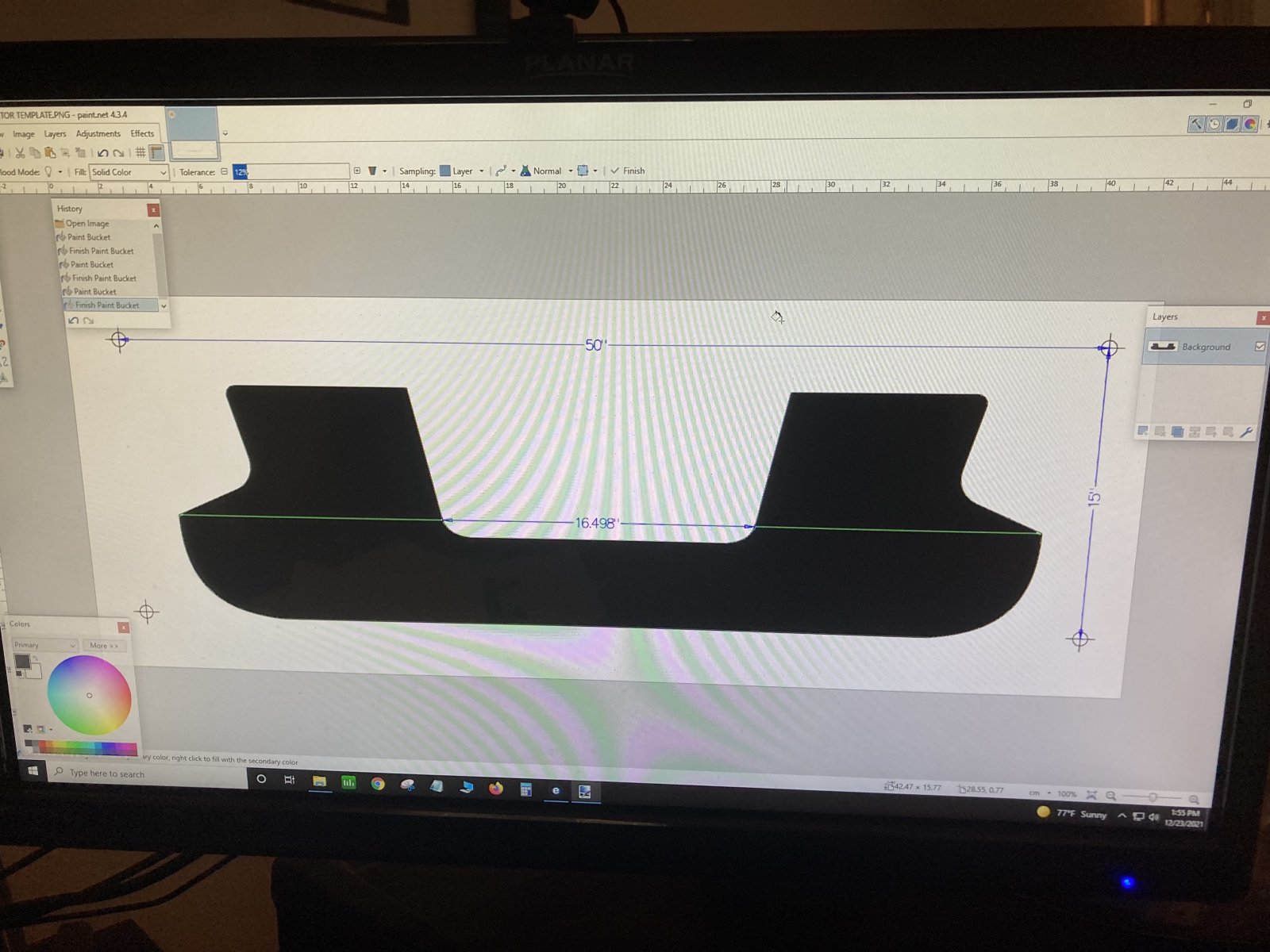

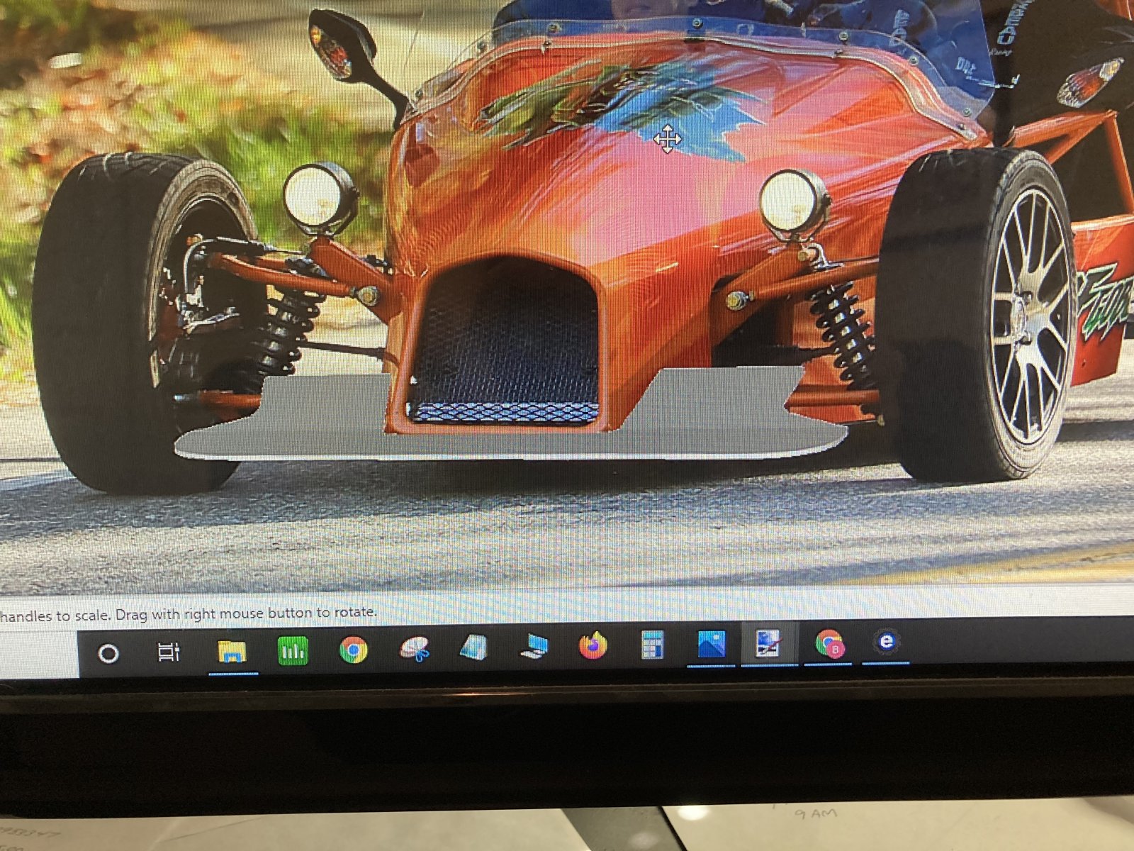

I’ll get back to posting about my build. Last time I left off, I was in the middle of designing a linear variable actuated front spoiler using simple flat plane drag coefficient to increase front downforce.
Brian74

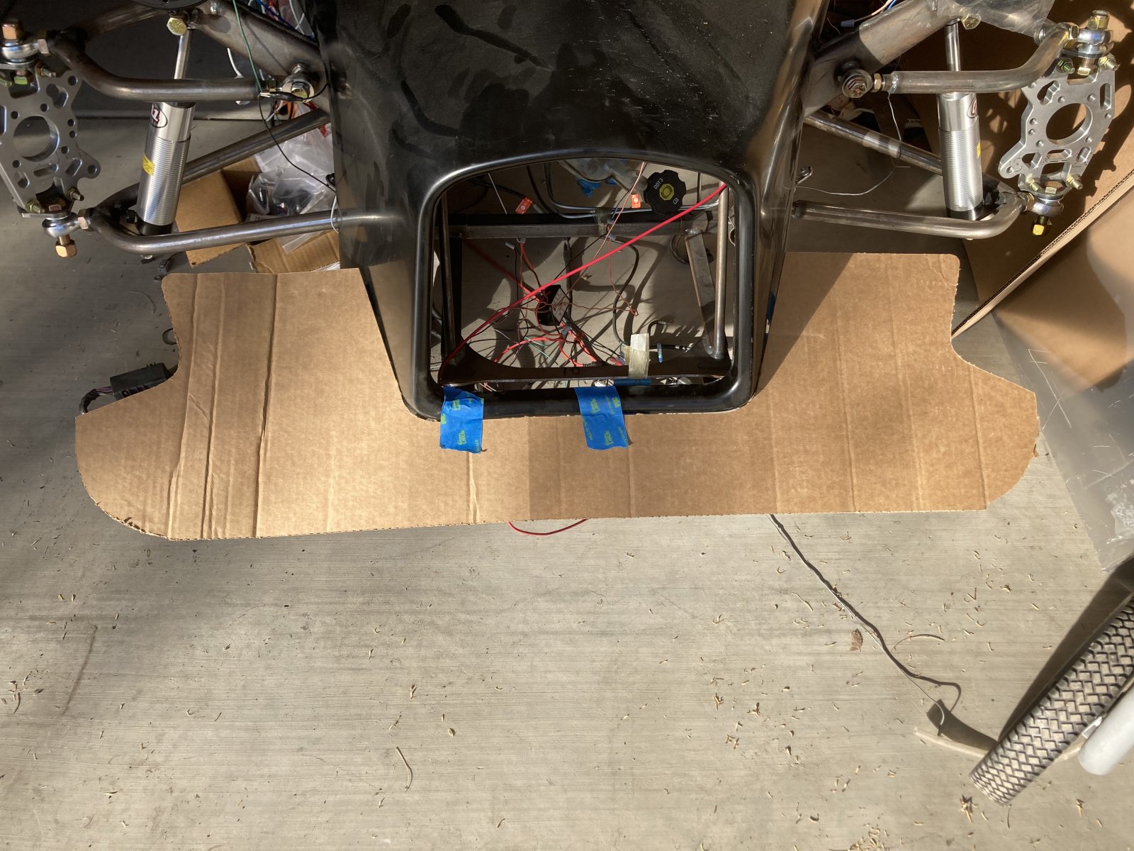

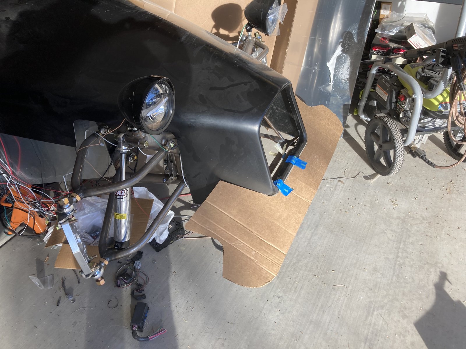

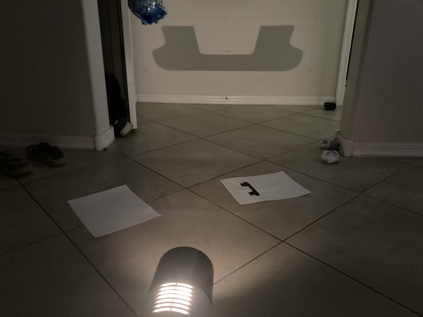

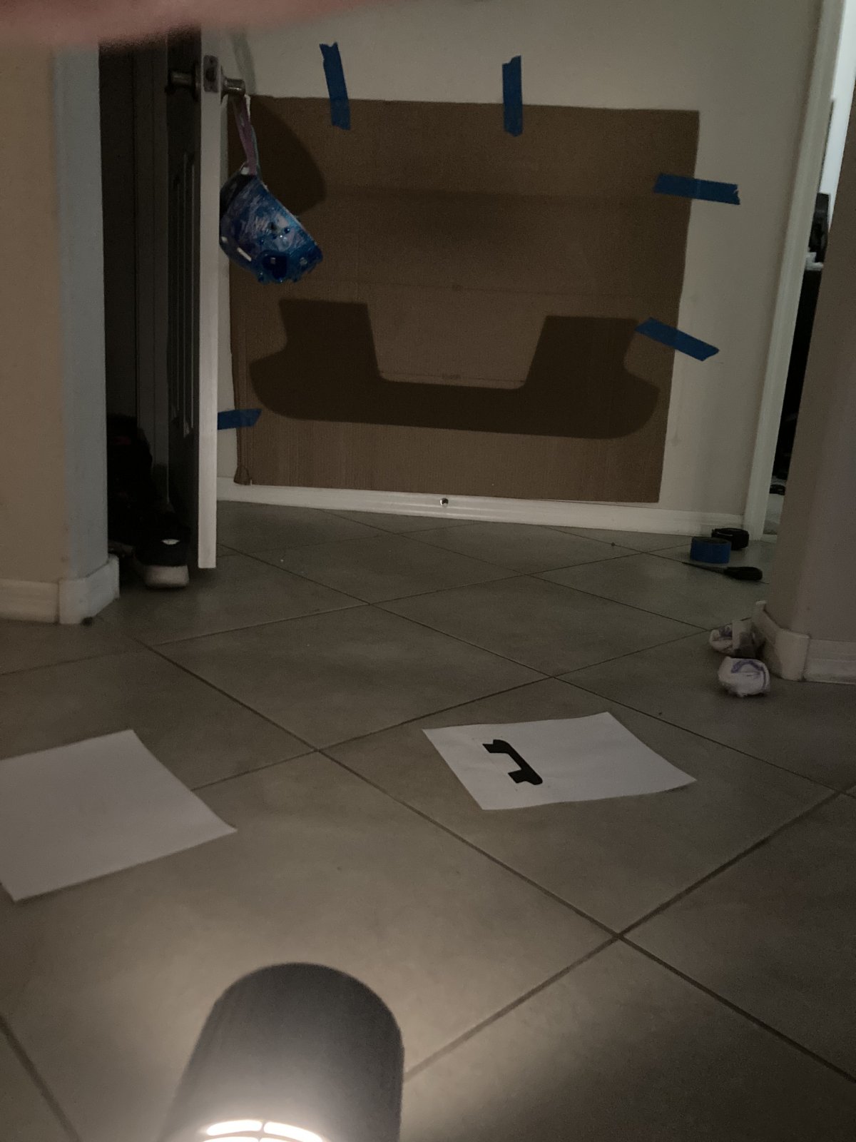

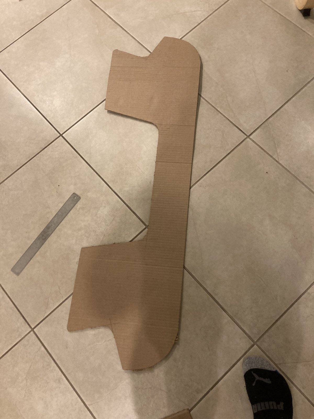

I got started on the template for my front splitter/spoiler. I scaled up my CAD design, and instead of printing up a huge template, I went old school; I threw it in a projector and traced it out.
I wanted to keep it simple as all I really need it to do is disrupt some of the fwd laminar airflow to create downforce. I will run lightweight sheet below the cowling as well as a rear diffuser and side splitters in an attempt to keep the airflow below the car as undisturbed as possible.
I’m prototyping this out for a general idea of fitment and to determine mounting. I think the front will mount on a bearing pivot, with adjustable turnbuckles on each end to provide a small degree of adjustment. The front spoiler will be made from 1/4” aluminum plate and weight 10 to 15 lbs.

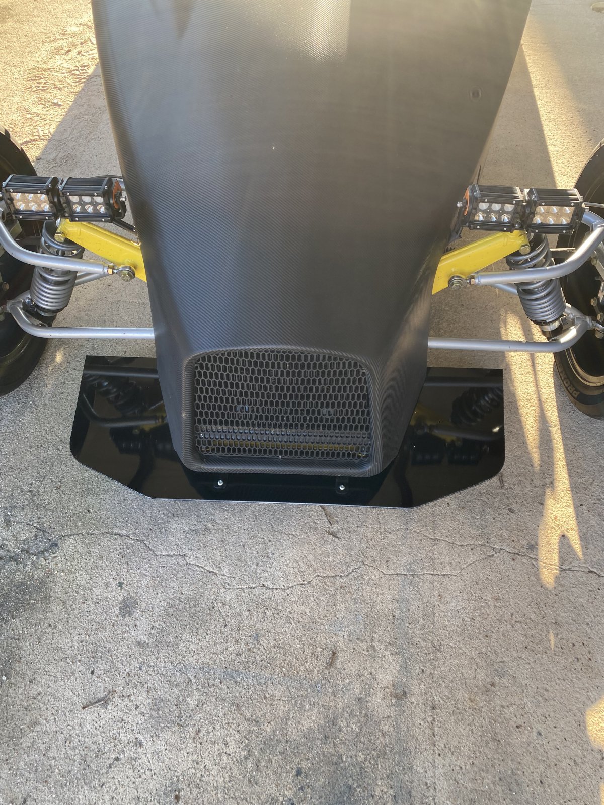

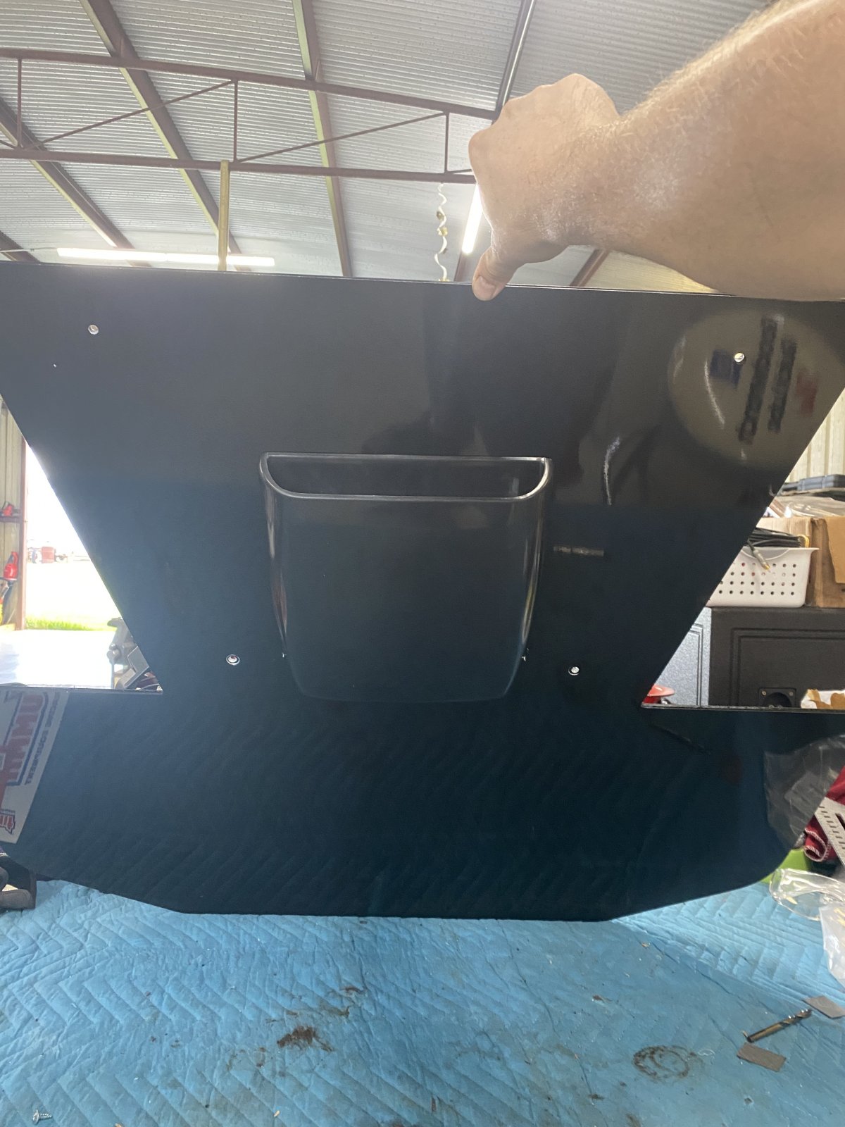

I would try to adapt SACTX splitter design with your wing design. It would cover the bottom and add more aero. It’s something we have both talked about, but haven’t implemented due to the satisfactory results of the splitter. More downforce Would be better, but it’s good the way it sits, so it’s a back burner project for us.
Classy
A few things on the front splitter, first, 1/4” solid aluminum is way too much. Splitters in the racing world at least are considered a consumable. Meaning if you run one, expect that it can be damaged or ripped off. Continuing on that you would rather the splitter give on an impact rather than break the bolts or mounting loose. I would go with 1/8” aluminum or aluminite.
Second, the angle you show in the pictures is a heavy angle and yes would increase down force, but will also create a lot of drag. I like that you are planning on making it adjustable but it should be generally flat. To that point, the one that RRtoys is using bolts under the car and can still be adjusted via washers/spacers if another angle is wanted.
The last thing, in the event there is an impact, your design will put it into the body work and potentially into the radiator.
I wrote all this in the best of intentions and I do want to be helpful.
I bought a splitter for my Miata on Black Friday and it is sitting in my garage, I am almost afraid to use it because I have seen what happens in the event of a hard impact.
I have been researching splitter design for quite some time. I do understand its purpose and also the point of it being consumable. Even without the splitter, any impact on the front of this car is not going to be favorable whatsoever. This is part of the reason that DF redesigned the replaceable front radiator mounting clip back around frame #60. I also do not plan on road racing this car.
A degree of rigidity is required or added mounting support is required. I thought about 1/8” but quickly decided not to, as the shape would lead to excessive flex and thus cracking in very short time. I do not want to create any additional lack of front ground clearance either.
The way I have it mounted on the mockup is not the final angle or shape. More cutting will be required on the template to adjust to flatter angle to prevent cowling interference. I’m going slow and removing a bit at a time.
Honestly I kind of laugh when people start to talk about drag considerations and the Goblin. This car has the inherent drag of a riding lawnmower. Its probably the last car a person should buy who is concerned with high speed aerodynamic efficiency.

I would try to adapt SACTX splitter design with your wing design. It would cover the bottom and add more aero. It’s something we have both talked about, but haven’t implemented due to the satisfactory results of the splitter. More downforce Would be better, but it’s good the way it sits, so it’s a back burner project for us. View attachment 29685View attachment 29687
I read through his posts. I really like how he extended the flat zone along the entire car as well as the side splitters.
