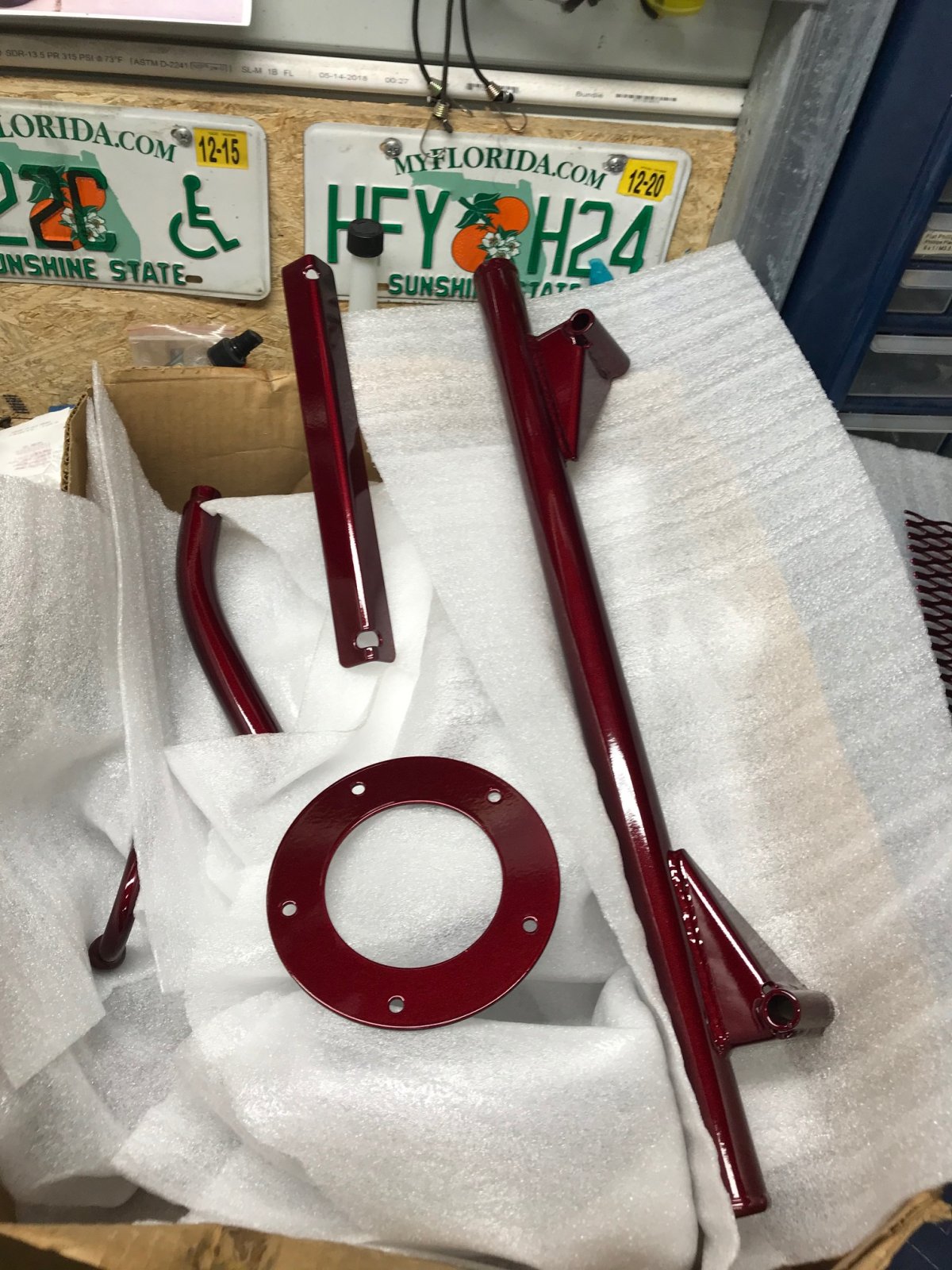

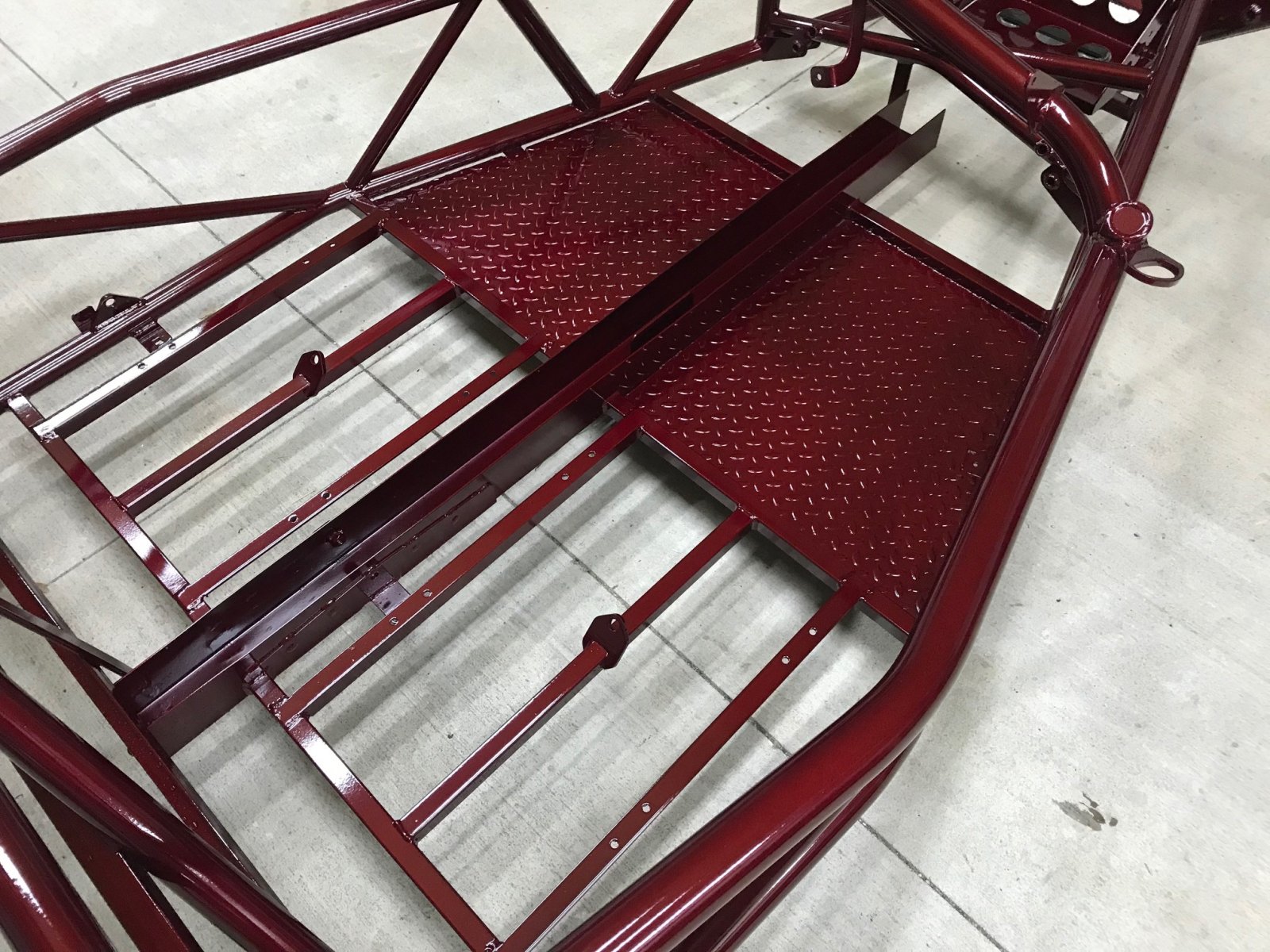

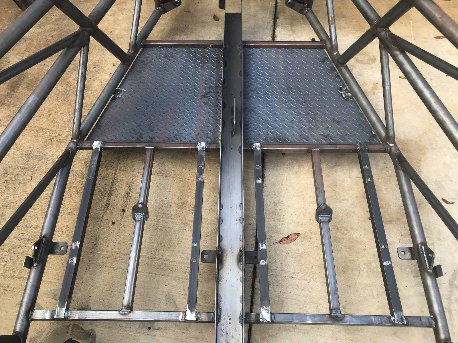

I did my homework and decided what frame mods I wanted to do before powder-coat. The two mods I decided on were the seat mounting rails & the diamond-plate floor. In hindsight the only thing I would have changed was mounting an additional horizontal bar about 8" higher for the shoulder harness straps. Why build the car just to tear it down later to paint? My powder-coat guy charged extra for small batches so I had everything done at once to save a few $$.
Also I think I would have spent just a few more $$ and had the fuel tank powder-coated as well. If you do that just be sure and mask off the area where the fuel pump "O"ring seats.
