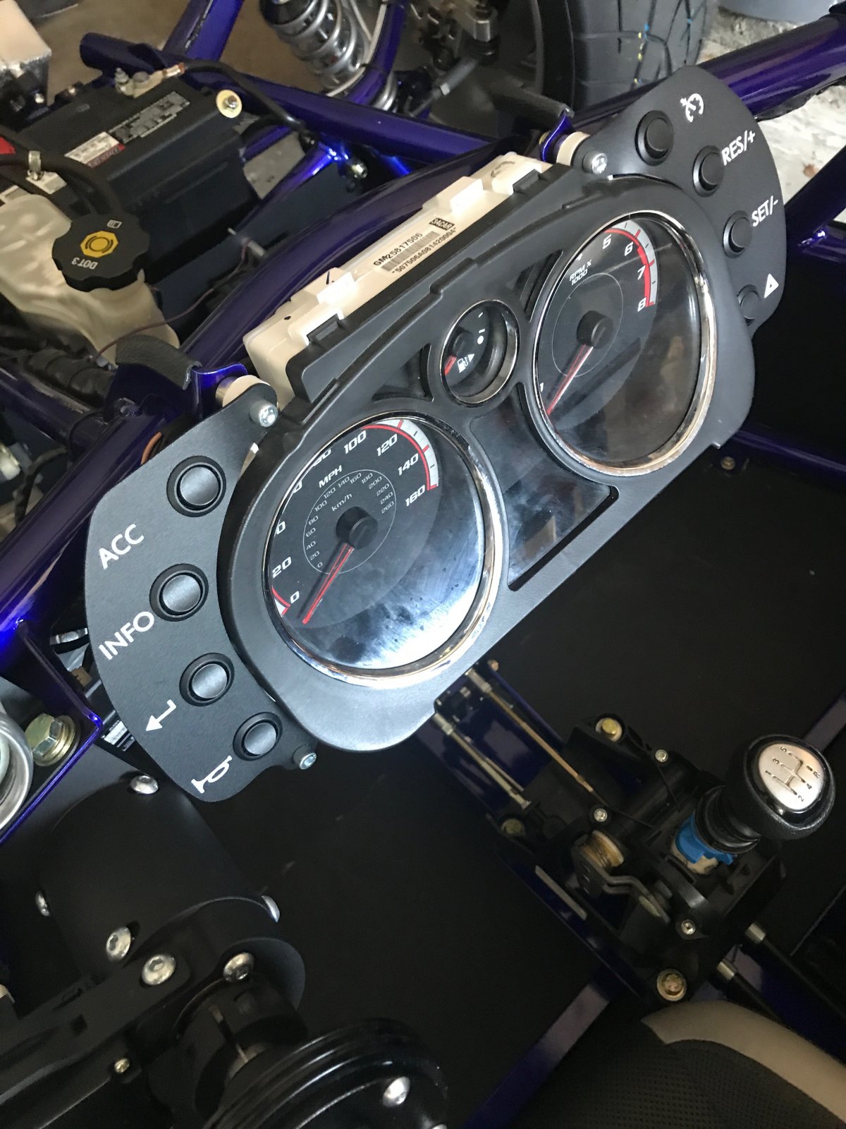

can anyone tell me how to use the spacers in the button panel set? i have it in place, but i want to make sure its correct. right now in the front of the cluster, i have 1 small spacers on top and 1 large on bottom. i used the remaining 4 spacers in the back of the panel were it touches frame (4). i have all the hardware from the original mouting kit leftover. thanks.
Top bolts:
panel, short spacer, cluster, short spacer, frame
bottom bolts:
panel, long spacer, cluster, short spacer, frame
I’ll have to take a pic of the bottom if you need it.
