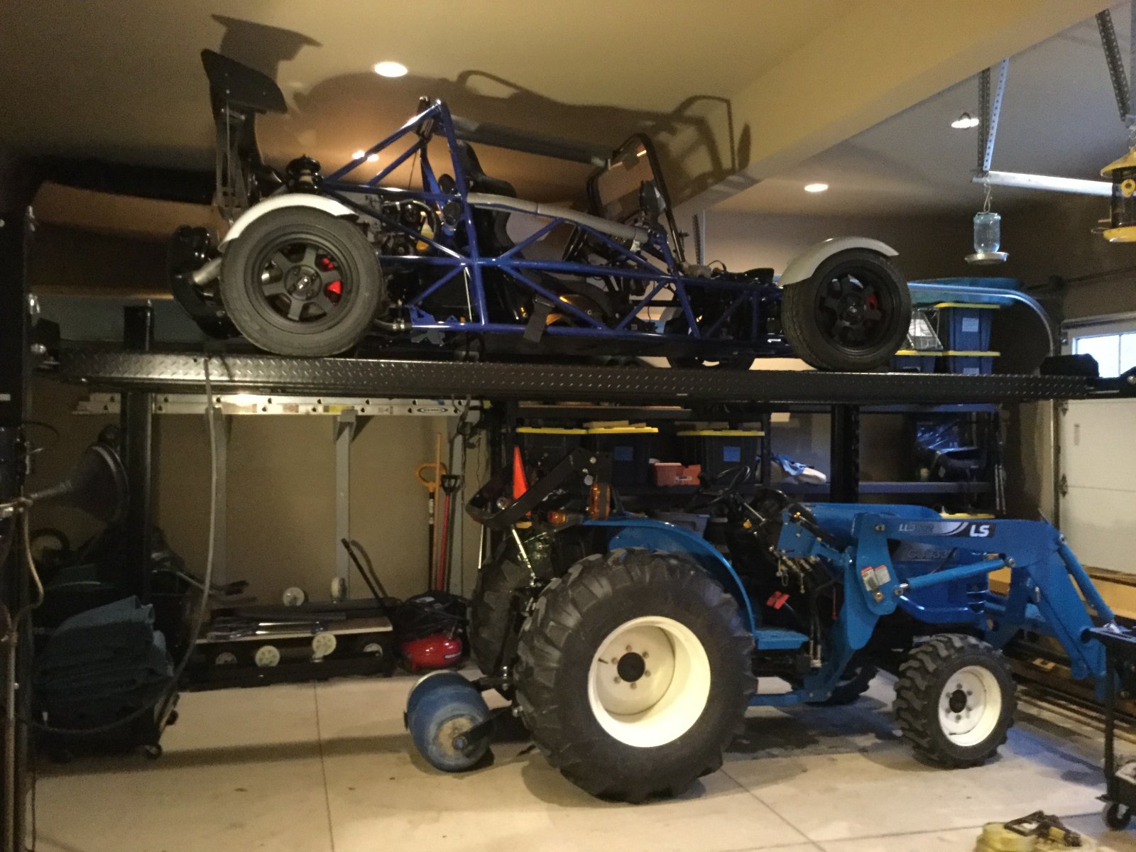

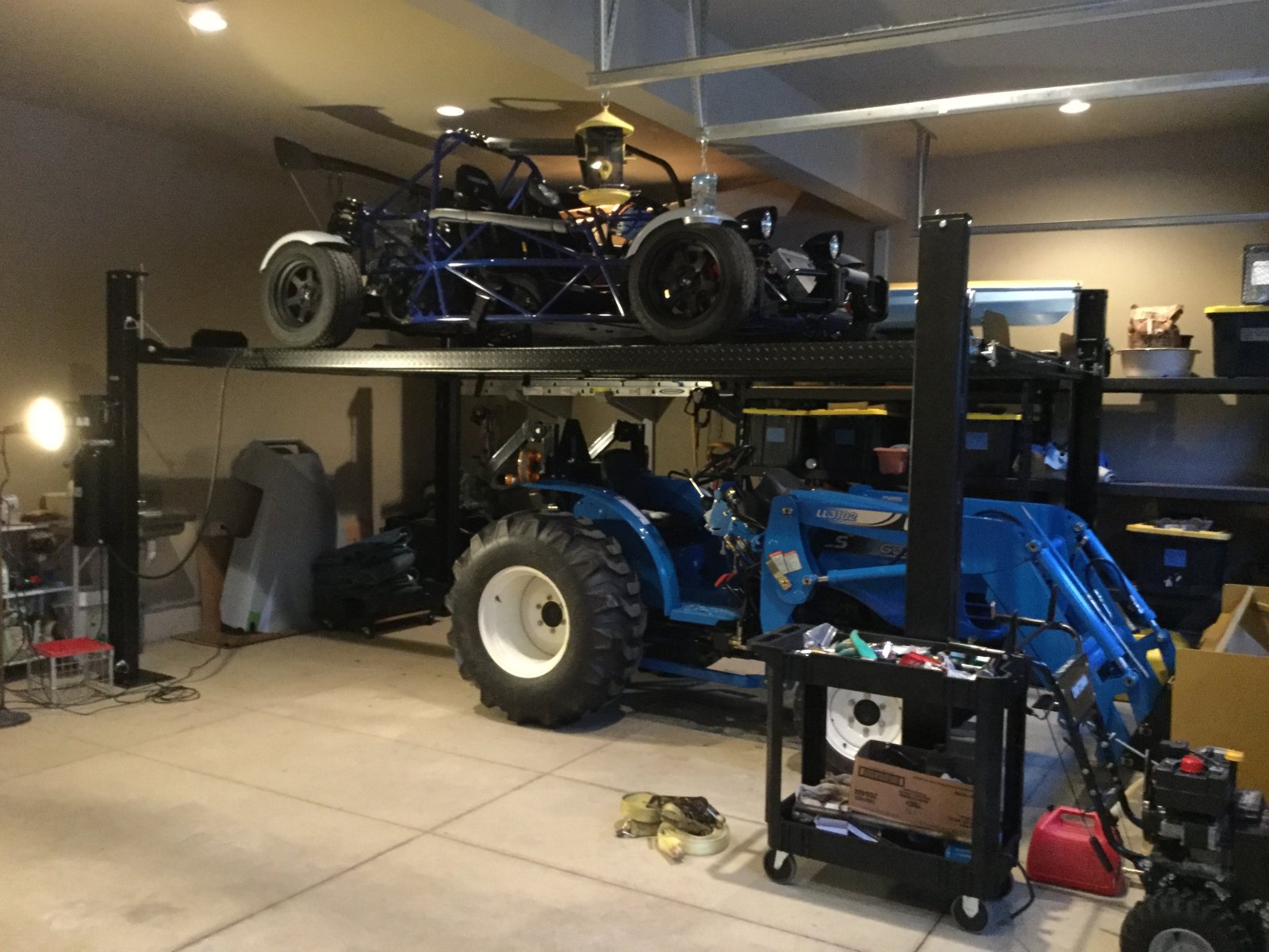

BAR-AIR
9000# lift extended track with a little higher lift 6’-6” under the track. Didn’t want to have to duck everytime I went under it. Great as a storage lift. Does have a little more wobble to it (with the Goblin on it) then I thought it would (just had my cousin’s 86 LTD on it no wobble) a lot more weight. Benefits it’s movable and there relatively cheap... downsides if you are working directly under the car great if you are doing anything with the wheels kind of a pain (does have a sliding jack tray with stubby jacks to lift the car). But you are still working around the tracks.
That is set at 6’-1” to the bottom of the track. Still can go up another 5” but that puts the car within 1/2” on the ceiling (a little to close for my comfort.....)
BAR-AIR
Would prefer a 2 post for working on vehicles. But for a storage or minimally used working lift the 4 post works great. The other thing I was concerned about leaving a car on a 2 post lift with the wheel and suspension hanging for extended periods of time. (Did want to add to my list of things to do to make up a cradle for the wheels to be supported on a 2 post lift).
