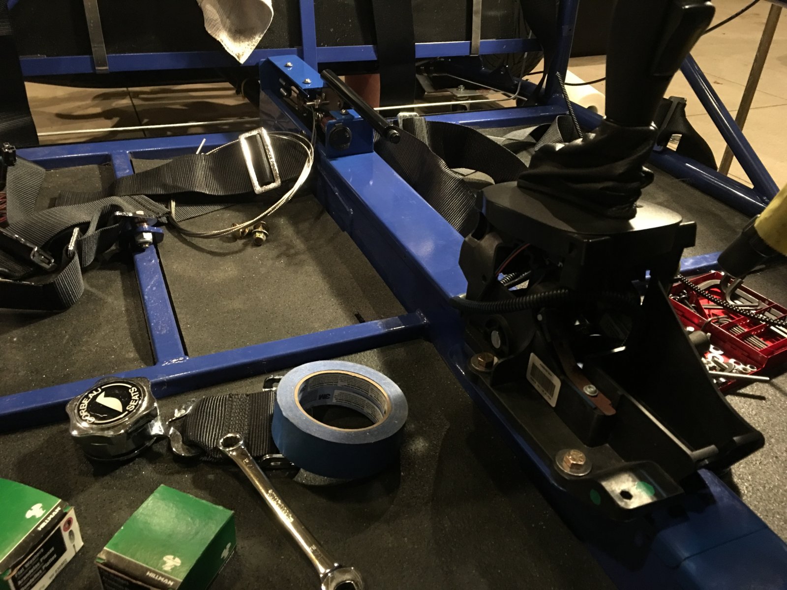

Cut the tunnel. Your either going to touch up the powder coating where you cut the tunnel (where you are controlling the scratches) or your going to be touching up the scratches on the walls and frame the first time you try to remove the tunnel. If your concerned about the cut two blocks of wood clamped on either side of the cut, tape the tunnel first and a new blade really only touched up the raw ends. Sectioned mine in to three pieces due to the emergency brake handle.
Waterdriver
Hack saw cut on the tunnel cover? I like the idea, but mine is already powder coated and I know I'll make a mess with it. I better leave well enough alone.
Mine was already powdercoated as well. Lay down masking tape first on the cover, make your cut line, used a cut off disc on a hand grinder to make the cut. Dress the cut areas and remove tape.
Although I do recommend to move the cut forward or back at least one inch from where I cut it. Somehow I cut it exactly at the lowest point of the shifter bellcrank throw, which the ball end was touching the edge trim I used to cover the cuts. Ended up trimming some of the edge trim off which gave it the clearance it needed.
Waterdriver
Thanks. Y'all talked me into it. Carl, I don't have any of my shifter hardware to figure out where the bell crank ends. So if I give myself about 1-1/2" from where the bell crank mounts onto the tabs sticking out, you think that will give me enough room? I'm assuming I need to allow for shifter movement too
Now that I look at my picture of it, I made my cut directly below the bellcranks pivot point mount. (The end of the brackets that stick out)
In retrospect, I would move that cut point forward (in relation to sitting in the car) of where I made my cut about 1 1/2 - 2in.
If you cut the tunnel, your going to have to drill additional tunnel cap/tunnel mounting holes. And tap the tunnel holes if going with bolting it together as Custrina did. Who I copied. :)

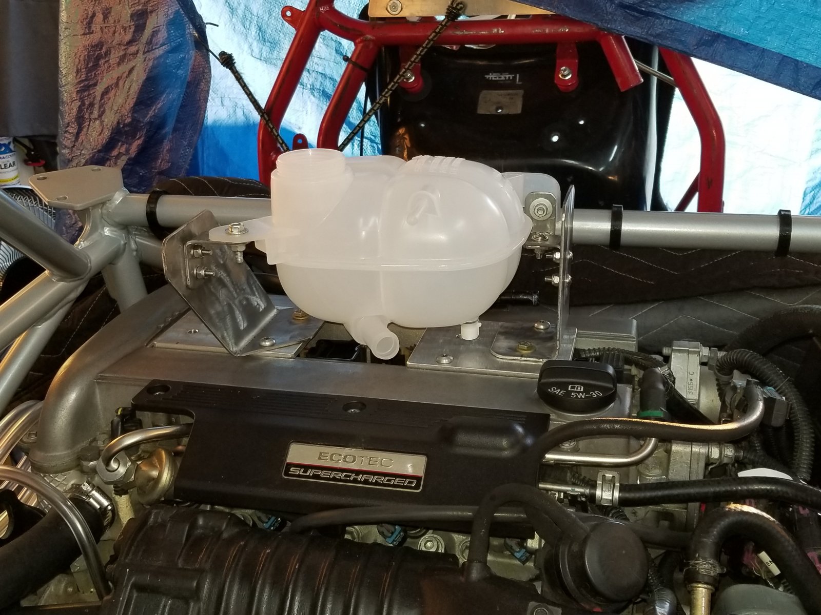

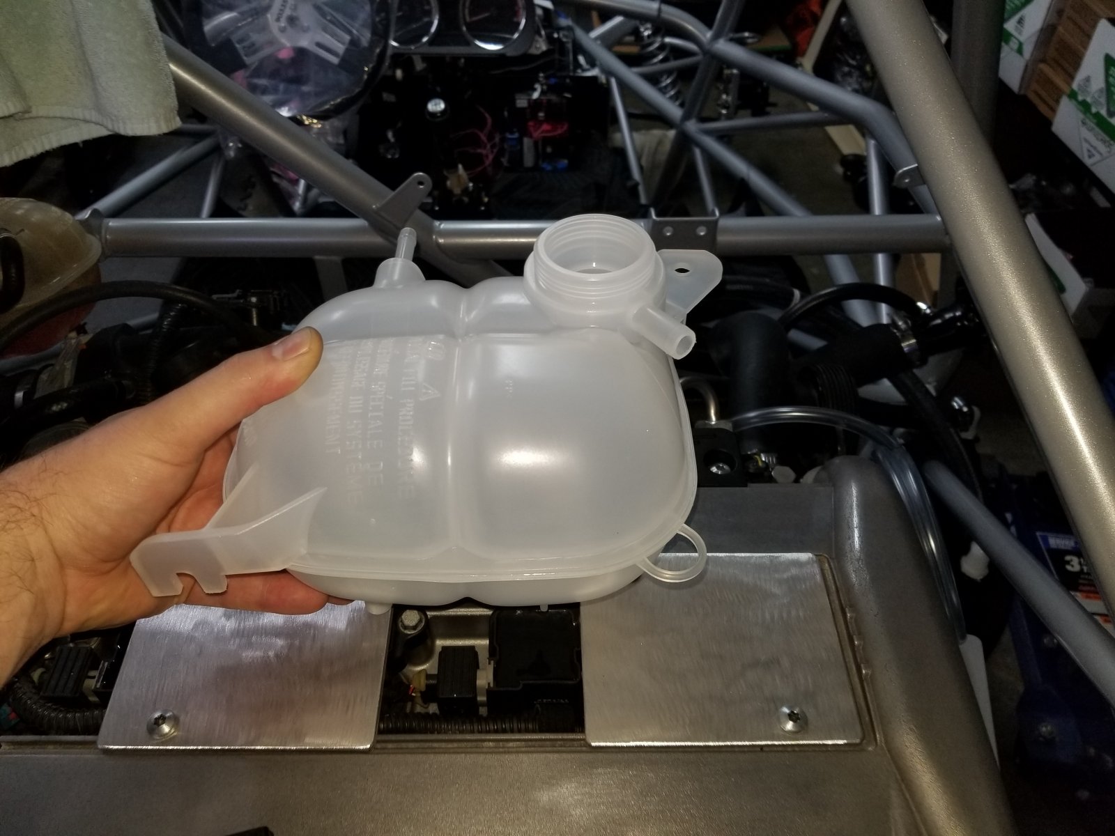

Working on building a bracket, or brackets, to hold the intercooler reservoir tank. (Option B tank)
Wasn't really liking the area around the supercharger pulley as it is kind of crowded.
Looked at some Ariel Atom photos and decided to go their route of a mount.

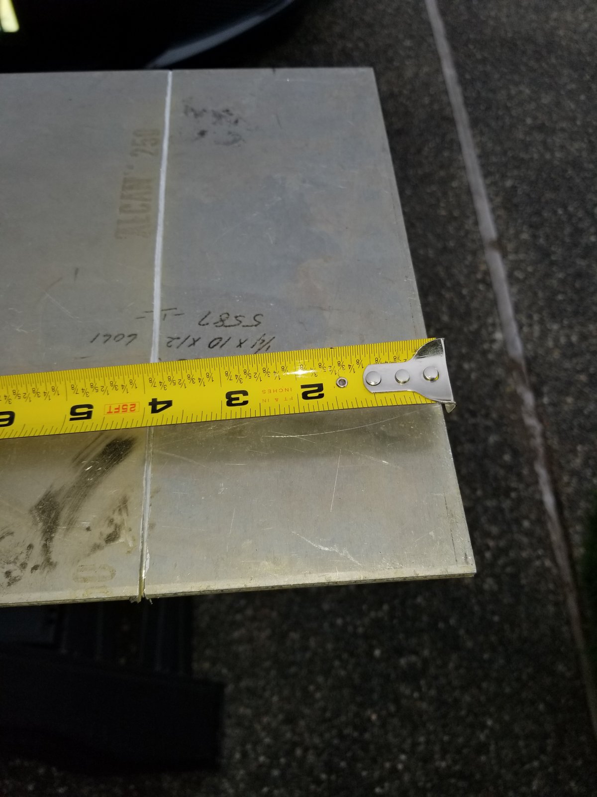

Had some aluminum plate and cut out 2 4"x5" plates to mount above the coil packs.
Still need to build the brackets that'll mount the tank to the mounting plates and then paint it.
