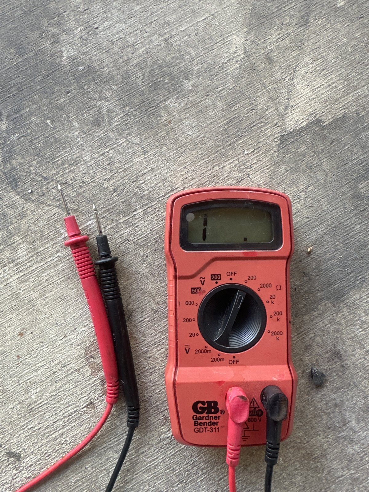

C1-30 and C2-9 both do not give a reading at all with the key off. I am using the lowest ohm setting on my meter, grounding the black probe to a known solid ground, and using a back probe on the C1 and C2 connectors. My meter does not change from this setting. I did touch the leads together on the meter to make sure it was working and I did get a reading View attachment 53892
C1-30 on the APP has no reading at all either.

Ross is trying to get you to check continuity between c1-30 and C2-9, not whether either of those is grounded. I would check with the ECM completely disconnected and measure on the pins of the ecm itself. They should connect up inside the ECM, although you are getting outside my knowledge on whether there may be some sort of isolation within the ECM. Probably not since grounding any one will pull all of them down to 0v.

Oh I see. Checking the way you described and the same settings on my meter I get a 0.00 reading. It does jump around just a little but it is probably me moving the leads.

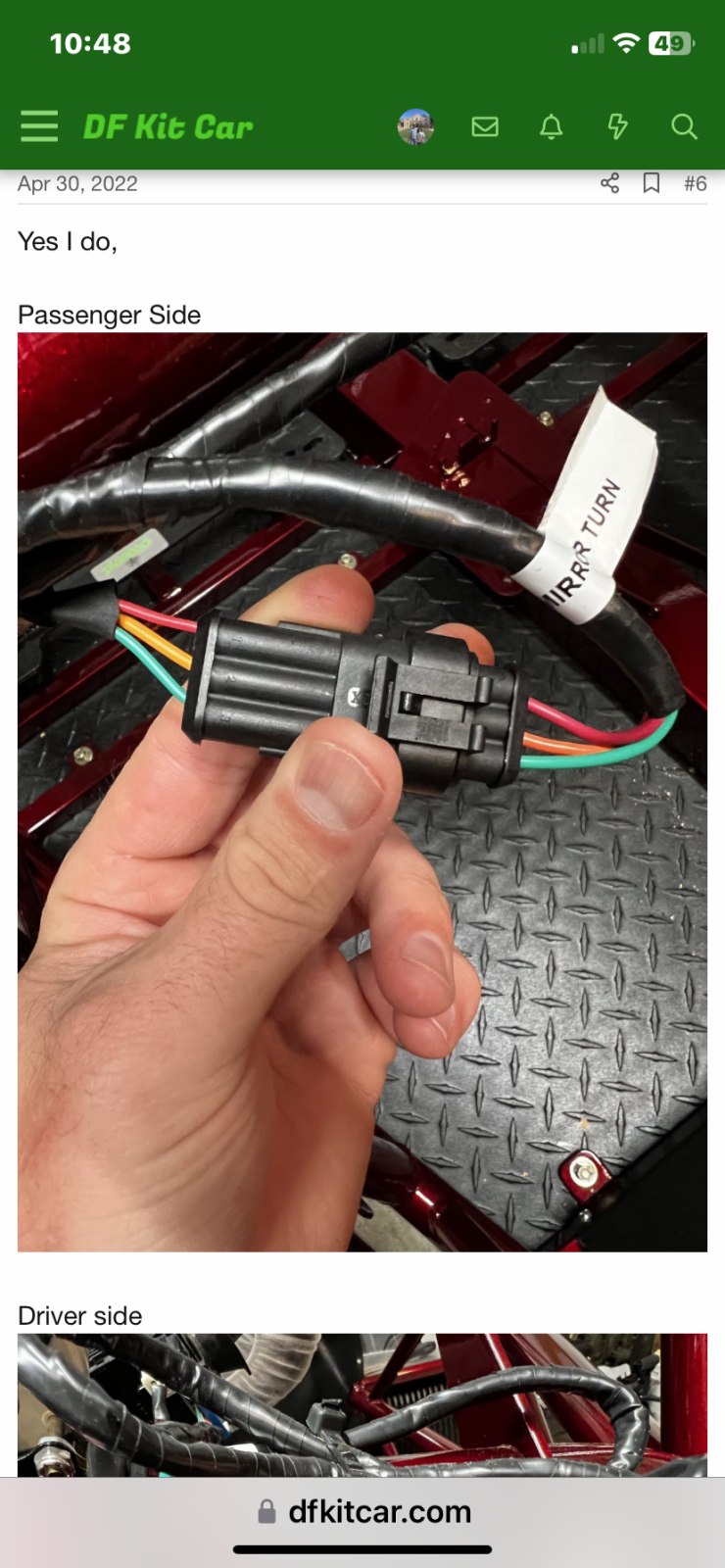

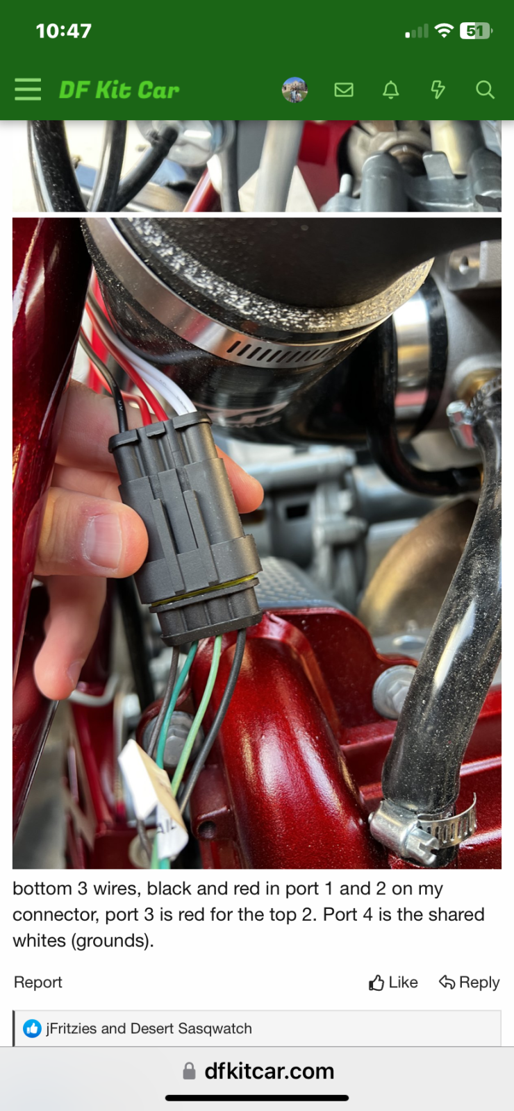

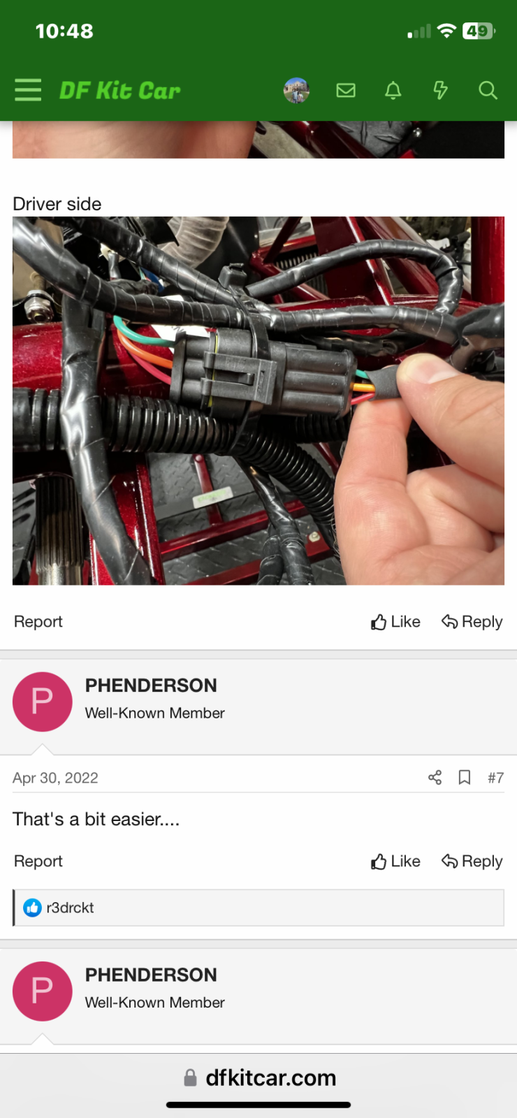

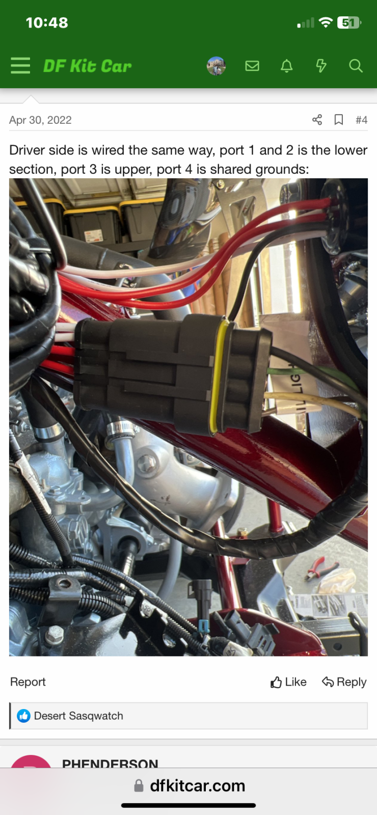

Does anyone have the basic wiring for the DF taillights? Just looking for maybe a picture of how they are wired into the harness. I tried to search but did not really find what I needed.
Waterdriver
I have really awesome chicken scratch pinout. Would only be better if it was on a napkin. Lol
Hope it can help.
Markm
I can’t remember where I found these but this is what I used to help me. I used small wire nuts to make temporary connections to verify the lights operated correctly then soldered the permanent connections. Also added the turn signal connections for the front also
