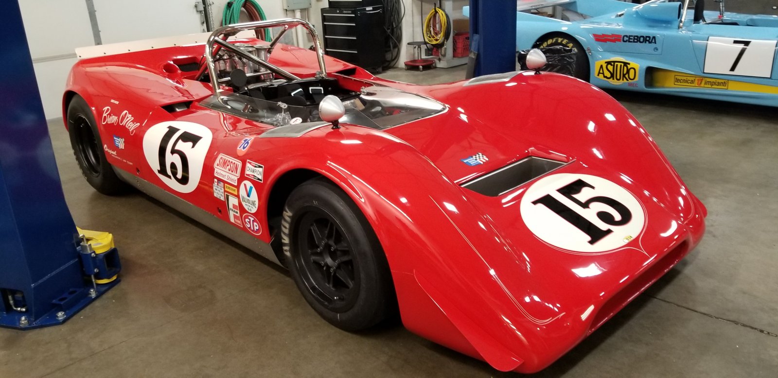

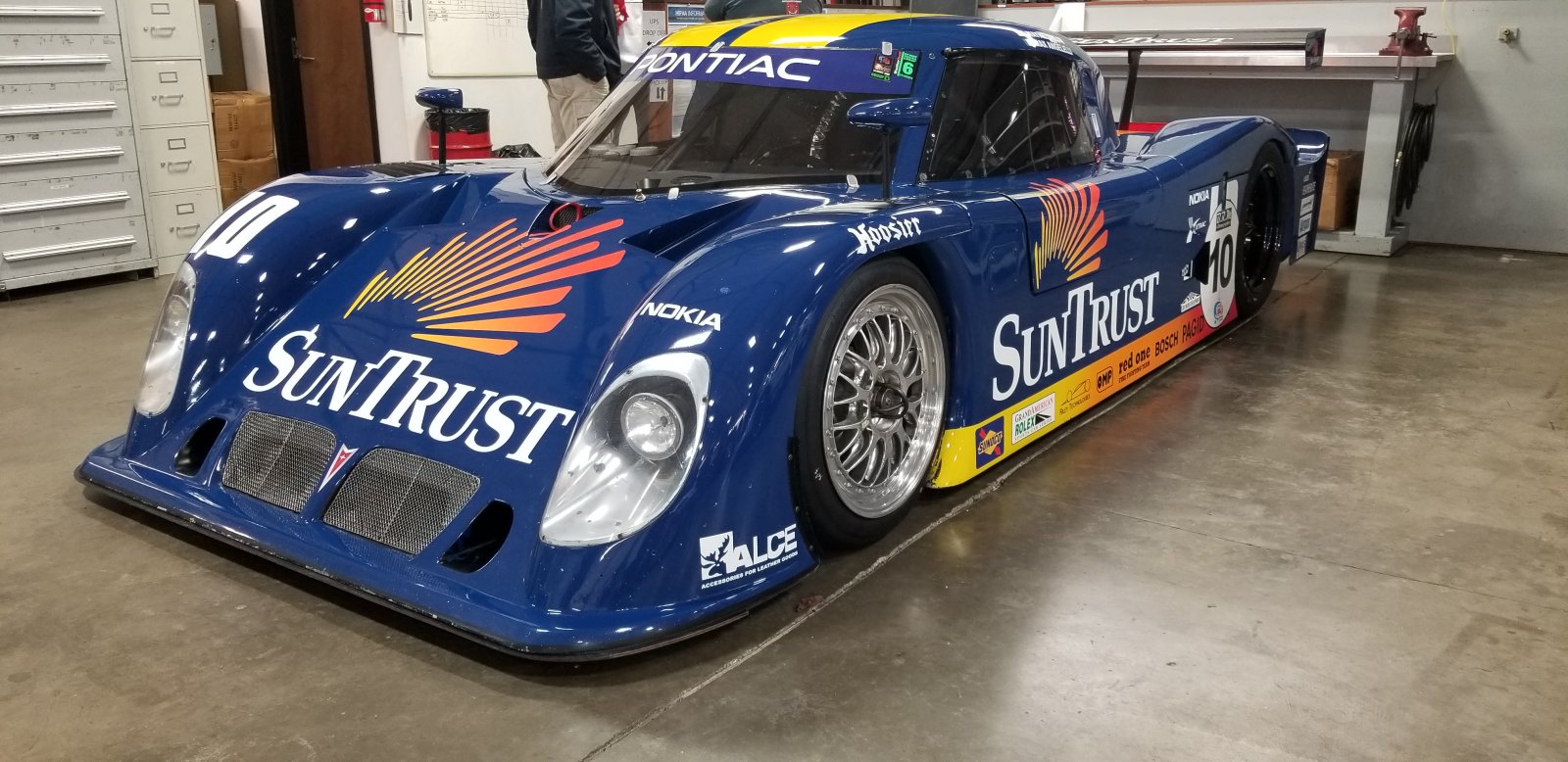

Had the opportunity to go to a Christmas party at a friend of friends shop. Talking, gawking and picking up some fabrications ideas!

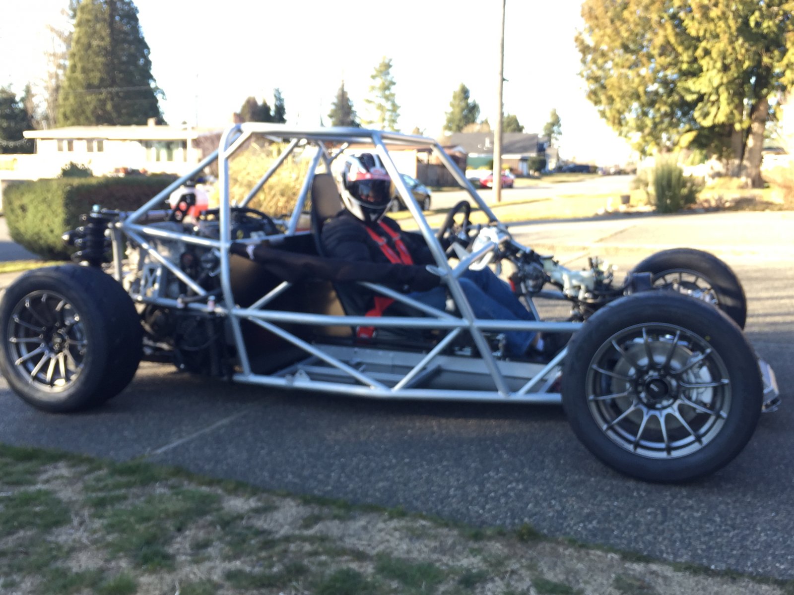

Getting back at it. Got the drivers side harnesses and seat bolted in last night. Going to be a single seater for a little while.
Took it for a spin around the neighborhood since the weather was nice.
On the hunt for an autocross now.

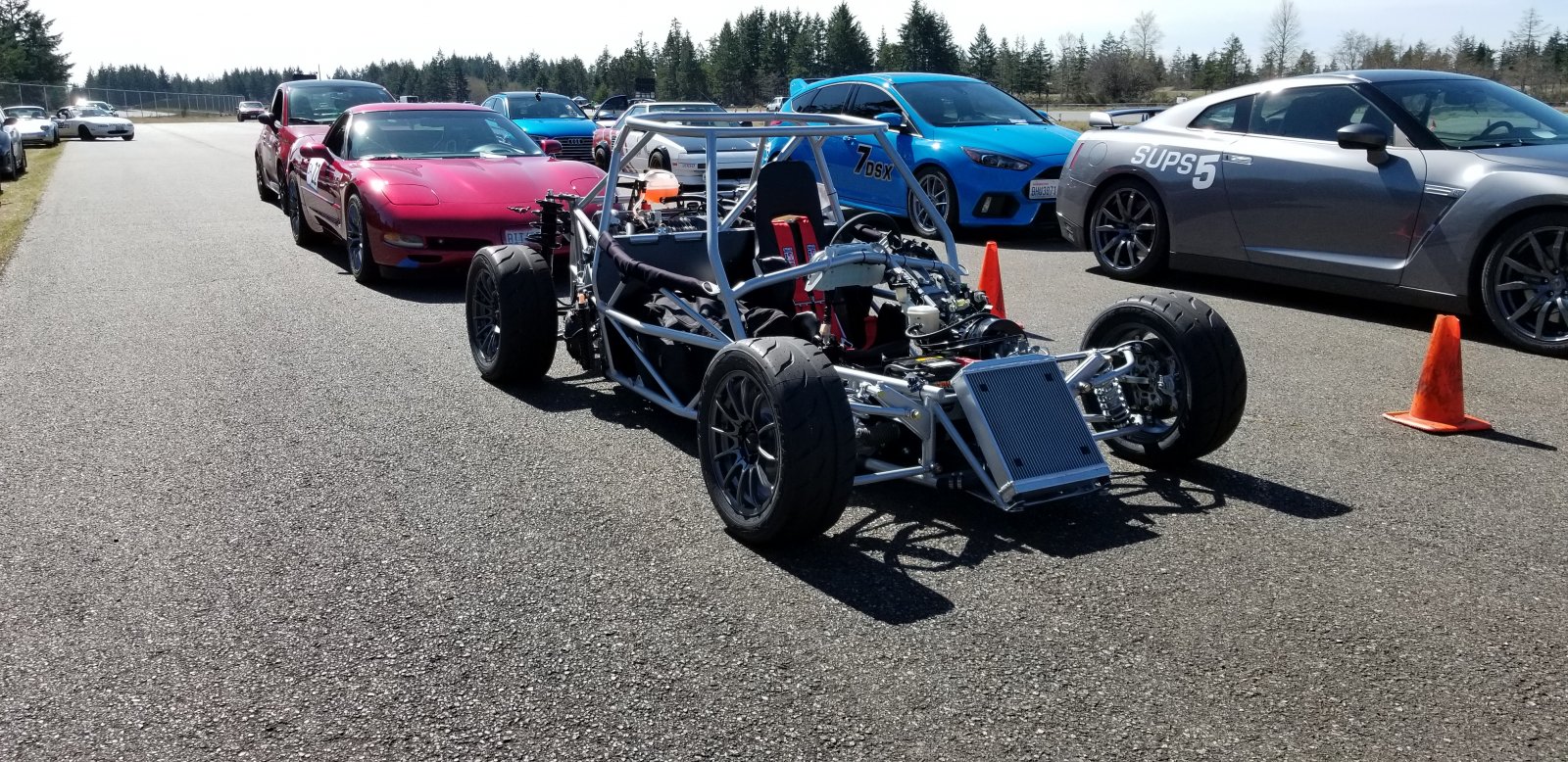

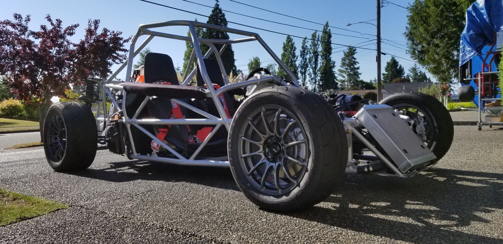

My first REAL drive. Autocross in the PNW and the weather actually cooperated.
First impressions. The car is quick! Gearing seems really good for autocrossing. Stayed in second gear for this course setup. Pulls really nice out of low RPM corners.
I was curious about this before the event but for autocrossing it will need an LSD. It was easily spinning the inside tire out of slow corners. Requires some throttle restraint.
With the current suspension and alignment it was tail happy and is lacking lateral grip. The car has it in it, just need to try a different alignment. Rear coilovers will be needed.

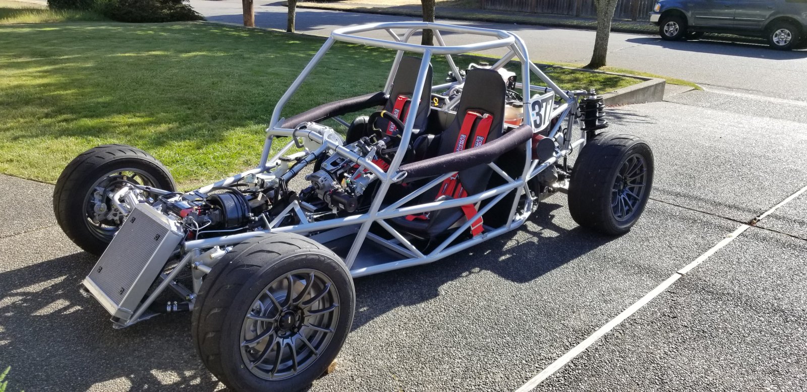

Haven't made much progress on my dash or bodywork. Distracted by all the autocross events and chassis setup.
I did Install new front springs and the rear sway bar to autocross with, which definately helped to control body roll and aid turn in. Although the stock SS bar is is way too stiff at 24mm but close to what i like. Will need to make a trip to Pick-n-Pull to source a base models sway bar to try out.
The added springs and rear sway bar are starting to make the Toyo tires work. Although I'm starting to get uncomfortable with the tire pressures they like without bead lock wheels. Hot F: 11 R: 12
So far it's been fun to work on the chassis setup and run times close to cars that cost as much as house. In my run group I was able to run within 1 second of a 911GT2 RS and 911 GT3. Further chassis tuning and Hoosier's will get it there no problem.

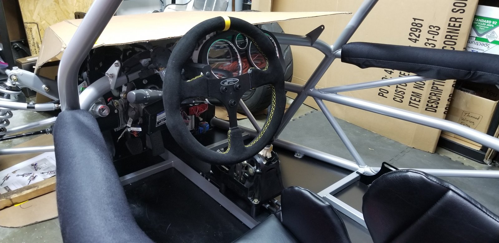

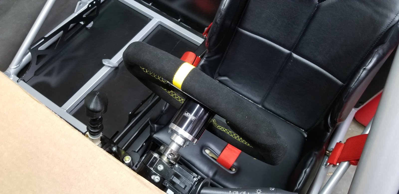

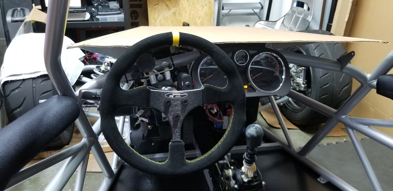

I added a new steering wheel last night.
Making it look and feel more like a sports car.

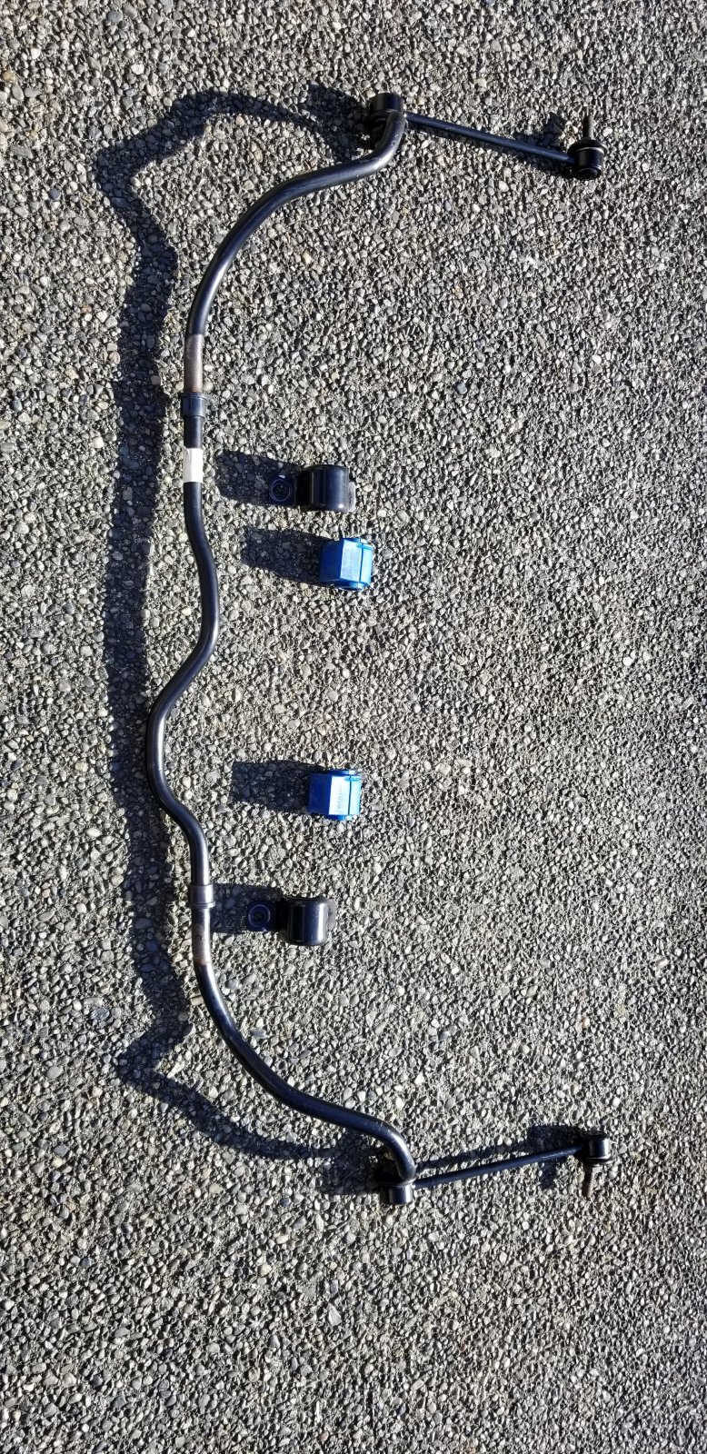

Went to Pick and Pull today and pulled a base model sway bar to try out in the rear. It has recently replaced bushings and end links and only $30. 18mm bar instead of current 24mm bar.
Tomorrow I'll take the muffler off and swap them out.

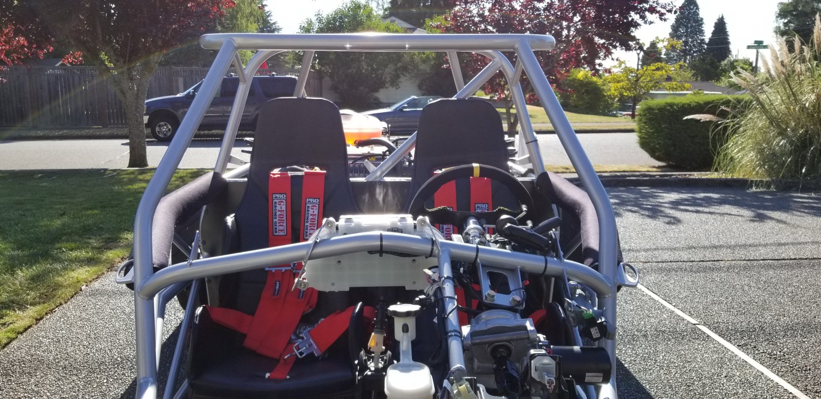

Finally got a second seat and was able to get that installed today along with the harness!
