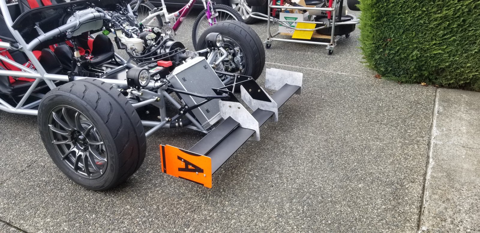

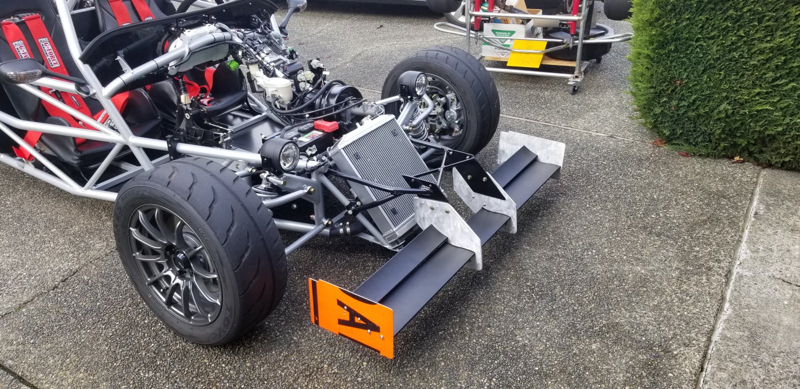

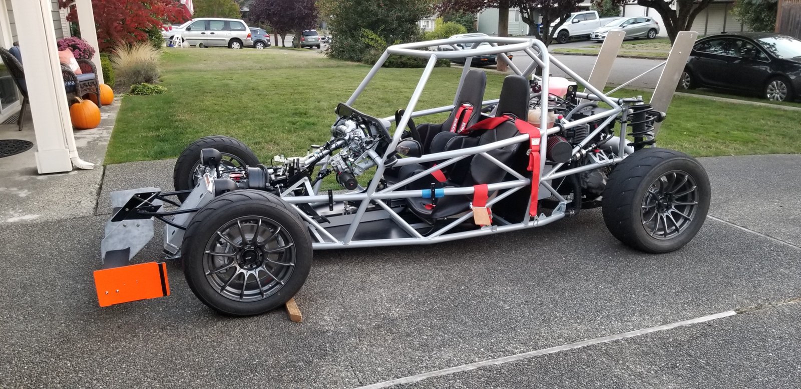

Front endplates done. Next, chop the 2nd element and bolt in place.

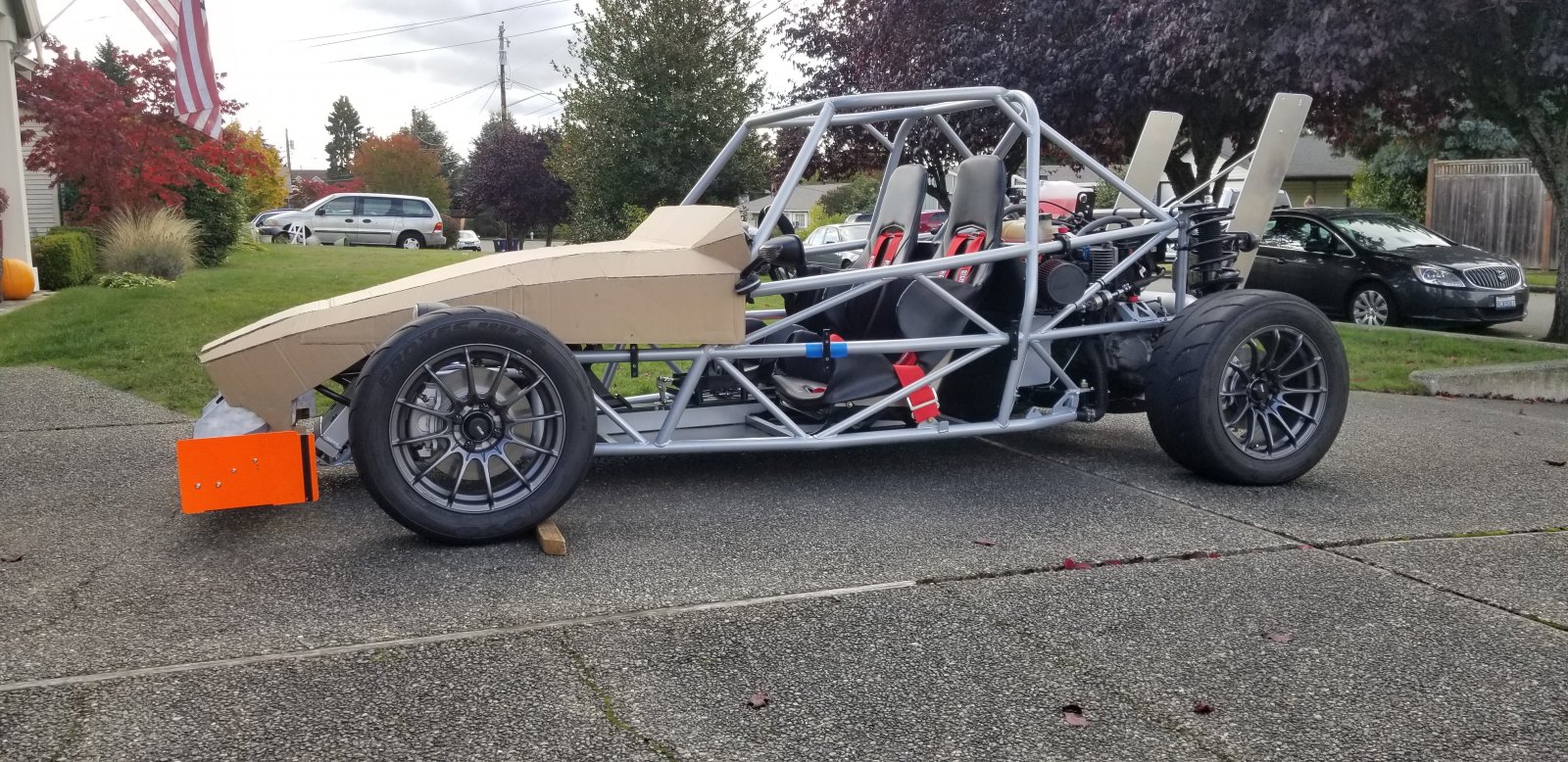

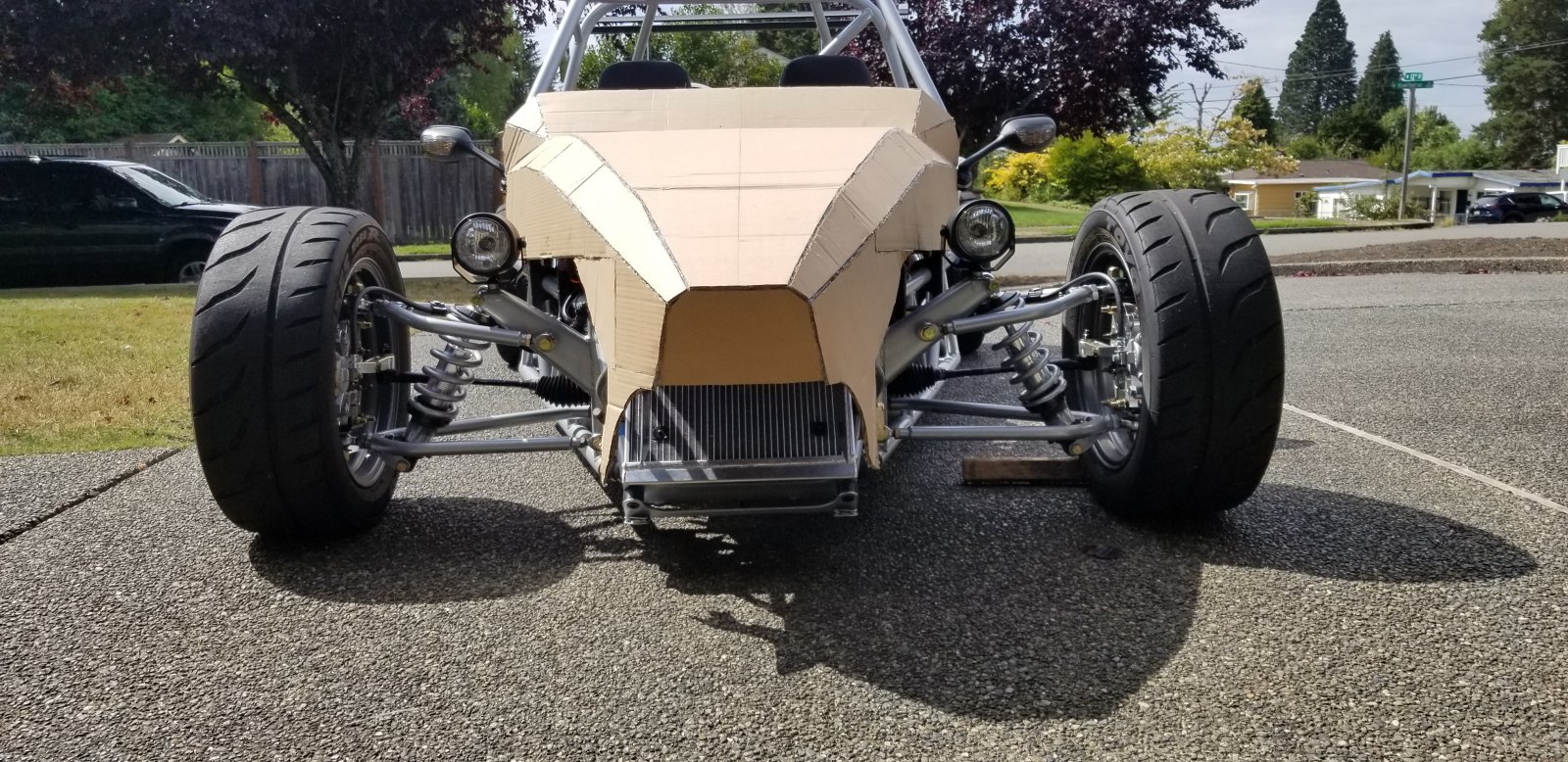

Yes, I still plan on a hood and bodywork. I should've thrown my template hood on to get a visual with the wing, then taken the pic. I do know I'll have to widen the template around the mount area to the nose. It's close to fitting though.Looks great. Curious how it looks with the hood installed. Or are you not installing a hood?
Your fabrication skills show with your wing mounts, nice job.1 of 2 2nd element installed.

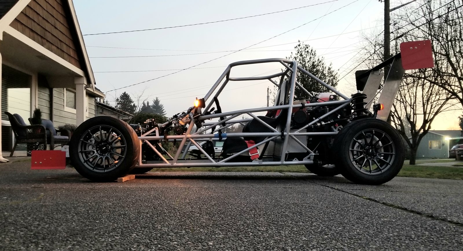

The trailing edge of the uprights measure 28in.Looks like the top yarn is blowing almost straight back, the second yarn down is better at a faster speed. As expected everything below that is all over the map.No surprise there, considering all of the conversation on the forum about the rear wing effectiveness. But your scientific method proves this out.
BTW, how tall to the top of the uprights in the video?

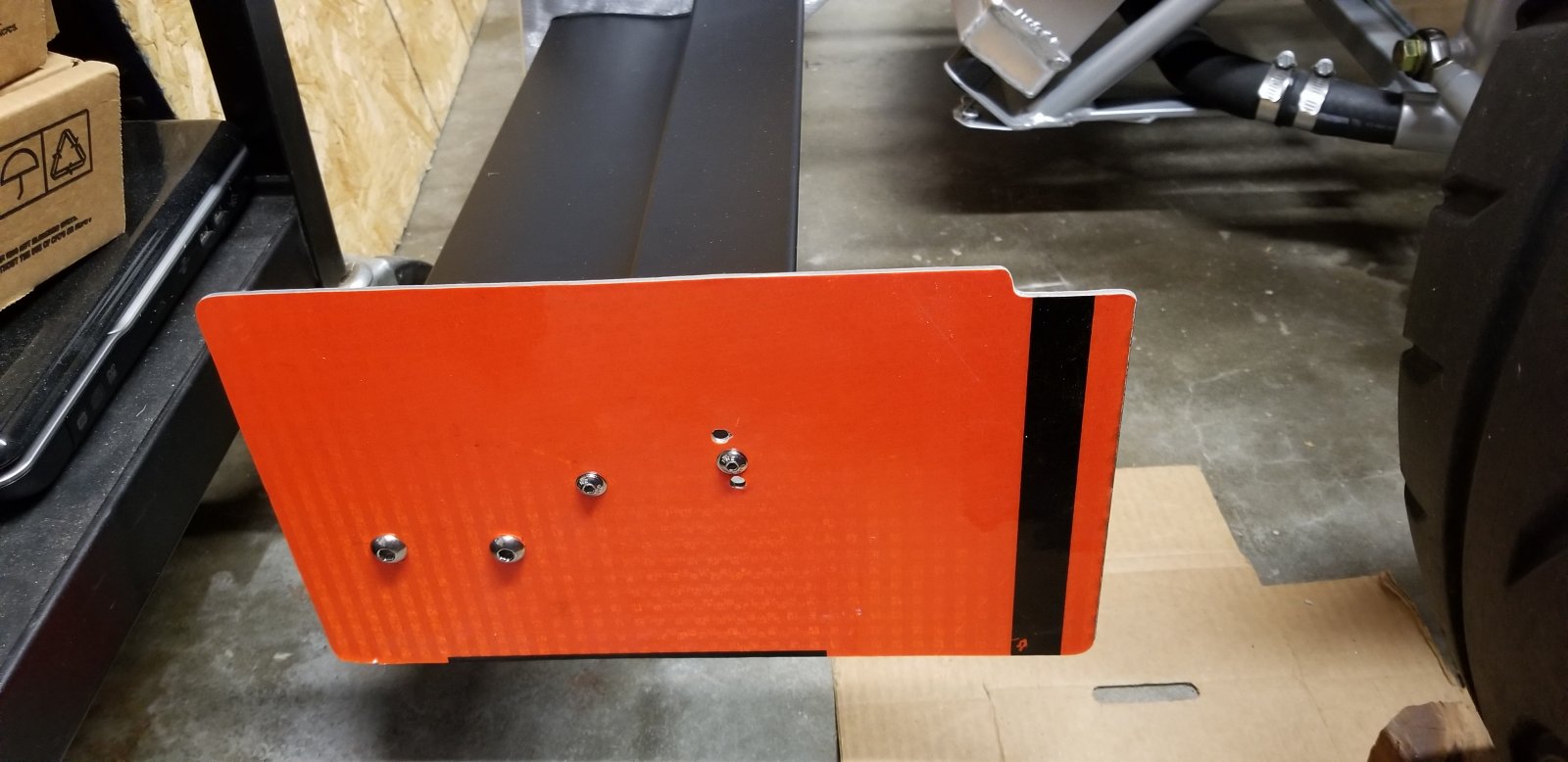

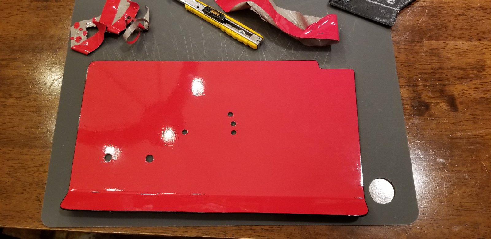

Thanks! That street sign vinyl is tuff stuff, it's a pain to get all the adhesive off.Looks good, CJ! I was digging the street sign look though
