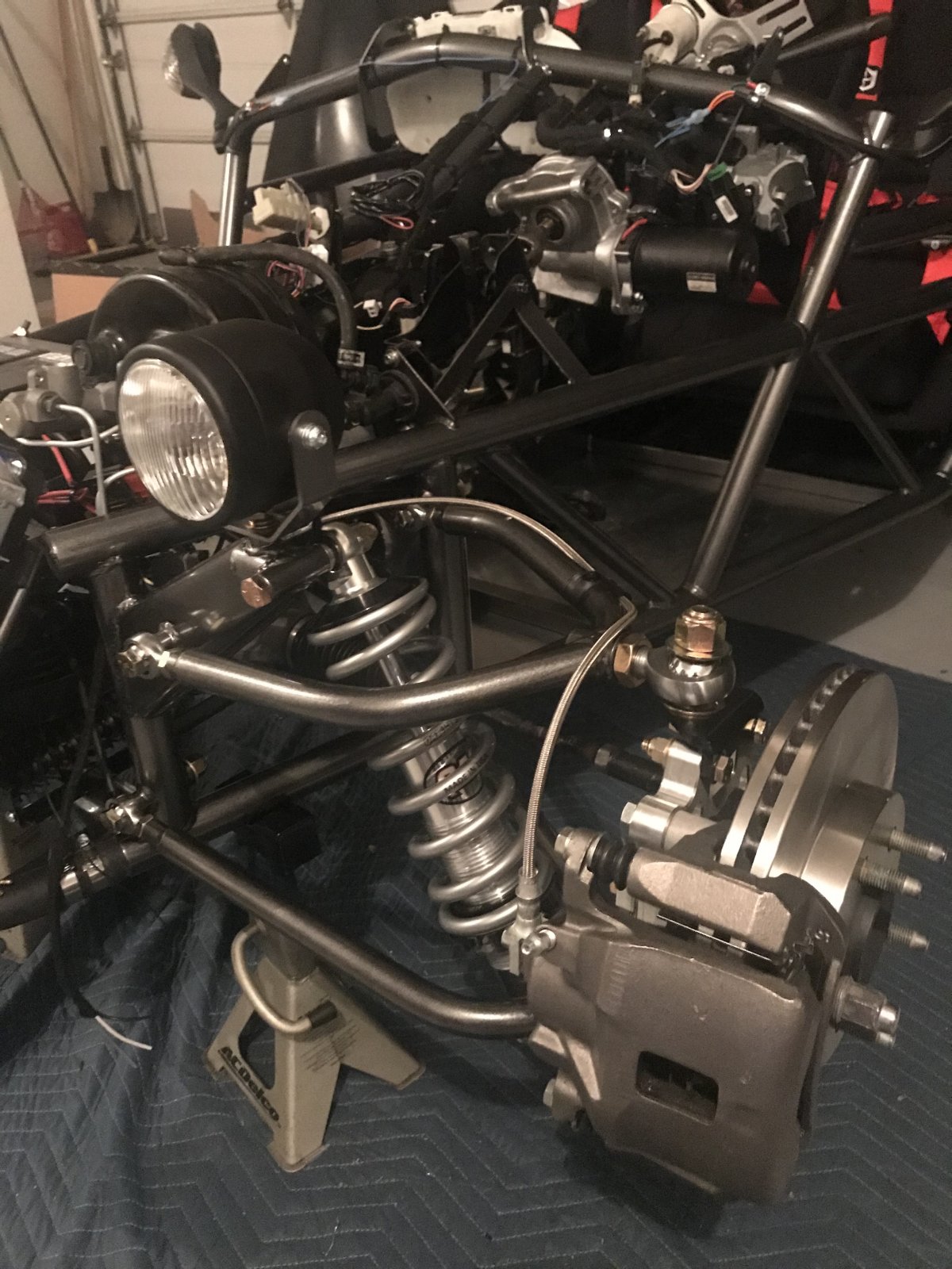

So I have a 2006 SC/SS donor. I bought the SC options from DF. I am looking to see if anyone knows the center bore sizes on the hubs I have? I have the stock hubs all the way around, with the 5x110 pattern. Doing my due diligence when ordering wheels to make sure they will fit, and I get the correct sized hubcentric rings with the wheels. Unless I won't need them...the Cobalt isn't lugcentric, is it? Always appreciate the help guys!

65.1mm for the 5 lug SS hubs. The rims are hubcentric.
Do you know what your rims hub diameter is? I have a 4 67.1mm to 65.1mm rings laying around I didn't need after I switch to the 4x100 hubs.

Cool will do. I found a lot of places that actually have them in stock. It shouldn’t be hard. Though, in my search for wheels, I found a set that’s ctually had the right sized bore, so I may end up going that route.

I actually decided to go with a wheel that had the correct center bore already, so I won’t need rings at all. Now to decide whether I want 16” or 17” wheels. Leaning towards the 16”, but not entirely sure yet.
