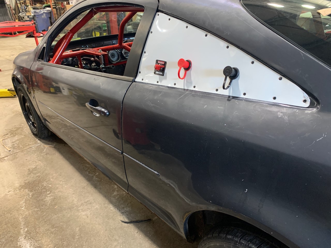

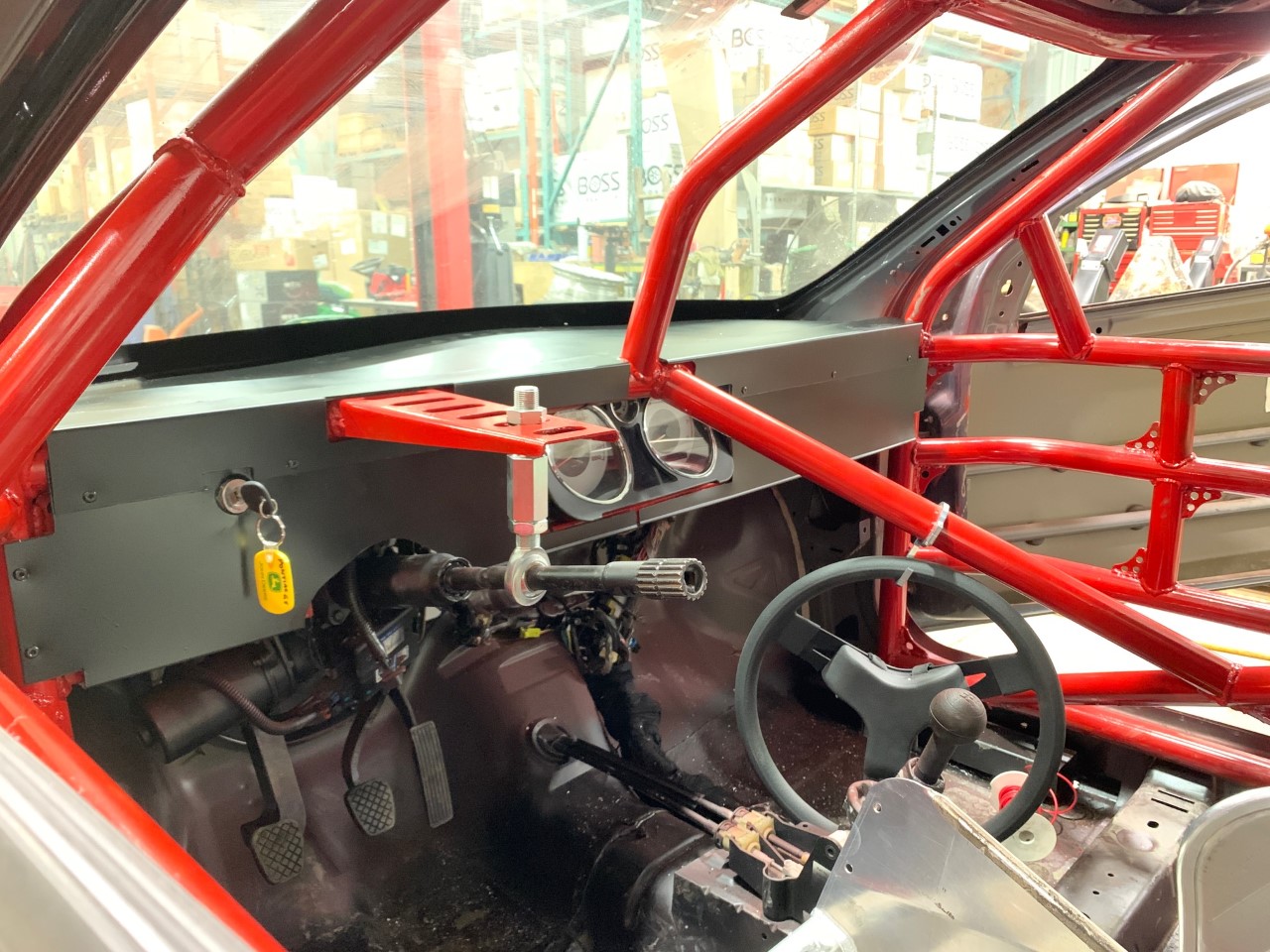

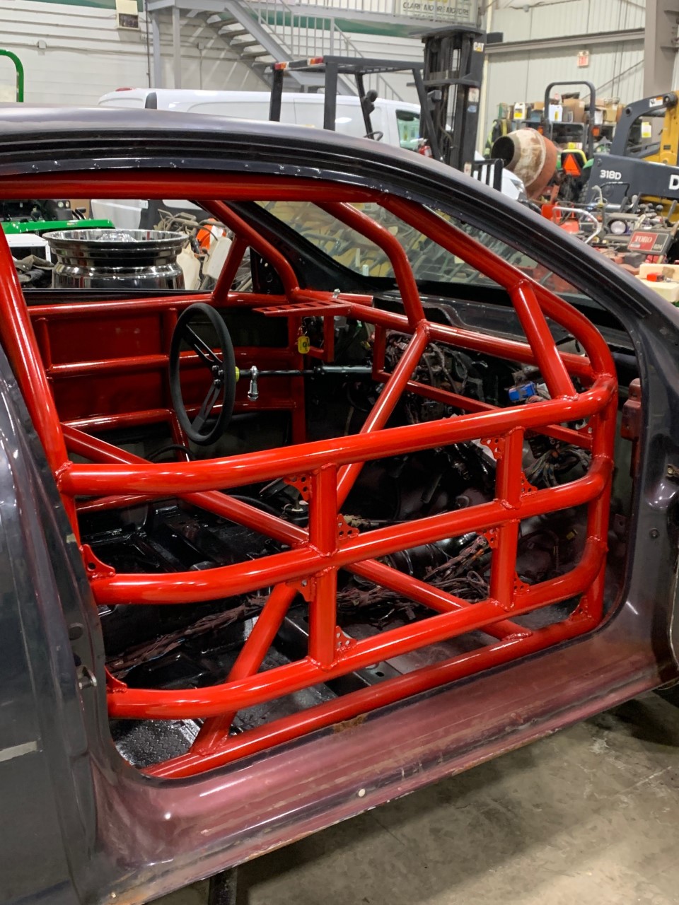

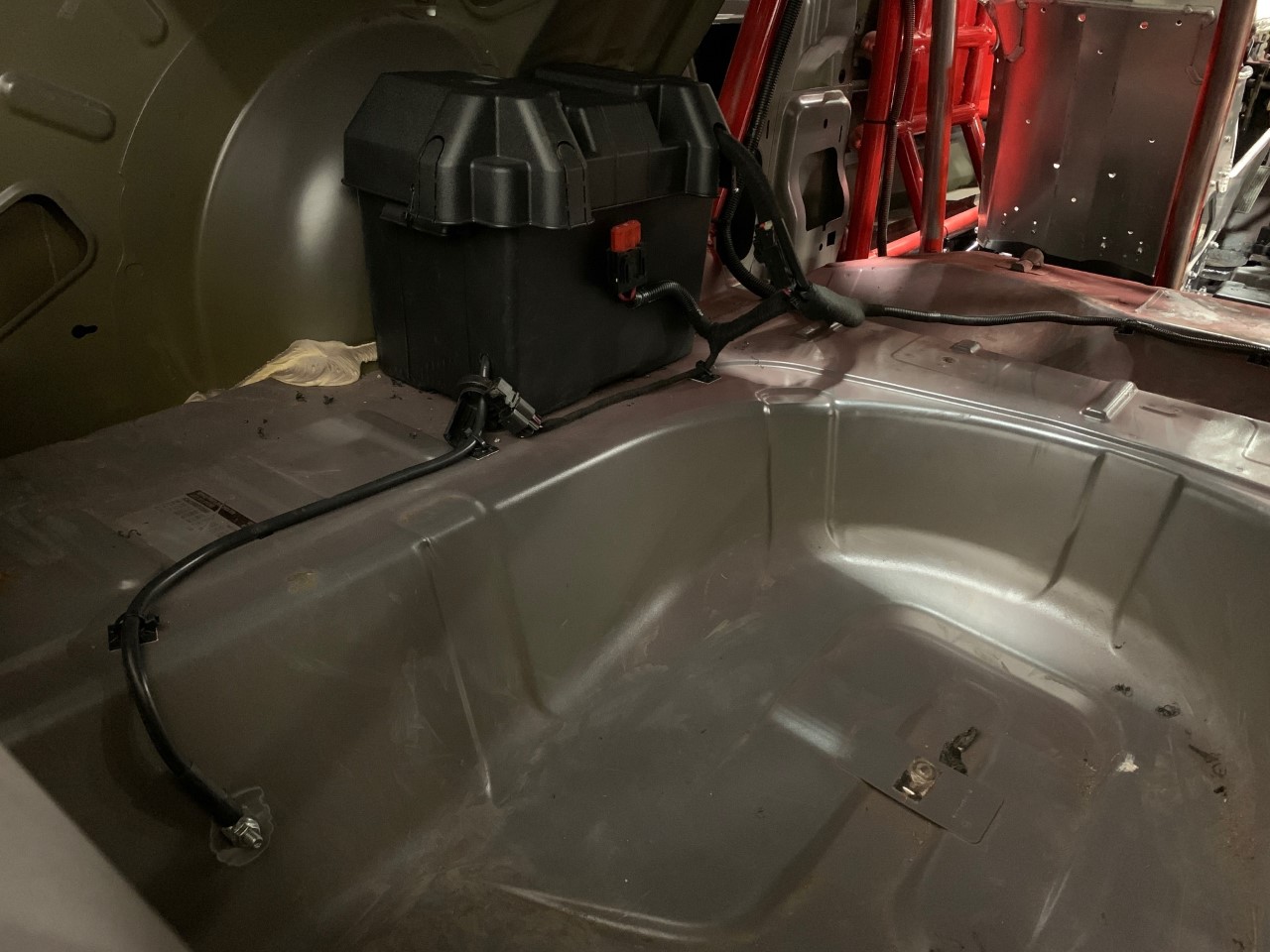

I'll attach a couple photos, so you know I'm building something actually and not wasting your time.
