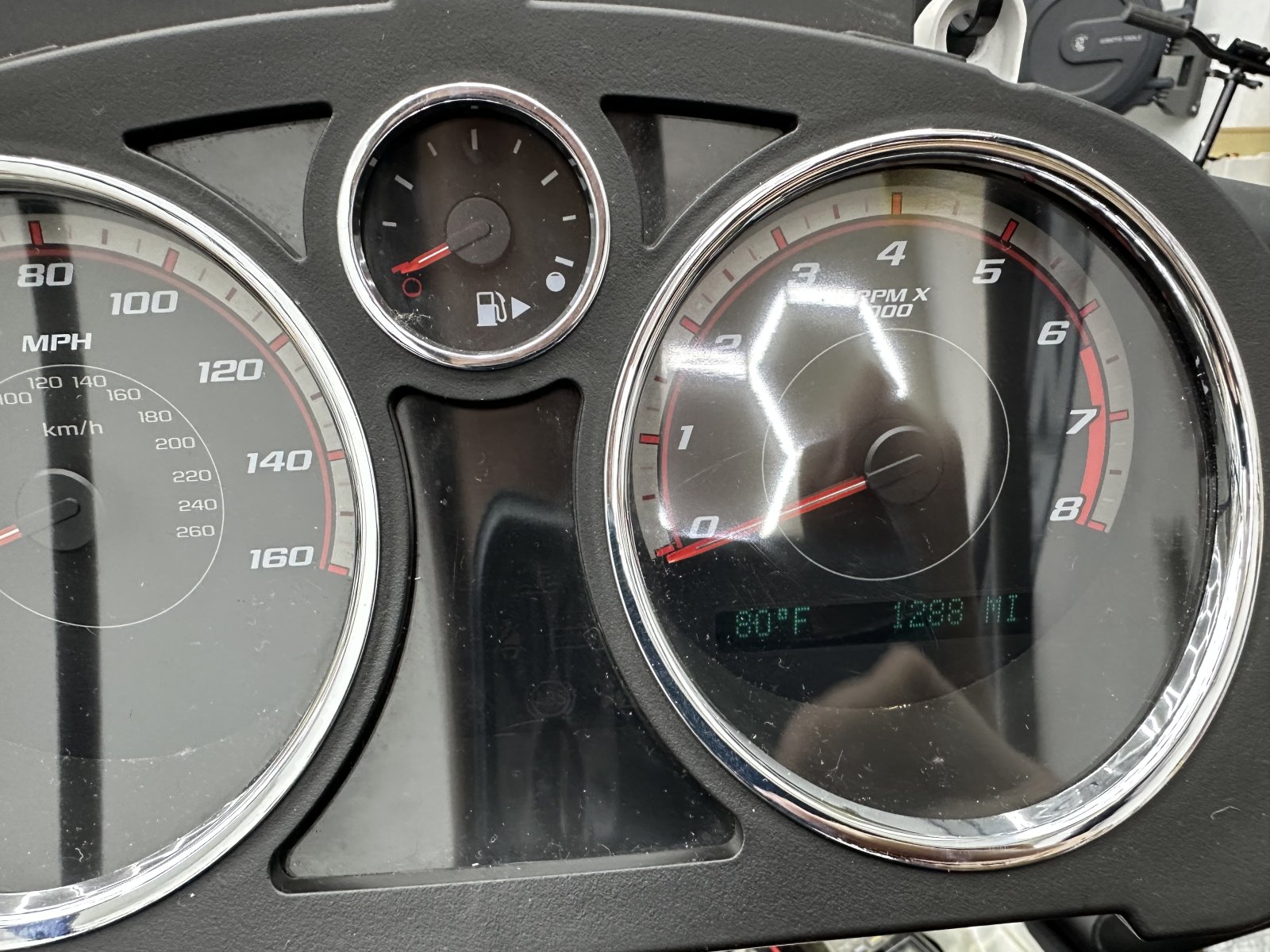

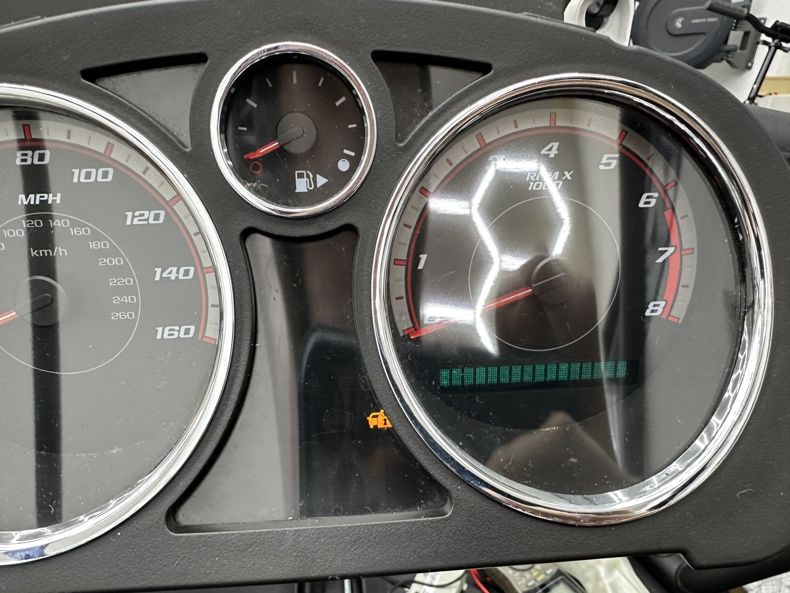

Momentarily it’s all green boxes but quickly goes away. I don’t think I can upload video. Picture one is initial. Picture 2 after 5 seconds.
Security light does stay long long enough to do relearn procedure if anyone curious.

Data is definitely flowing. The problem is likely the above. I had to replace those bits on my car and it wouldn't start until I had swapped the PCB from the old TDM into the new TDM. I'm sure there's a procedure that can be done, but, something definitely needs to be done there.
