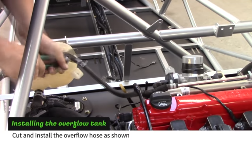

Following the instructions for part 20. At the end of the video they hook up the coolant overflow line to something by the fuel rail. I don't see that on mine? What do I hook it to? 2010 Cobalt LS XFE 2.2L Manual.

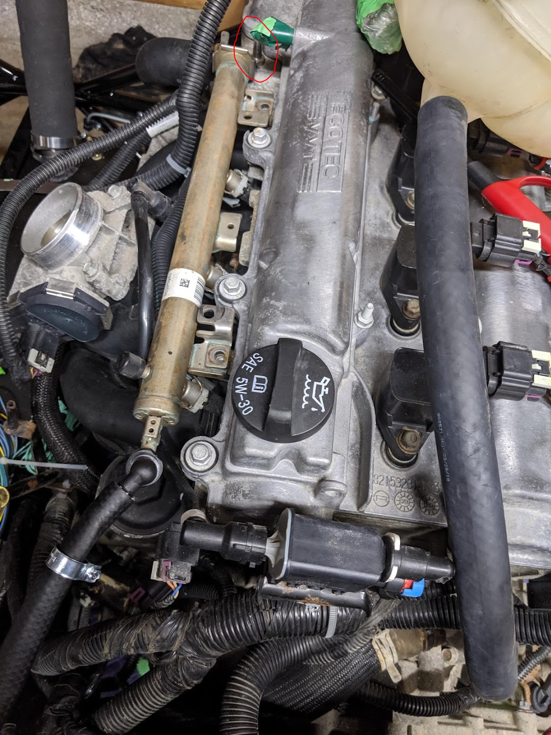

This is an 07 LSJ , doesn’t look like your ecotec has this line.

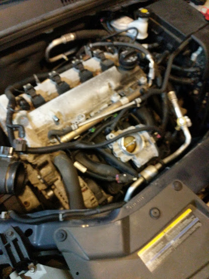

I think I figured out what I did. If you look at the fuel rail, its not bolted in. I took off the valve cover with the intention of painting it, and that was probably in the way. I found an old (blury) picture where you can see something else sitting on top where the fuel rail is.
10428

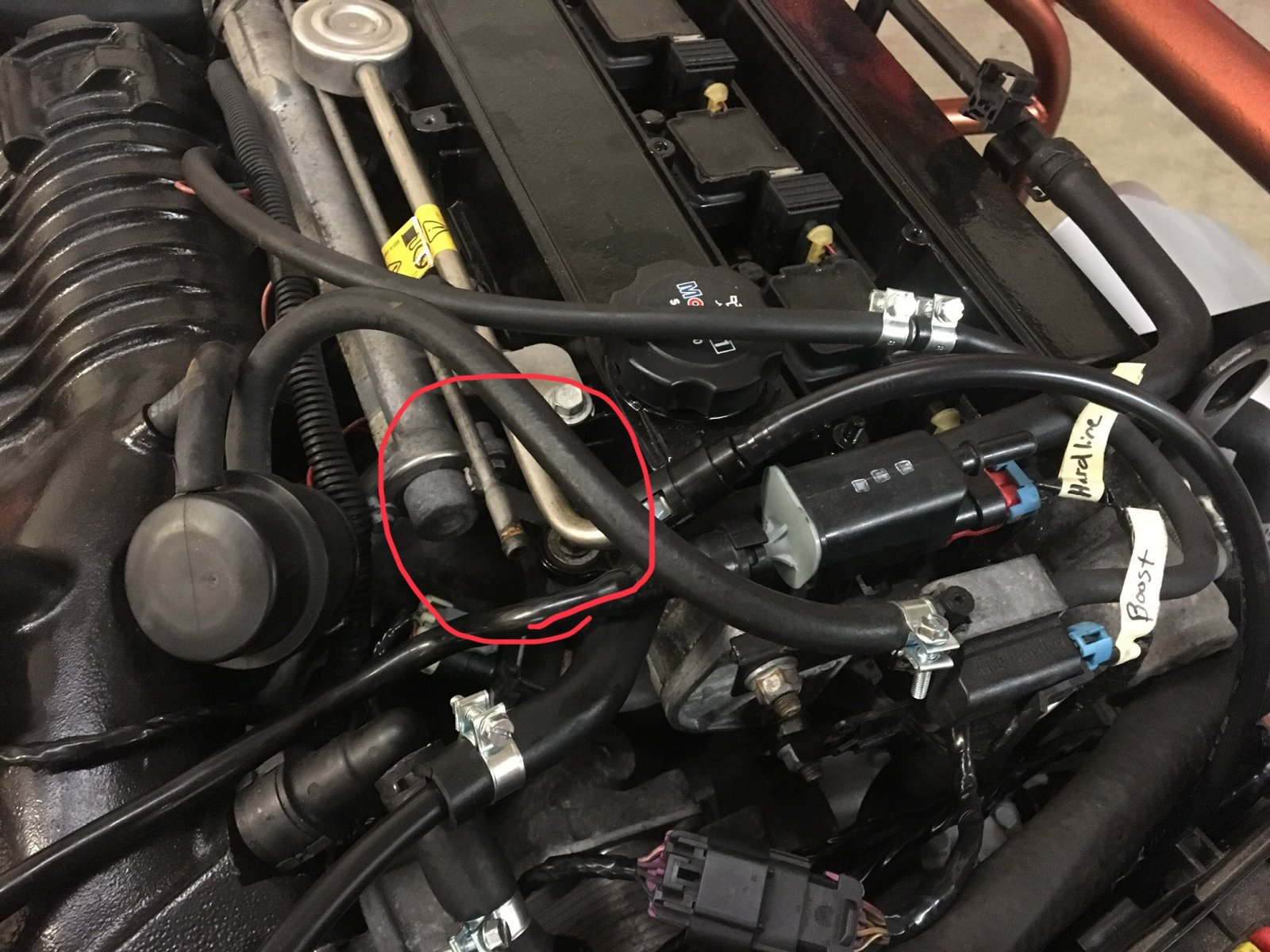

I need to find that, and plug it back into here:
10429
