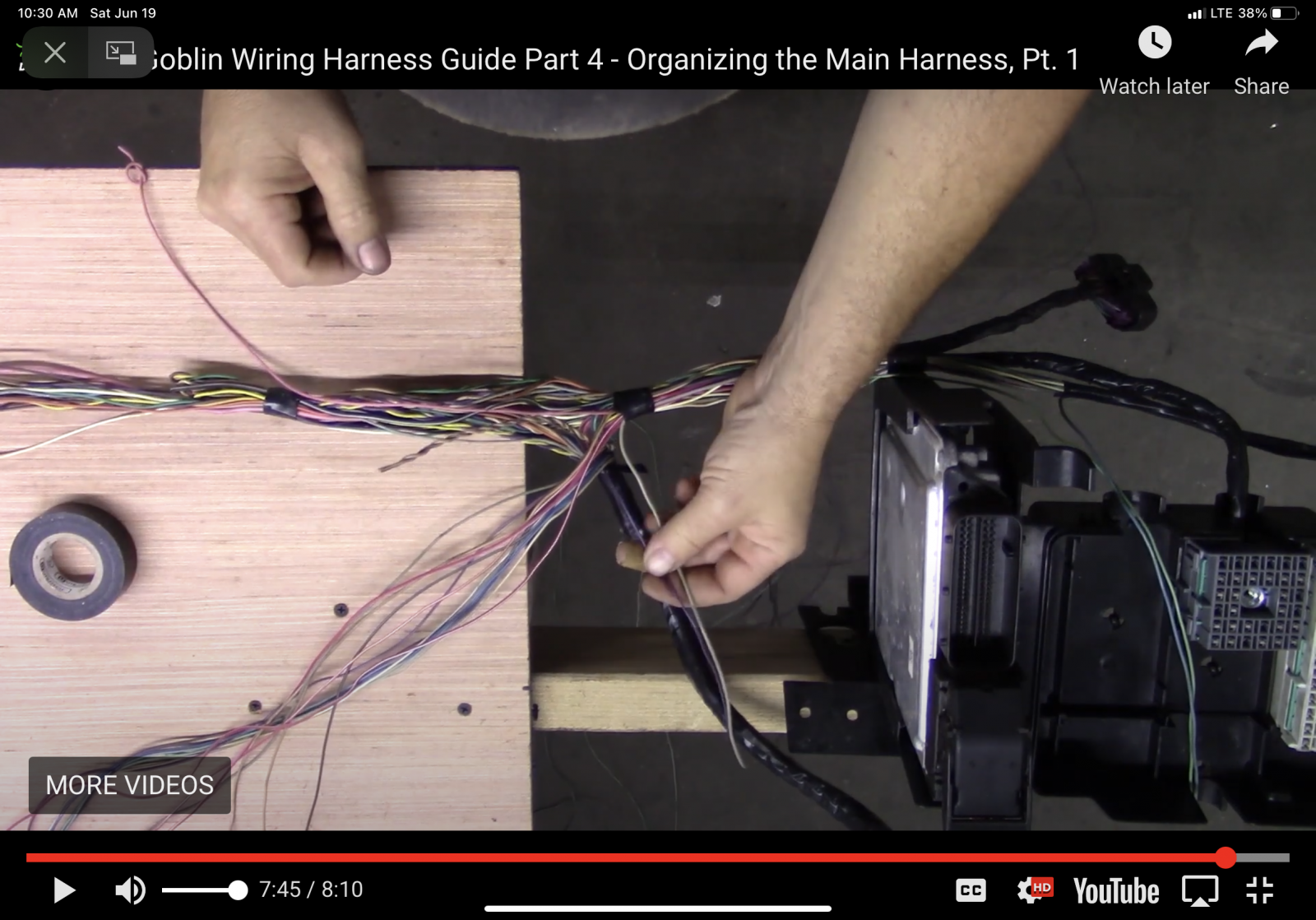

Wiring harness Guide part 4 organizing the main harness part 1. At 7:45 says I should have a Pink coolant wire. I do not have a Pink coolant wire. My coolant wires are Green and Black. I tied a knot in the black wire and moved the green wire with connector to the BCM. What is the Pink wire and where does it go.

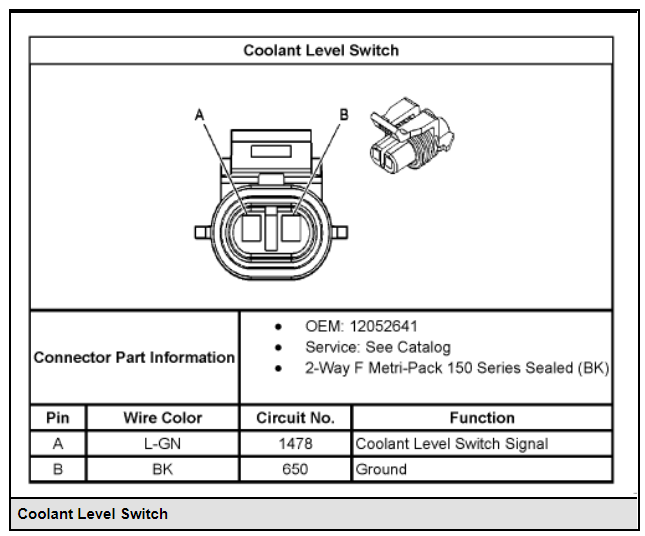

Lonny says the pink wire is for the coolant level.
I've been looking thru the AllDataDIY electrical LSJ diagrams, and haven't found the right spot yet...
but video 4 isn't on an LSJ, so there will be some differences.

We made a mistake on the video. Pink is for the brake fluid level, light green is for the coolant level.
