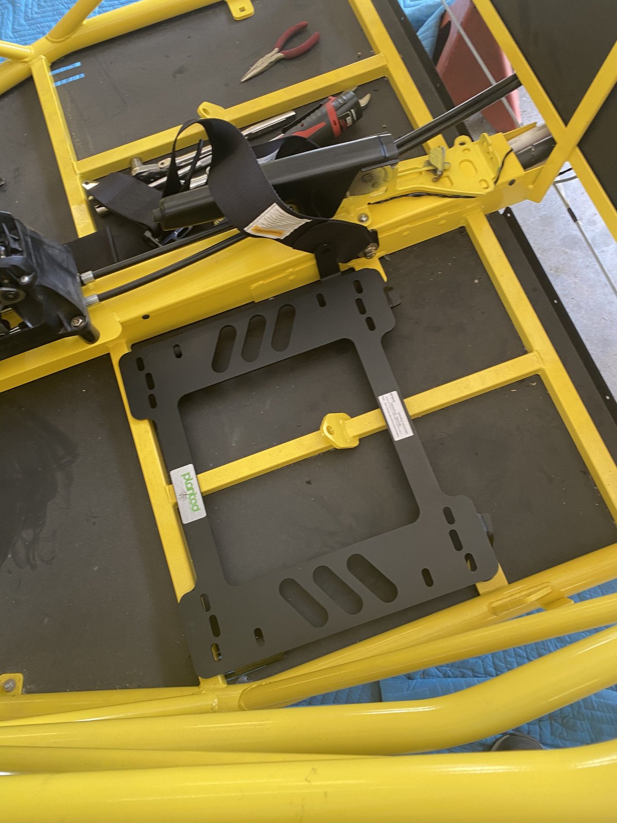

Is there physically room to mount the Corbeau seats lower than where the DF mounts place them? If so, about how much lower could they go?
RouteAbel
I think you could potentially lower it about an inch. You could maybe get 2 inches if you were to cut off the mount for the submarine belt of the 5 point harness.
Check out Planted technology cobalt seat mounts SB225DR and PA
Not sure if this helps, but they sit right on the rails of the goblin. direct fit to a cobalt, so direct fit on the goblin.
I almost got these for my Braum seats, but the person I was reading up on who bought braums before me said he got these and they didn't work and need a LOT of welding ot make work.
I'm sorta bummed that I didn't go this route because I'd much rather this way of installation rather than my stopsign brackets that I did.
Also those seat mounts are not cheap.
