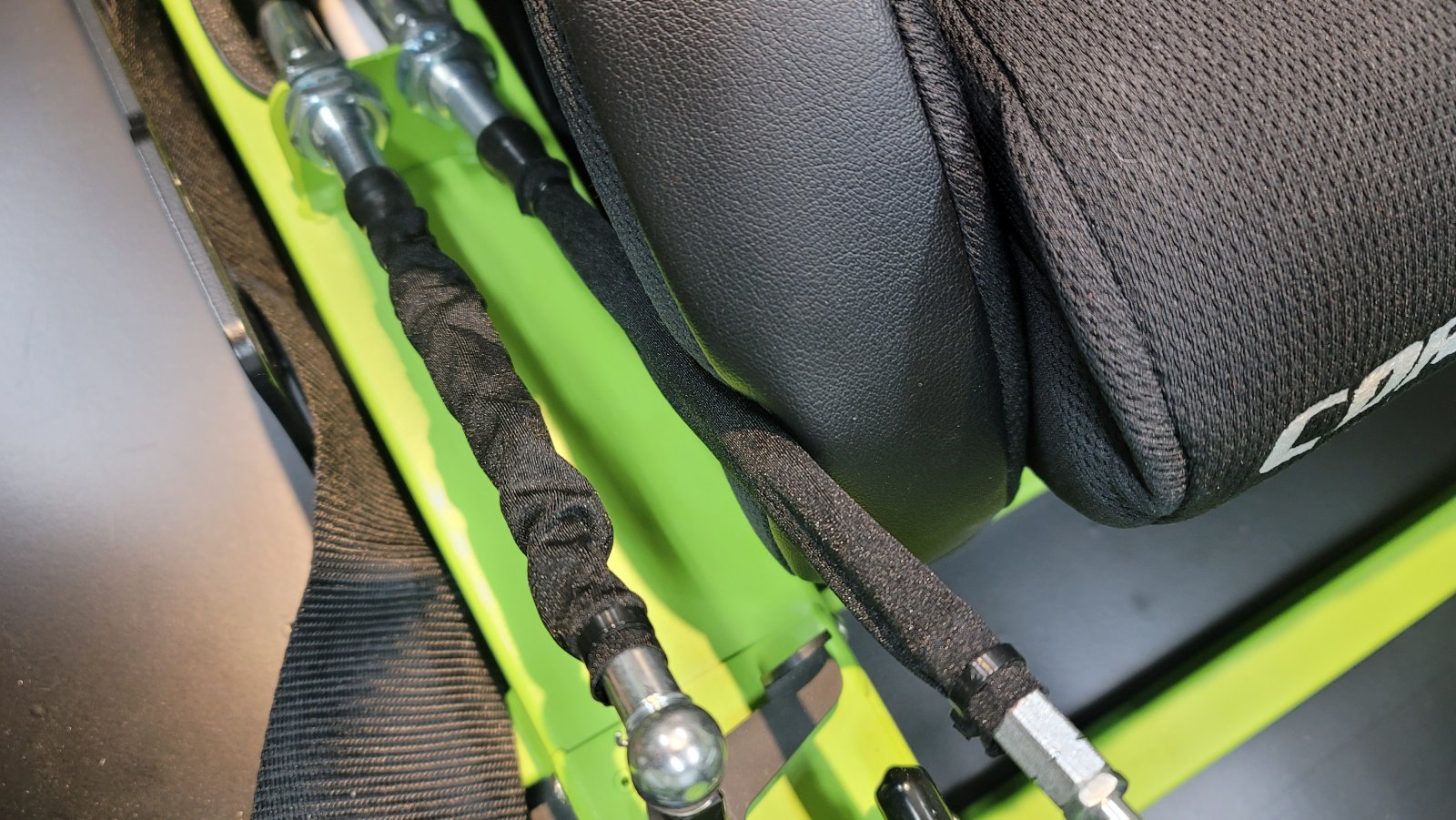

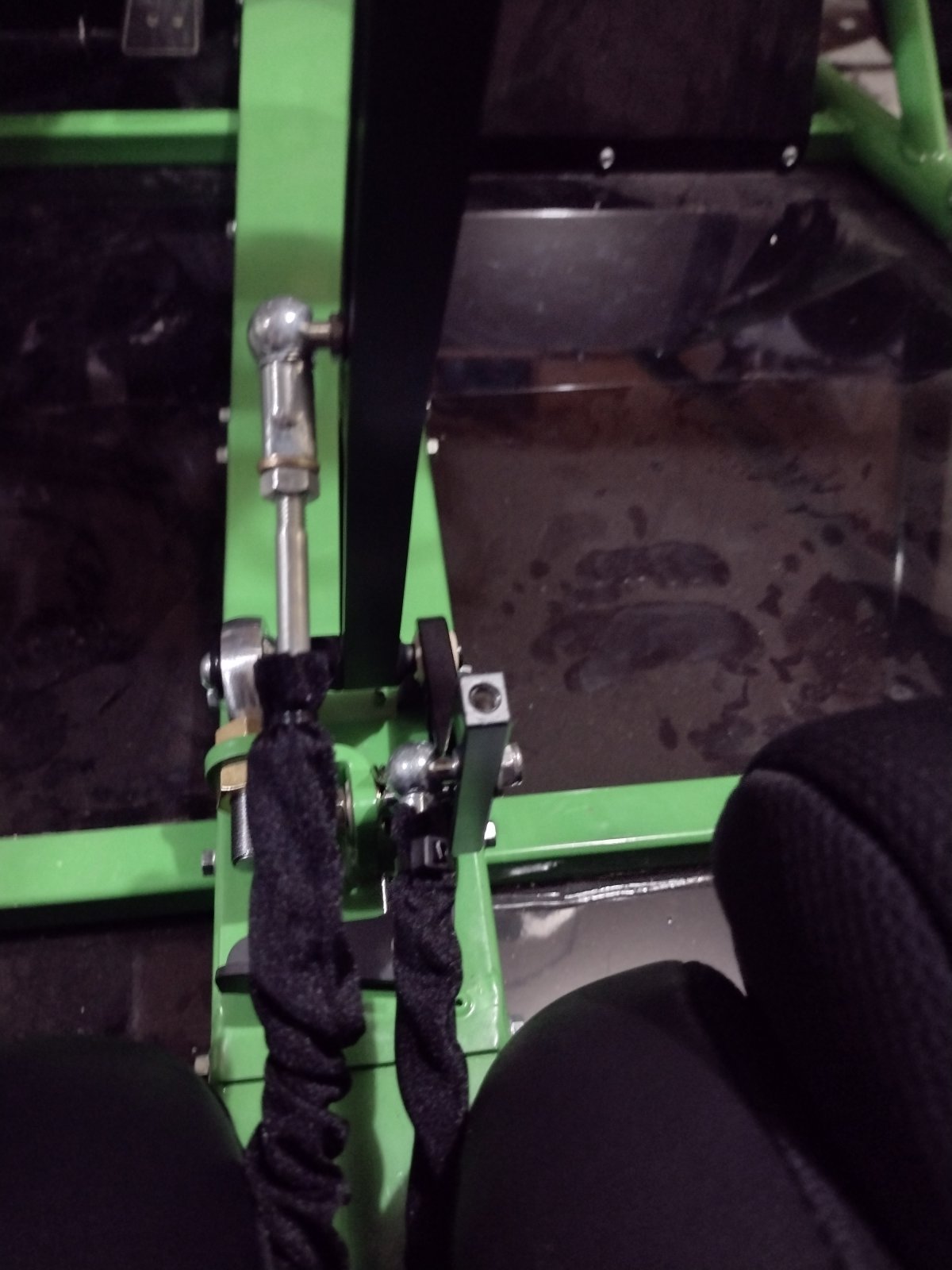

What have others done to prevent the seats from hitting the cable and making you force side to side in neutral?

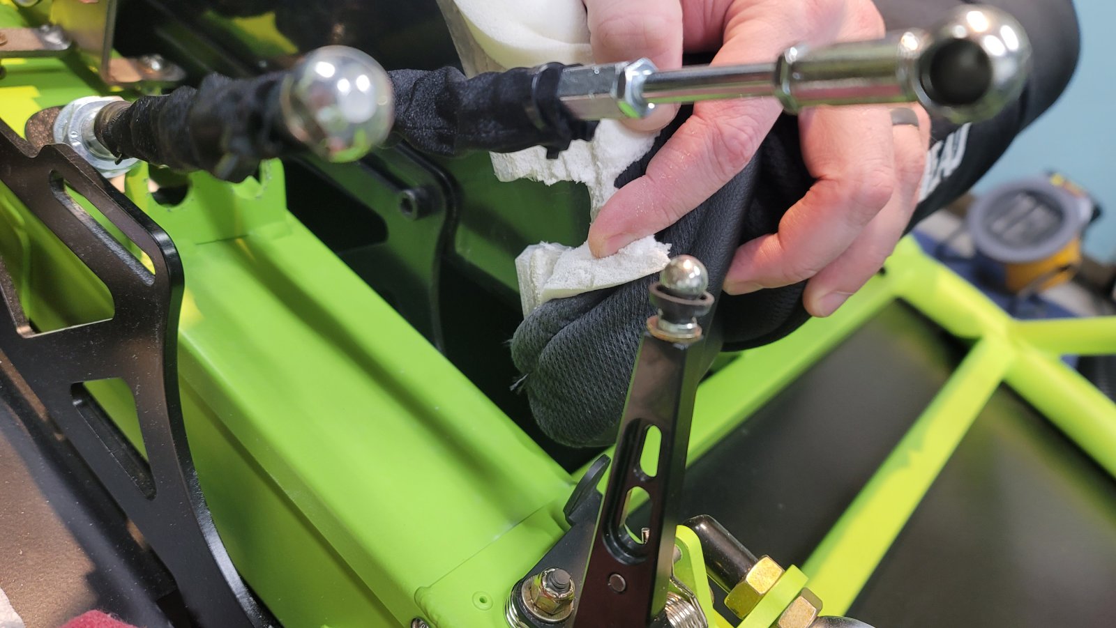

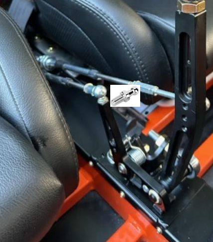

If you are willing to drill and thread a new hole in your shifter arm,
you could mount a ball stud on the inside of the arm,
and that would move the cable over towards the center of the tunnel.
Of course, you could consider modifying the passenger seat.

That looks good Ross thanks I thought about that. I'll look into it. Any idea on what ball size I need? I'm seeing m5 and m6. I don't think I have an option for the driver side. Maybe a washer under the inner bolt.
WA08TC
Not sure how long it is might need to tap it but I'll check that out first. If not I'll pick up both sizes. Seems like local hardware store don't carry those.
WA08TC
Moved it to the side glade I have a nut laying around also moved the DS rod to the lowest hole. Everything clears nicely and is smooth now. Thanks for the help everyone.

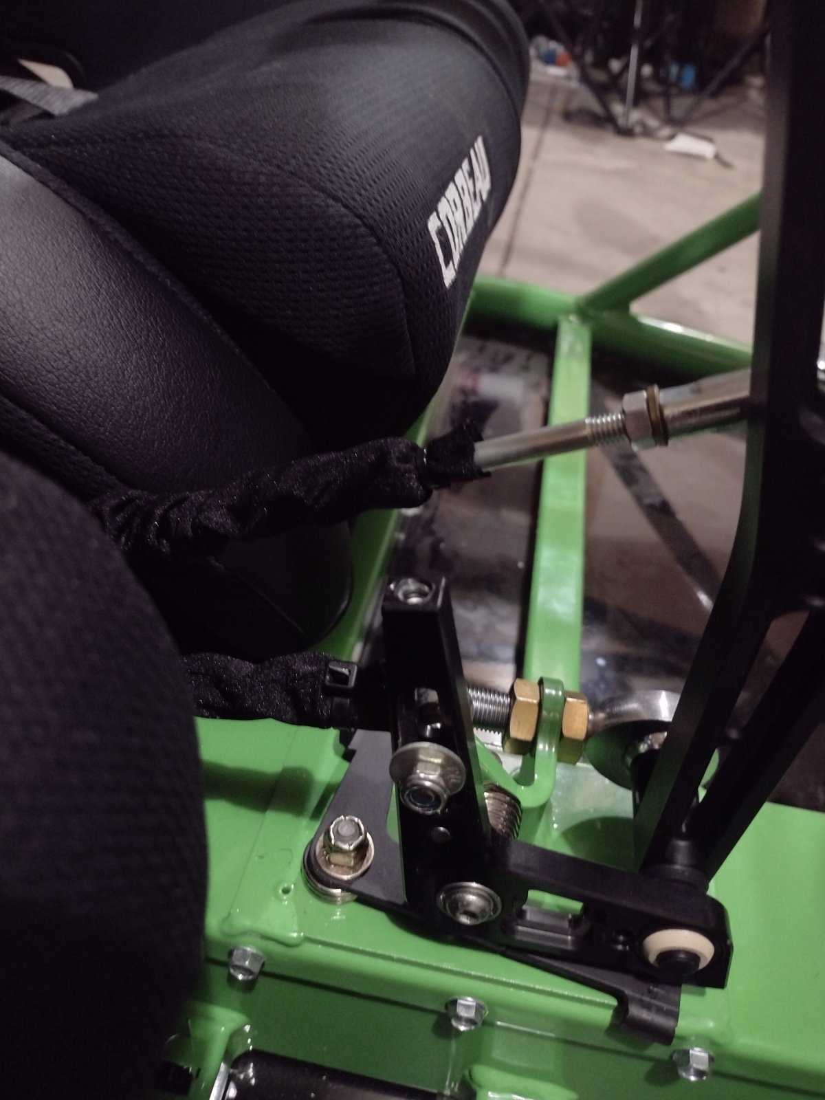

Update not enough movement forward and back with the passenger side selector can't get into reverse. Being on top gives it more movement but very hard to shift.
Joebob
Keep it on the side mount but move to the top hole so that you get more cable movement. You might also need to reset the cable length to the new position as well.
Take out your old school compass and draw a 1" dia arc and a 2" arc(using the same center point). Then get out your protractor, 30* on each arc is quite a difference! Man! shifter motion is an ugly "can of worms!" You only have to remember every mm Closer the shift cable end joint gets to the pivot joint on the shifter Subtracts throw and every mm Away from the pivot point Adds throw and slop. {Designing a shifter gives quite a headache!}

All is well, used the top side slot and went all the way in on the trans side ball socket. We are good!!

Fx1 not pro or wide. Front position for both. Was actually very easy to adjust the trans side all the way in and just put the ball socket on the side. No hole drilling needed just a couple seconds w a drill bit to enlarge the opening just a hair.

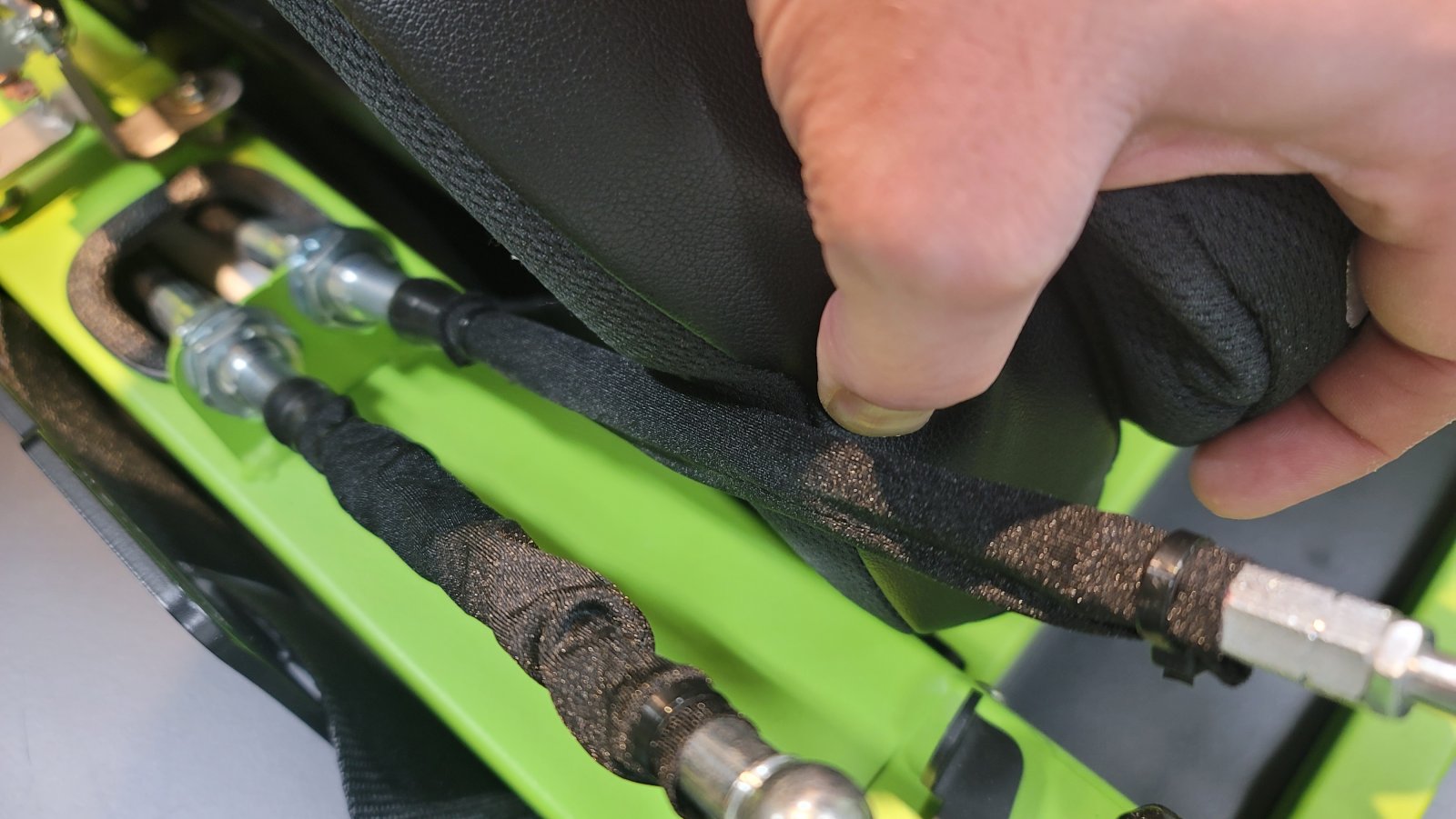

ToothMagician
Had the same problem, went the other route. Peeled back the seat cover and used a Dremel to cut out a small ~1x1 square out of both seats for clearance:
