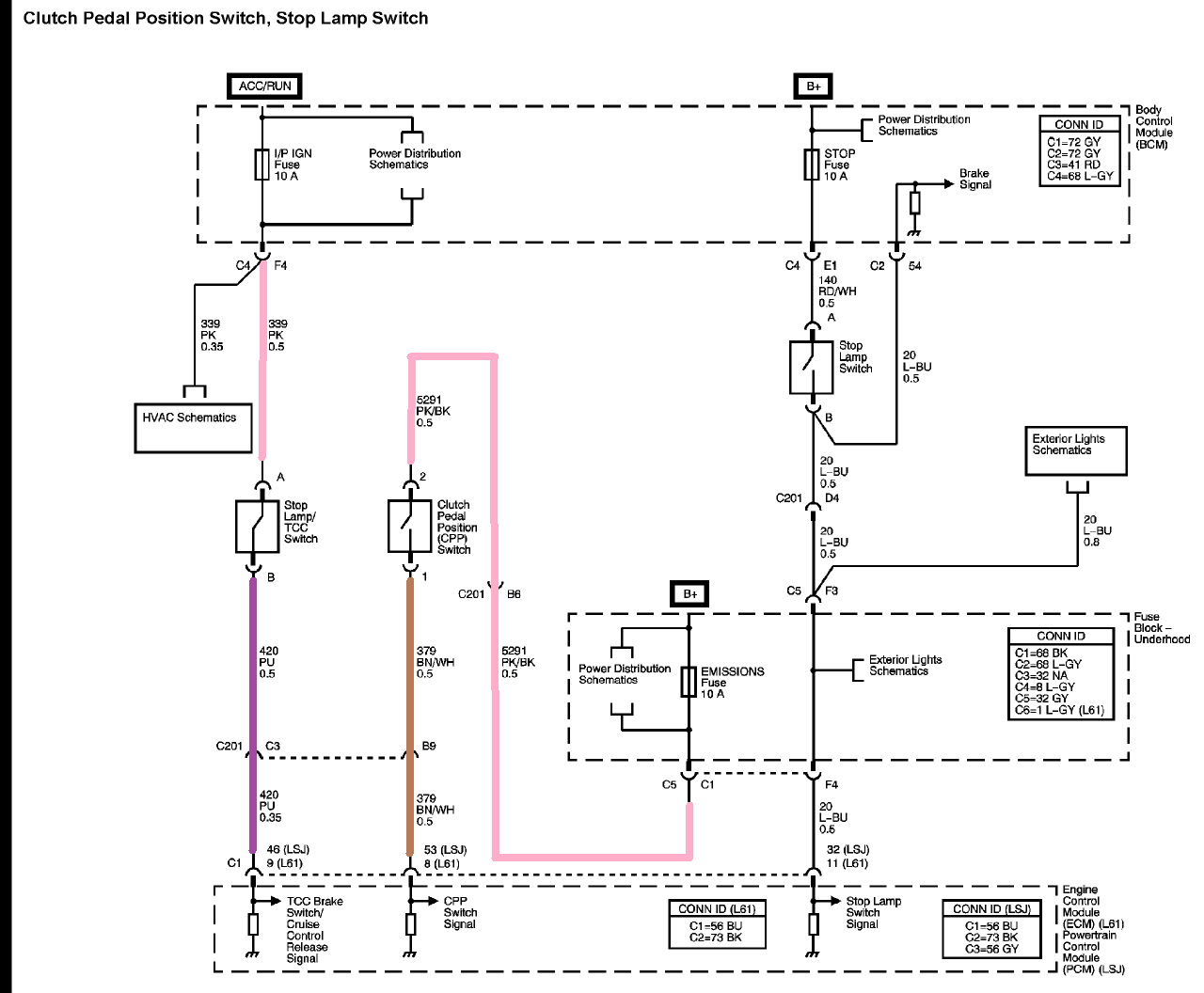

Aside from the resistors at the control switches, you also need the switches at the foot pedals to be working correctly. The clutch and brake switches can also cause cruise control to not work.

Wouldn't there be starting issues (clutch switches) and brake light issues (brake switches) and not just cruise control issues if those switches had problems?
Cruise control has different switches on my car. The cruise switch is at the start of the pedal movement, while the engine start is at the bottom of the clutch pedal movement.

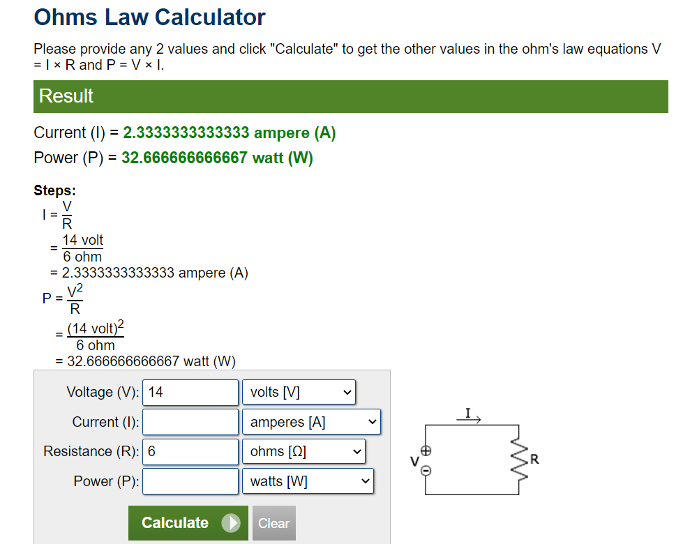

I'm taking another swing at this. I have replaced my 10w resistor with the DF recommended 6 ohm 50w resistor. The 10w was burned out, with one of the wires completely burned away from the resistor body.
So, with the new, bigger resistor, cruise still doesn't work. Also, the resistor gets HOT. Too hot to touch for more than half a second. I know resistors are supposed to be hot, but how hot is it supposed to get? It seems excessive, and makes me question if I have miswired something. The resistor is currently in parallel with the LED center brake light.
What could be up to 32 watts will probably feel pretty warm. I'm surprised that something as small as 6ohms is used. There isn't much you can do to wire it wrong since it is basically line voltage through the resistor to ground. Rockauto listed the "high mounted brake" bulb as 13 watts which would be somewhere around 10-15 ohms. Of course there is still some resistance through the LED that would have to be calculated in parallel to try and match oem.
