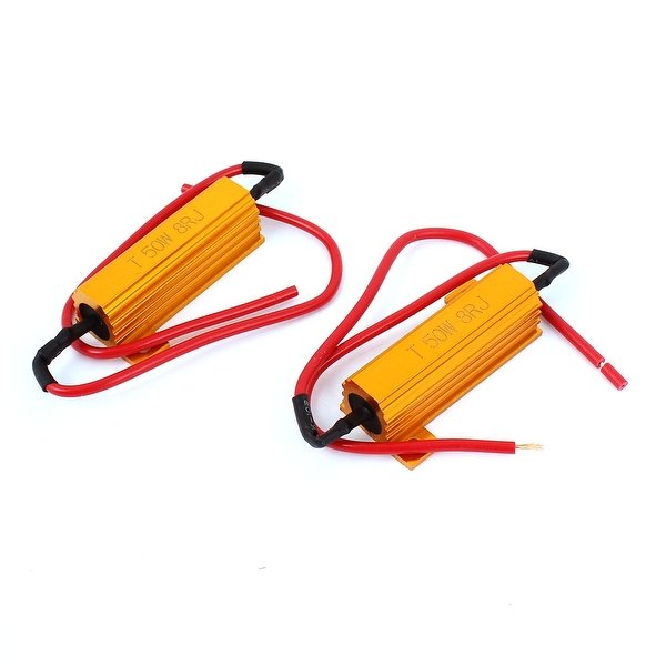

I only have the 3rd brake light wire going to ground on frame through a 6 ohm 50 watt resistor.

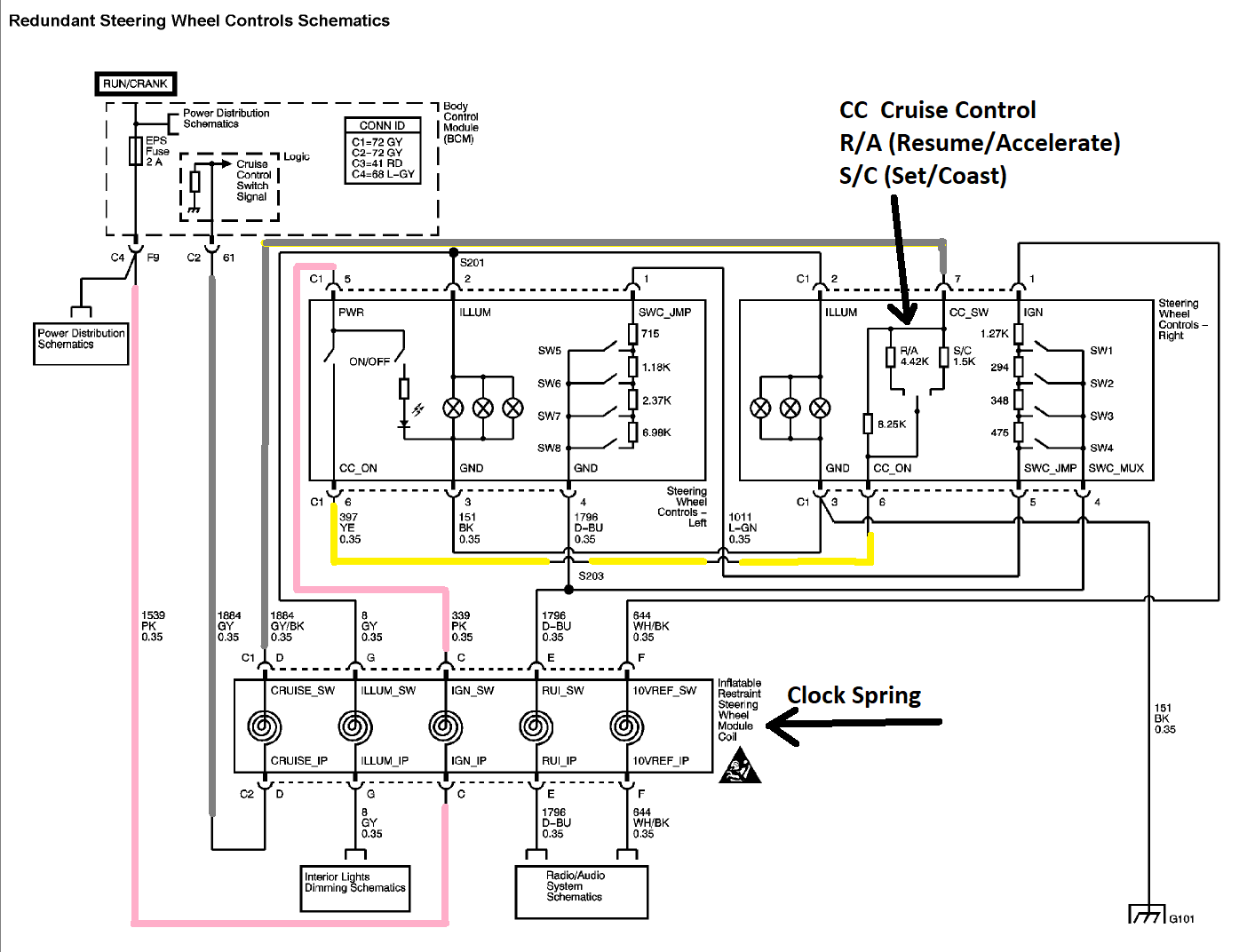

So, looking at the cruise control schematic, it shows a 1.6k ohm resistor in the steering wheel controls dotted line box going to ground on the blk/wh wire. Does that make any sense? I don't think that DF supplies this in the button panel harness. Just wondering if this could have any effect on the circuit. Is it possibly just a safety net to protect the inflatable restraint module in case of a voltage spike? Above my level of intelligence and understanding of electrical.
That 1.6K resistor is there to put a draw on the LED light... which only turns on when the cruise is on.
The dotted line indicates the physical connection to the 2 switches. When the cruise button is pressed, both the LED and the cruise buttons get 12V+.
The "inflatable restraint steering wheel module" in the diagram is kind of misleading.
It is the clock spring wires in the steering column. And yes, the SRS air bag is also in the steering wheel, but so are the cruise buttons, and the radio buttons going thru the clock spring. The SRS system isn't part of the cruise control system.

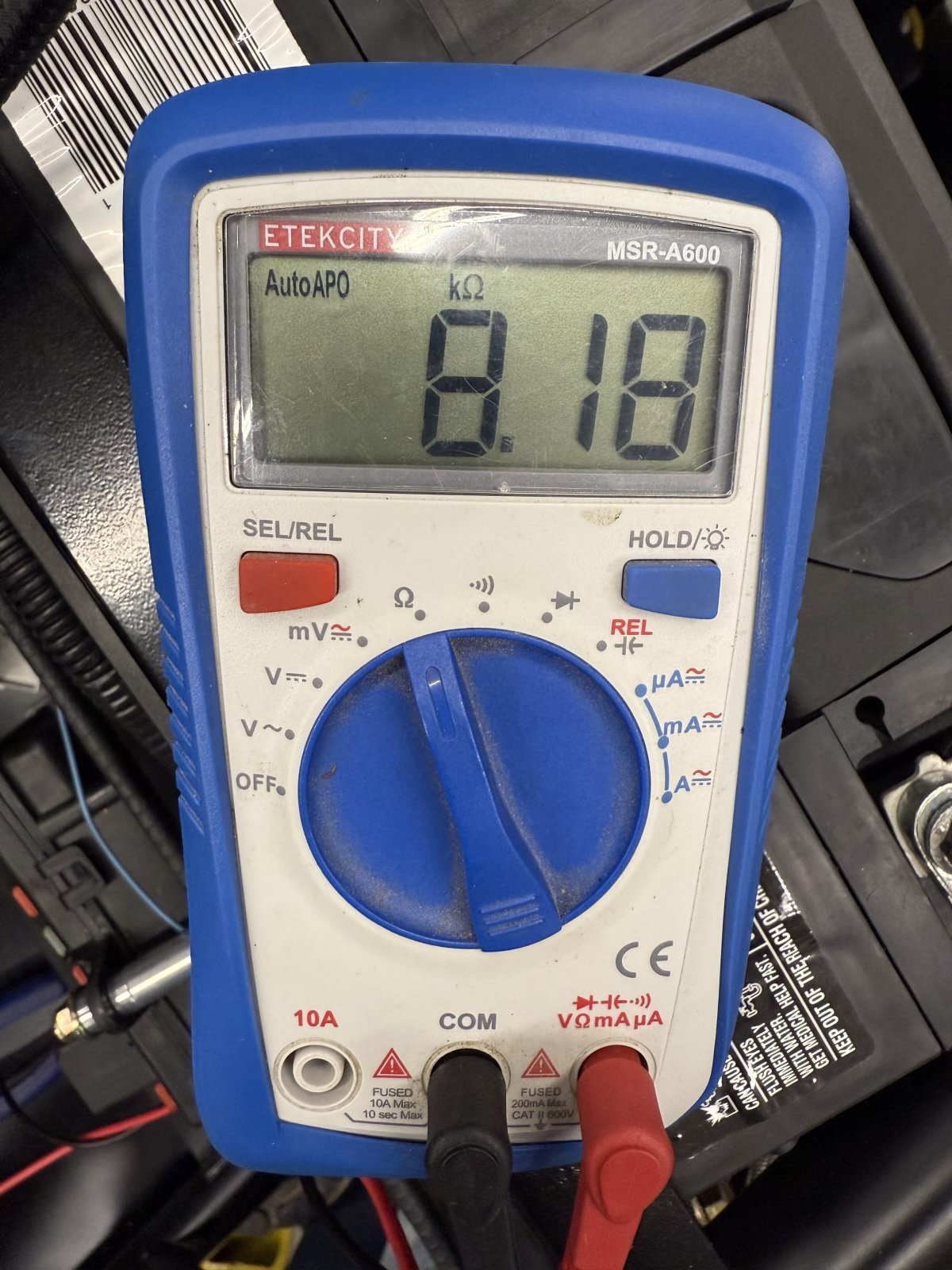

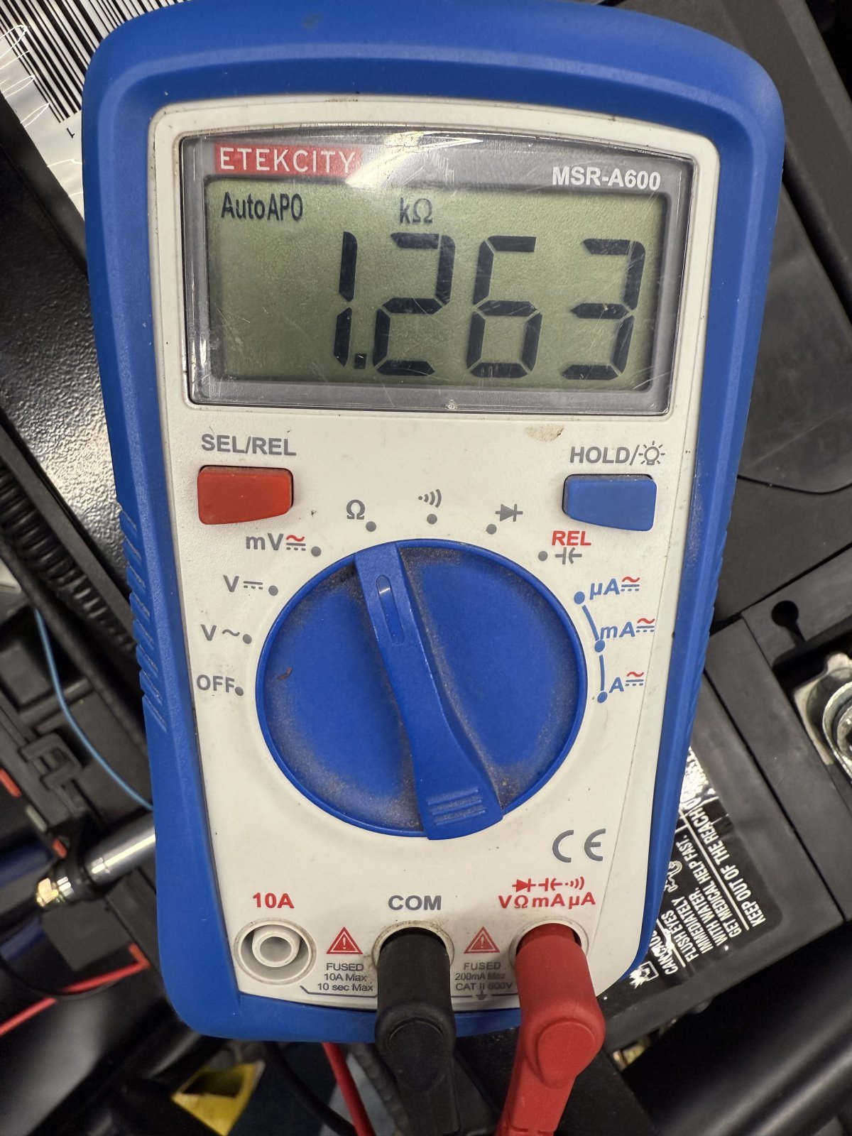

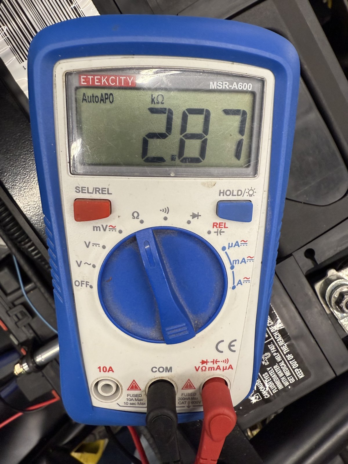

Ok so I removed battery positive and took the connectors off bcm. I received the following readings.
Pink wire (ignition power wire) to the gray wire (cruise function wire)
8,180 with cruise button on, OL with cruise button off.
2,870 with resume button depressed
1,263 with set button depressed
leading me to believe button functions and resistors are correct. Now what happens with everything plugged in and powered up is beyond my understanding but we would assume that it is functioning correctly. Verified ground and correct 12.43 volts on cruise power button is present. I’m wondering if the tune may have cruise disabled. Can I see that in HP tuners?
