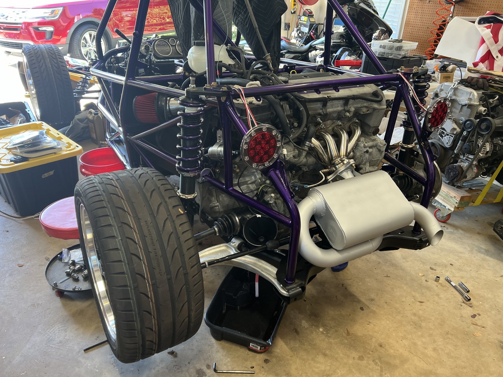

Went ahead and put the intake tube and air filter on so I could get the MAF into position. Also mounted the exhaust so I could plug in the downstream O2 sensor. Not sure if one or both of those systems were the problem, but either way the engine runs beautifully now.
Next up is to finish wiring the two fans up front. I'd like to get the subframe mounted by the end of the weekend.

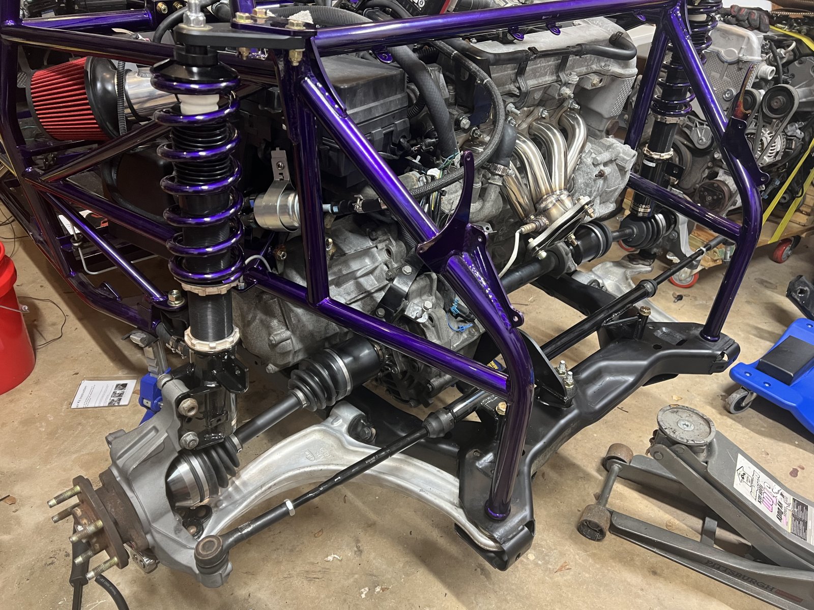

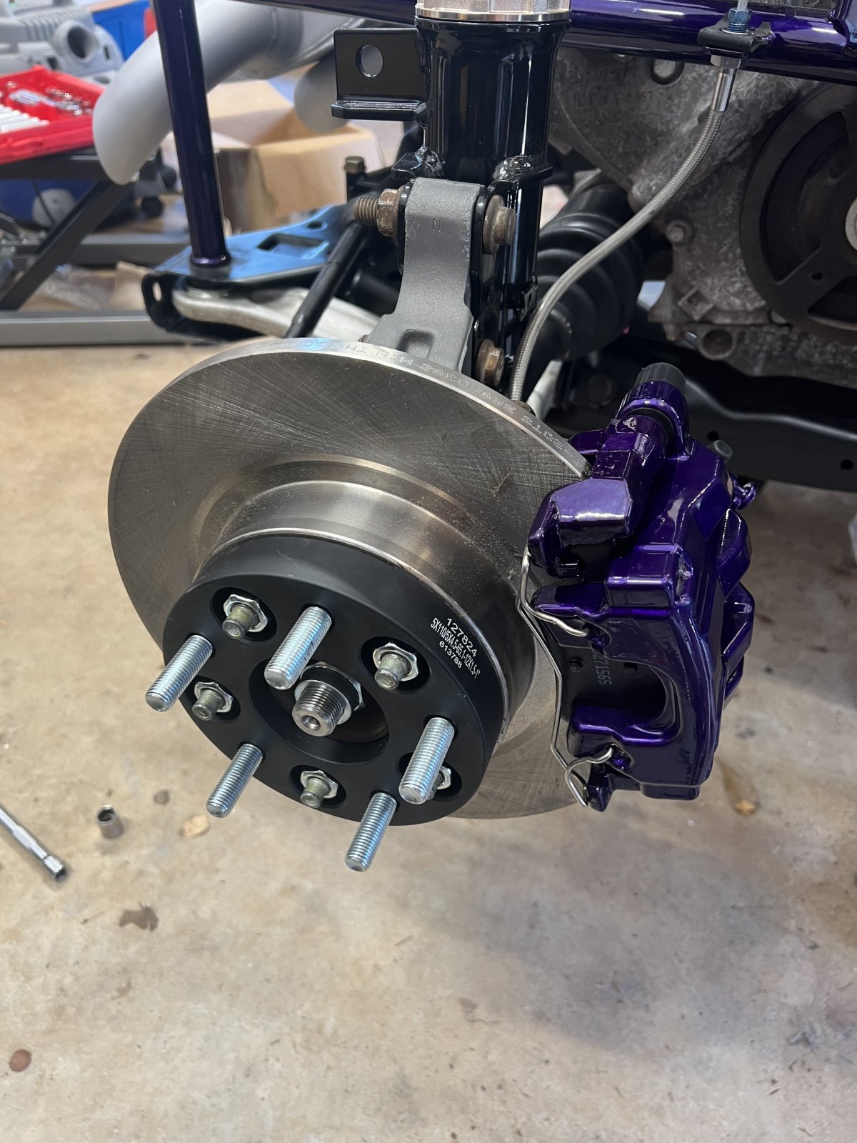

Got the subframe mounted up and started assembling the rear end. These are new axles and new knuckles. I'm debating on replacing the wheel bearings since it'll never be easier than now. These bearings have 124k miles on them.

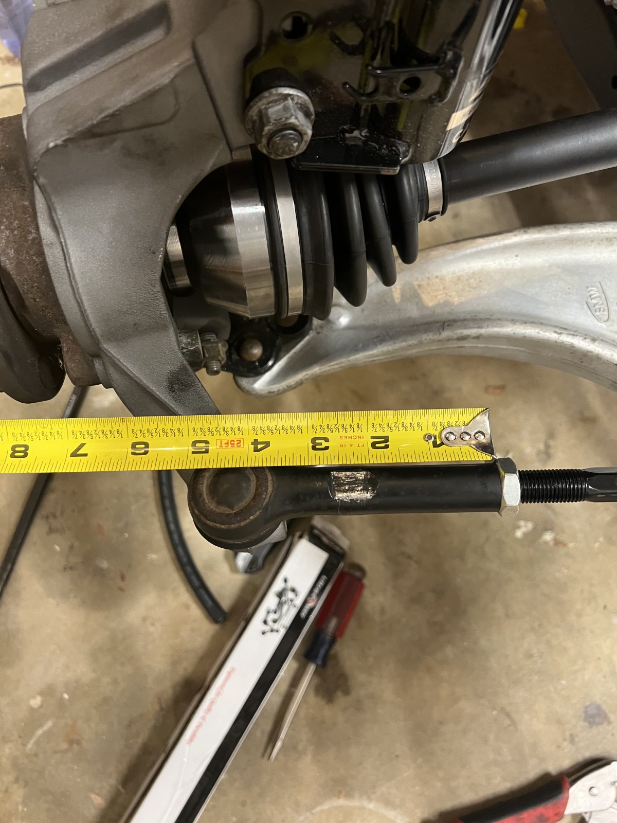

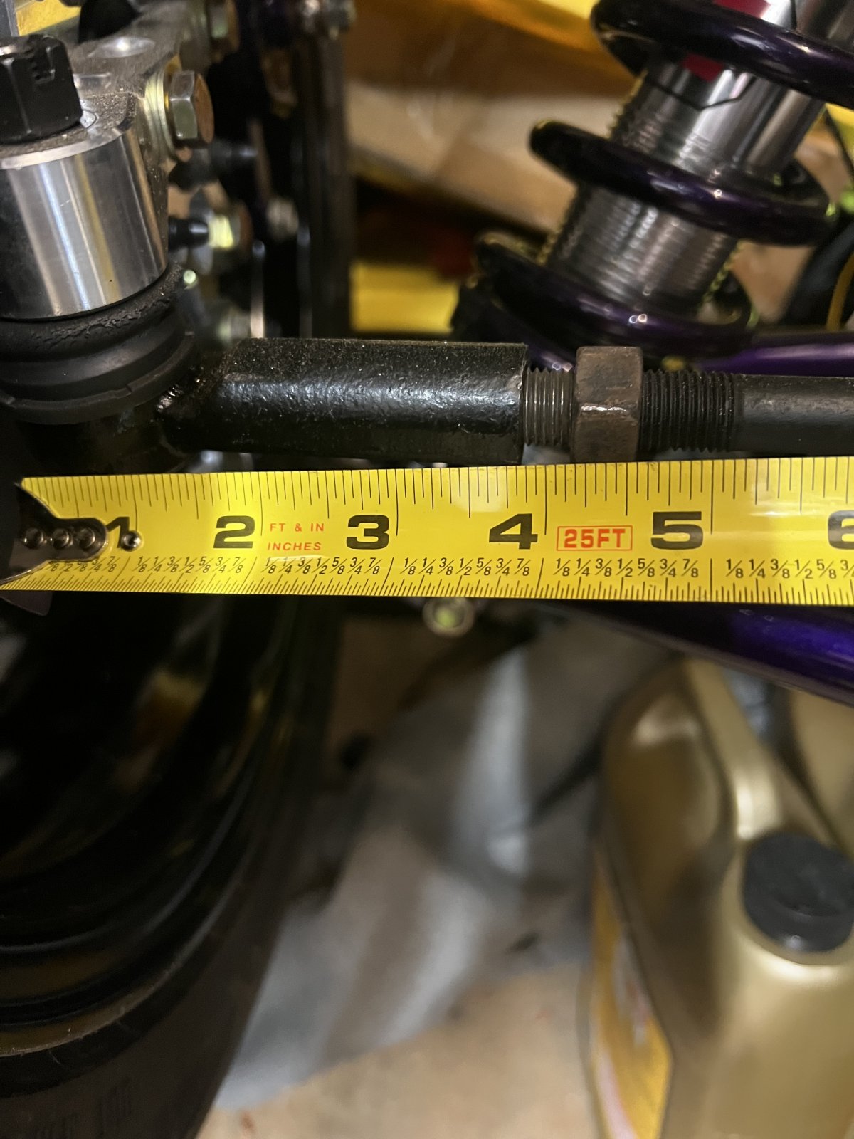

It's taking a lot more effort than I expected to screw these toe link ends onto the DF-supplied rods.
48651
Plus, did you put the stock cobalt outer tie rod ends on the back, then use the Df supplied tie rod ends on the front? rears look long

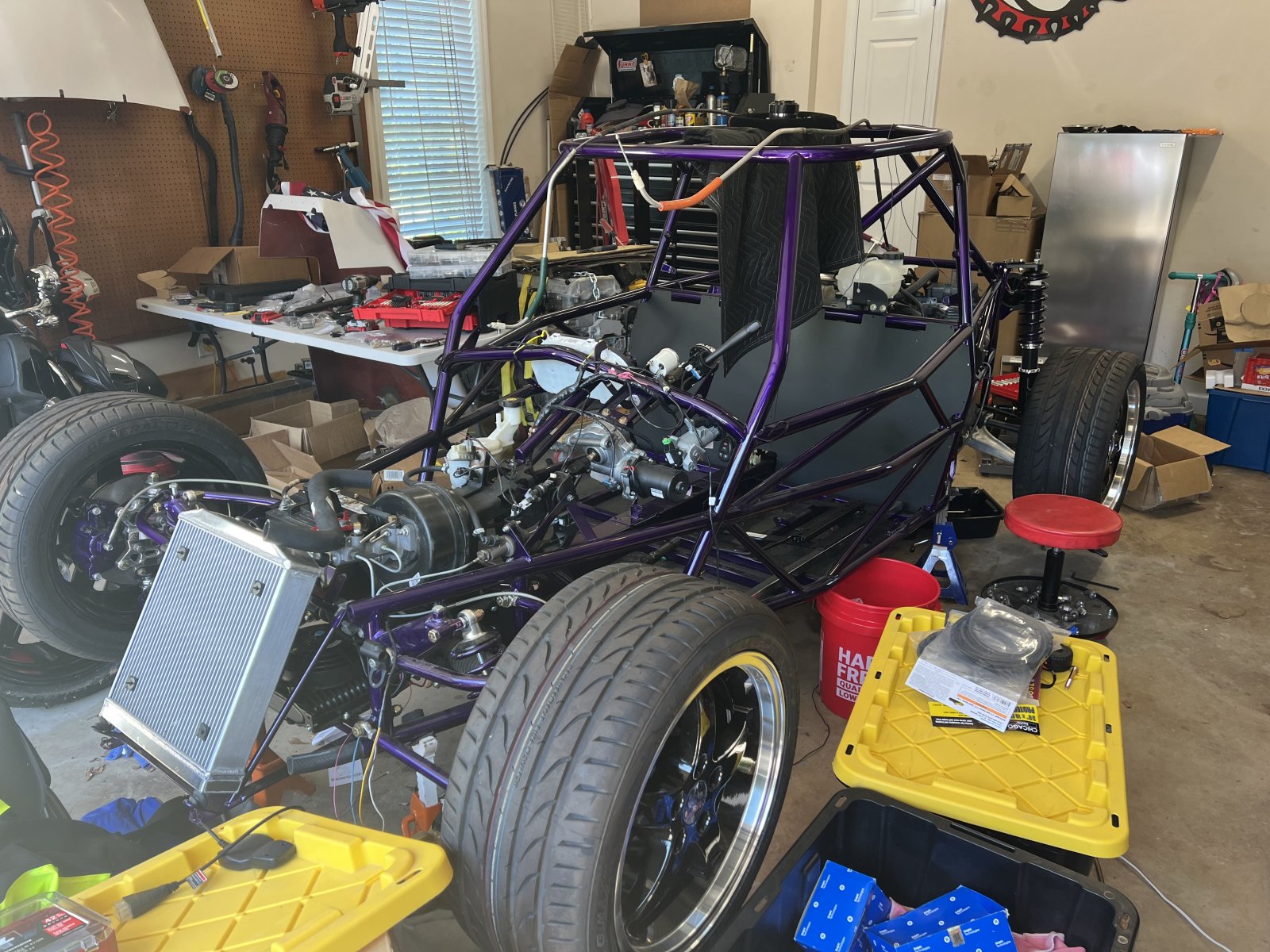

Today I tightened up everything in the rear end. I've been all over town trying to find a m10x1 tap to clean the powder coat out of the left rear caliper. Both the bleeder and brake line holes are gunked up. FYI the thread restorer loaner kit from AutoZone does not come with that size.
Discovered that two of my tires are mounted backwards (I bought them that way) so I'll have to take them somewhere to be remounted.

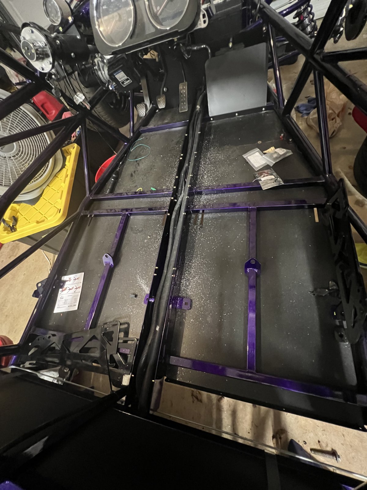

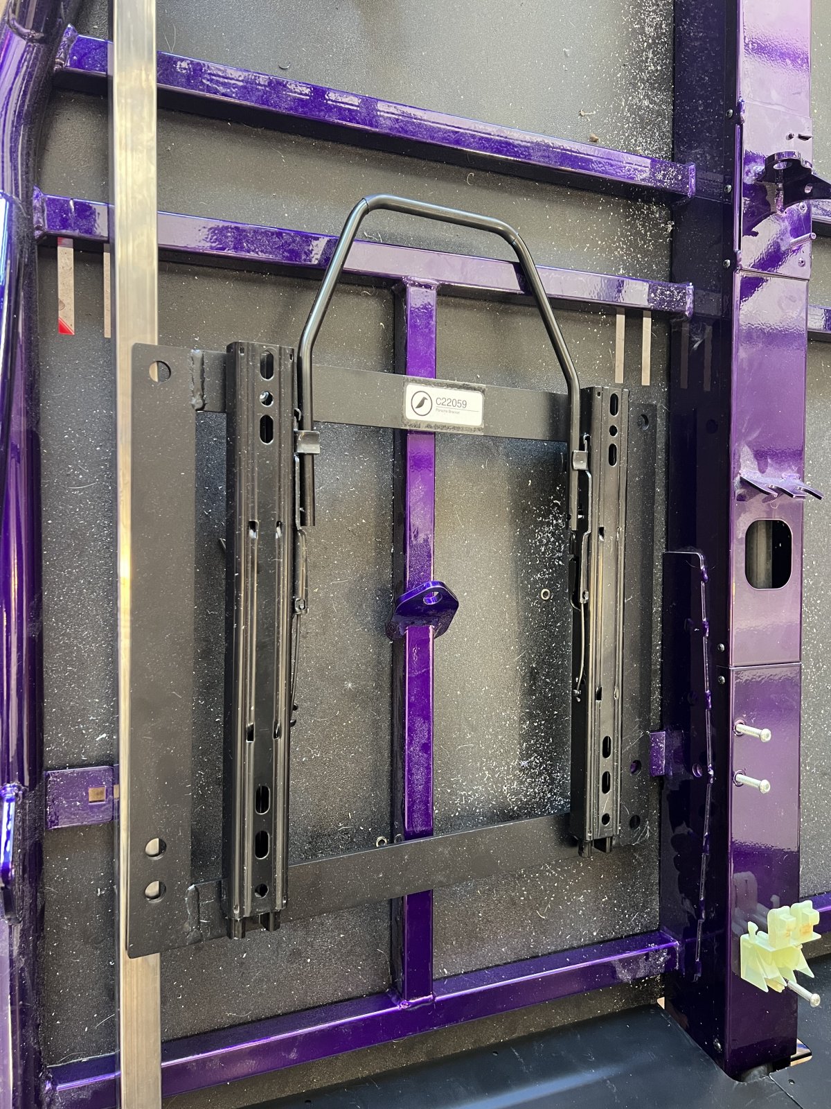

I have two universal corbeau sliders that won't work with the seat mounts from DF. My plan is to cut this 1" square tubing to span the perpendicular tubing on the chassis. I'll drill a hole through both pieces of tubing and the floor. I will use heavy hardware to attach everything. Finally, I'll test fit the seats and mark where the sliders need to attach to the new mount. My concern with this plan is that the seat will be too flat and it'll feel like I'm sitting at a 90° angle in the car. I could built up the front with washers but I worry the angle would get funny when tightening the bolts.
