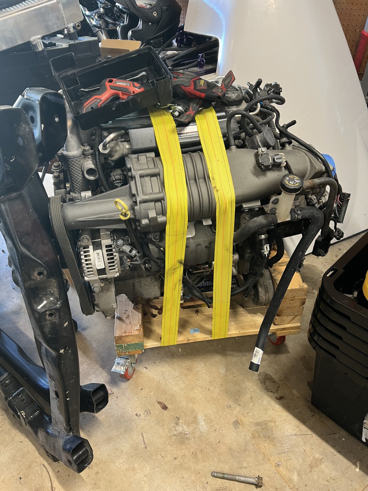

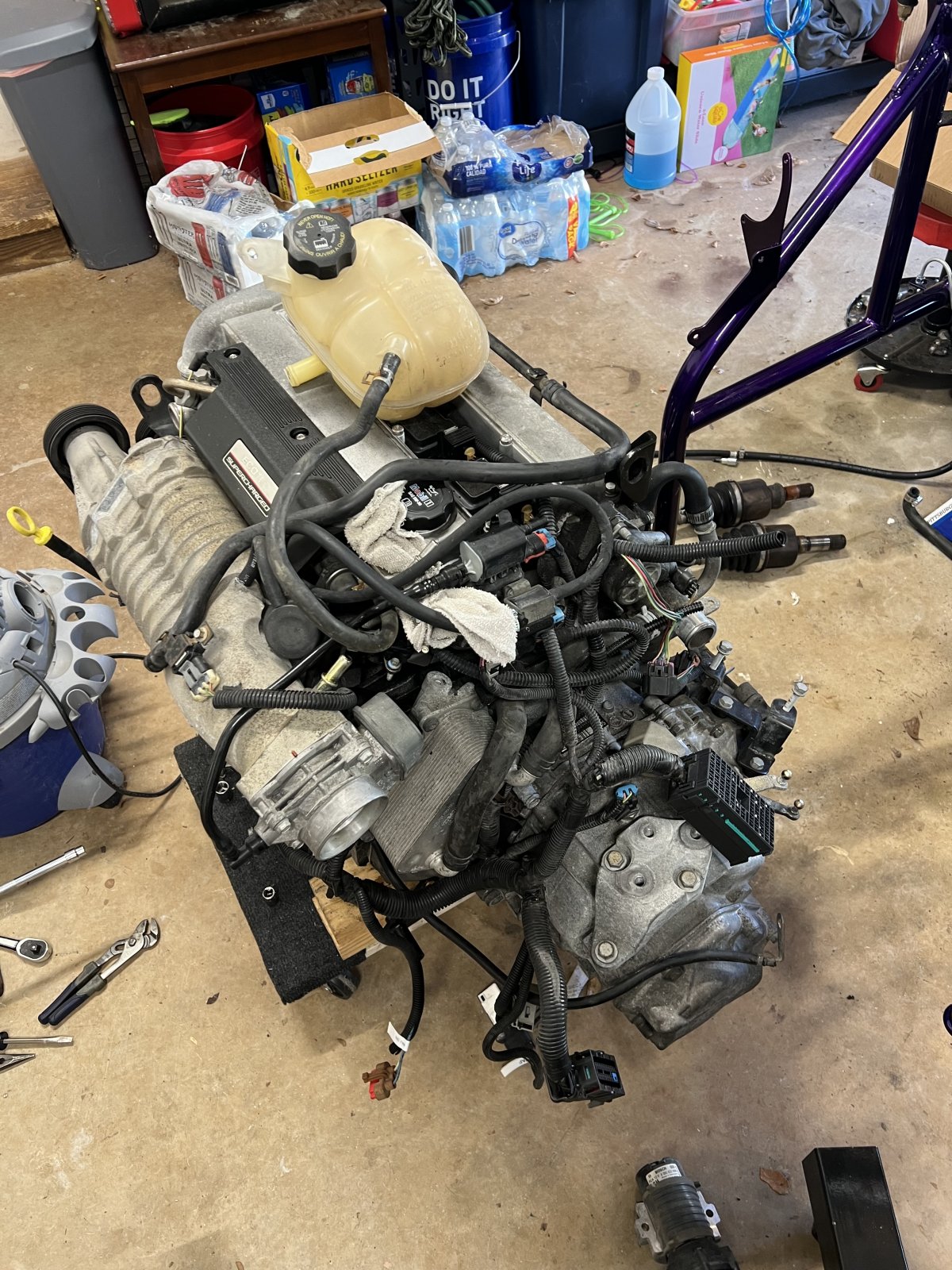

A while back I acquired another complete-ish LSJ. From what I can tell, it has a new water pump, new starter, new alternator, gutted a/c compressor and I'm told it has a new timing set. It's also just a lot prettier and less corroded than my original donor motor. It's missing the intercooler pump and all the associated tubing. I'm not sure of the status of the clutch and the fella I bought it from had never heard it run. Also, someone annoyingly removed the lift points.
My plan was to pull the original motor and swap over all the missing parts (including the clutch) to the new one. Now that I've started that process I'm wondering if that's the best course of action. Seems like a heck of a lot of effort to swap in an engine that I'm not 100% certain is healthy.
I think I'll remount the original engine and keep the prettier one as a backup.

TheAnesthetist
Did you at least compression check/leak down test it?
I haven't done anything other than a visual inspection. I was tempted to swap it in just because it looks better but I think I'll press on with the original motor and push this one into a corner. I can dig into it during the winter but I don't want to get distracted from completing the car.
You're not the first with this dilemma. Stay The Course! ;)
With Engines, pretty don't = runs! More back story or pix of the donor could prove useful! Junkyard rules say in an unwrecked car, Engine disassembled = trans good and the inverse. When the body is crashed so bad it will not drive, the lump is usually ok because it was haulin' butt when it abruptly stopped.(unless it took the brunt of the crash.)
devianteng
Here's what I'd personally do:
1) Compression test as it sits. Take off the belt, pull the plugs, and one cylinder at a time hook up a compression gauge and jump the starter using a battery.
2) Pull the valve cover to inspect the top end, and look at the timing chain tensioner to determine if it's the old style or new. If it's the old style, you'll definitely want to plan to replacing the timing stuff.
3) Use a borescope to look at the top of the pistons to see how they look, through the spark plug holes. The LSJ is an interference engine, meaning if something goes wrong (jumps timing, etc), the piston and valves can kiss and you should be able to see this with a scope.
4) Drain and inspect the oil and oil filter for metal flakes.
5) Pull the oil pan and inspect things like rod caps/bolts, play in the rods, oil squirters, etc.
If all that looks good, then I'd be comfortable enough to pull the trans to inspect the clutch and flywheel. Probably replace the main seals while I was down there. I'd personally be comfortable to put it in the car at that point. IMO, pulling the engine out of the Goblin is super easy with a pair of jack stands, floor jack, furniture dolly and engine hoist. I can probably do it in 30-45 minutes at this point lol.
