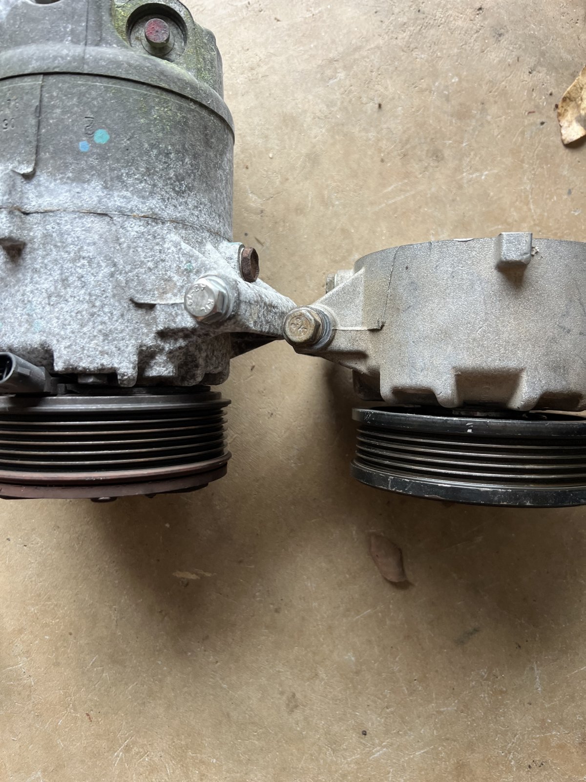

Successful first drive in the neighborhood! The car ran great. The alignment is terrible and did some wacky things under braking. After a couple minutes the 6-ribbed serpentine belt was liberated of one of its ribs. Turns out the gutted AC compressor from my backup motor had a 5 rib pulley. It was a 5 minute job to swap on the correct pulley.

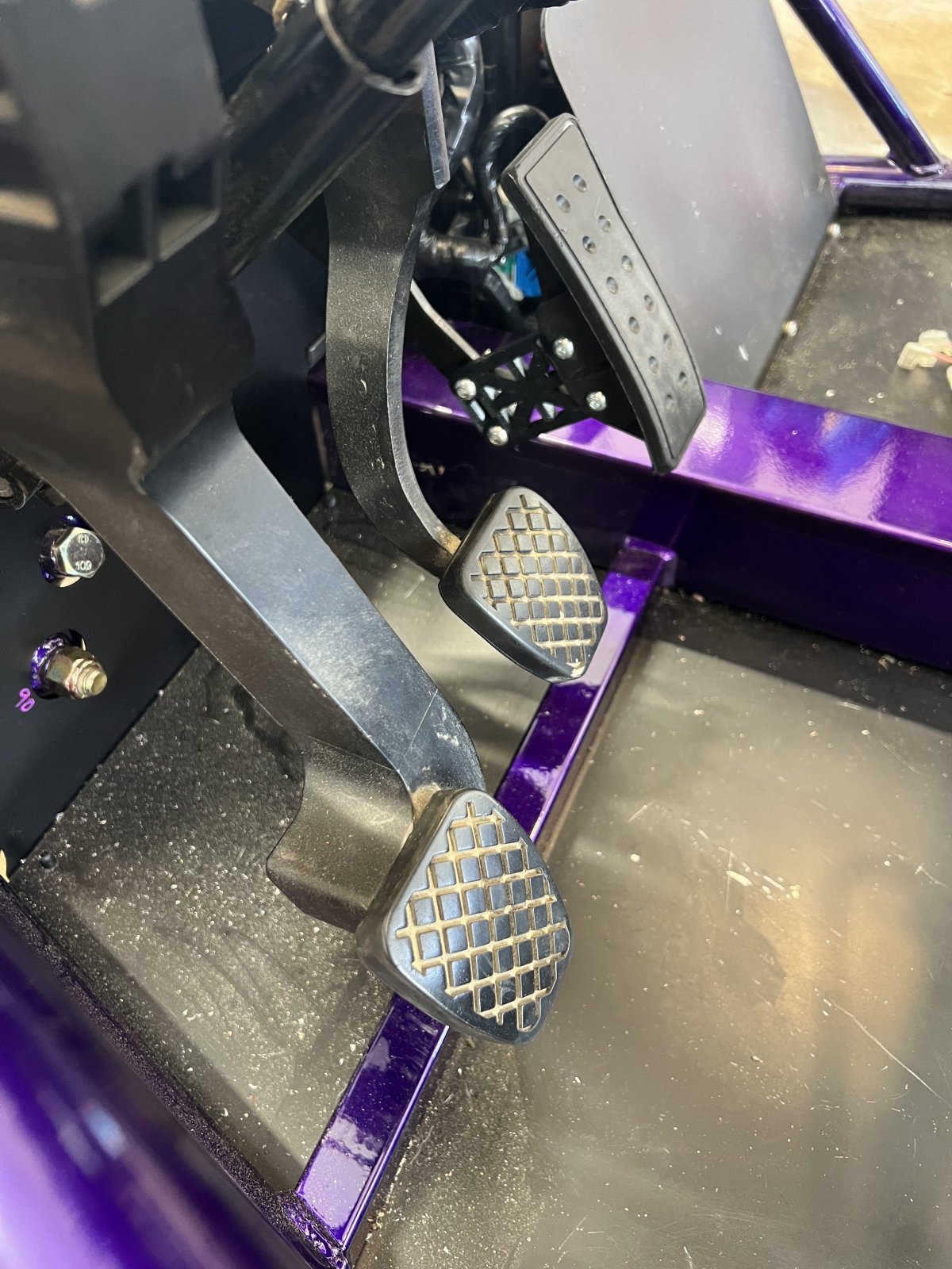

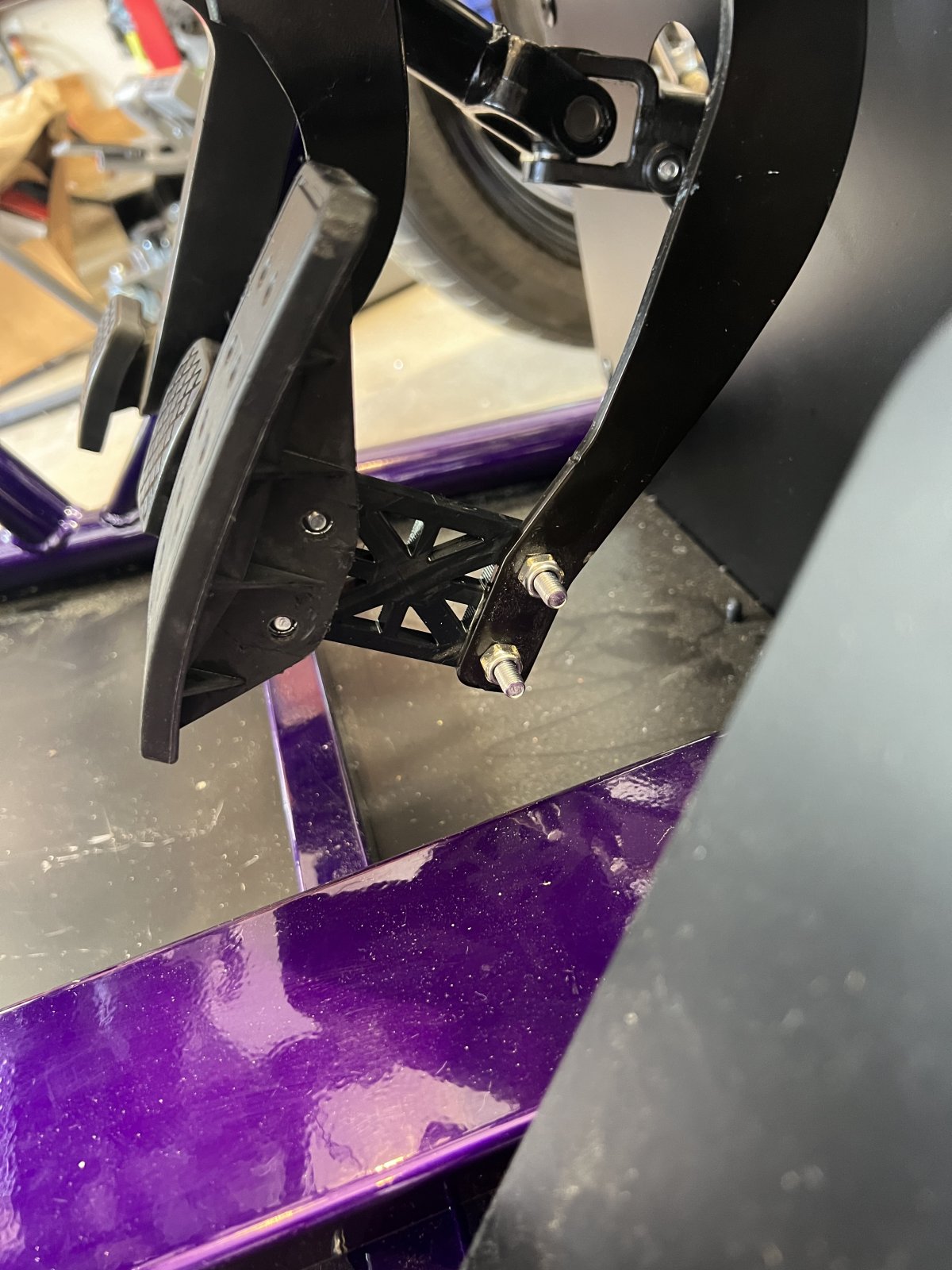

The steering shaft and clutch pedal have a ton of contact when the pedal is depressed. I'll have to see how much more of the pedal can be trimmed without sacrificing rigidity.

Everything is back to normal after swapping to the correct AC pulley and replacing the belt

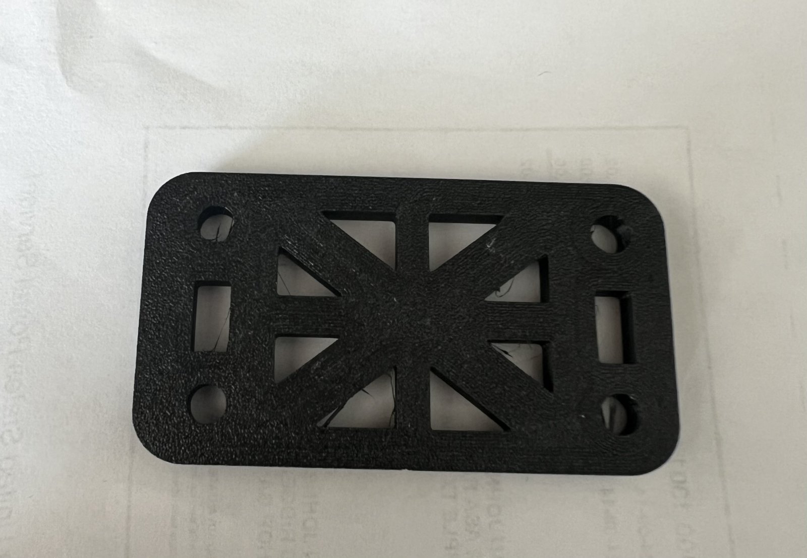

I could be totally wrong or it was someone else that used it maybe. I remembering thinking when it was being discussed that it's not anything more than a flat plate, why would you not make it out of metal.
I've been running one of these since I finished my build in '21. From time to time I think it might be better if it were a little shorter, but my heel-toe downshifts are pretty dialed so I haven't bothered.
Found it :confused:
Mine broke on the arm side and not the pedal side. I think it was lateral stress from a lot of romping that made the plastic fail. I figured it would take quite a bit to affect a 1/4" piece of steel so I used it and wondered why I printed one out of plastic to begin with.
2 1/4". If I end up making one in metal, I'll go shorter. This spacer makes heel/toe shifting challenging
The 3D printed one puts the pedal pretty much even with the brake pedal, so going a little shorter is probably preferred. As stated above, I was the one who broke mine and when I made one out of bar stock I drilled the holes a little further in from the end to shorten it up a little.
