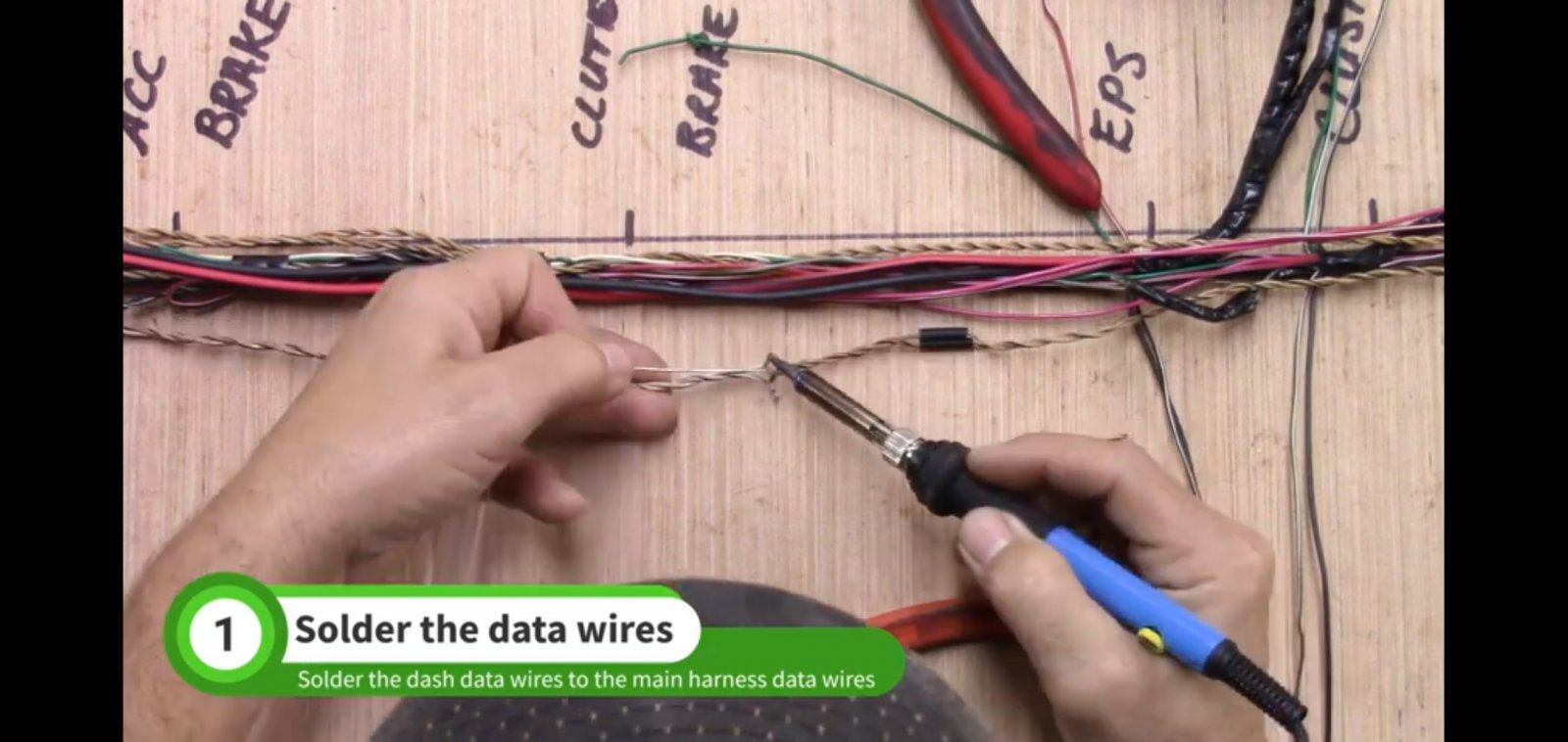

V1 Dash harness data wires
KD0AXS
Active Member
K
These data wires (tan and tan/black stripe) come from the BCM into the dash harness. Since I don't have the performance display option, do these get routed into the main harness and get connected to the data wires coming from the fuse box that were extended earlier? They're also tan and tan/black stripe. Just want to make sure before I go and connect something wrong.
K
Perfect, thanks! Looks like they go from the BCM to the PCM, so they do get connected where I thought. It just wasn't real clear in the video.
