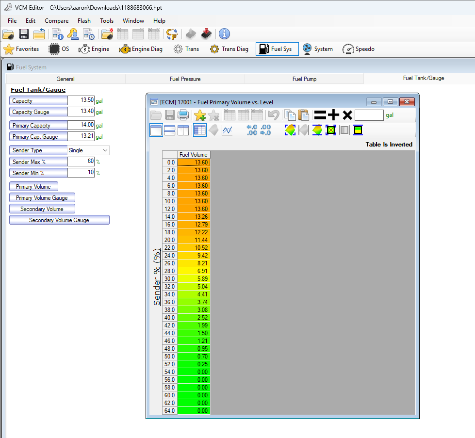

Is there a way to modify the fuel range on the instrument cluster with an HP Tuner?
It's full and says 384 miles until empty, which I know is nowhere near correct, considering the tank is nowhere near it's OEM size, that it thinks it is anymore...
How can you edit the file to add in the Fuel tank/gauge section? I don't see it in my base tune file.I'm looking at a few hptuners files, and some OSs appear to have these tables defined, and others don't.
Can you post your file? If it's not defined in yours, I can *probably* get it added and modify it for you if needed.

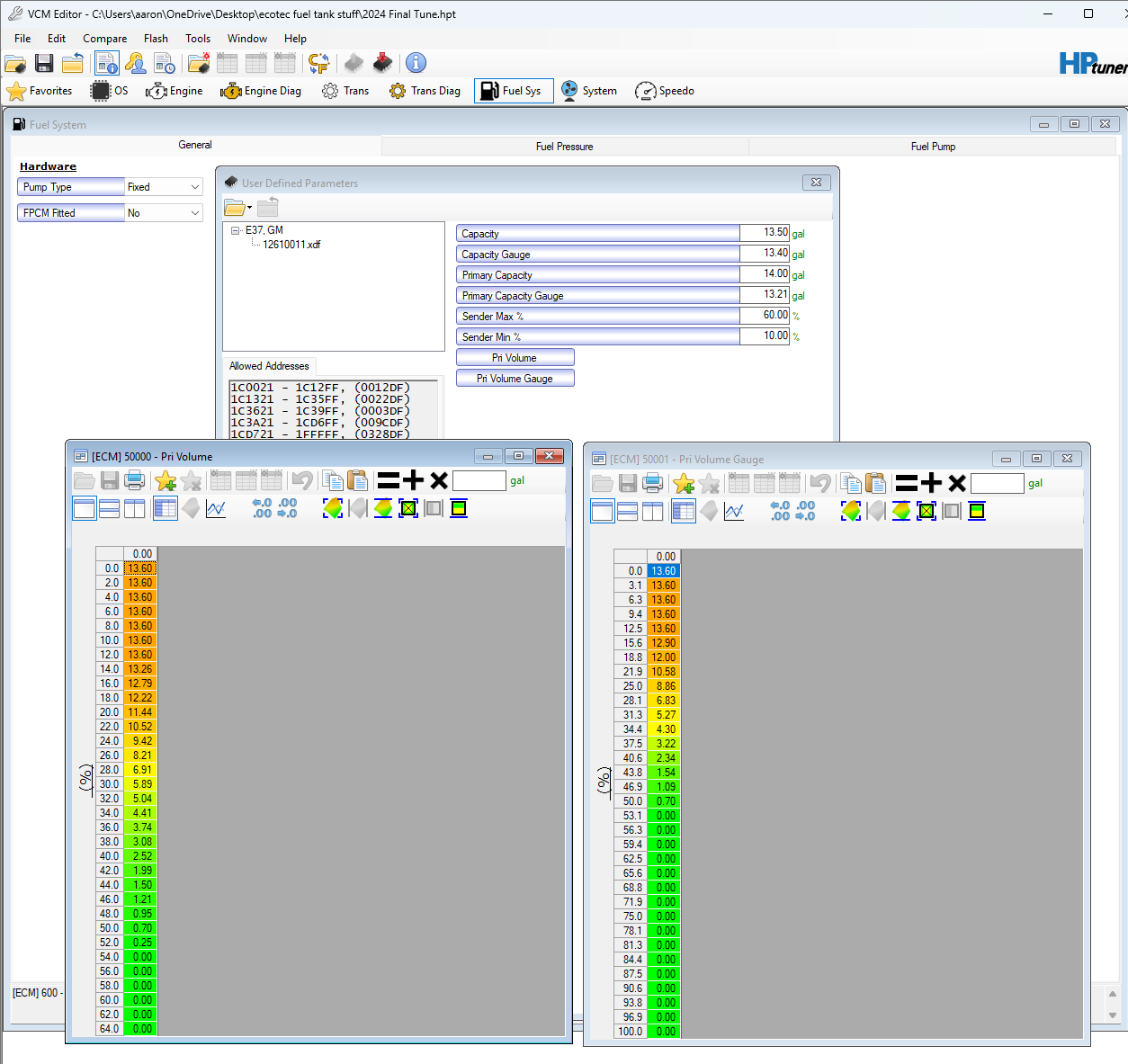

Yeah, user defined parameters. Lets you create your own definitions (xdf format) and basically edit anything in the calibration block(s) that aren't defined by HPT. Kind of a workaround to asking support to add stuff, if you know how to find tables etc. Unfortunately it's a paid feature and linked to my MPVI, so only I or other UDP enabled devices can bring up this function to make the edits.How can you edit the file to add in the Fuel tank/gauge section? I don't see it in my base tune file.
Oh, that's very cool! I've been playing with HP Tuners and had no idea about user defined parameters before. Could you reshare the file with the edited table in it?
It looks like I've got a 10 gallon tank, could you use the same the ratio that you have for the sender % and scale it down to the 10 gal capacity instead of the 13.5 capacity that I see in the screenshots?If you have some ballpark figures you want to fill in, let me know and I'll do it and post the file here.
