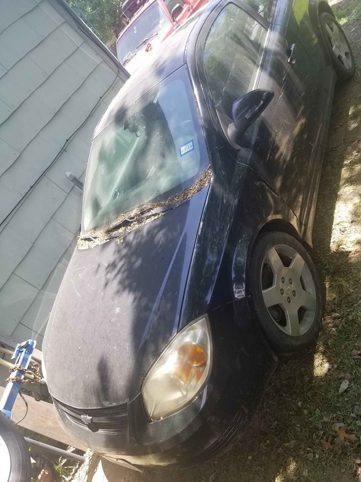

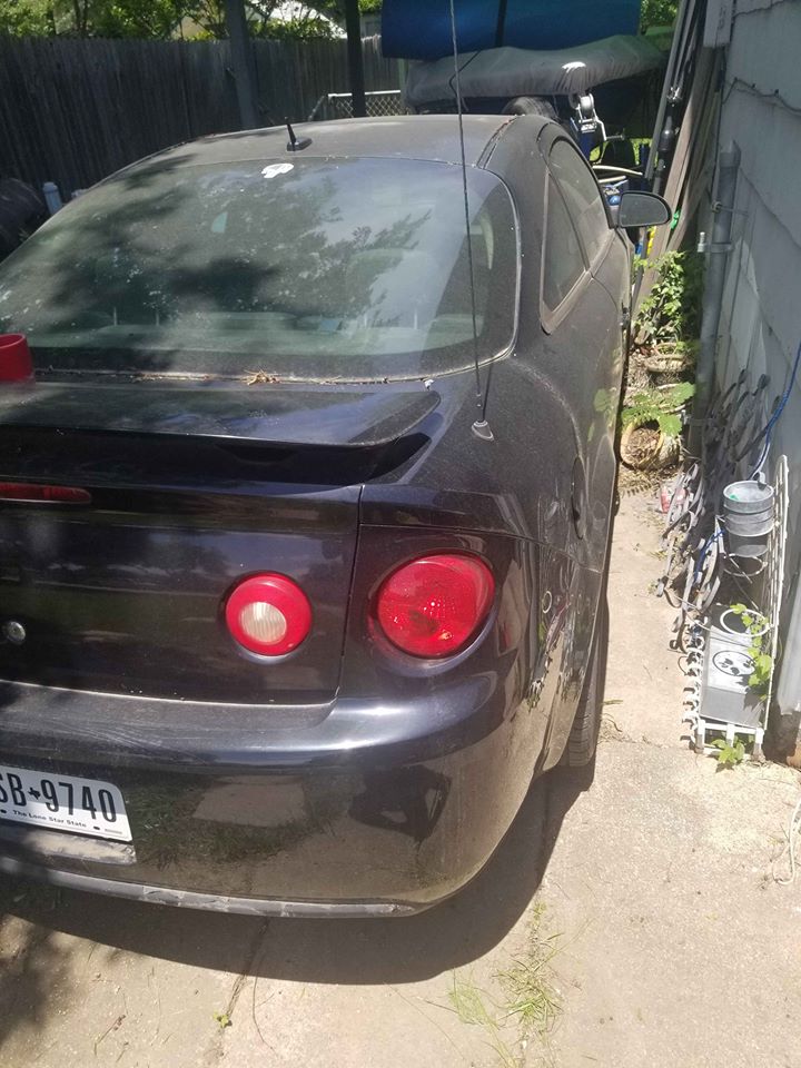

I found a possible donor on Facebook Marketplace that SEEMS to be a steal. I am hoping for a little guidance from the goblin gods.
This car has transmission issues. The owner states that the car will move on its own, but not far. He cites transmission issues.
Are all cobalt transmissions compatible? Could I swap a base model auto or manual tranny in or is it incompatible? I looked online and it looks like it will work, but I wanted to be sure.
I wish I could begin with a car that runs and drives and I was just going to start with a base model, but this seems like a pretty decent deal.
103,000 miles and a salvage title. Interior looks good
He is asking $1000. Is it worth $1000?

I'd say that's an OKAY deal not great. I paid 2000 for my first 07 SS/SC with 79k miles and 1500$ for my second SS/TC with 102k miles but rolled.
I think you will need a different flywheel and possibly other things too to make it work. New F35 is going to run you around 750$ non LSD or 1500+ for LSD.
At worst use that car and you can buy a new F23 for around 450$ DF was even selling them might still be.

Depending upon how deep your pockets are should be your guide to making a risk buy. Faulty transmission should make you question the condition of the engine. Does it start and run? Are any fluids on the ground under the car? What does the engine oil look and smell like? How much rust is visible on the car, especially on bolts and suspension components? From the photos it looks like this o e has been sitting for a while neglected. If a car is worth buying as a donor it should driving, preferably daily. Unless you have deep pockets and a big budget. :rolleyes:

Very good points. I would probably be stuck shelling out more than I want to for a suitable transmission in addition to anything else wrong with the car. I certainly do not have deep pockets. By the way things are looking now, I'll have the cheapest goblin on earth!

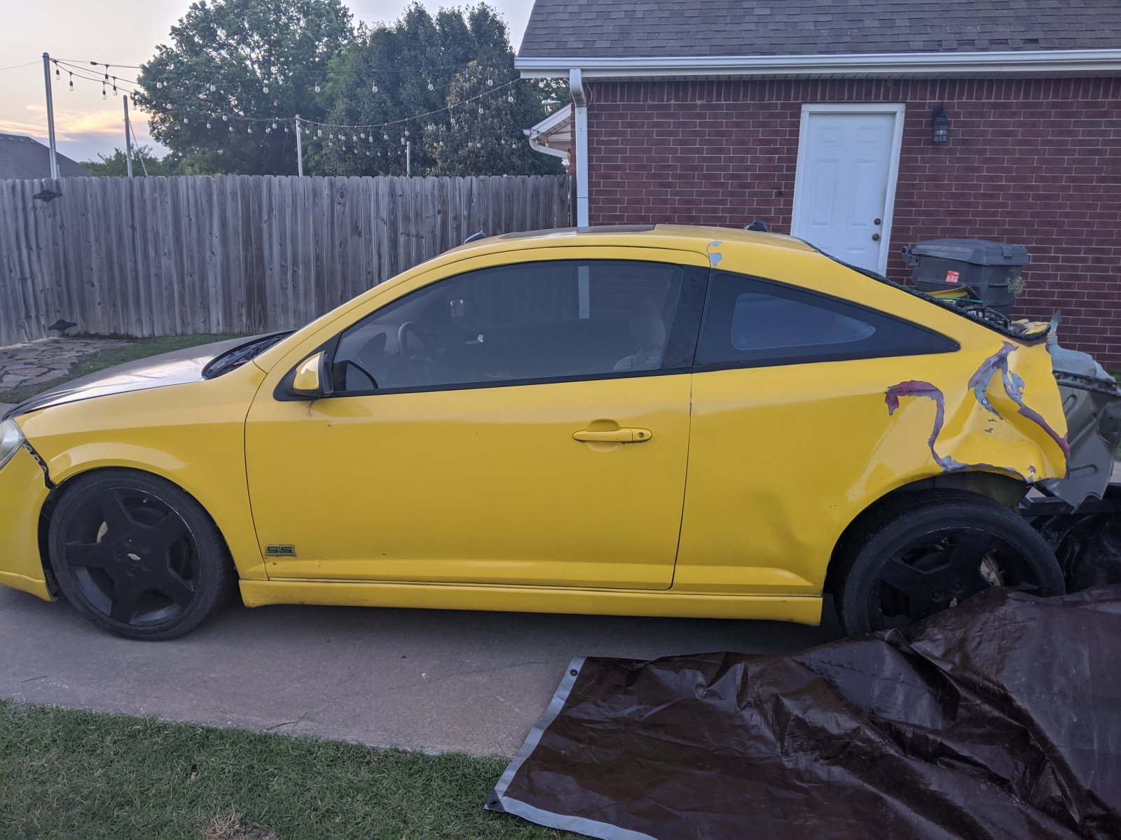

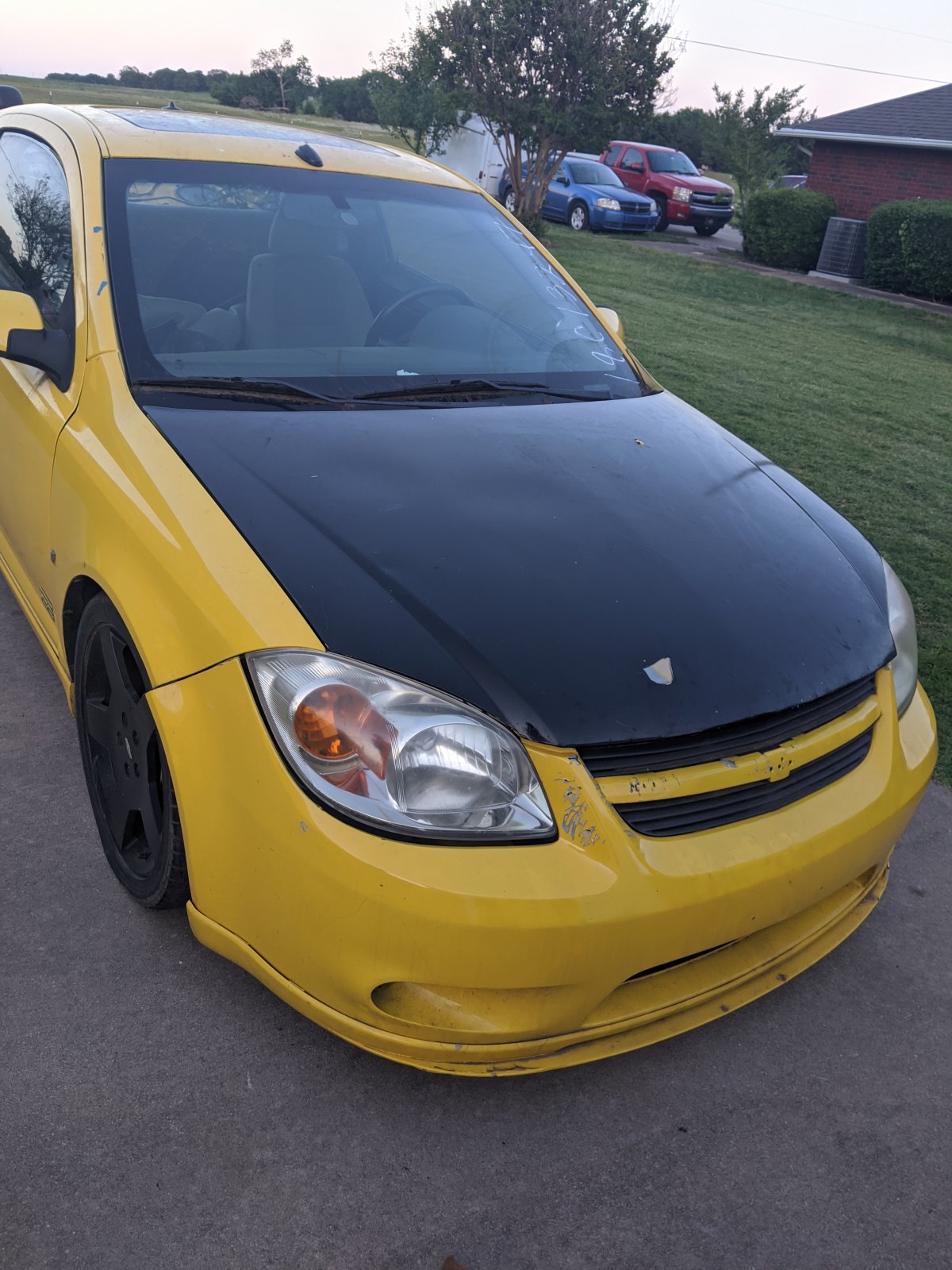

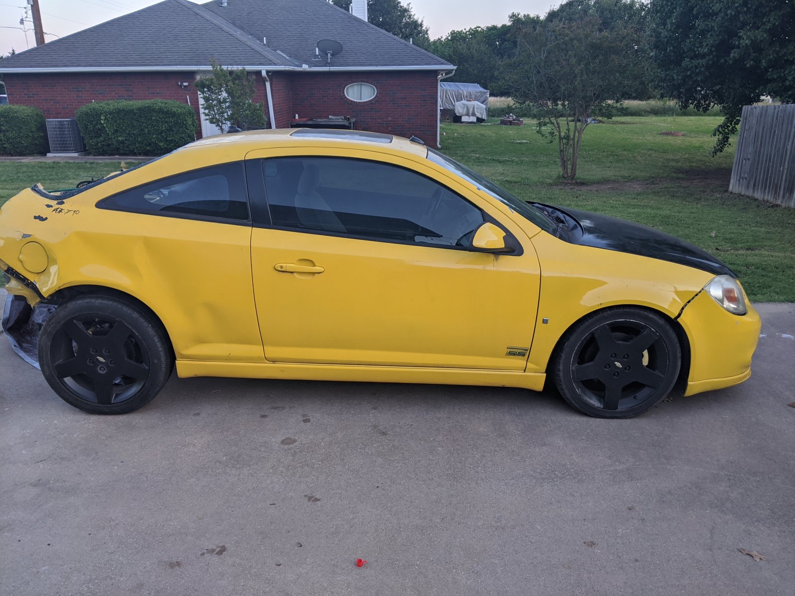

Splurged and bought my donor today! 2005 Cobalt SS S/C
It runs, drives and shifts, at least! Engine sounds good even when revved and there is no timing chain rattle, although I do have an idle surge and code P0315, which I am researching now. It does not seem like a huge deal so far.
Could not find any leaks.
I paid only $700 for it. Signed salvage title.

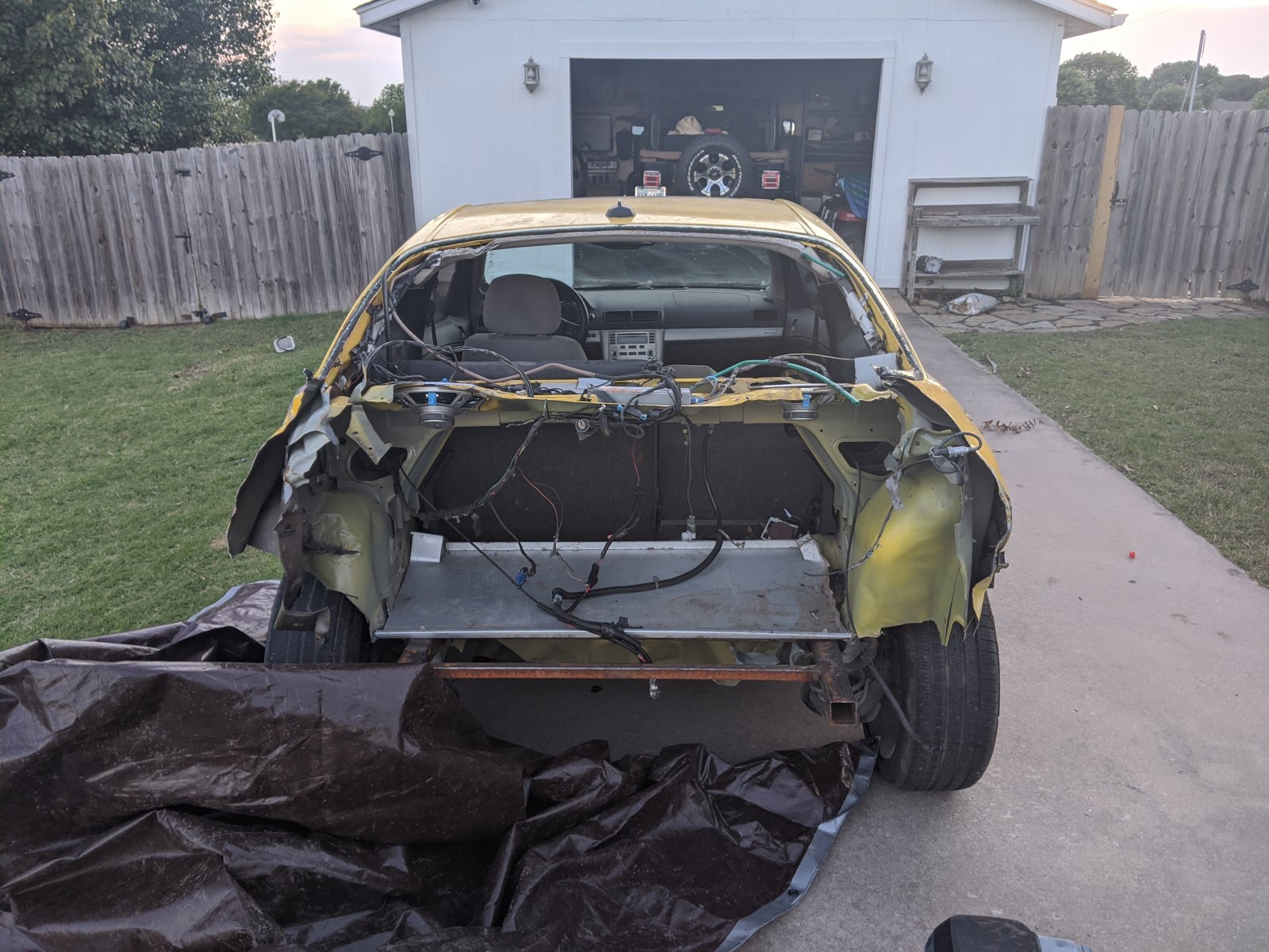

Cover your children's eyes before seeing the rear!
Rear suspension looks good, but it seems the previous owner did a battery relocation? The battery terminals are the cables hanging down in the rear.
I suppose it is a little late now, but was it a decent buy in your honest opinion?

Miles are too high! 200k
I don't believe it has the G85 package unless they took the recaros and replaced them.
I would not buy a base model cobalt with this many miles, but it sounds good and I've read that the lsj 2.0 is a little more robust than the 2.2.
I mean, you're probably going to get a few surprises in the process, but you can't argue with $700. I do have to wonder, what the seller was doing to that poor Cobalt, though.... looks like he cut the ass off of it.
Dakota8800
Yup! I think he got inspiration from an el camino? I'm not sure.
Rear suspension and axles look good, but it seems the previous owner did a battery relocation? The battery terminals are the cables hanging down in the rear.

Oh wow! Looks like something from my childhood at the county fair demolition derby.
Cobalt battery was always in the trunk.
Rear suspension does not get used on the Goblin.
