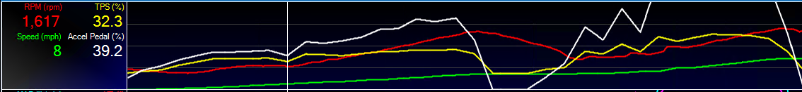

I checked the logging data and the ARF is spot on, my VE tuning is still very good. LTFT were at 0.8! And the STFT were always correcting up and down as they should be.
You can see here the White is the pedal and the red is the RPM. There is a dip here and a bad bounce in my foot to the right. The RPM never really moved.

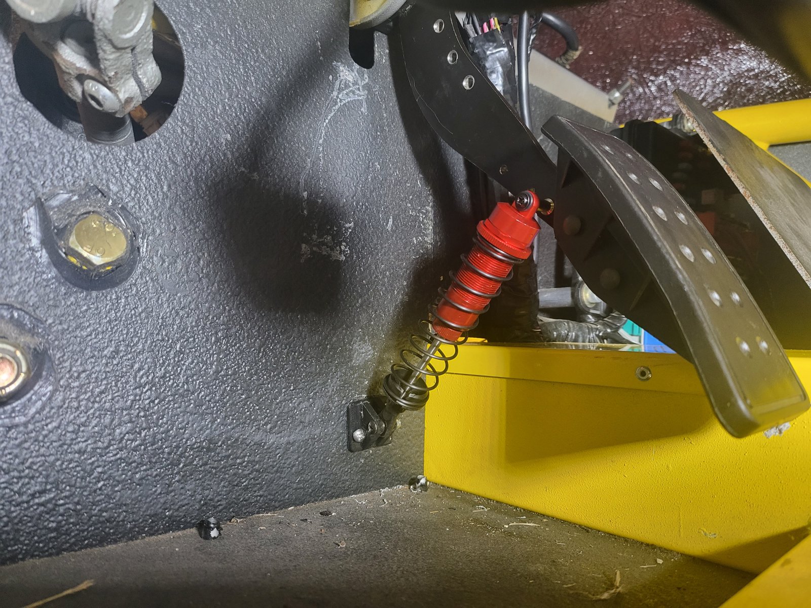

I was going to post about the throttle bounce issue (which I have really bad!). I figured since it's a physical problem (your foot actually bounces) I would fix it with a physical solution. I put a damper on the throttle pedal. And it works (mostly).
I bought a 1/8 scale RC car shock absorber off of amazon for $20 for a pair. Filled with 1200 cSt oil. It fixed my throttle bounce about 70%. It still happens in some situations, but it's rare. No issues with hanging throttle or anything like that. I think with slightly thicker oil, I may be able to get rid of my throttle bounce completely.
