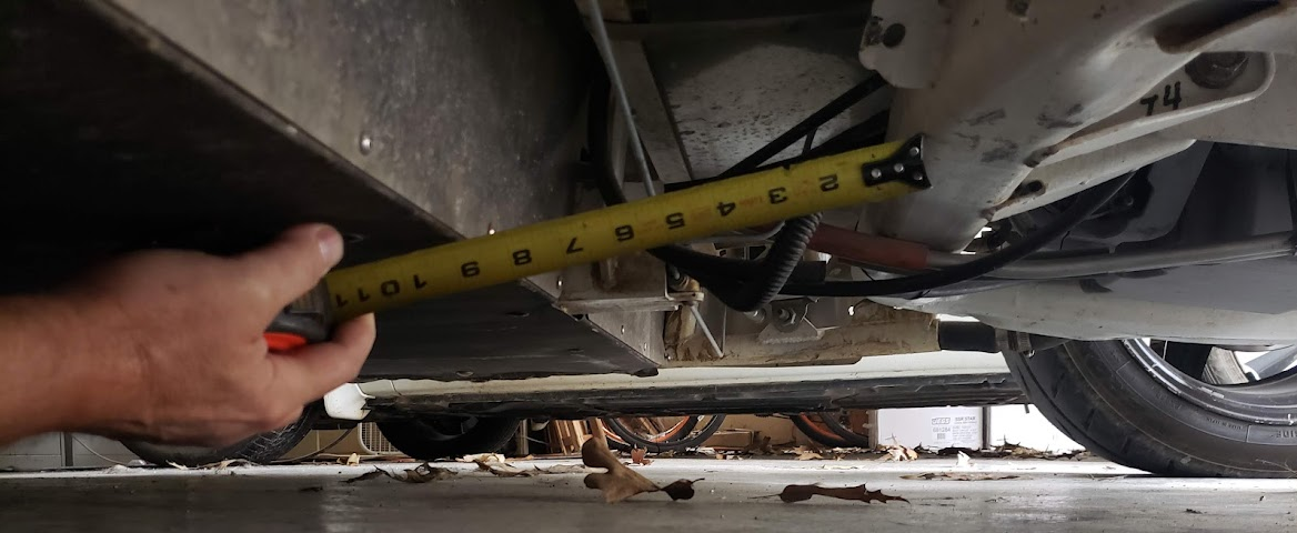

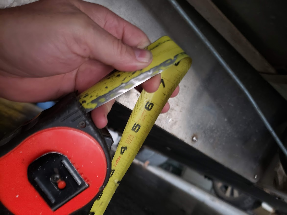

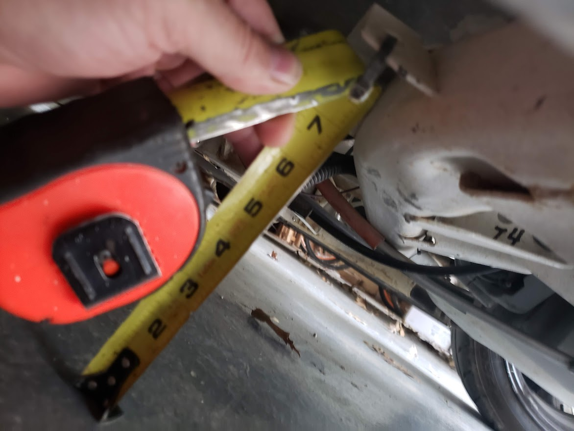

The front of the subframe is up higher than the floor pan. Is this the measurement you want?
The subframe is almost 9" away from the floor pan.
28066
The floor pan is 5.375" off the floor,
28064
The frame is about 6.75" off the floor.
28065
So that would put the floor pan at 1.375" lower than the bottom of the subframe... at the rear firewall in the Goblin.

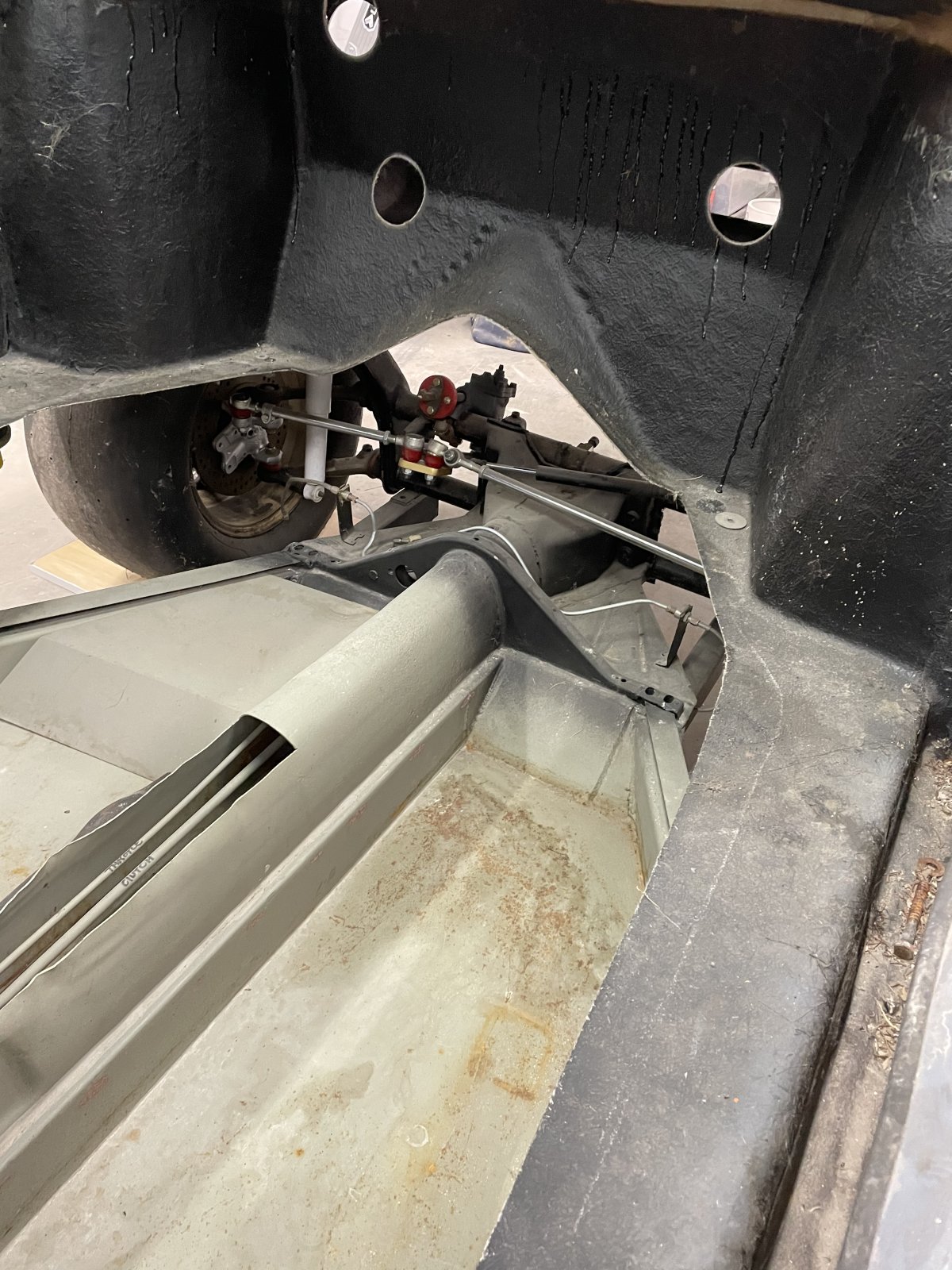

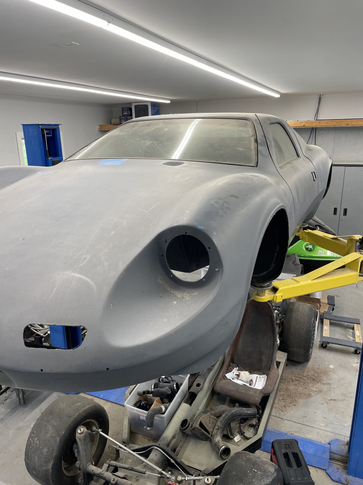

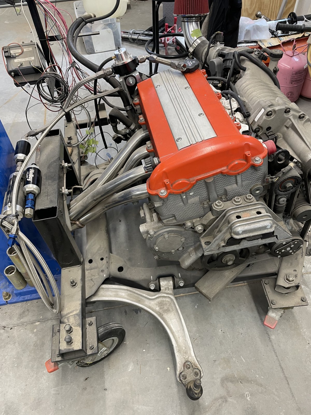

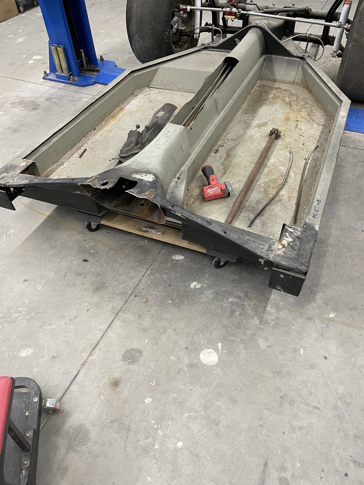

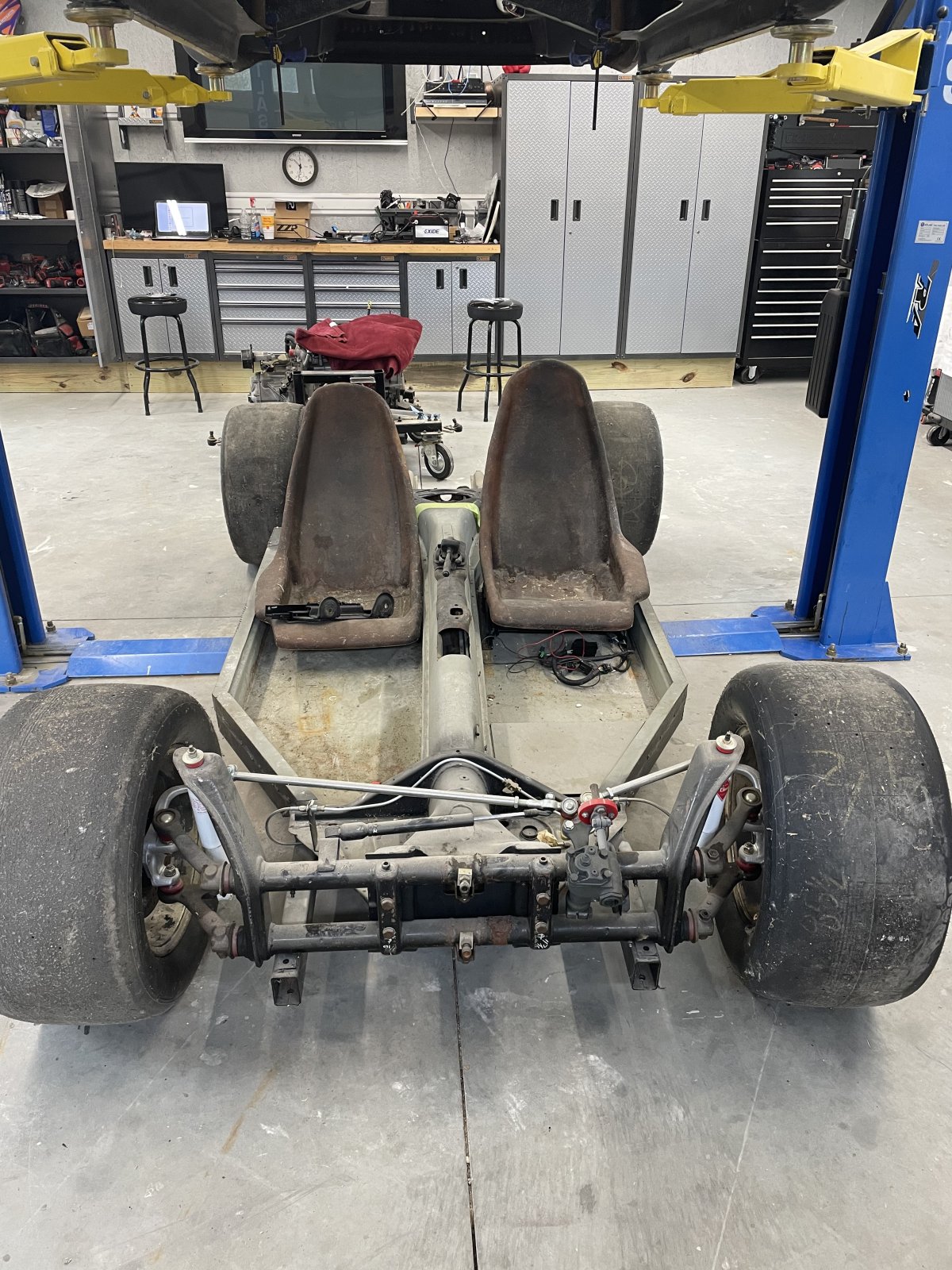

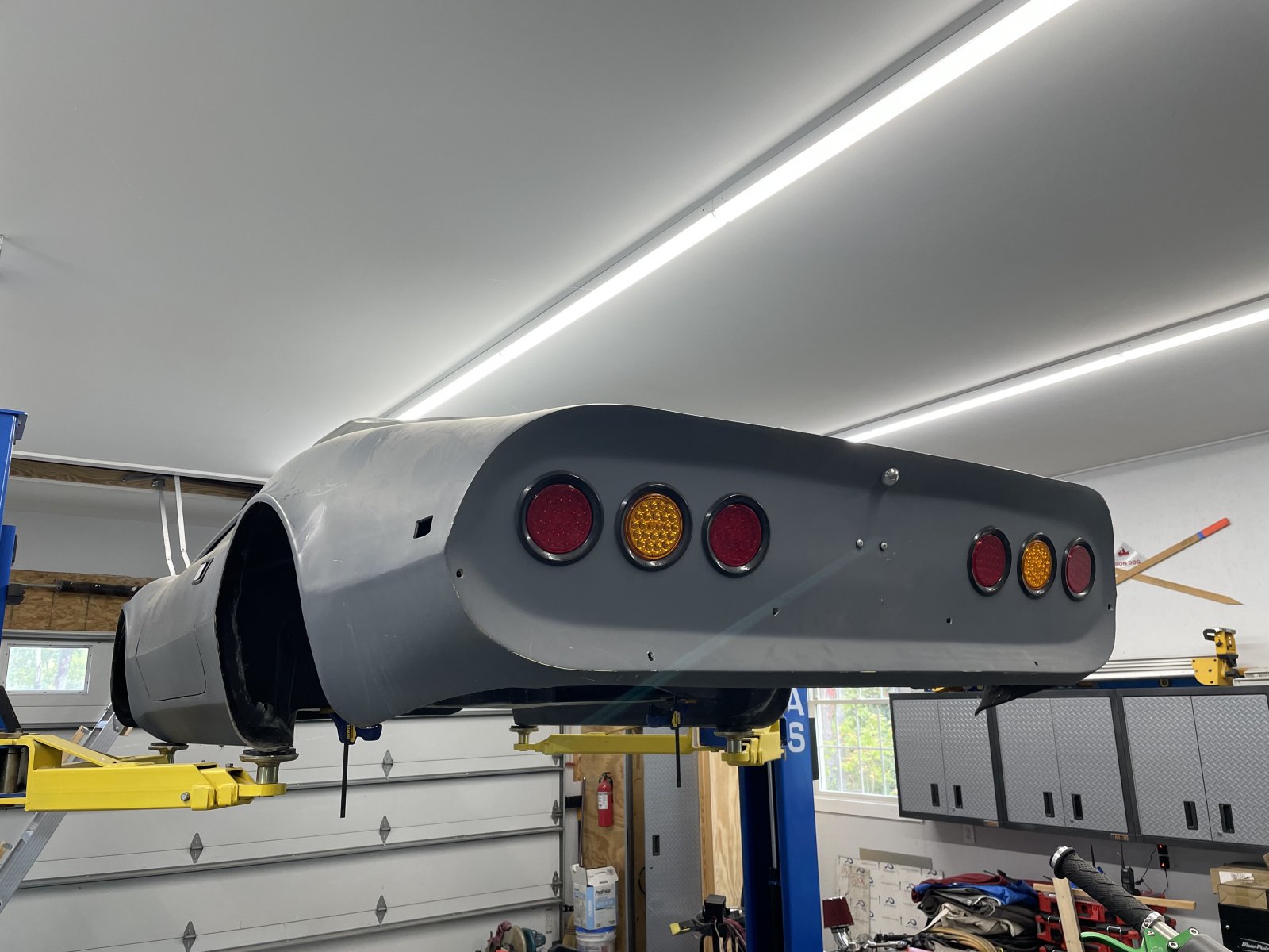

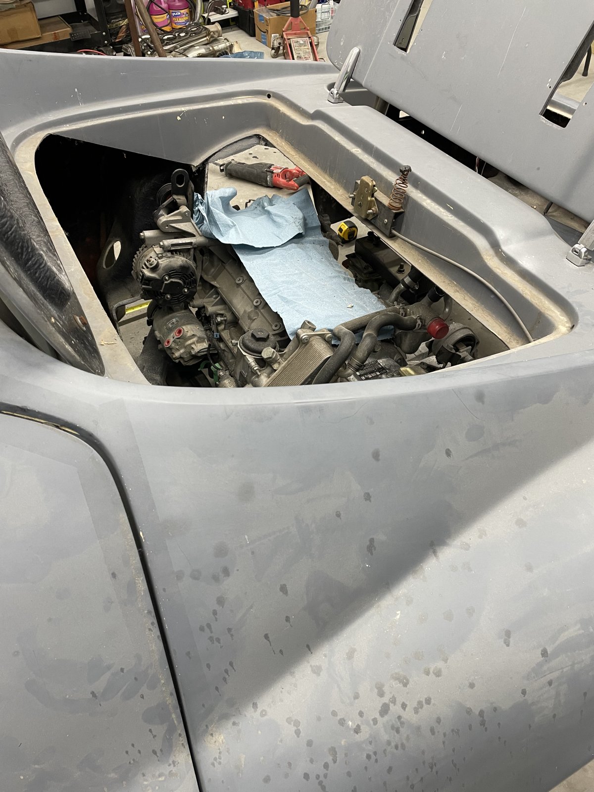

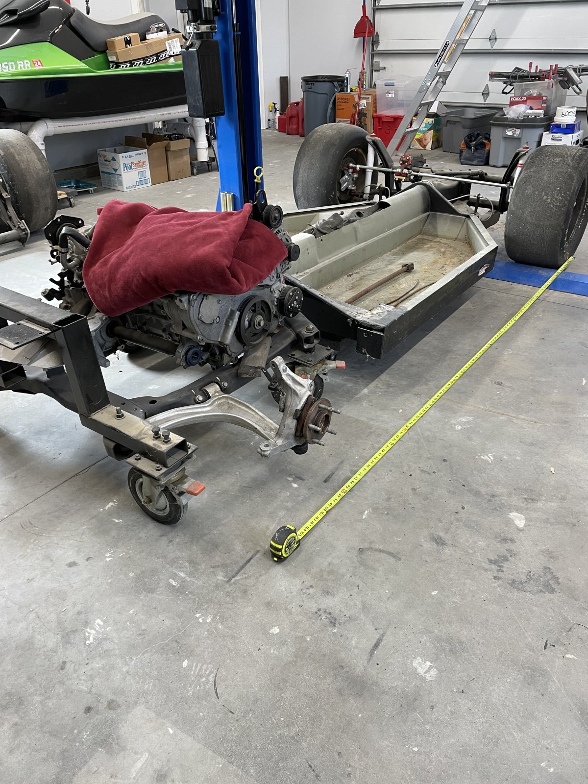

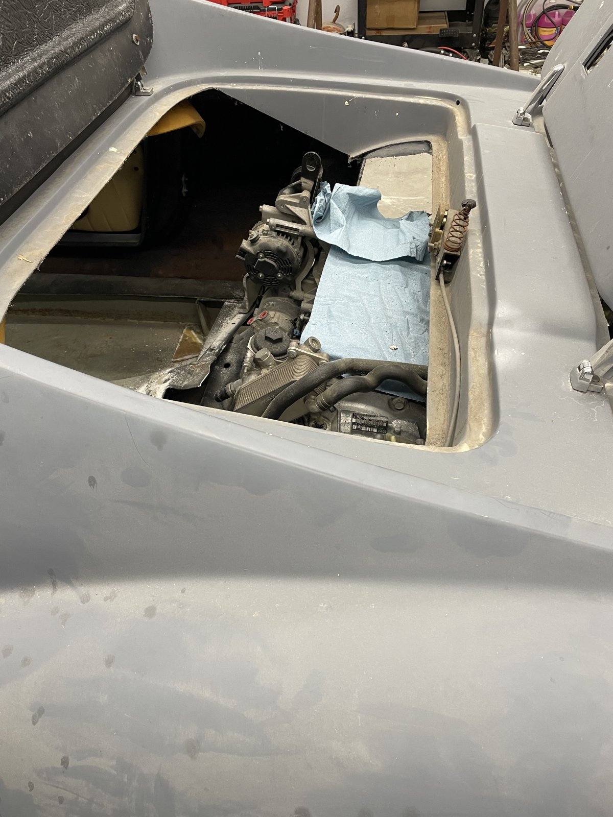

Yes all great questions. Let me start out by saying my current build is not a goblin although I would like to build one after this project is complete. The build I’m working on currently is a Kelmark GT that was intended to be built on a vw pan. VW pans absolutely had a place but they are not really what I’m going for. The Kit itself was purchased by my father in early 80’s. It was going to be a project for him and I but like many things in life don’t go as planned. Dads gone and I have my own kids that I want to build a couple cars with just to expose them to mechanics more. I currently have a LSJ with a F35 mocked up in a stock cradle and I have cut the back half of the vw pan off. I originally thought I would just mate the subframe up to the vw pan at the correct wheelbase and ride height. Quickly I figured out that I have no idea where the subframe is supposed to mount in relation to control arm and half shaft angles at ride height and also inclination of subframe from front to rear in chassis.I reached out because I wanted to try and duplicate the Goblin mounting points so if (when) I do buy a goblin kit I can build another tube back half for my build. I reached out to Goblin to see if they would sell me a front suspension and some parking brake components and was told she was forwarding my email to Adam but did not hear back from him. (Maybe the email got hung up) I also tried buying an 09 LNF cobalt I knew of but the owner has a deal pending. That’s when I decided to just go tube frame front and rear clips and build control arms for upper and lower as well as front and back. Might be a little ambitious due to the geometry and engineering to make it work well. But I think it will be a better driving vehicle in the end. Another reason I think I need to go away from the stock struts is because they are just to tall for the body. I’ll post some pics of the project and would appreciate any constructive criticism and or ideas.

This might help as well.
Thanks Again

I think your best bet would be to find a goblin near you and take measurements. If that isn’t possible maybe provide a sketch of what measurements you want.

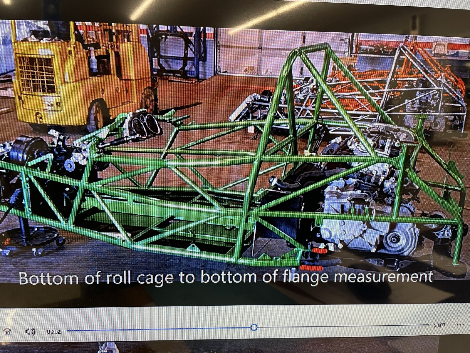

So another question on this subject
Can someone get me the measurement between the bottom of the bottom roll bar and the bottom of flange that the subframe mounts two. Picture I included sucks but it’s for reference. My guess is about 3 3/4”
