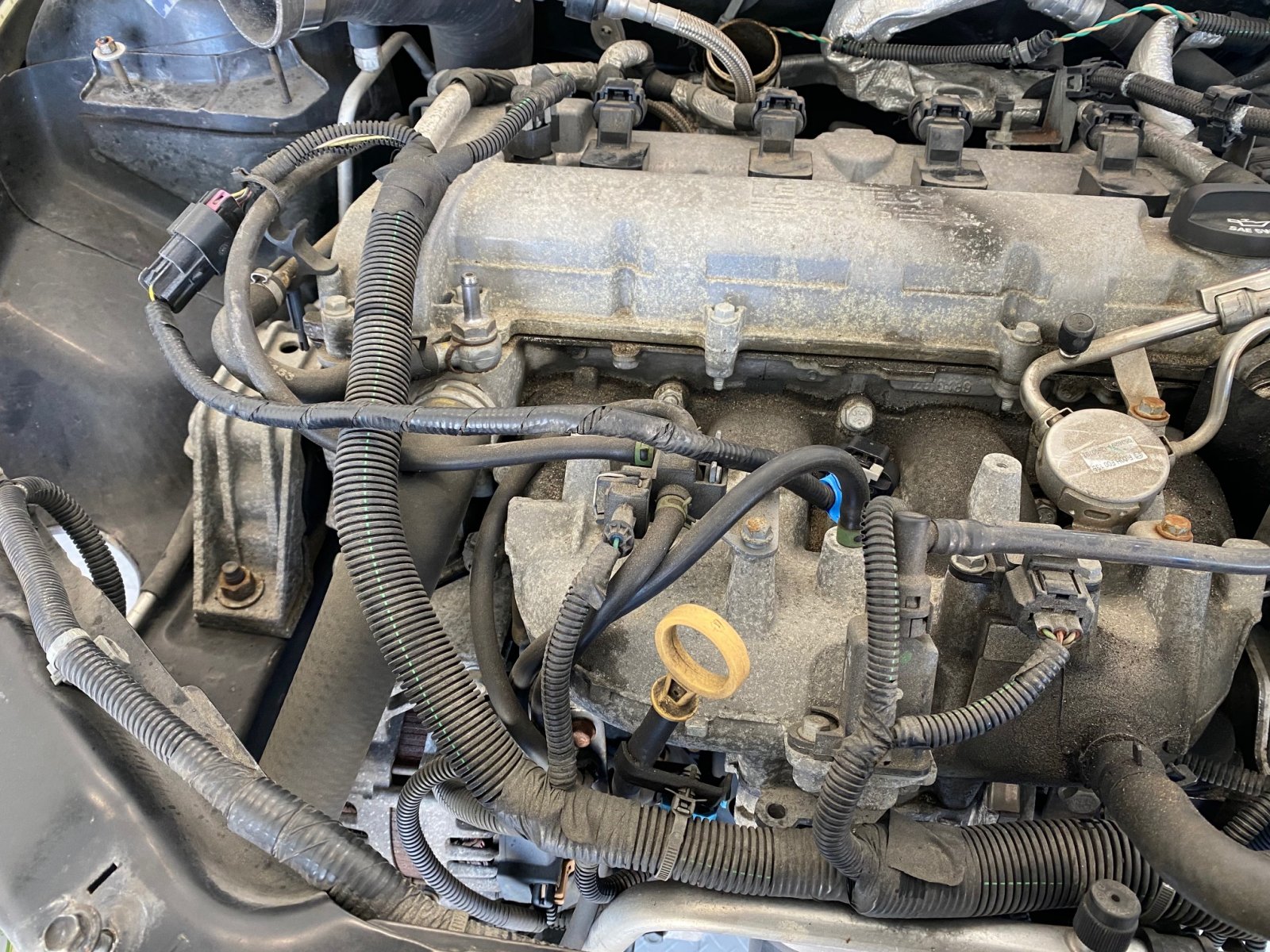

If you cleaned your engine prior to installing it in the Goblin? I'm using Simple Green concentrate (3:1 with water) and a brush to clean up the engine and its doing a decent job but I'm looking for get a little more shine out of it - if its there to be had.

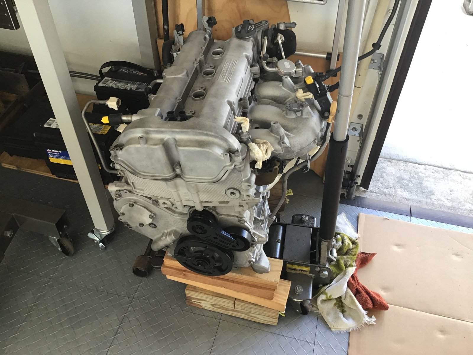

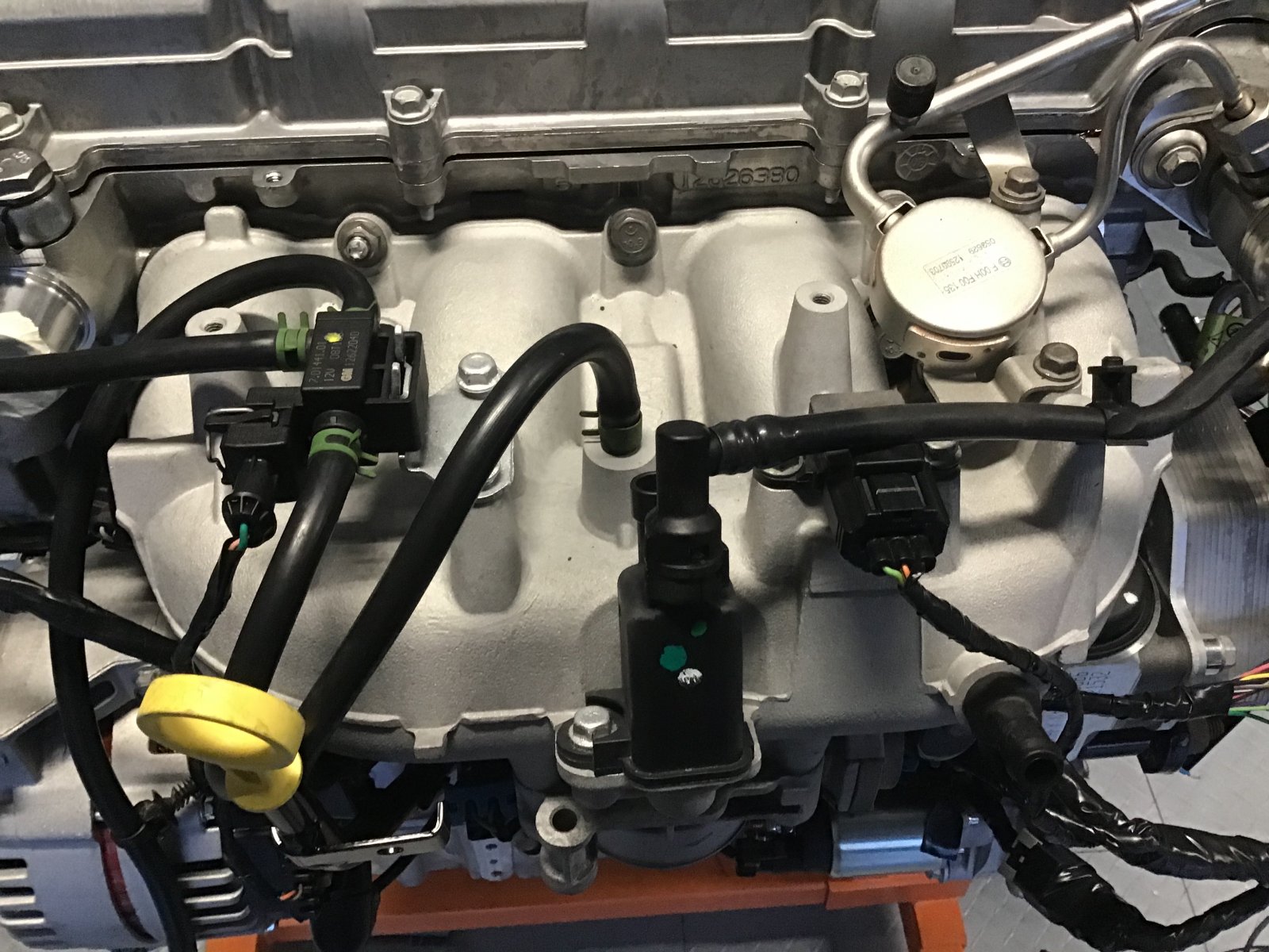

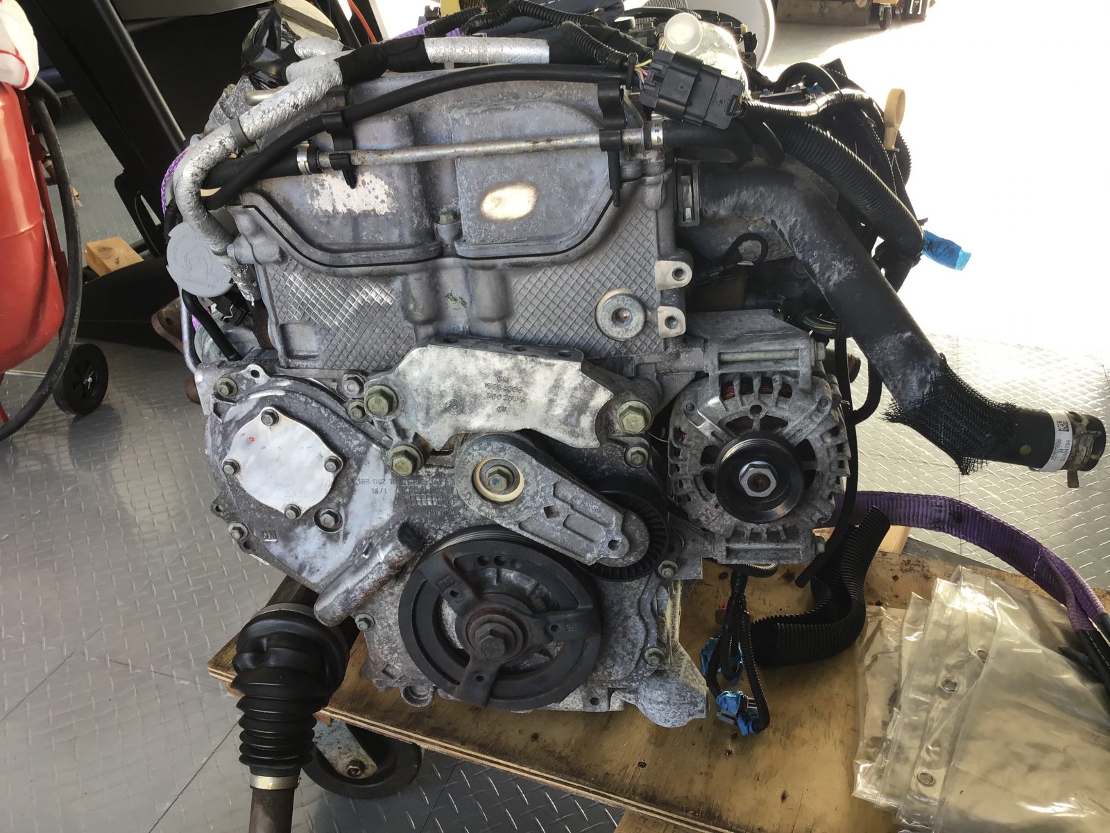

turn ugly engine into almost OEM LOL
See the big difference in intake manifold.
I tried everything to clean engine ZEP, SIMPLE GREEN, OVEN CLEANER, SAM’S PROFESSIONAL OVER CLEANER,
THEN I ( BLASTED THE ***** ) WHAT A DIFFERENCE THAT MAID, SHE WAS SO HAPPY TO BE CLEAN AGAIN !!
2nd Picture is after cleaning her with everything before blasting

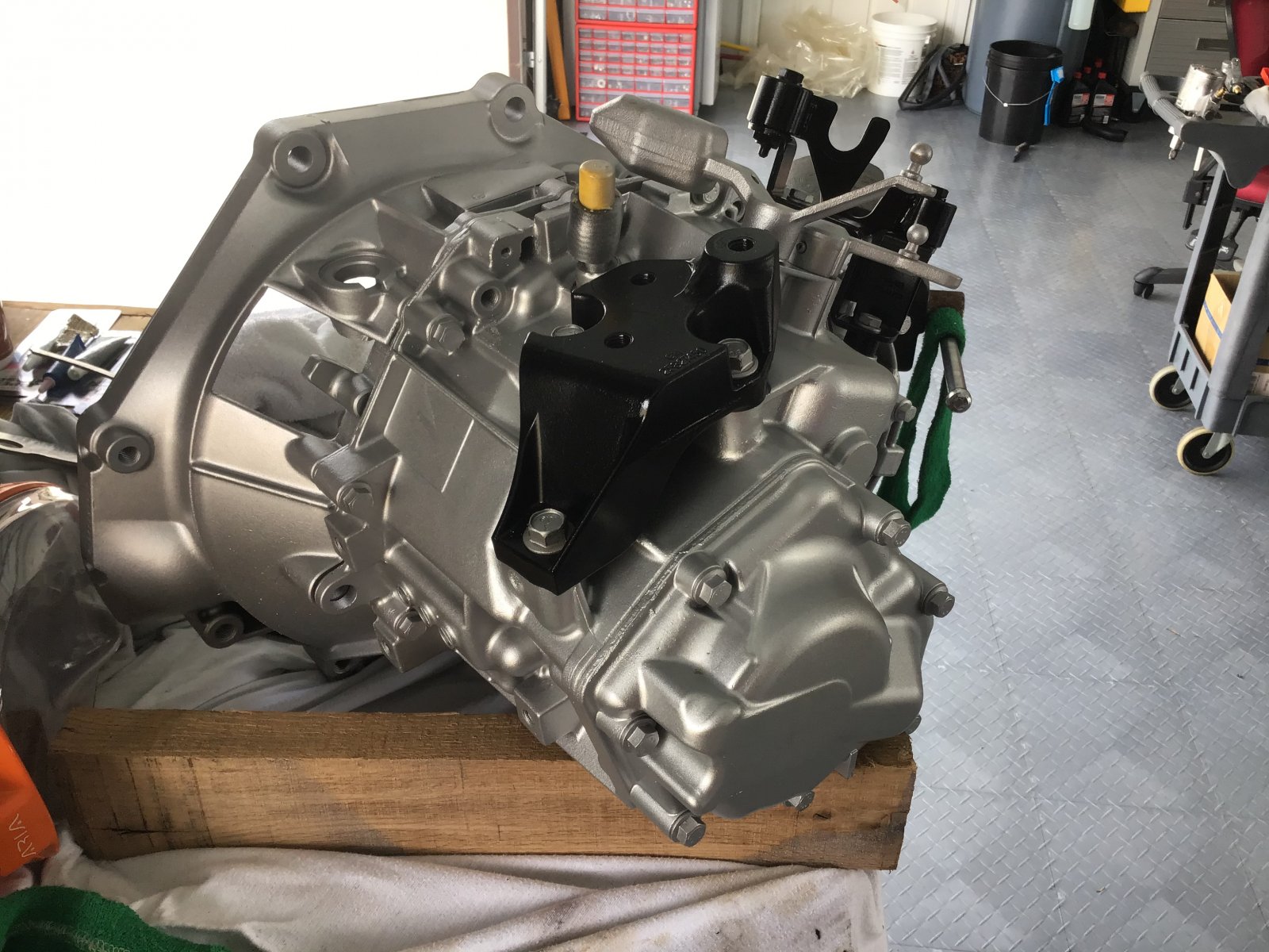

Sand blasted transmission then painted with high temp paint

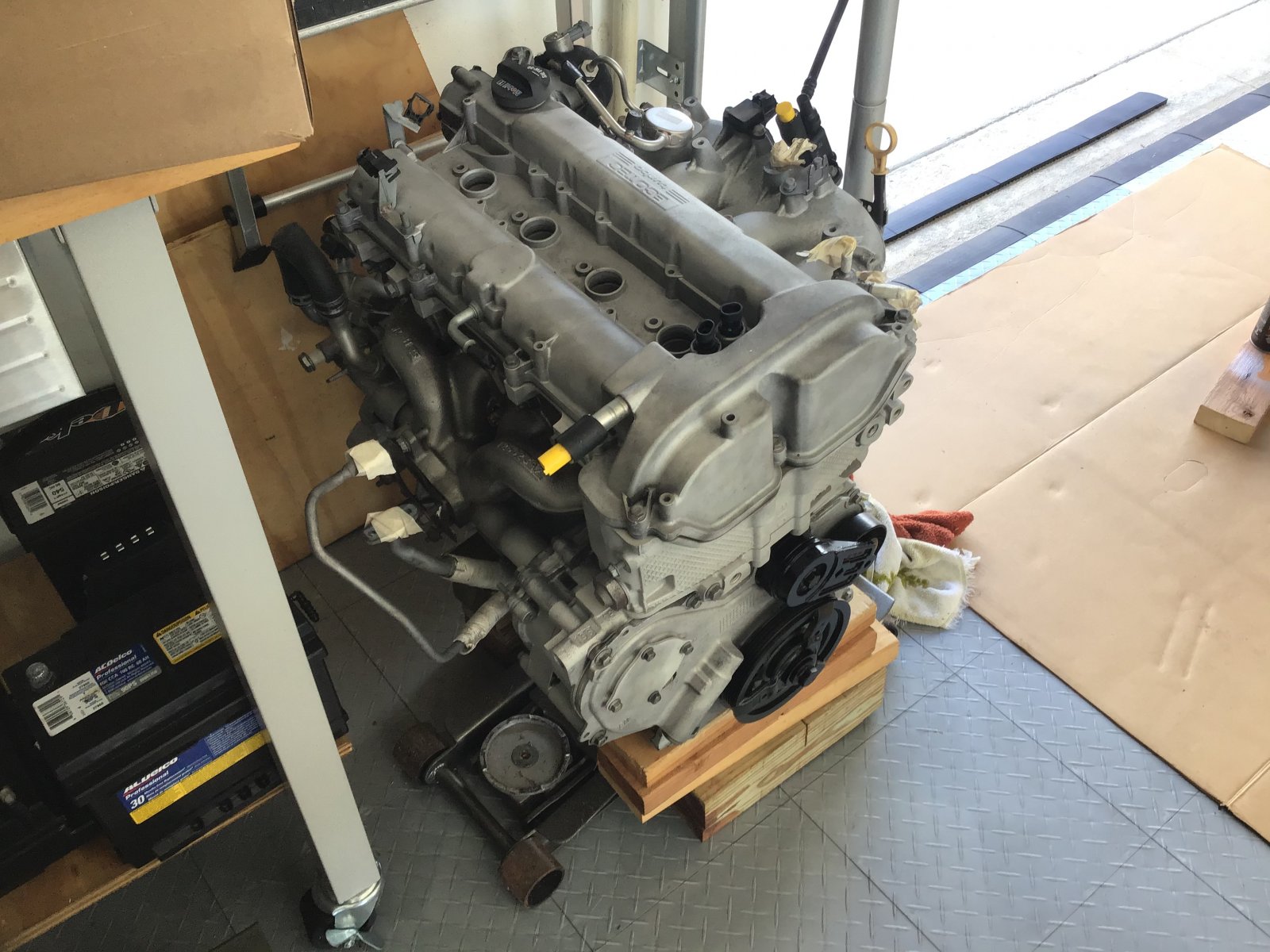

Cleaning will only remove the grease and grime at best. Much of what you are seeing is it oxidizing. That can't be removed by a "cleaner". Mechanical means are the most effective. Not sure I suggest everyone go out and blast high pressure sand at their engine. I attempted to use soda, but had poor results and wasn't worth the effort. I ended up spending a lot of free time wire brushing with different size and types of brushes.

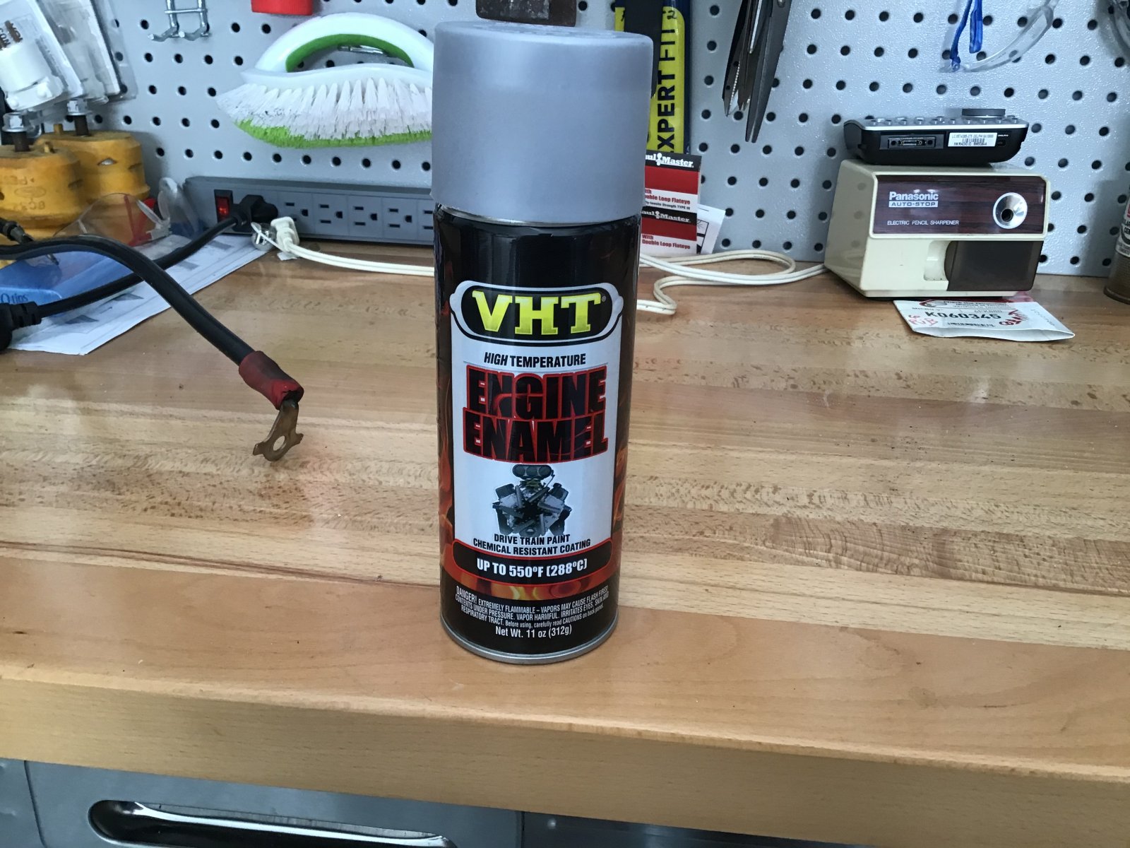

In the end, I use engine paint over it.

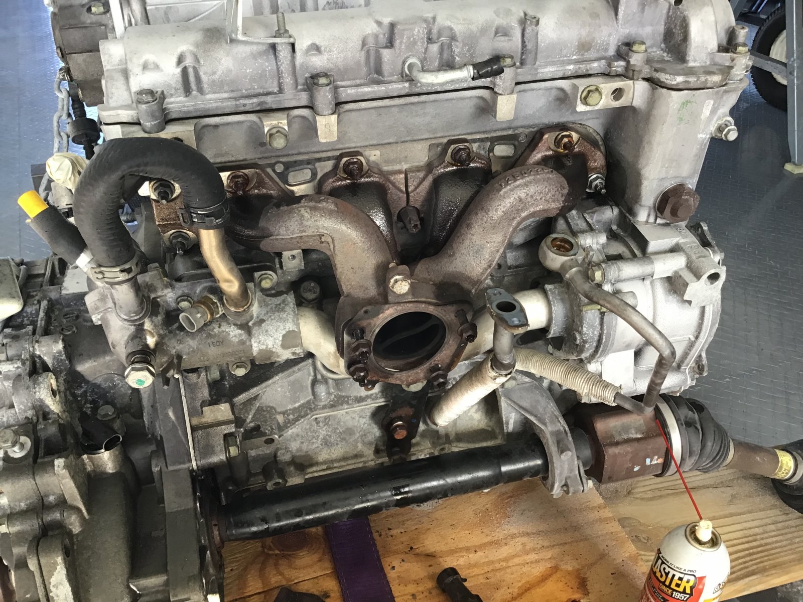

You didn’t suggest That I blast high pressure sand at mine but it sure did an outstanding job of cleaning engine, When you go from this to this, You can see where I tried the wire wheel but that wasn’t working very good in my opinion.

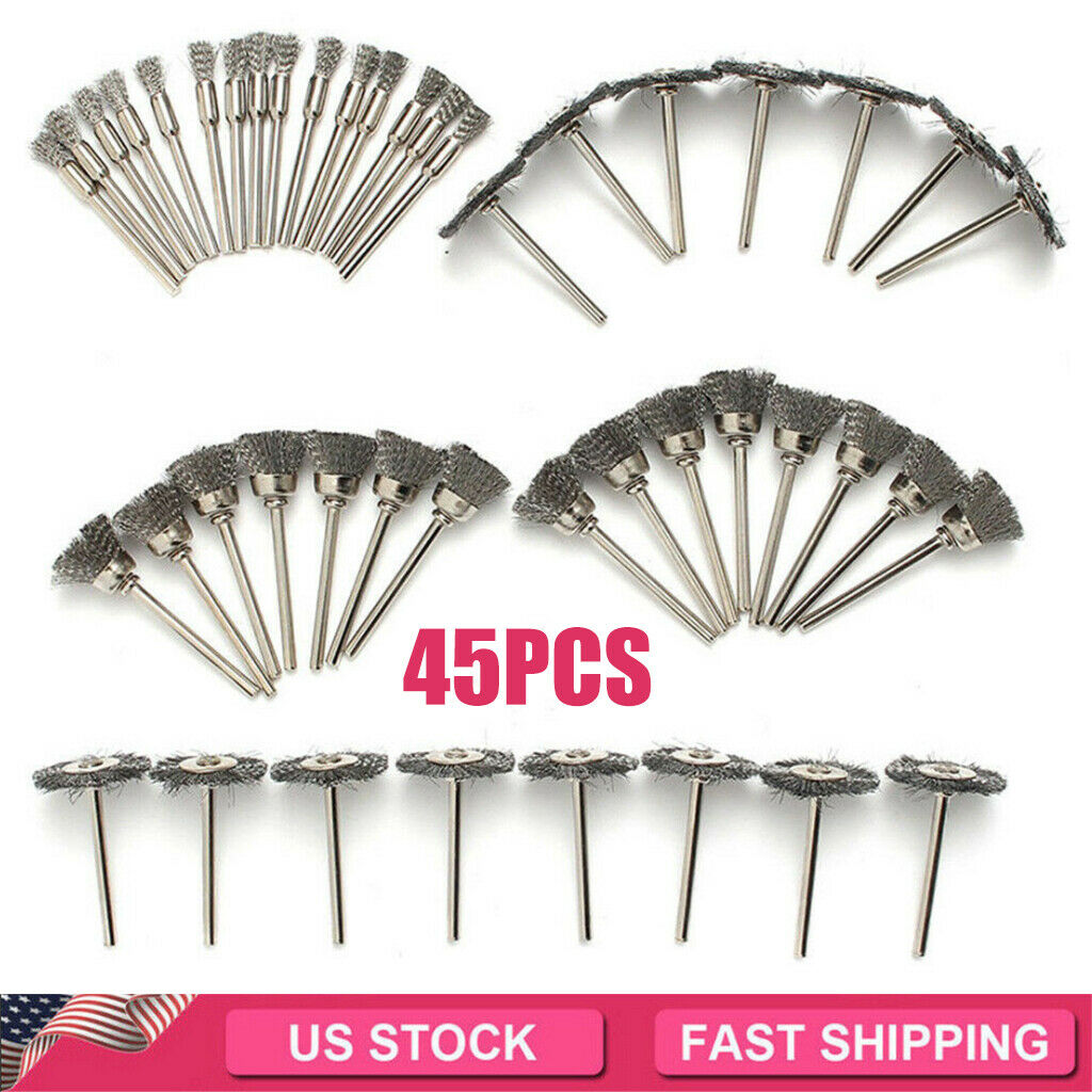

After the wire brush, I get in the tight areas with the dremel tool wire brushes:
The little wire brushes only last about 5 minutes, but they do get the job done.
I used these same type brushes and some aluminum paint afterwards. Like Ross said they did not last long wear at the minimum safety glasses I recommend a face shield. and long sleeves. Those little wires end up stuck everywhere. I used more of the cup and the pointed styles than any others. Brush assortment.
