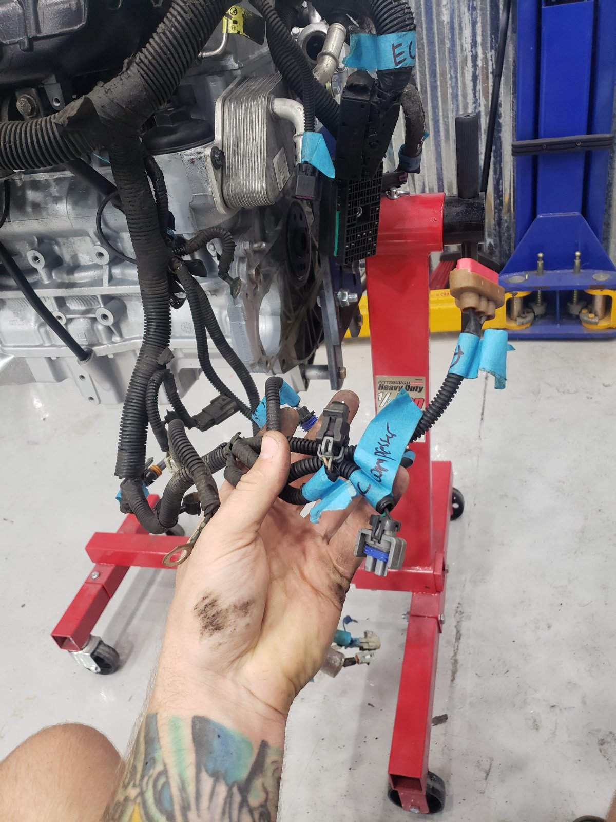

I sent my harnesses that were listed from DF to get the wires thinned out in the service they provide. Was I supposed to send the engine harness too? I am putting the engine together and I have all the wires for the fan, the ac compressor, intercooler pipe. Engine harness wasnt on the list that I saw so IDK what to do with these wires. Any help is good help. Thanks

You can thin the engine harness if you want or not. You can thin out AC plugs and the rad fan wires except the light blue that you'll use.
Ok so just tidying the wires up and out of the way can be ok? I definitely wish I had bought an engine that was not taken apart already. Heck of a learning curve here.
