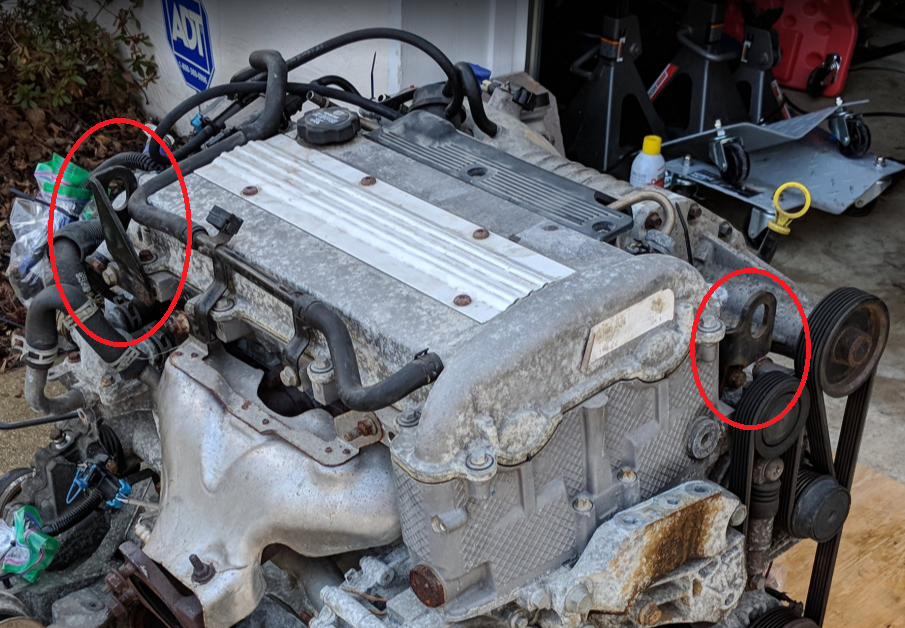

Guys, I'm about to use engine hoist in efforts to clean up, paint the engine etc. I also have an 34" engine hoist chain. Are those points below suitable? I have to assume they are there. But my chain doesn't have hooks on the end making me question myself, they are holes for bolts. So, I either need to buy a couple chain link things, or use bolts.
