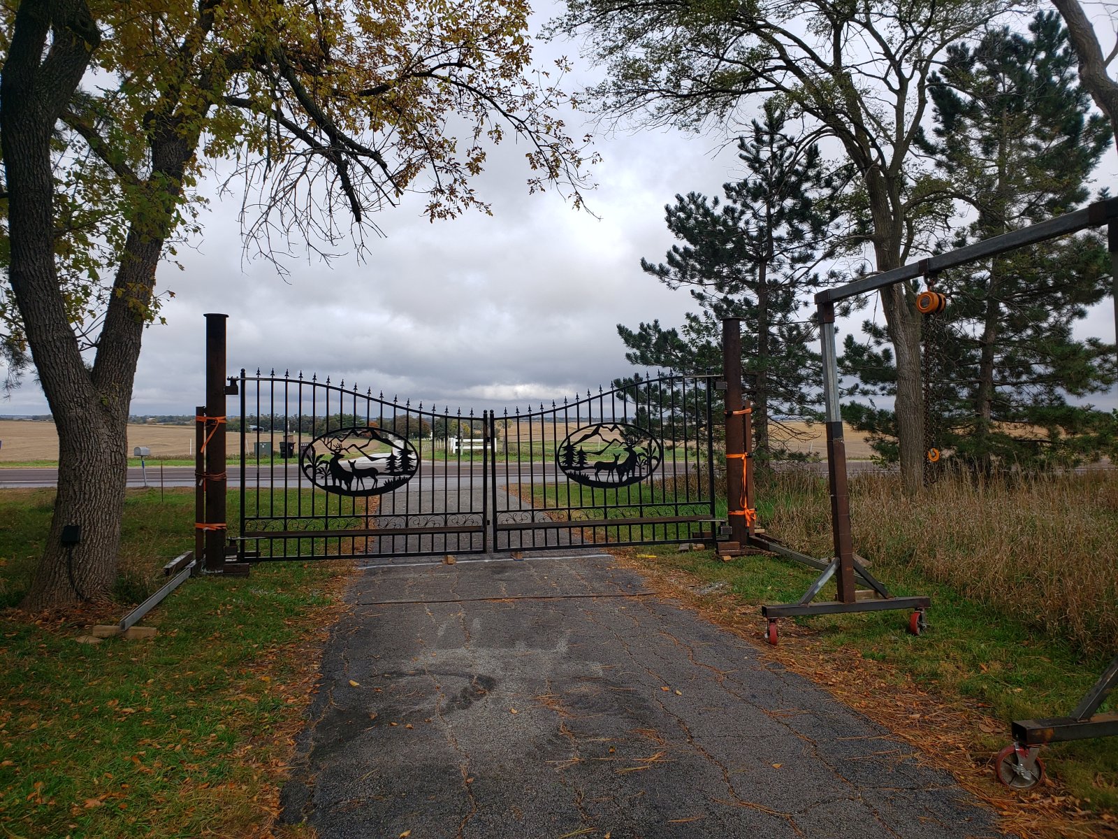

Here is how it looks now. these are just attached to some stands I made to hold gate square until the concrete sets up (not squared in this photo). kinda look like minecraft armor stands lol. the posts are 10" dia 1/4 wall well pipe and 10 feet tall. the bottom flanges will bolt to 5 foot stubs set into concrete. once the concrete is in, these are scheduled for paint and the gate panels will get oil stained cedar attached to the house side. oh and the "hinges" are left over Cobalt rear hubs incase you were wondering about the 6 degrees of separation to a Gobin forum. lol
