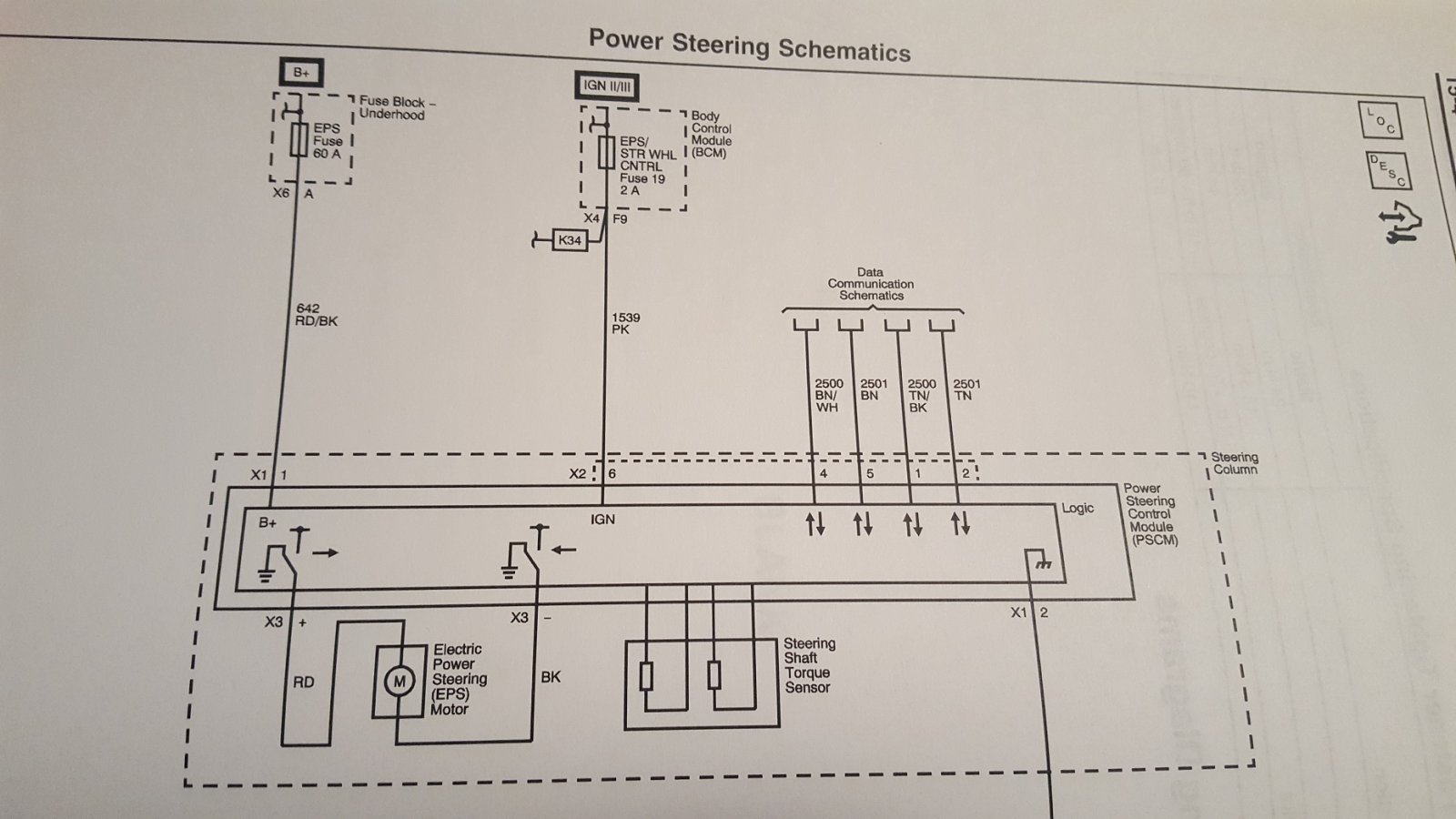

Can anybody help me with the power steering wiring? My power steering module 2 A fuse keeps popping and from what i can determine it seems as though the 12v wiring going to the module is grounded out! I am able to supply the module with a separate 12v supply and the EPS functions flawlessly. Soo I and hoping to find where that 12v is supplied to test/repair. I am hoping the wire comes from the bcm and not the pcm as I have already riveted the center cap... (fingers crossed)
