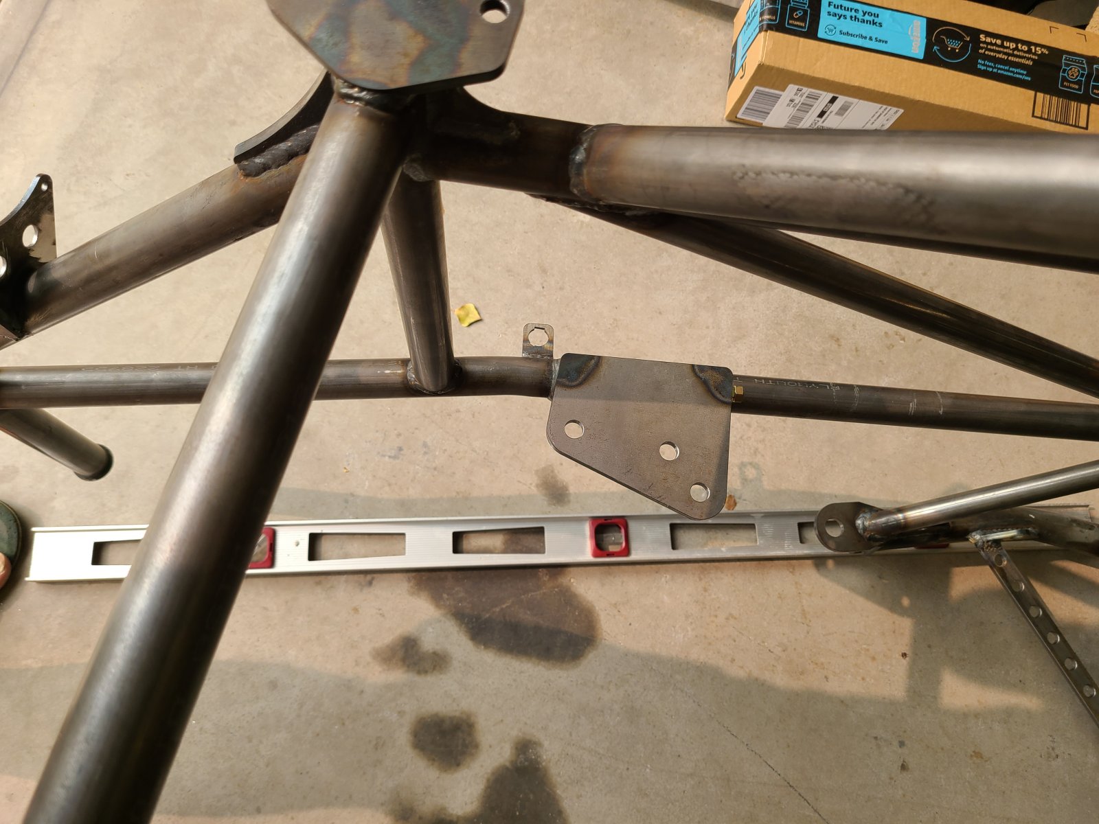

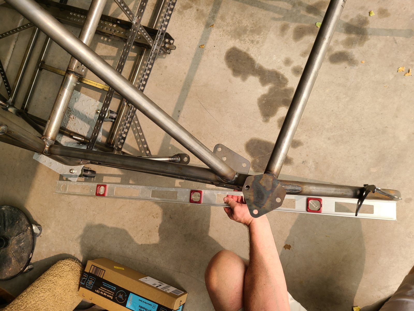

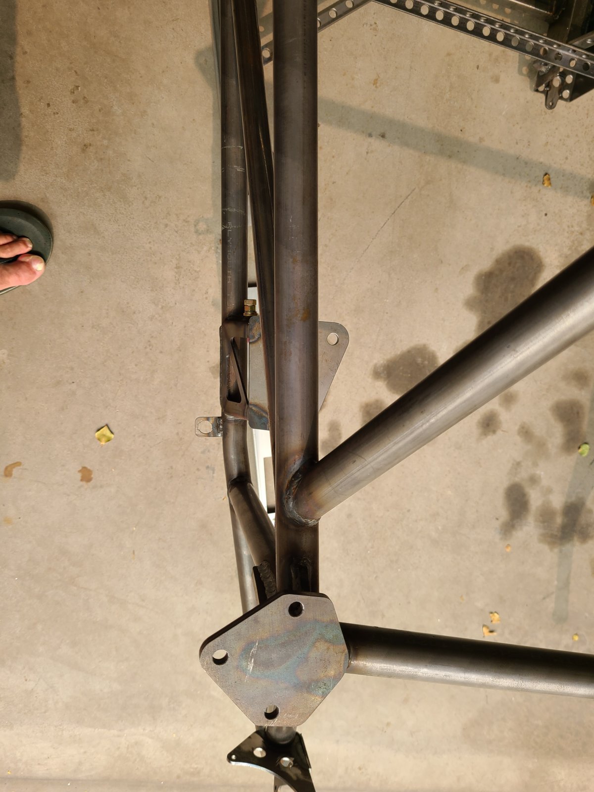

Ross, I didn't forget about your question, I've been too busy this week to get the photos til now. I put a straight edge in the photos so you can see the 'kink' in the frame that moves the lower rail out a little over an inch next to the trans mount - which also is different. Let me know if you need any other angles.
Thanks Tim. The changes are subtle, but important. Looks like DF did a great job. I am guessing you did all the holey modifications?
