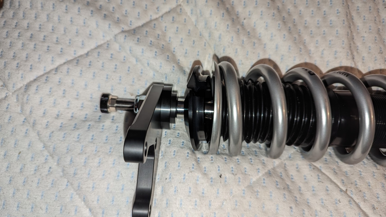

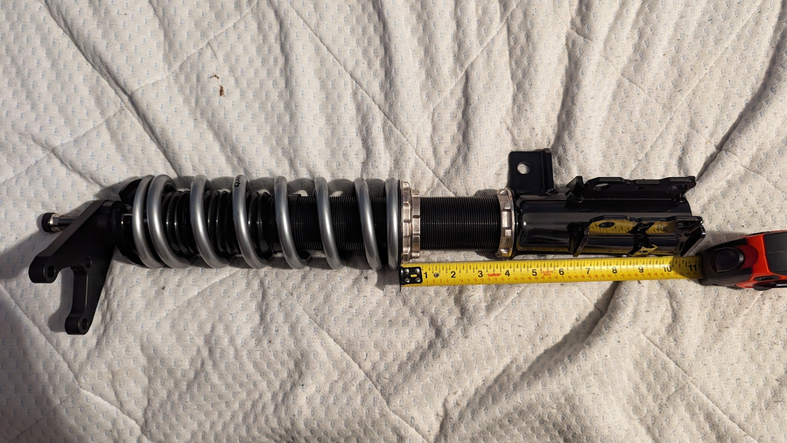

Today is my birthday. My mental health has reached a state where I am almost unable to work. None the less, I sent out the seat mounts and coolant bracket to be powder coated. I have the front and rear control arms and subframe at powder coating as well. The current lead time is 2~3 weeks as of today. Do I use the donor steering knuckles in the rear or is DF specific ones supplied? Asking because if so I have to clean them up as well. I turned in the donor tags and will be getting the donor hauled off soon. I contacted DF and requested stage 3 invoice and I am expecting more stage 2 stuff to arrive this week or next. I took time today to assemble the rear coilovers using the supplied photo gallery as a guide so that I can feel like I accomplished something today.
Guide: https://photos.app.goo.gl/aMx82XNptYFiRceaA
Mine:
47043
47044
On another note, once I get the MCO I might be able to fast track getting the kitcar registered in montana despite not being complete since my cousin is a state trooper and he will be doing the inspection.
Edit: working on the second coilover, the nylok nut won't go down and is just spinning the silver metal shaft unlike the other one where it didn't give no fuss. What do?
Edit: Nevermind found out that I have to use a hex key while turning the nut
You do use the Cobalt knuckles in the rear. Yes, use an Allen wrench in the strut shaft to pin it in place while tightening the locknut on the damper shafts.
