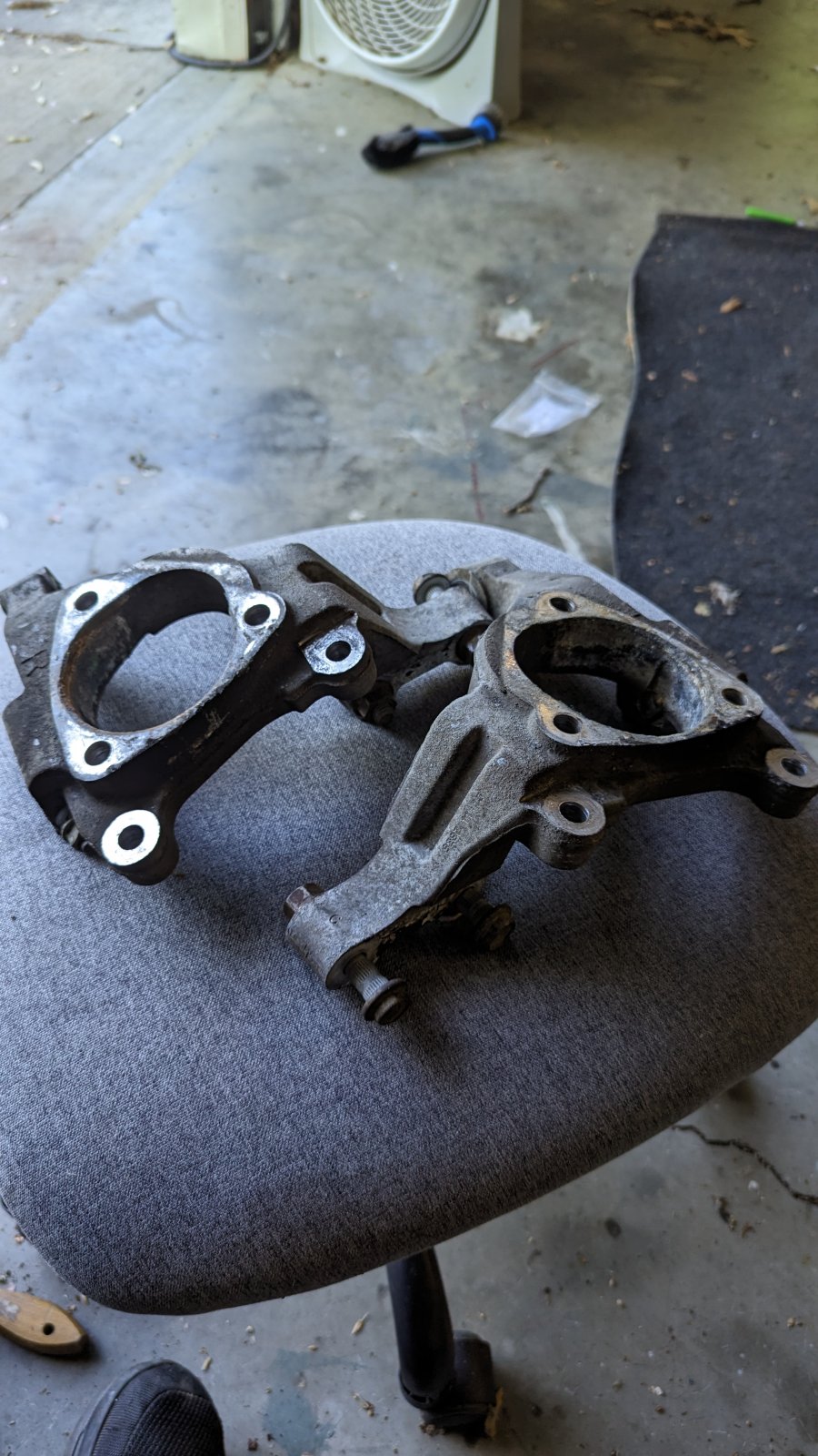

Got the knuckles separated using the bolt trick and installed the coilovers

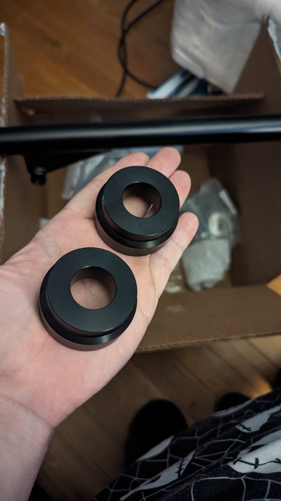

Something looks off on the top of the coilover assembly: http://dfkitcar.com/forum/index.php?threads/coilover-options.764/post-13095
Fenix Nexen
The spacer is coated black now
Oh okay good to know

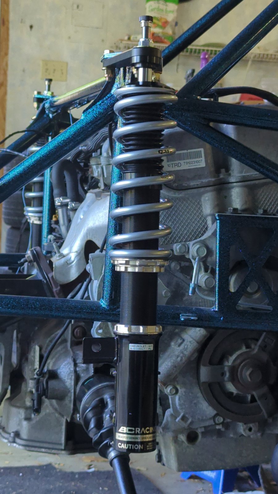

Is it because there's nothing else attached to the coilover that there's a gap between the spring top hat and the spacer? Even at full droop I don't have a gap there. Sorry if I'm making a fuss for nothing.
Yeah that's what I'm thinking. Will see what happens when I get the rest of the stuff on

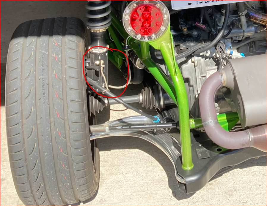

Even without running a sway bar, you should switch the sides as it will also give you a mounting point to hold the parking brake cables. You can see on the sticker FL for Front Left.
47064
As @Rauq also mentioned, a good starting point is to thread the spring perch up to take all the play out of the spring at full droop and then thread in the bottom housing for ride height. Most start at ~4" measured inside the knuckle housing to the bottom of the shock insert.
Joe
Multiple reasons to swap them so I will be doing that. I measured 4.5 inches deep into the strut just as the assembly pictures shown. Will see how it's loaded when everything is attached but atm stuff is at powder coating for a few weeks

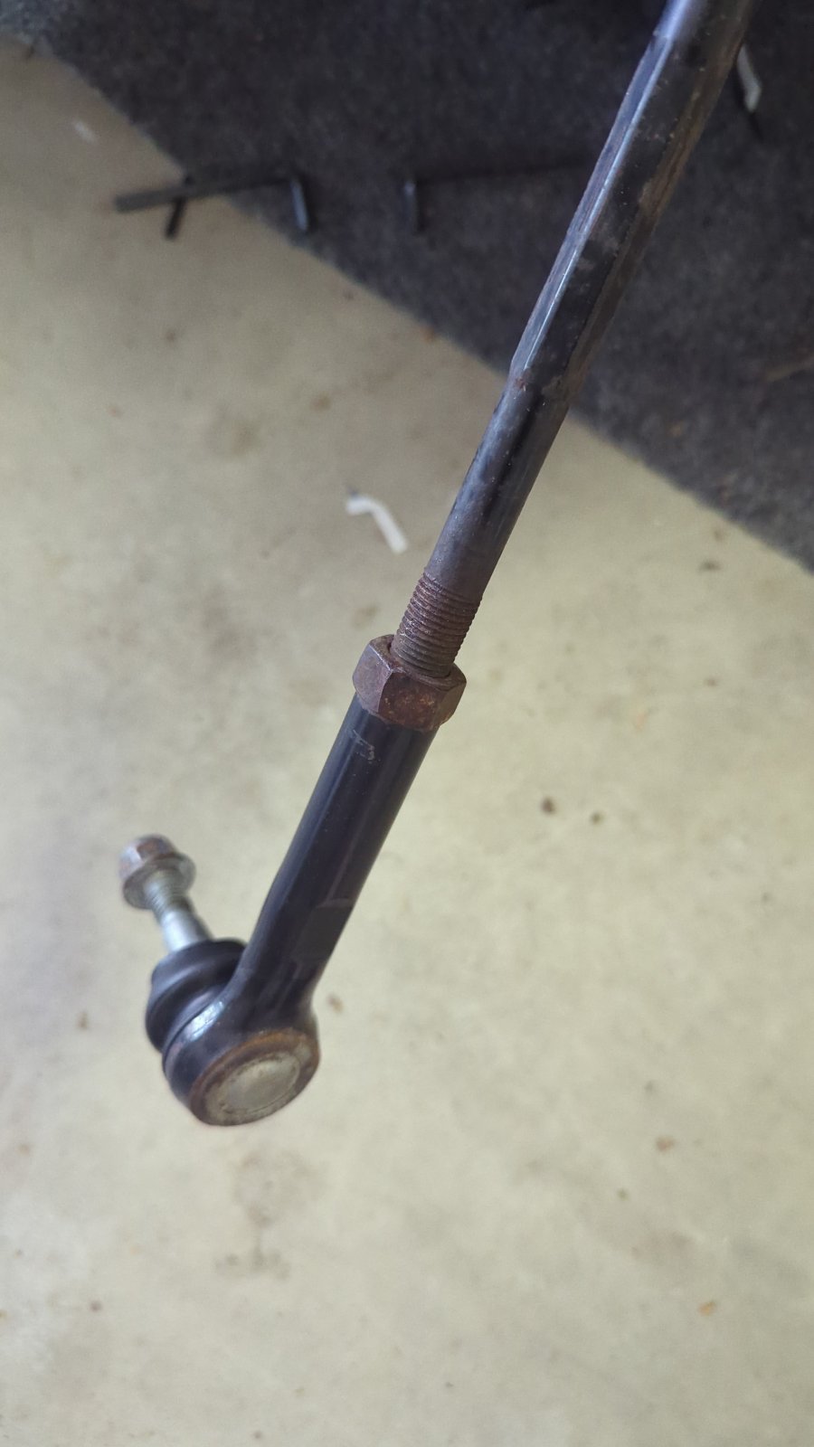

Maybe. I'm tinkering on some parts right now and the front tie rods seem to be rusted on. Tried elbow grease and it's not budging. Front what I understand the front tie rods are used in the rear?
